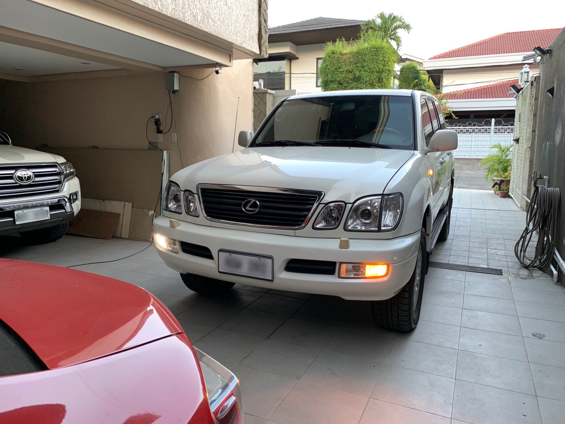

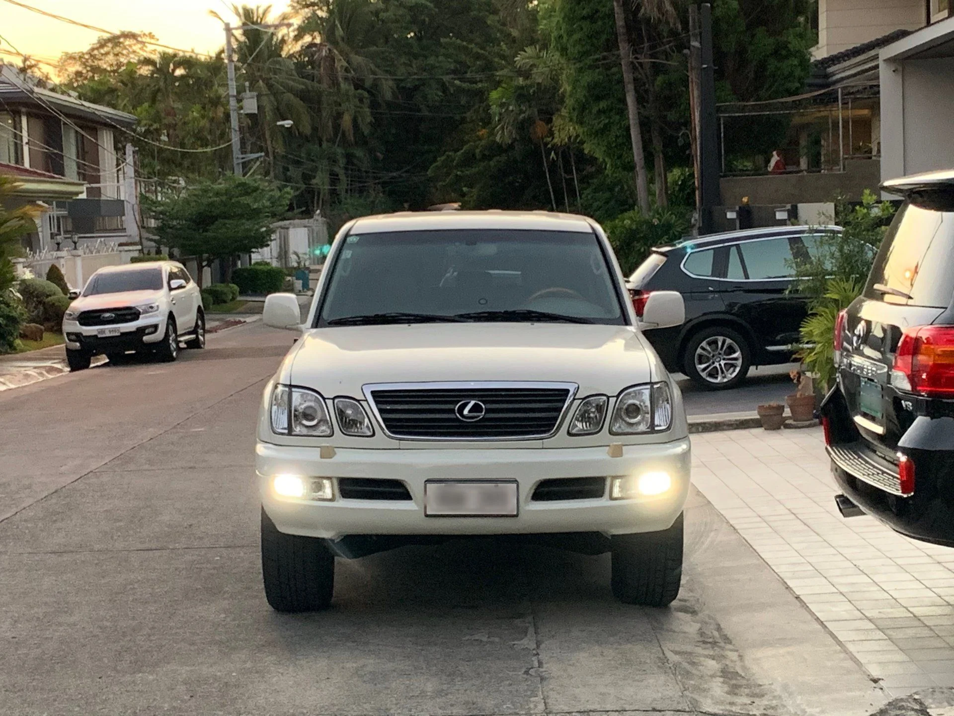

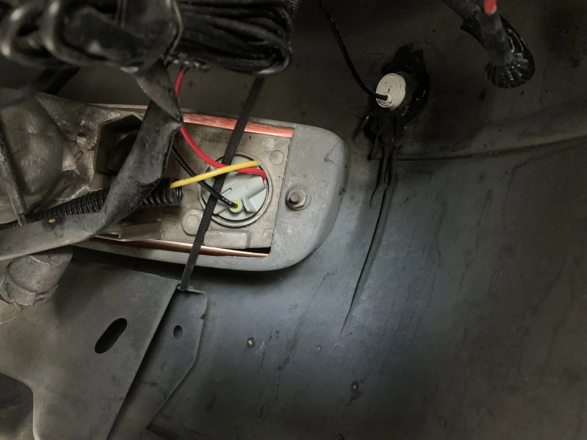

I had somebody ask me in another thread how I converted my turn signals to DRL/turn signals. So here it goes. Not really a step by step but just a post with the diagram and stuff needed. Please note that we are on a lockdown here in Manila due to COVID-19 so I had to make do with what I already had at home since all the stores are closed.

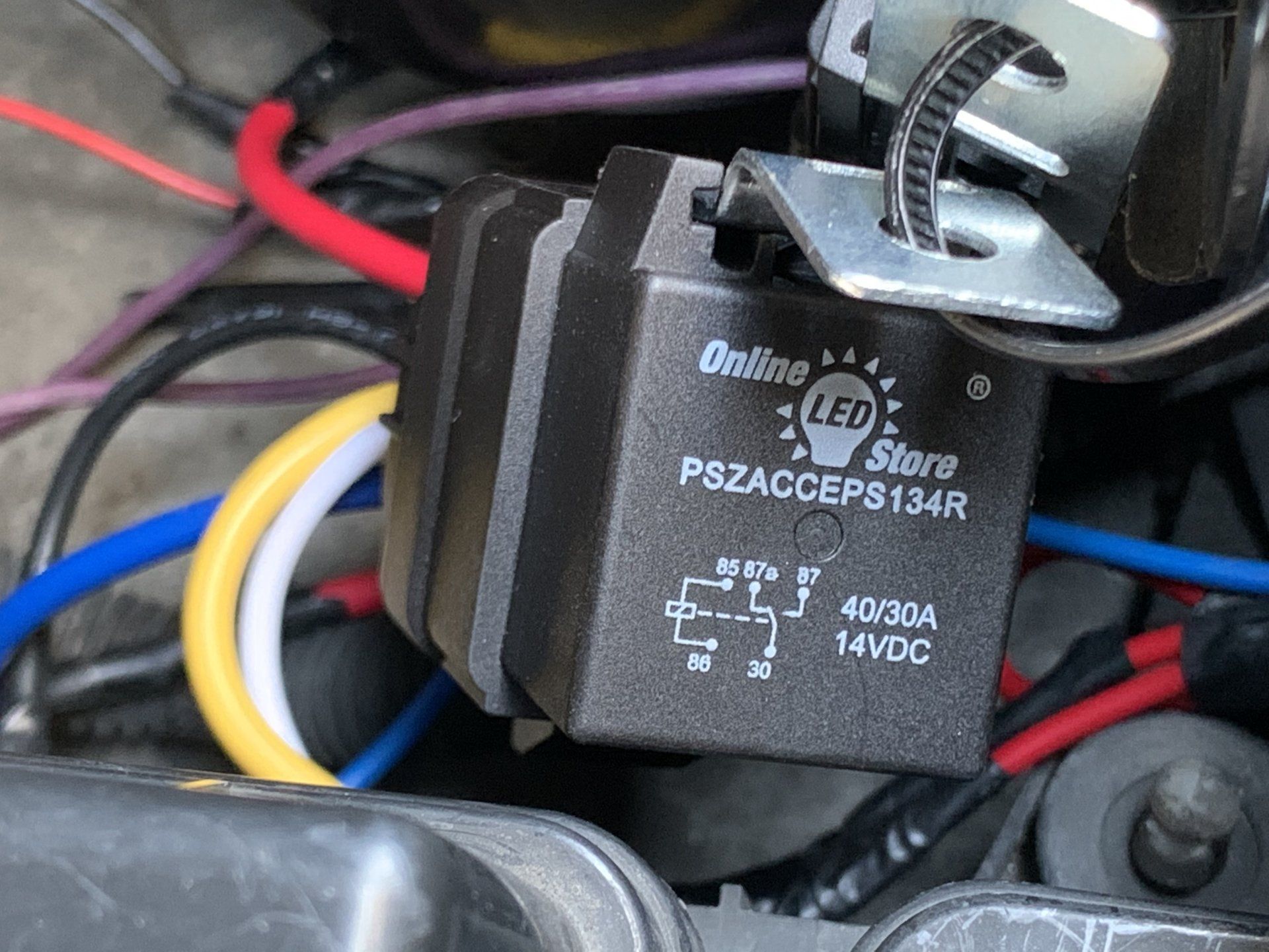

-two relays, one must be SPDT, the other can be SPST. I used these:
Amazon product ASIN B01MTQNJKM

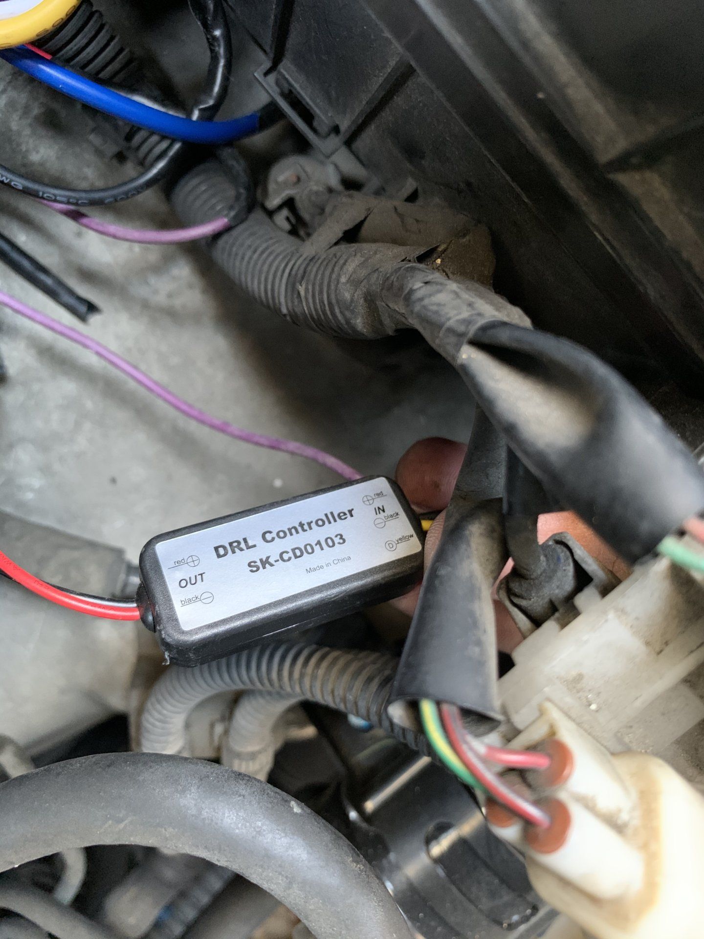

-DRL controller (optional)
Amazon product ASIN B010NEO5HQ

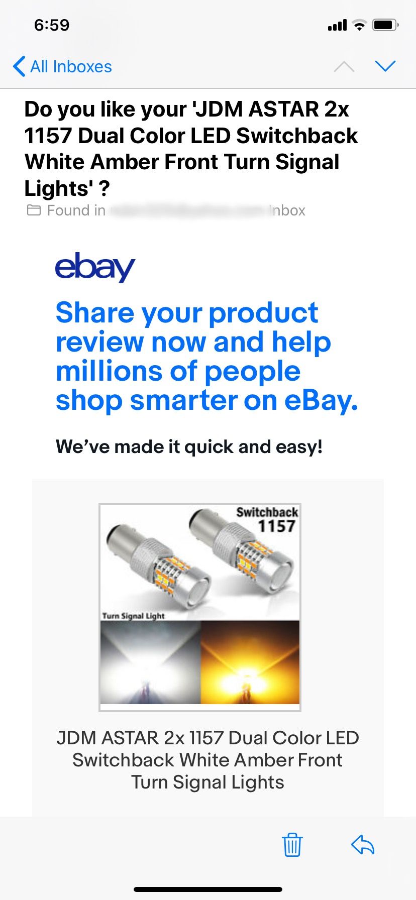

-1157 LED switchback bulbs

I couldn’t find the bulbs I used on amazon or ebay anymore so I didn’t post a link. Here’s what I used for reference:
Instead of a regular LED flasher relay, I used the SmartTap CF18 which added one touch signalling: Just installed SmartTap flasher relay and LED bulbs

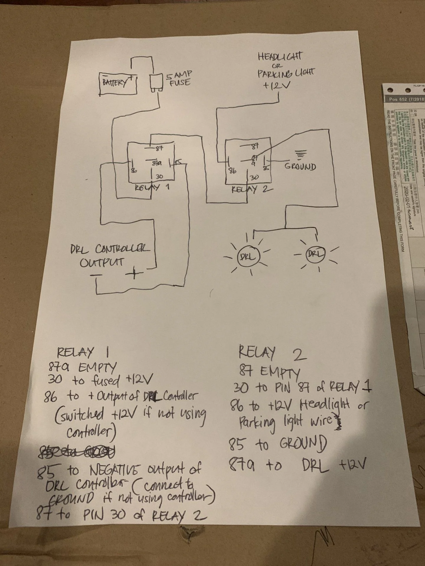

Wiring diagram. Take note that the DRL controller is optional. You can use switched +12V in its place in pin 86 and ground pin 85 of relay 1. DRL controller just makes it easier since it hooks up directly to the battery and you have the added feature of having the lights stay on for a couple of seconds after shutting the car off
Additional note: the purpose of the second relay (SPDT) is to cut power to the DRL when the parking lights or headlights are switched on. If you want the DRL to always stay on, you can ditch the second relay and connect the output to the DRL to pin 87 of relay 1. Relay 1 can be a regular SPST relay.
