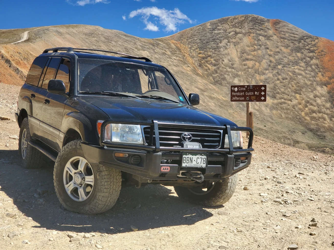

Love the look and capability of my LC with 385/75/R18s. But without a regear, it has been a struggle at times, especially towing. It's time for new tires and they don't make the cooper at3 xlt in my size anymore. A regear is going to cost like 5 grand now a days, and I'm considering just downsizing to gain some power back. We only do like 1 trip a year where the 35s are really needed. I think if I went to 33s, i wouldn't need the regear. I'd probably just turn down the torsion bars in the front to be about. 5" lift and maybe swap out the rear coils to handle the extra weight but not provide lift.
What are your thoughts?
How she looks with 35s
