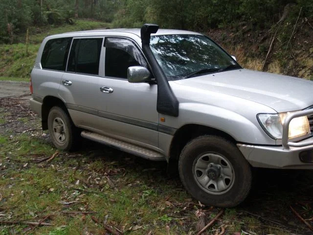

It's not that Australians can't make them, only ARB doesn't make strong sliders. Here's Moooooo's rig with Cheezy brand sliders and some Cheezy 80 series sliders.
