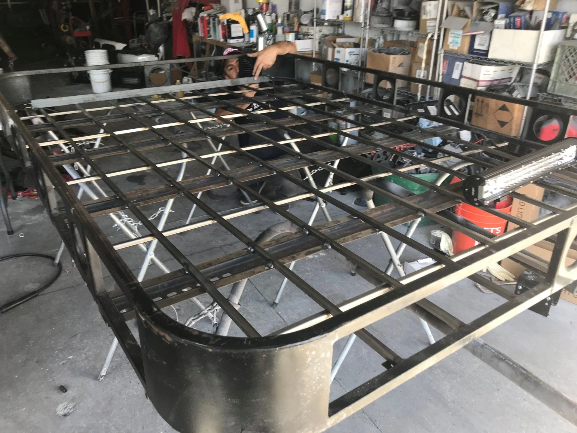

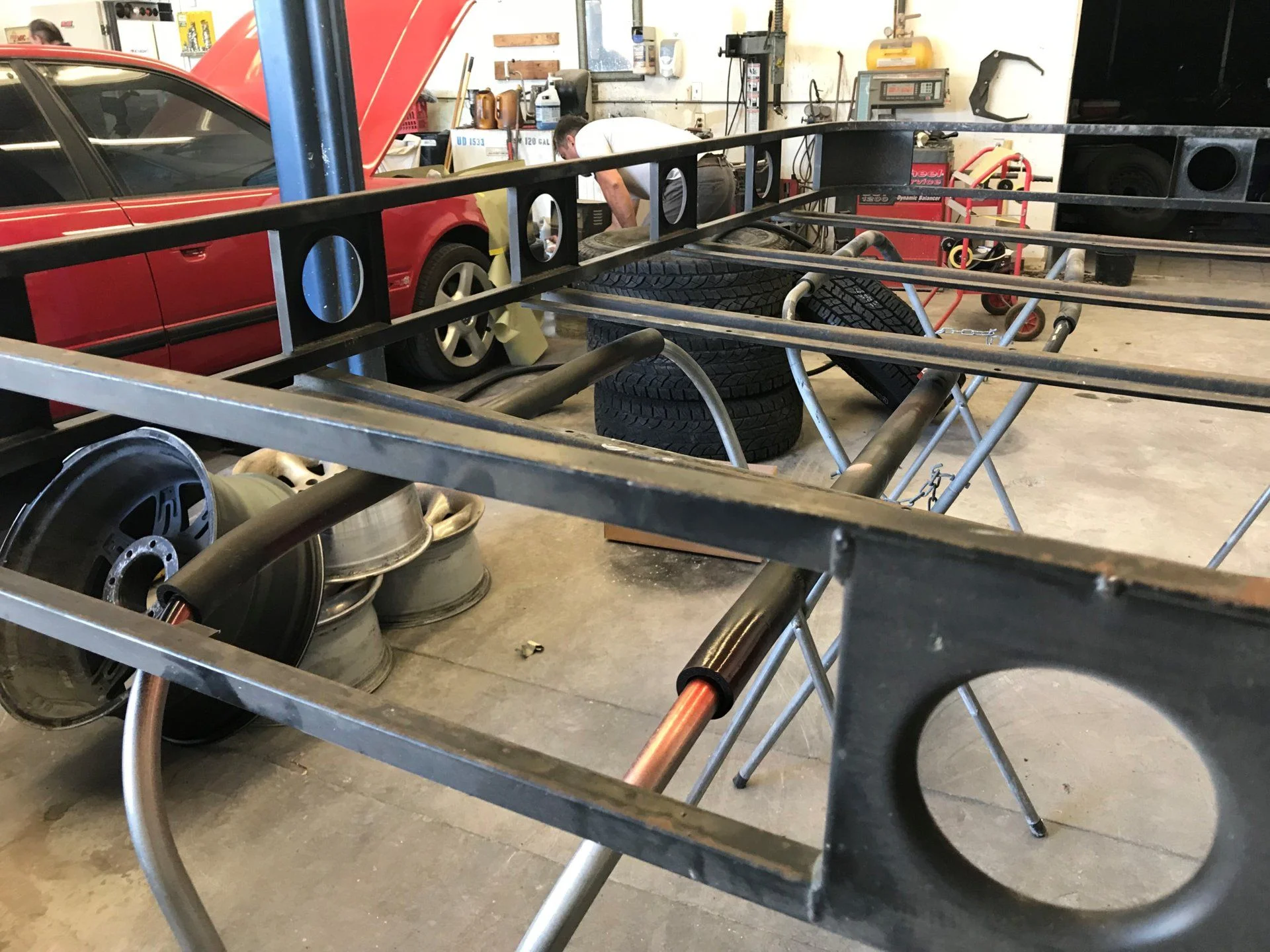

However, I thought I'd post a thread on the new rack I'm having rebuilt for the truck by Sam in Surprise, Arizona. He's a really good welder and machinist. I got the rack from Barry Henderson, a CSC member here in Phoenix and originally a native of South Africa. It's the large 6-inch tall Con-ferr which has somehow always looked right on the 60 series to me. Currently, plan is to use 1/2-inch square stock to beef up the rack, basically forming a floor with 6-6 inch spaces throughout, and I'm adding front and rear integrated LED lights. Eventually a 2nd spare tire holder (an original Con-ferr that I picked up on Ebay a few years ago, a propane tank hold down and a 3-can carrier for 2.5gallon spectre cans (I find these MUCH easier to get on and off the roof).
ANY INPUT FROM MUDDERS WOULD BE VERY WELCOME.

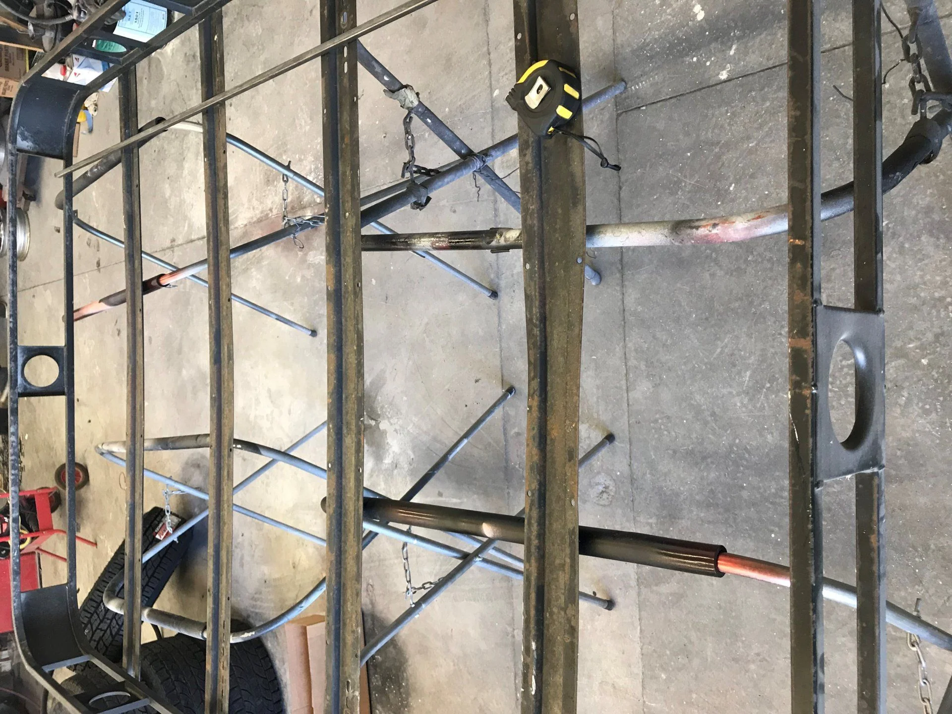

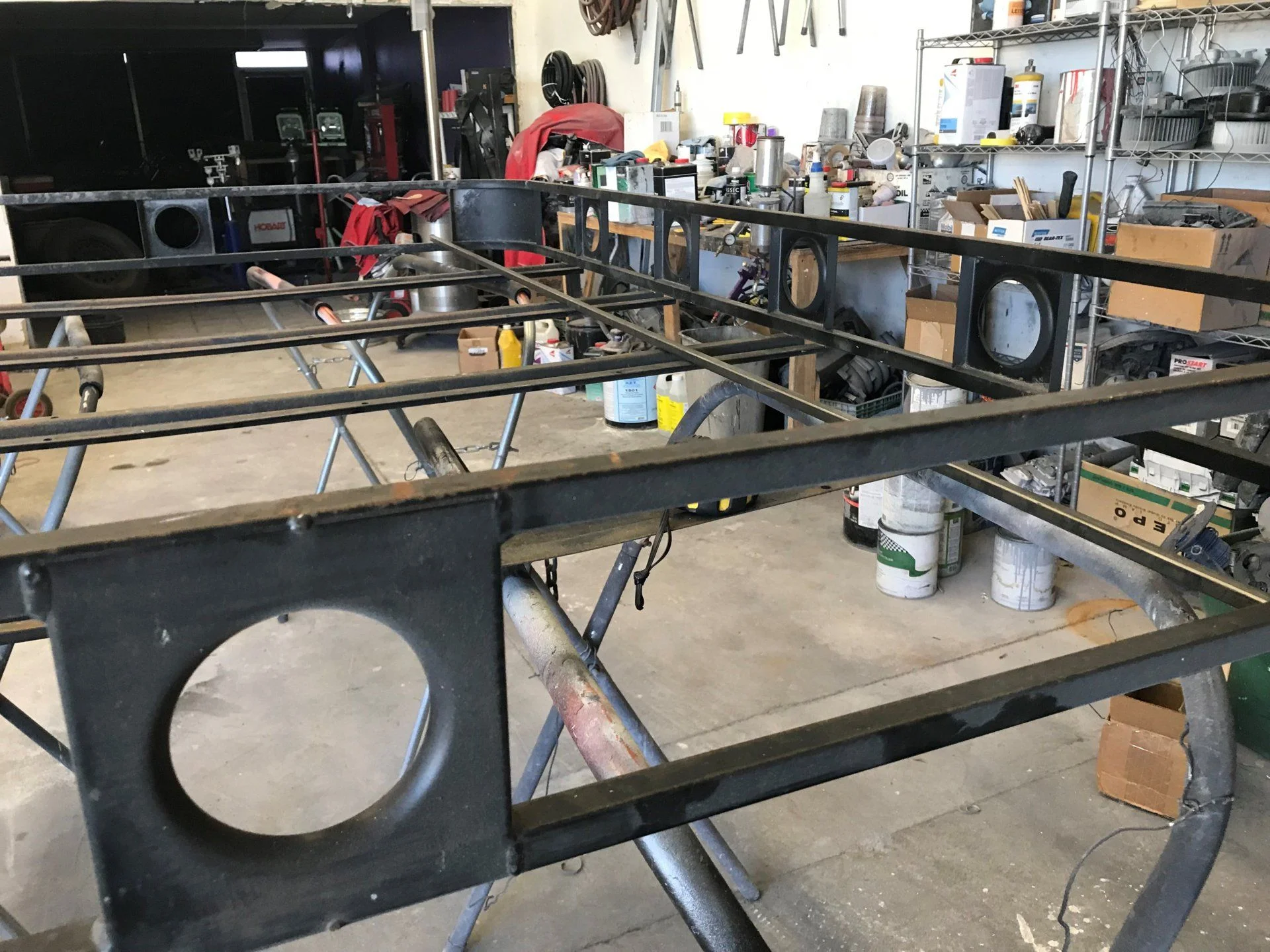

The first pics are of the rack on Barry's truck and then when it arrived at the shop. It was solid but bare bones. Small areas of corrosion.

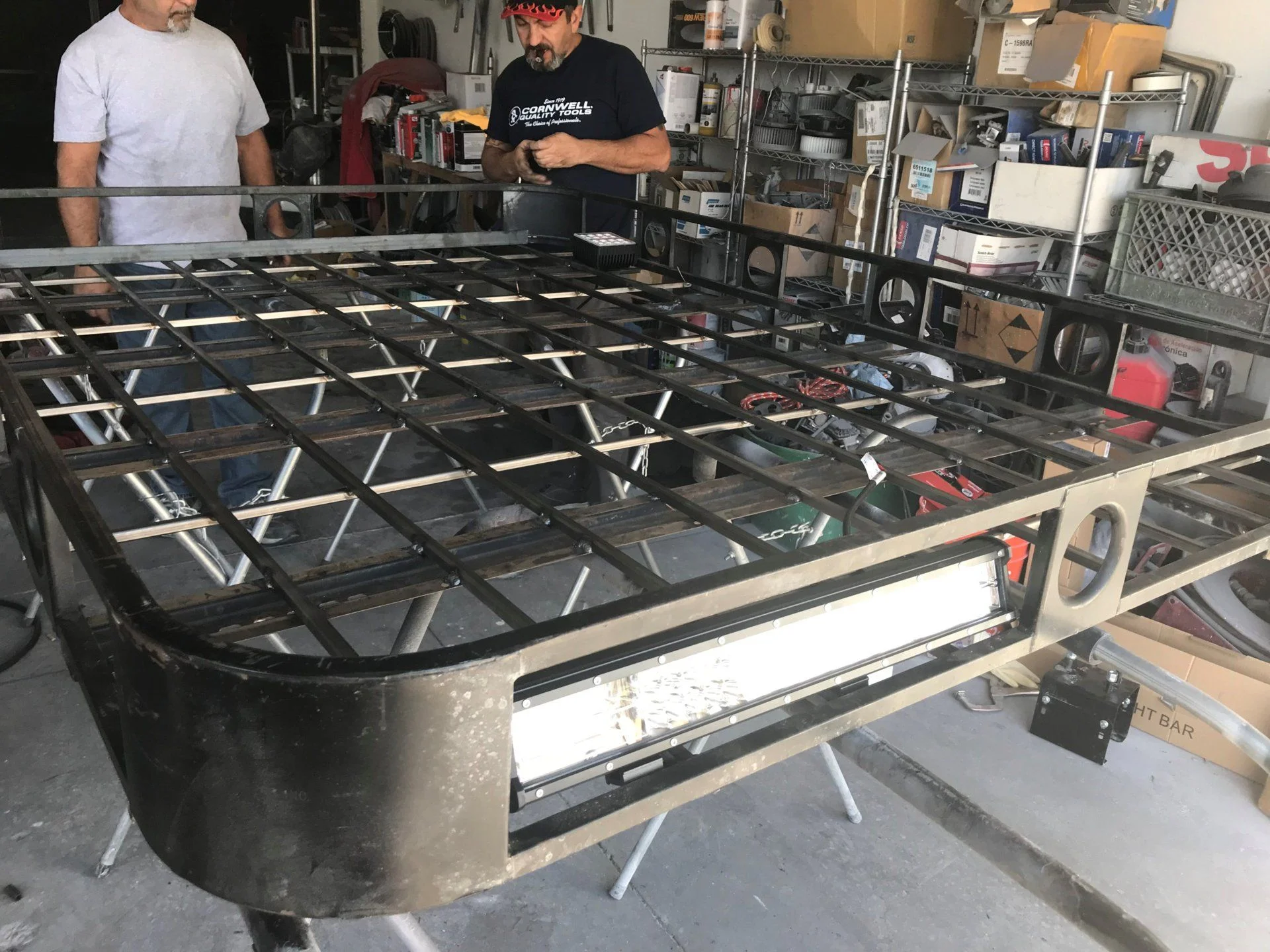

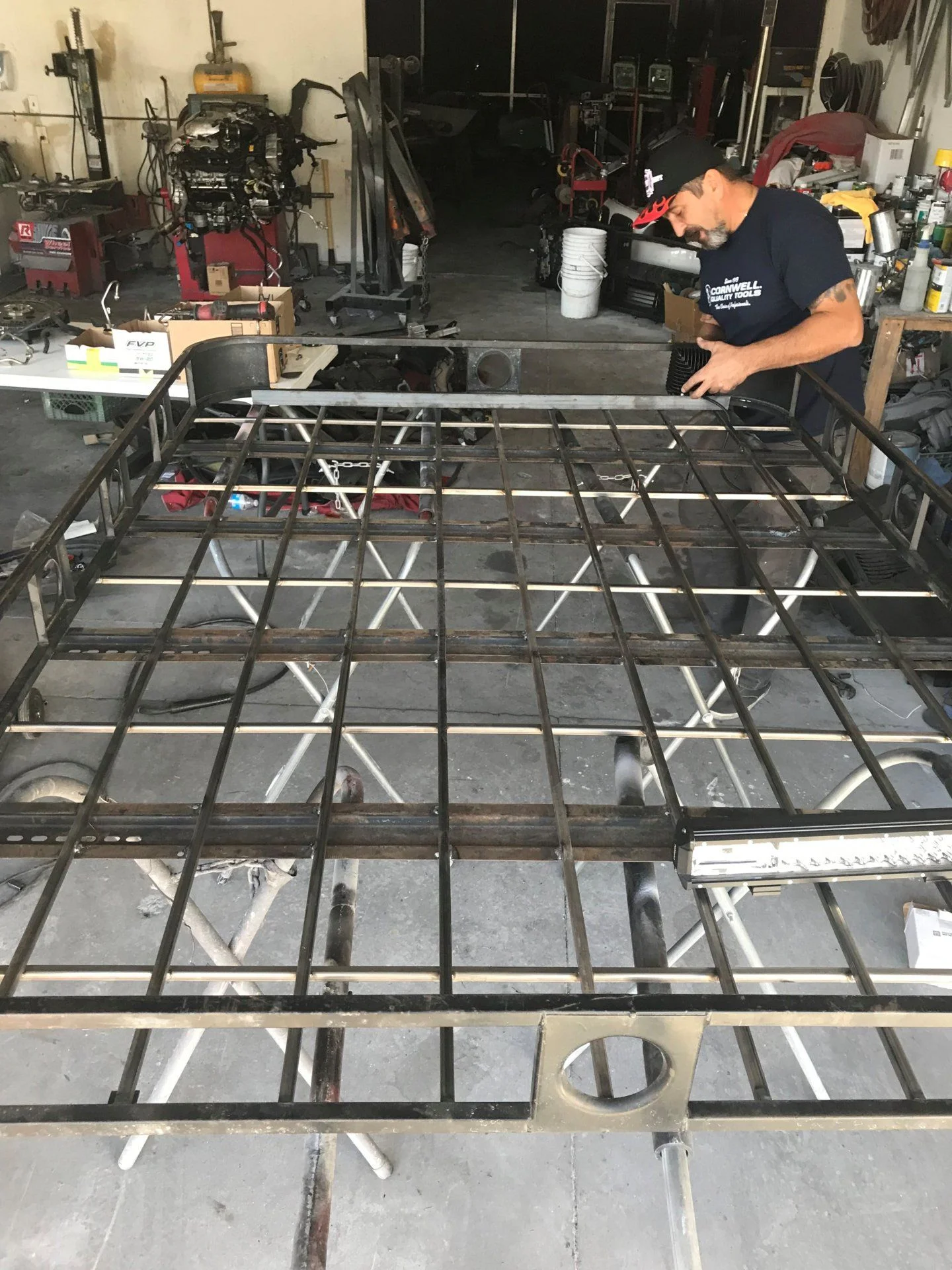

First update with pictures. Added nine full length pieces and five cross pieces from 1/2-inch square stock to "Beef Up" the rack. it made a huge difference and also straightened out one of the bent cross members. Also welding a light bar on the front and rear full width to install current lights. Also leaves me open to change out the lights easily in the future. Getting the rack ready to go to powder coating on Friday. Going with a finish that'll look slightly glossy black, with a silver color on the gutter mounting brackets.

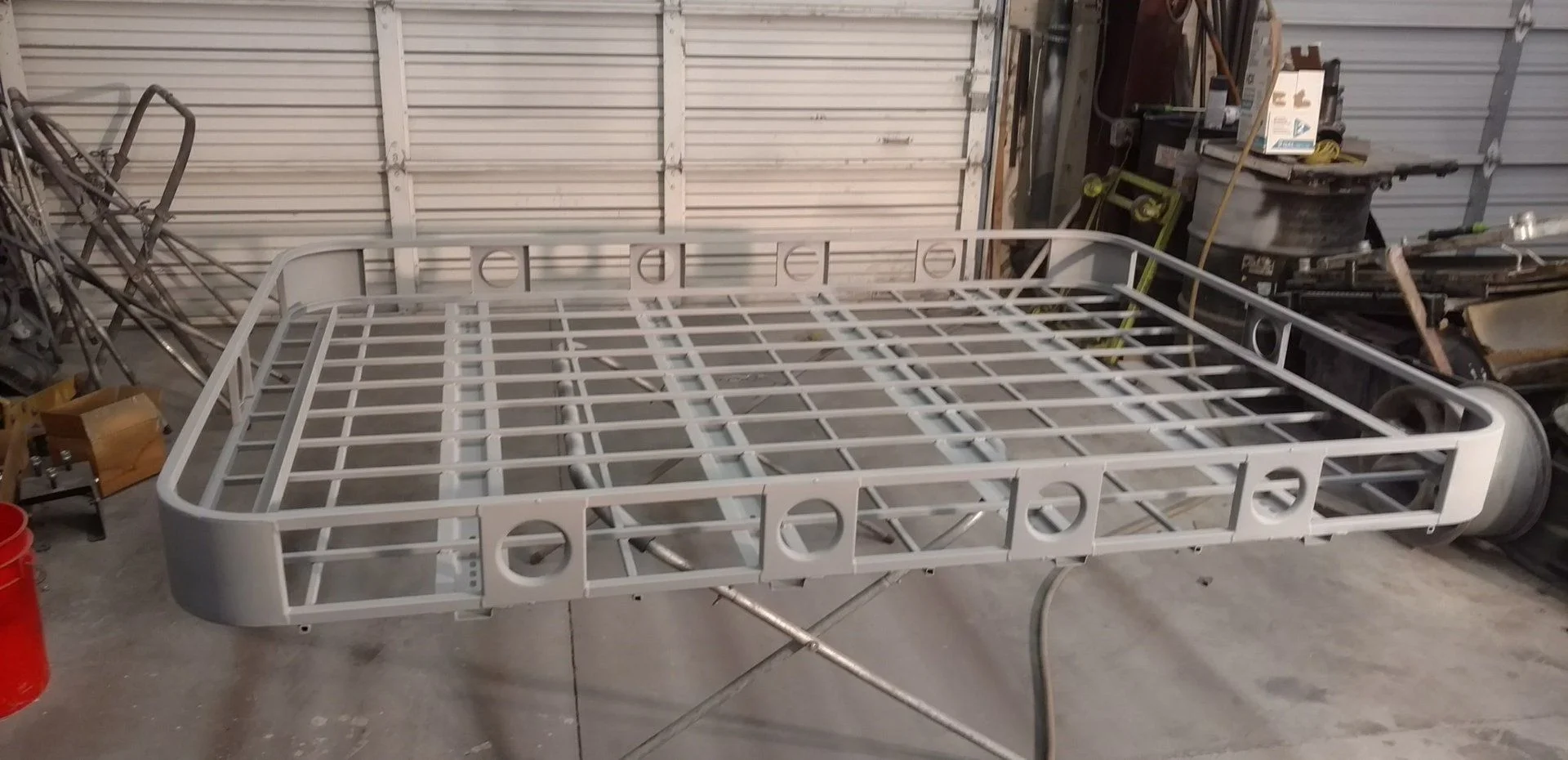

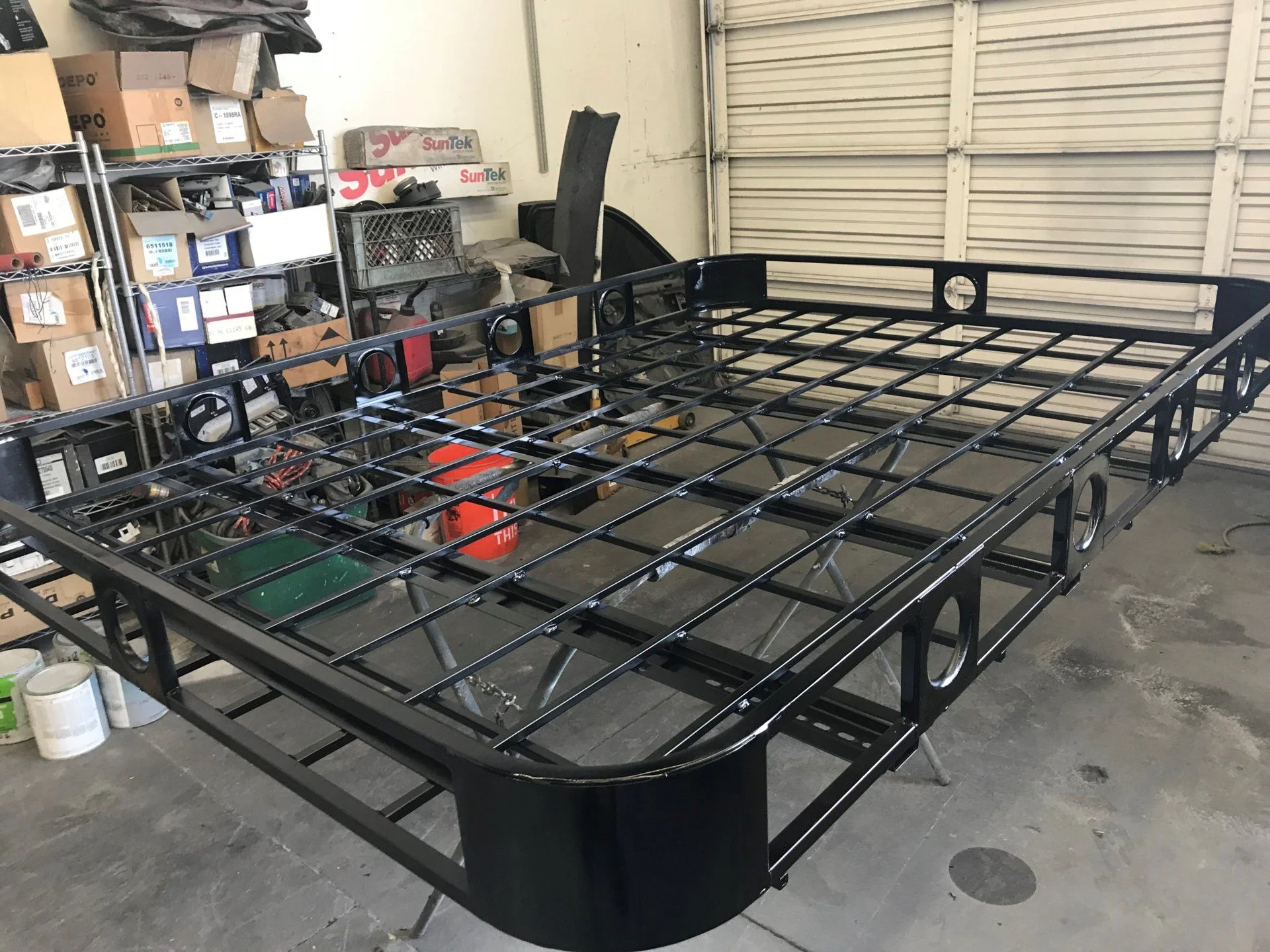

turns out that powder coating was pretty expensive, so decided to go with a good sanding primer and two paint coats. My older Con-ferr that's on the truck now has seen two years of Arizona sun so far with no problems and it wasn't pre-treated nearly this well before painting.
Painting the rack black, and the 8 gutter mounts (also original Con-ferr) will be flat silver on the lower portion that mounts to the truck and the rest of it black. Hoping to set off the clamps a little and echo all the chrome that came on these 62s.

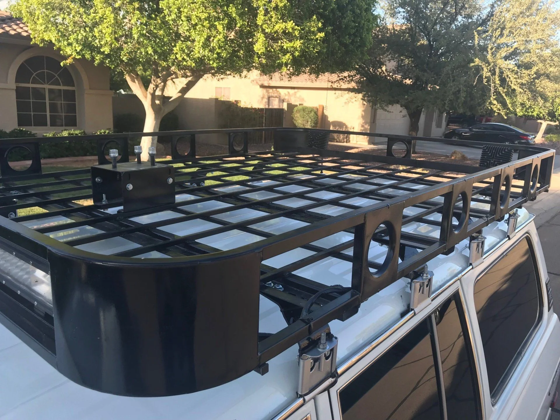

all painted now with holes drilled for lights front and rear. painted the top part of the old con-ferr brackets black like the rack but the lower two pieces that clamp onto the gutter mounts a dull silver as contrast. Fitting to truck now will post more pics when I get 'em.

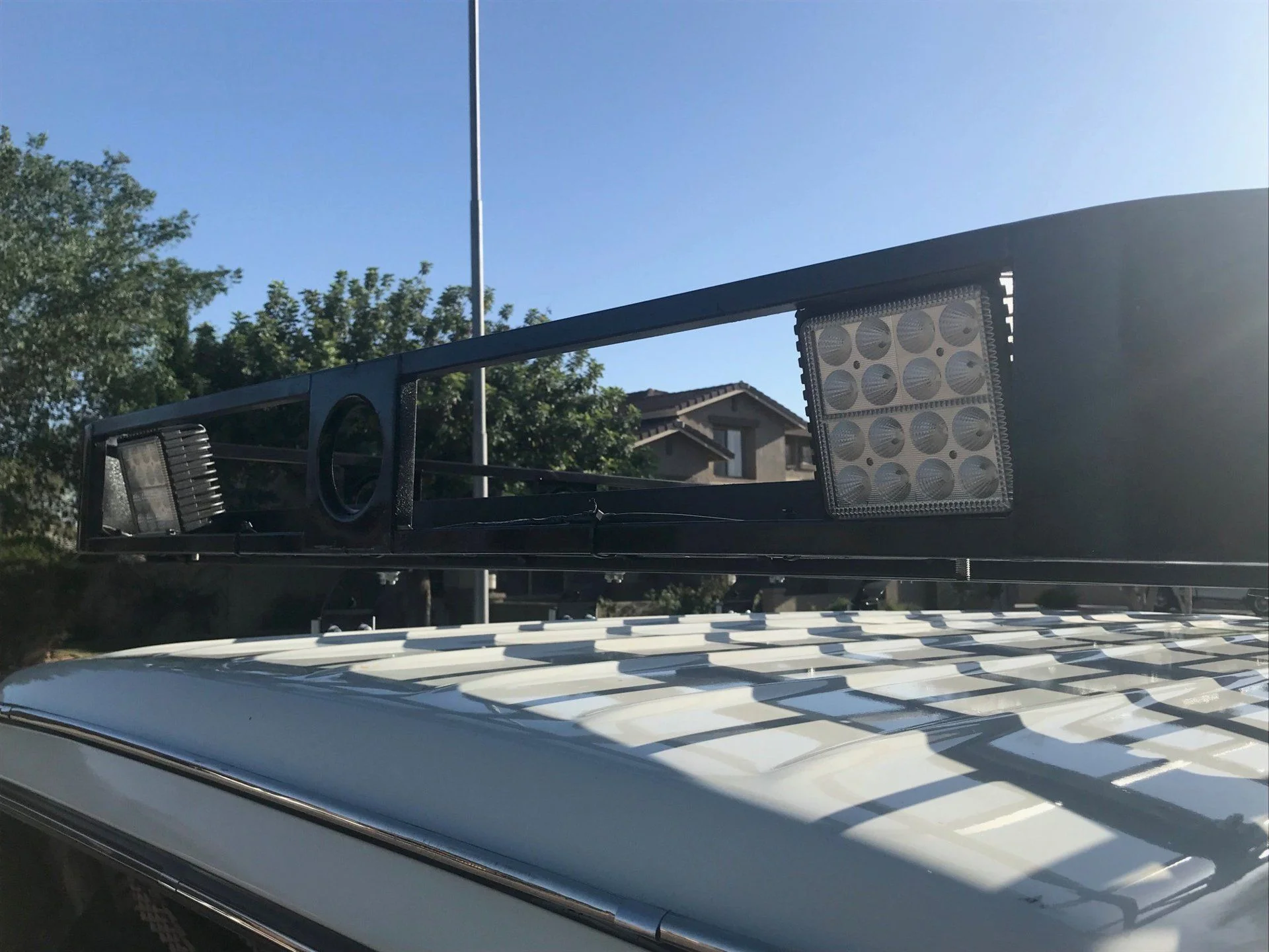

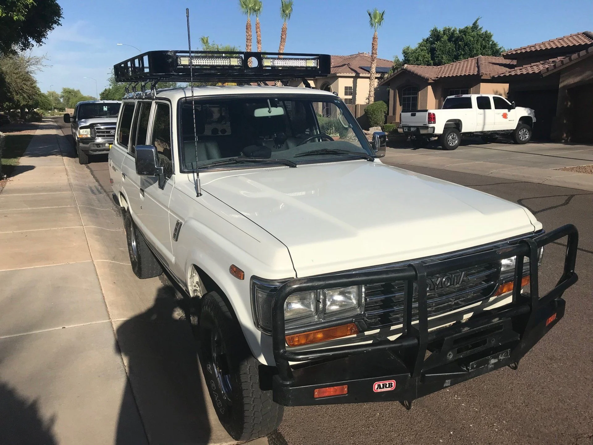

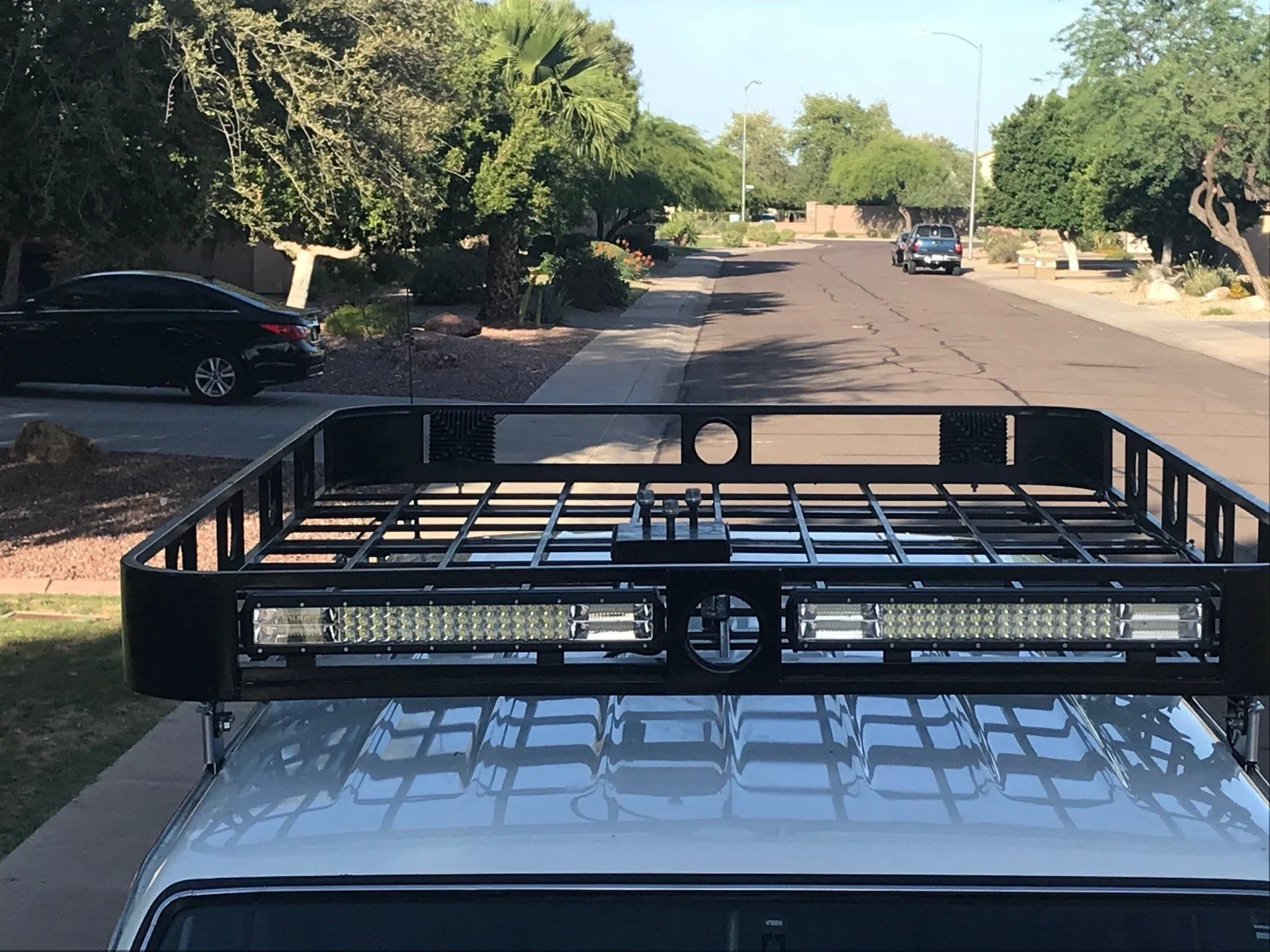

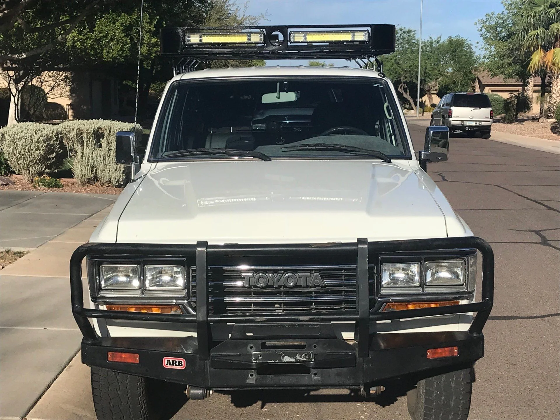

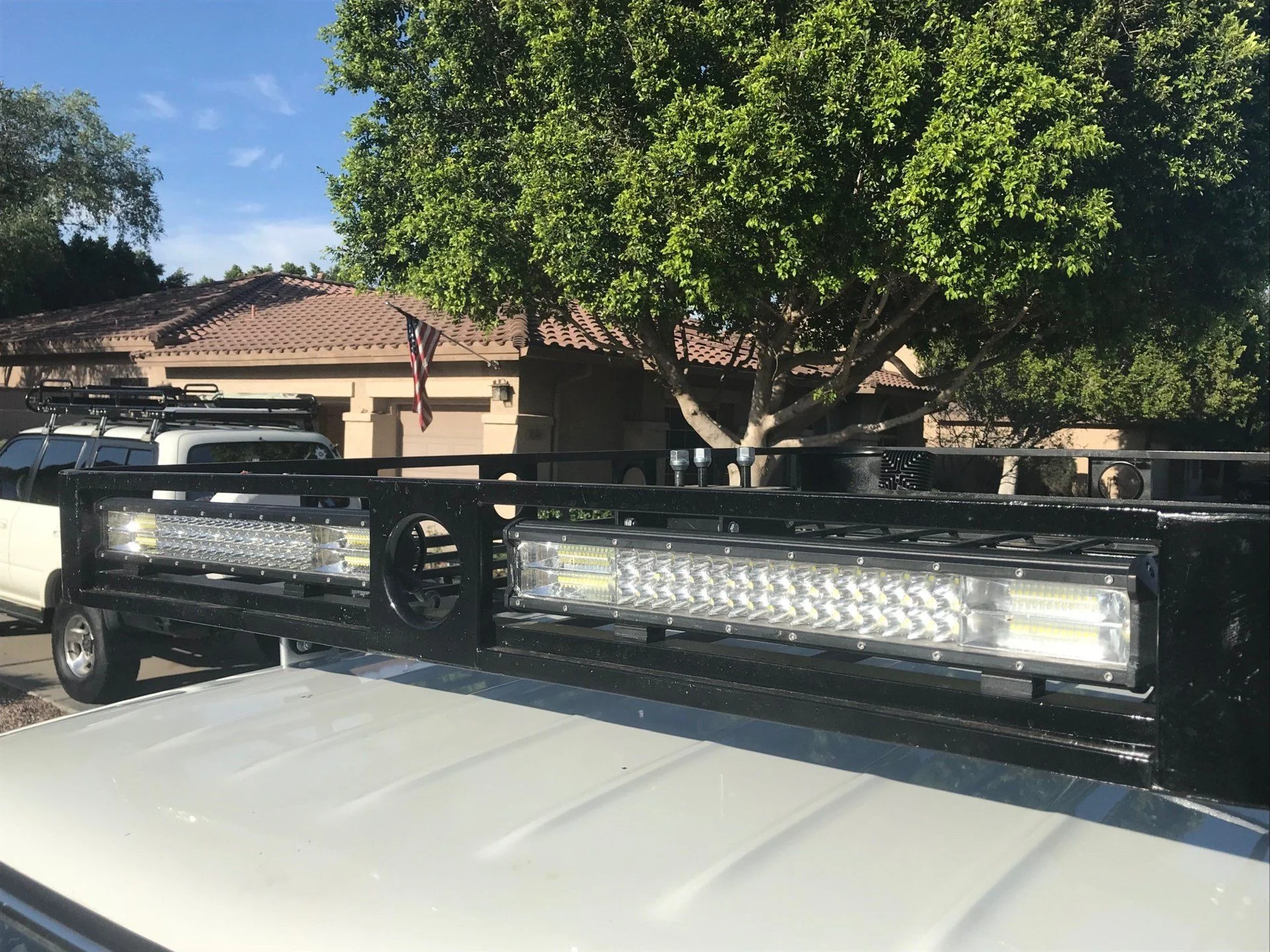

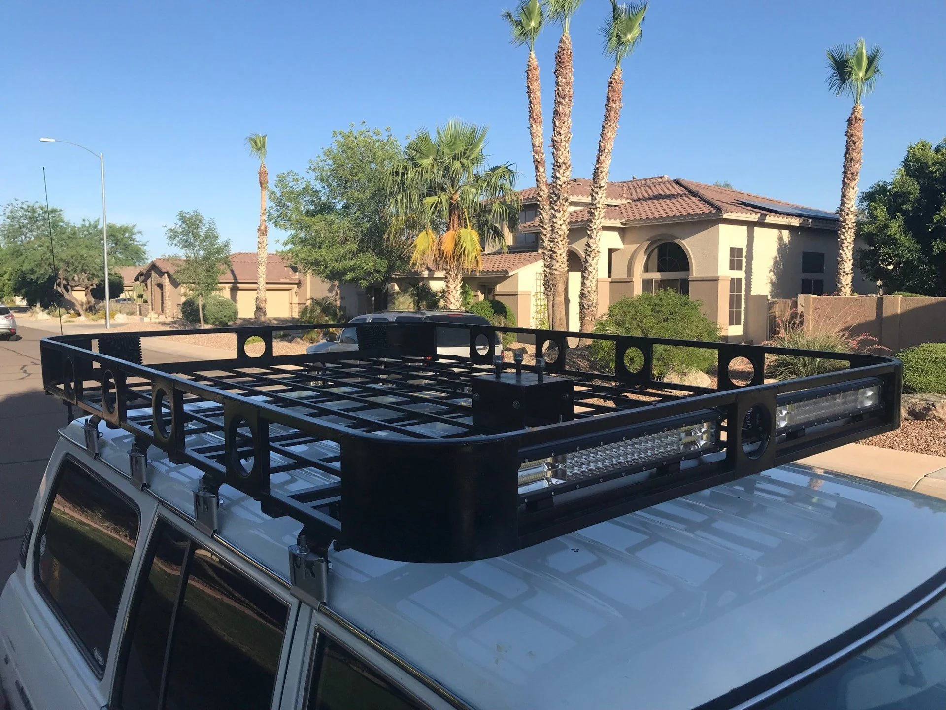

Rack is now finished and on the 62. Been driving around with it for two weeks now with no noticeable wind noise and/or rattling. shouldn't rattle as it's all welded on the rack itself. Lights are super bright with the two worklights in the back and the two modest 20-inch bars on the front. Went camping last week and it really lights up the woods. Pleased with it overall though I think it's now about a half inch too high to go into my garage. Thanks again to CSC's new South African member for a great rack that gave me a great starting point.
Nice piece of work on the rack. I like the old school type for the 60 series, have a Garvin Wilderness on mine. Like the Conferr better.
Mine is too high for the garage as well.
Very nice job! Good that you recessed those lights. I've moved aside many a large branch with the front of that rack. How are you running power to the lights?
I just yesterday remembered that the Gamiviti gutter brackets I had for another rack were a good inch and a half to two inches lower. They are the 30-60 degree ones for a 60 series that they still sell on their site. Swapped them out and WA-LA!, now it fits into the garage. The original Conferr gutter mounts that came with it instantly struck me as really high. Maybe lots of other vehicles in the 1980s, not LCs, had a lot more crown or curve to the roofline. I sometimes forget that con-ferr didn't just make them for our specific favored vehicle.
I love the front ones, they are 20-inch units that fit perfectly in a 21.5-inch space. Don't like the square ones on the back though. Probably will order two more of the 20-inch ones and put them in the back in the same way, just angled down more.
