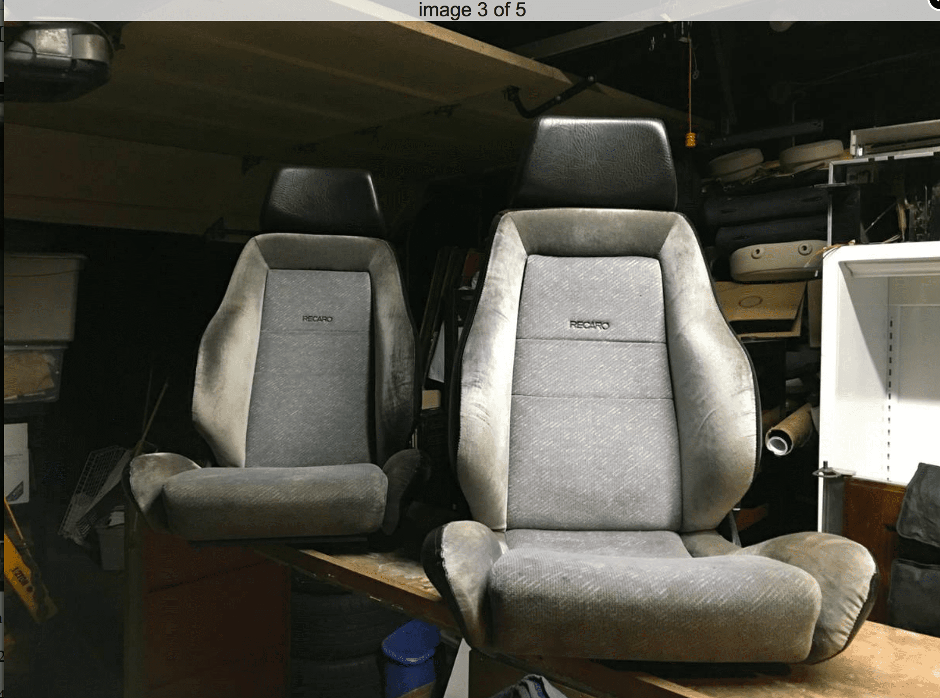

just picked these up on CL. will be ordering wedge brackets once I can pull measurements and confirm they'll work with these.
Found some 370Z seats locally at a decent price; going to take some measurements and see how they might fit in the next day or so.

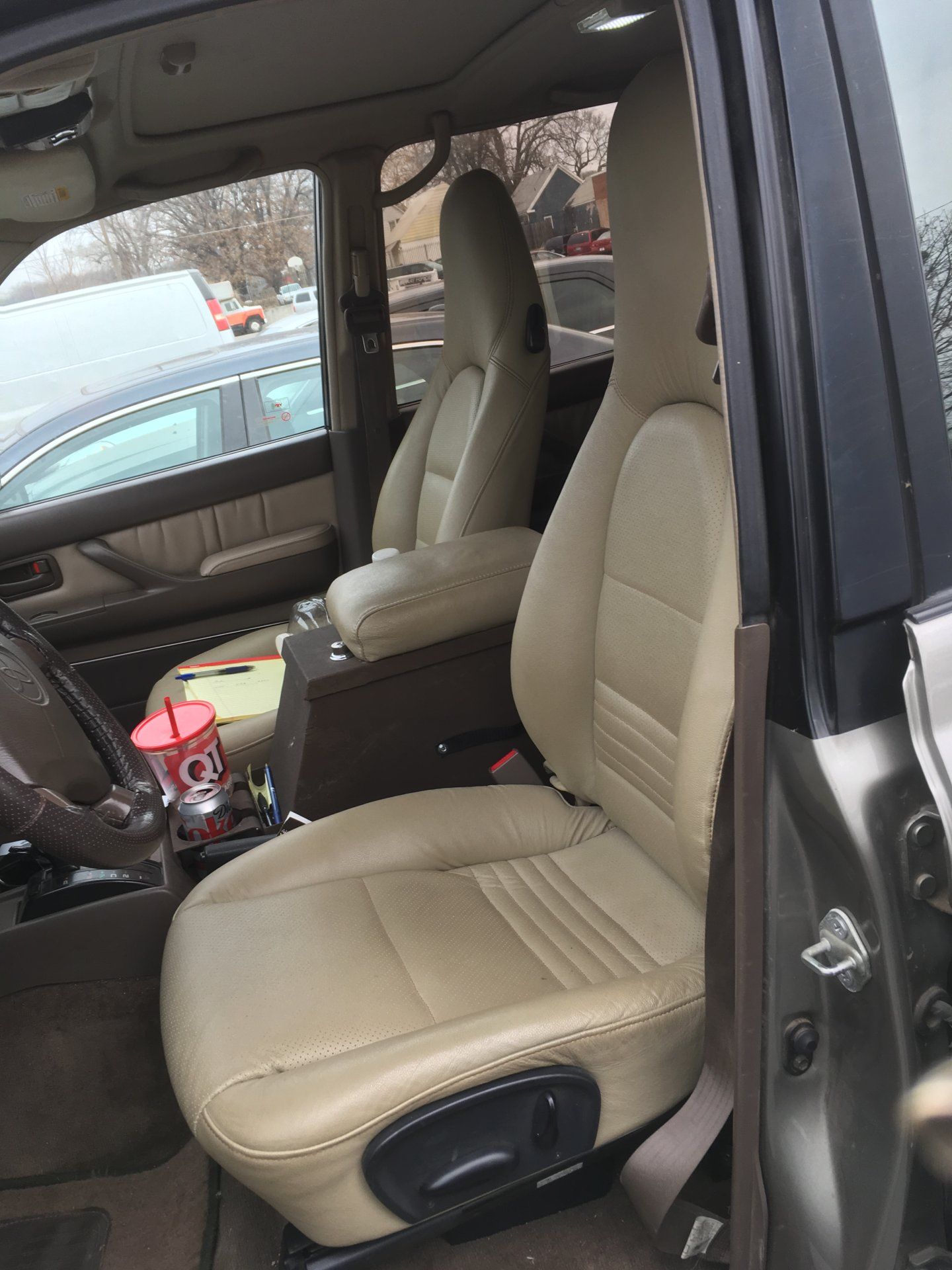

I have an 04 WRX I put race seats in, so decided to put those stock seats into my 80 (at least for my driver seat at the moment). They are really supportive and are heated, which I just straight spliced in and works. I used a Corbeau bracket for FJ80 passenger side, originally bolted it in with the provided slider but it was too high for my liking - currently bolted directly to the bracket using L brackets I cut and drilled to size.
It feels great and i'm stoked to try it on long trips - it leans slightly to the right which I'll fix shortly along with putting in the passenger side.
Pic is before I removed slider so its about 2 inches lower

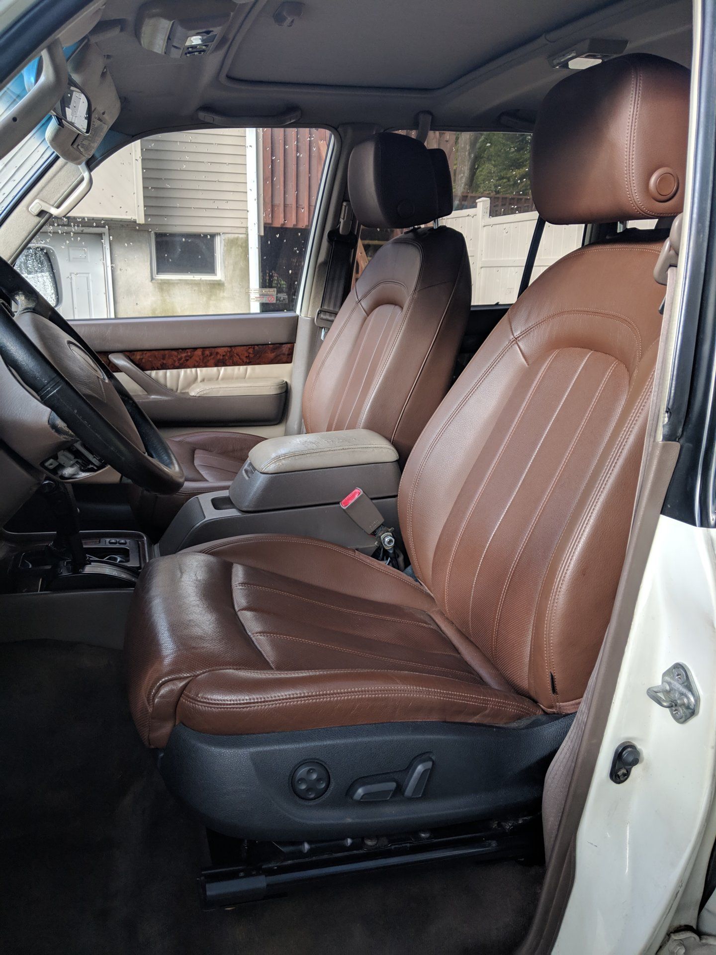

I installed front seats out of a 2013 Audi A6 and I'm very happy with them. The movement is fully functional on both seats, but I haven't hooked up the heating and ventilation yet. You can see the discussion thread here.

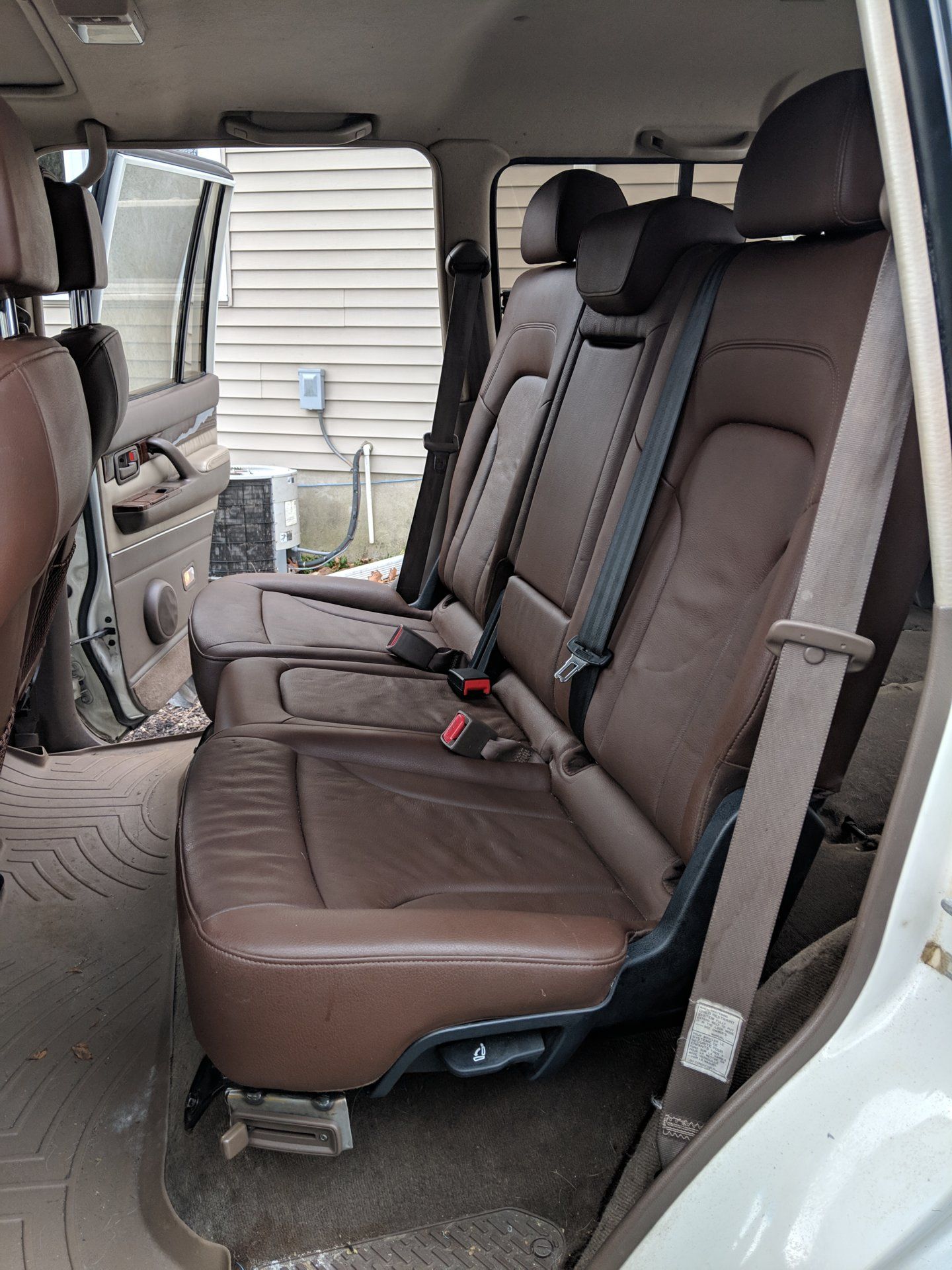

I installed some Audi rear seats, from a Q5, into my LX450, to match the Audi front seats that I had installed previously. They offer much more adjustment than the stock seats, and a shoulder harness for the middle seat. The discussion thread, with a link to the build process, can be found here
Good to know about the rear seats. I'll make sure before I buy them with the fronts.
