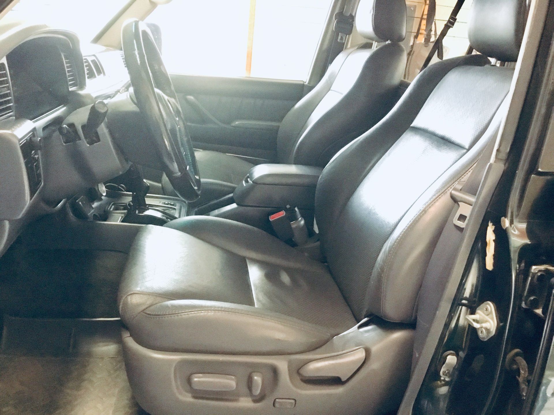

Seats from a ‘06 Toyota Solara. Perfect color match. The drivers seat is fully adjustable, passenger side is manual. :princess: loves them!!! View attachment 2112925
Also installed a steering wheel out of a Toyota Matrix. I don’t think i’ll be able to hookup the air bag though. But hey, myFJ60 never had one to begin with!
Nice to keep it all Toyota
How much fab work was involved with the solara seats?

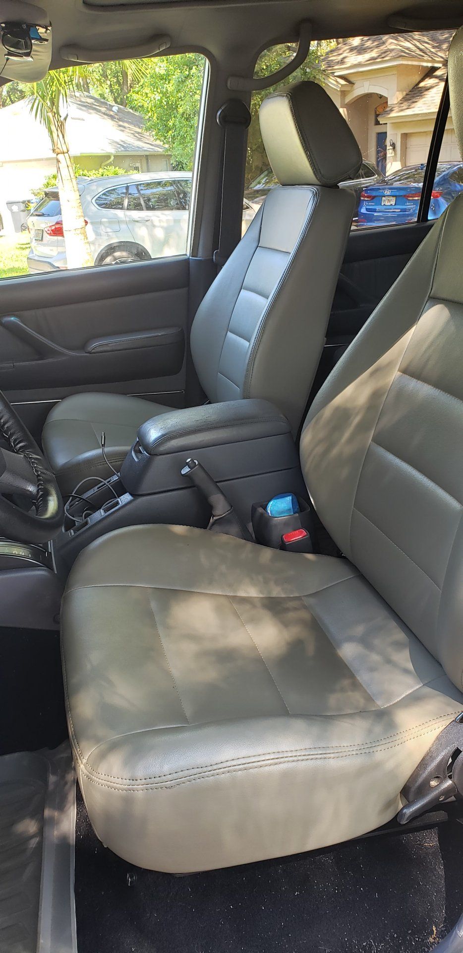

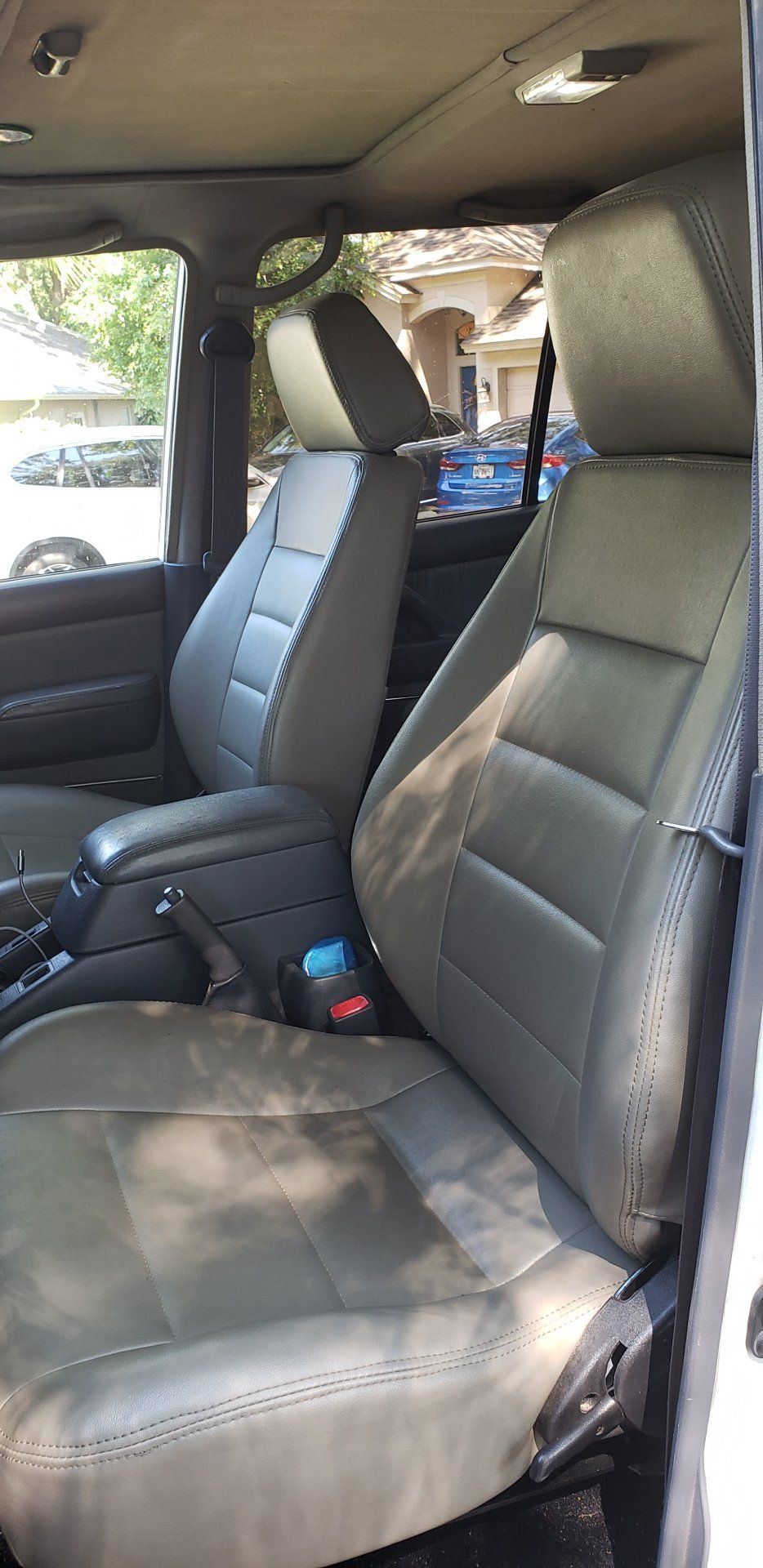

CORBEAU Sport with Planted seat brackets.
I'm running a 1/2in spacer to raise them a little bit, they feel perfect to me.
Pretty much plug and play? Any odds and ends?
I deleted the rear heater a while ago, so idk if the bracket clears the heater.
The 1/2" spacer gives just enough clearance for the Corbeau slider lock bracket to lock/unlock the foward/backward mechanism.
Other than that, yes it is pretty much plug and play.

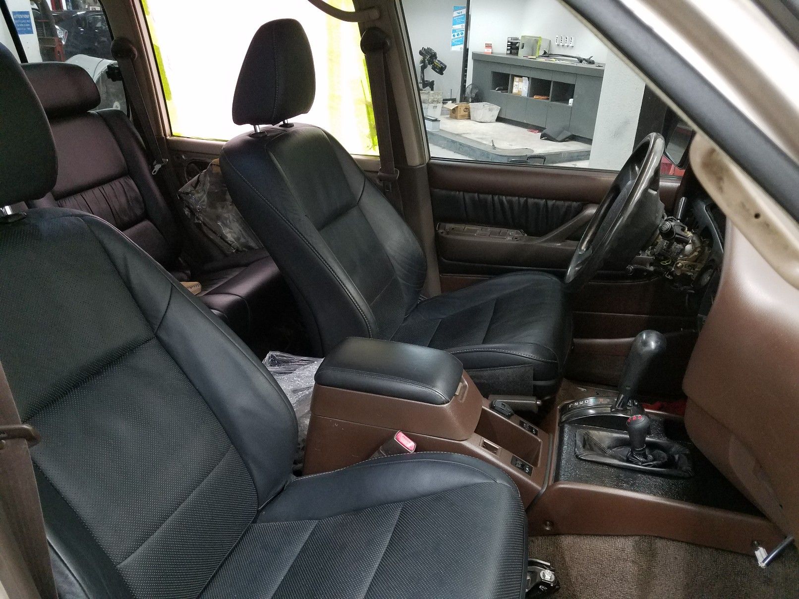

Here are Lexus seats with heating and cooling...
what Lexus? What year? How did the install go? What kind of adapting did you need to do? How much did you have to mess with wires? Separate power source?
they look great btw, are you happy with them?
They are from a 2013 es350. The installation was difficult, it's all custom. Wiring was the toughest part. I had to make the seats work without a lexus body ecu. I'm happy with them. It's an extremely comfortable ride now. Driver fatigue is almost non existent. They slide back enough to fit a person thats roughly 6'5 or so to be comfortable. I have 2 full weekends into bracket fabrication. Wiring was very time consuming to figure out.
