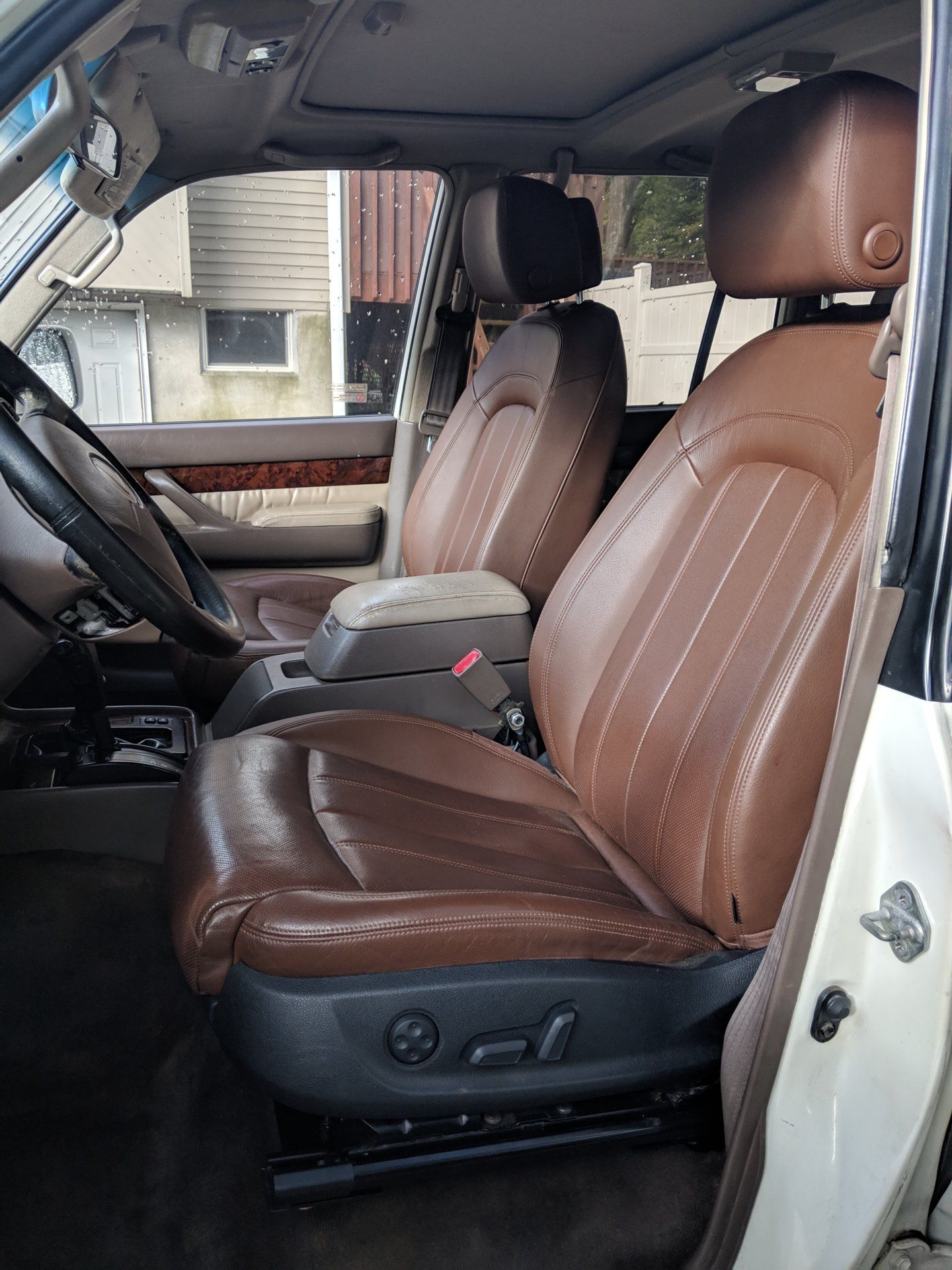

Why did I replace my OEM cloth seats?
Because they hurt my back.
The used Audi seats are way better suited to me. Adjustable lumbar, heated, larger butt pad and they are shaped like a normal human.
Some car seats and lots of chairs in general are like concave in the back. I need support or material in the lower back area. The Audi seats have that.
I can drive long hours with so much less discomfort and less soreness the following day. So worth it, for me

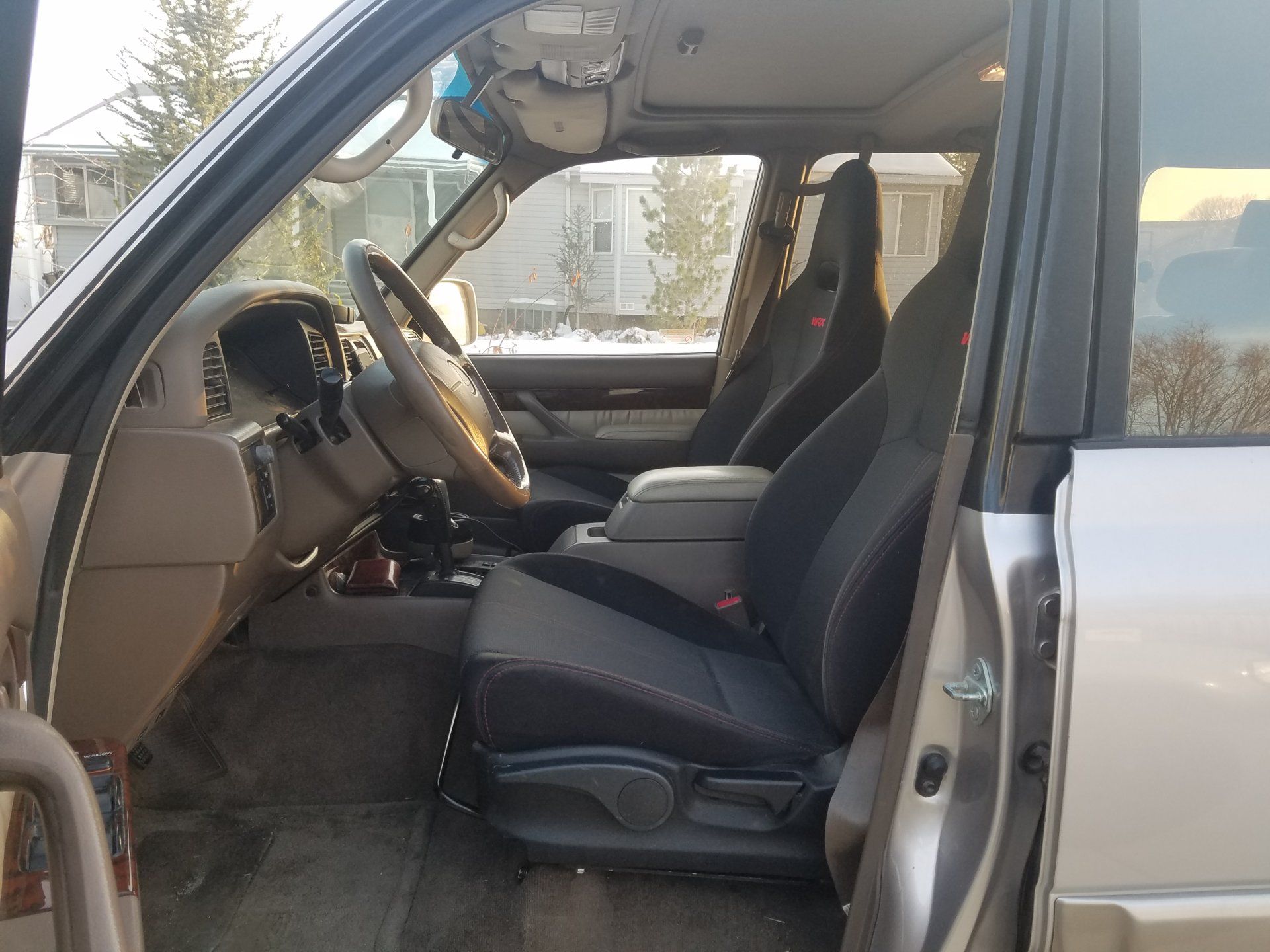

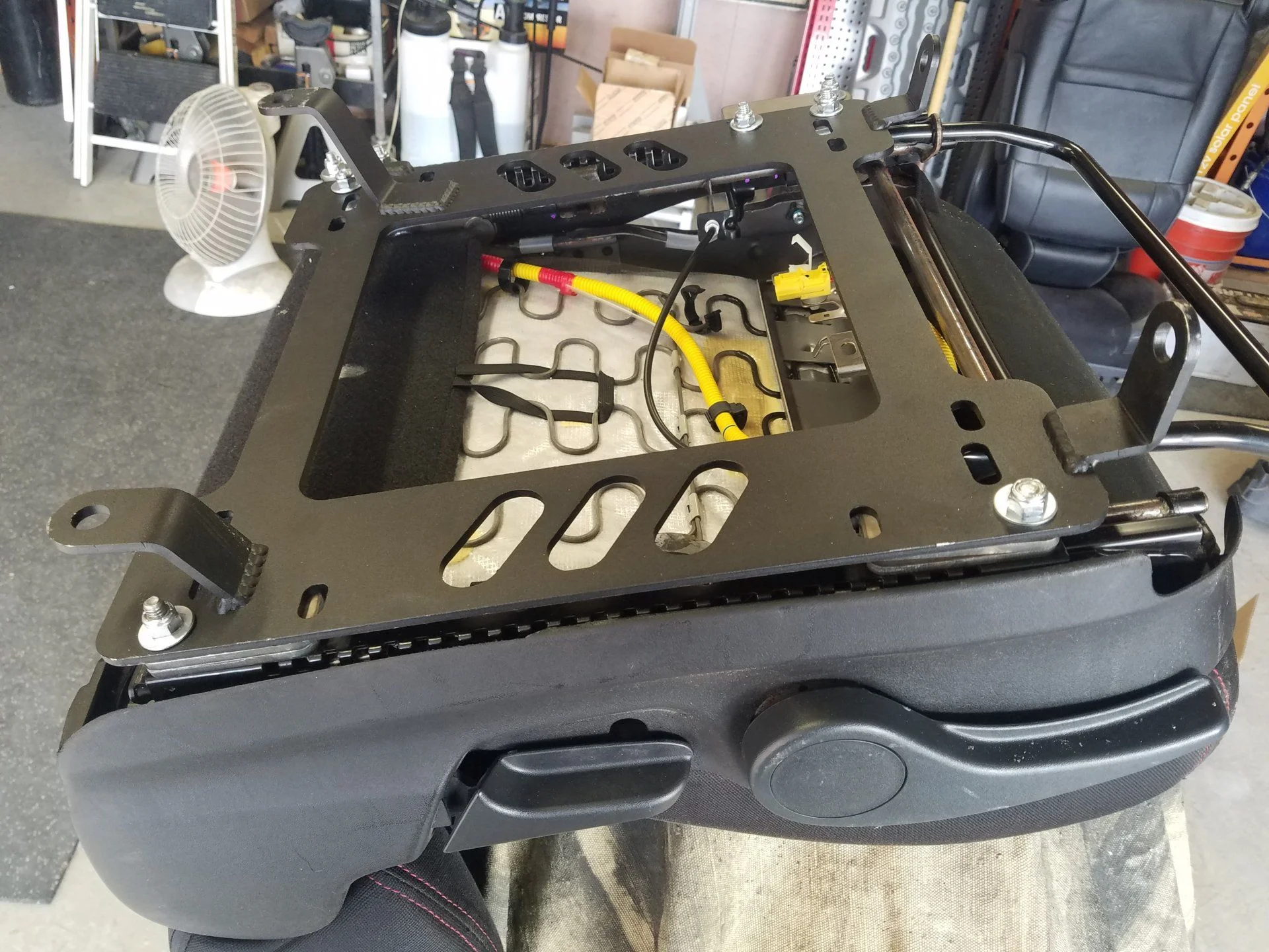

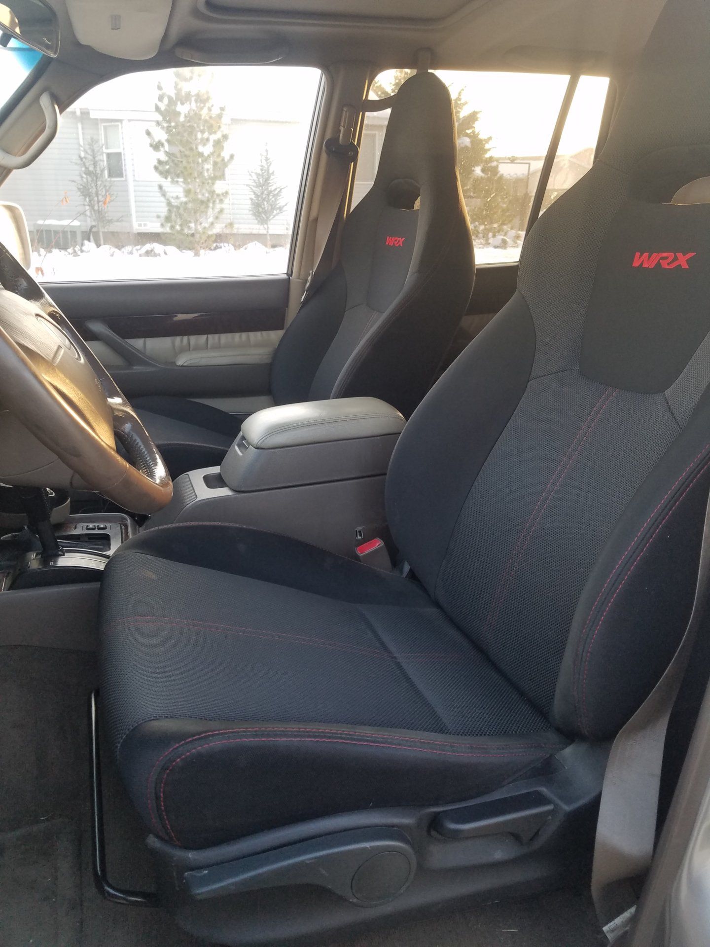

2012 Suburi WRX Seats with Planted brackets and some custom cut plates to make it a mostly bolt in deal...no welding required, just a bunch of drilling.

That's a slick setup. I like it.
I am super happy with the result.
Manual also.
Yes they are, I specifically wanted manual seats...bonus is they are significantly lighter which makes moving them around less of a chore.

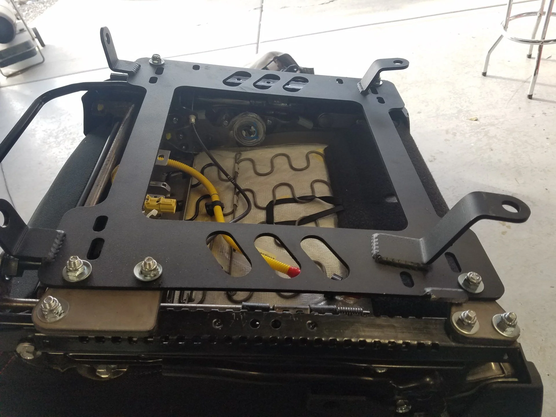

Any pics or info on the plates? I have WRX seats and planted brackets that have been laying around, waiting on a welder and time.

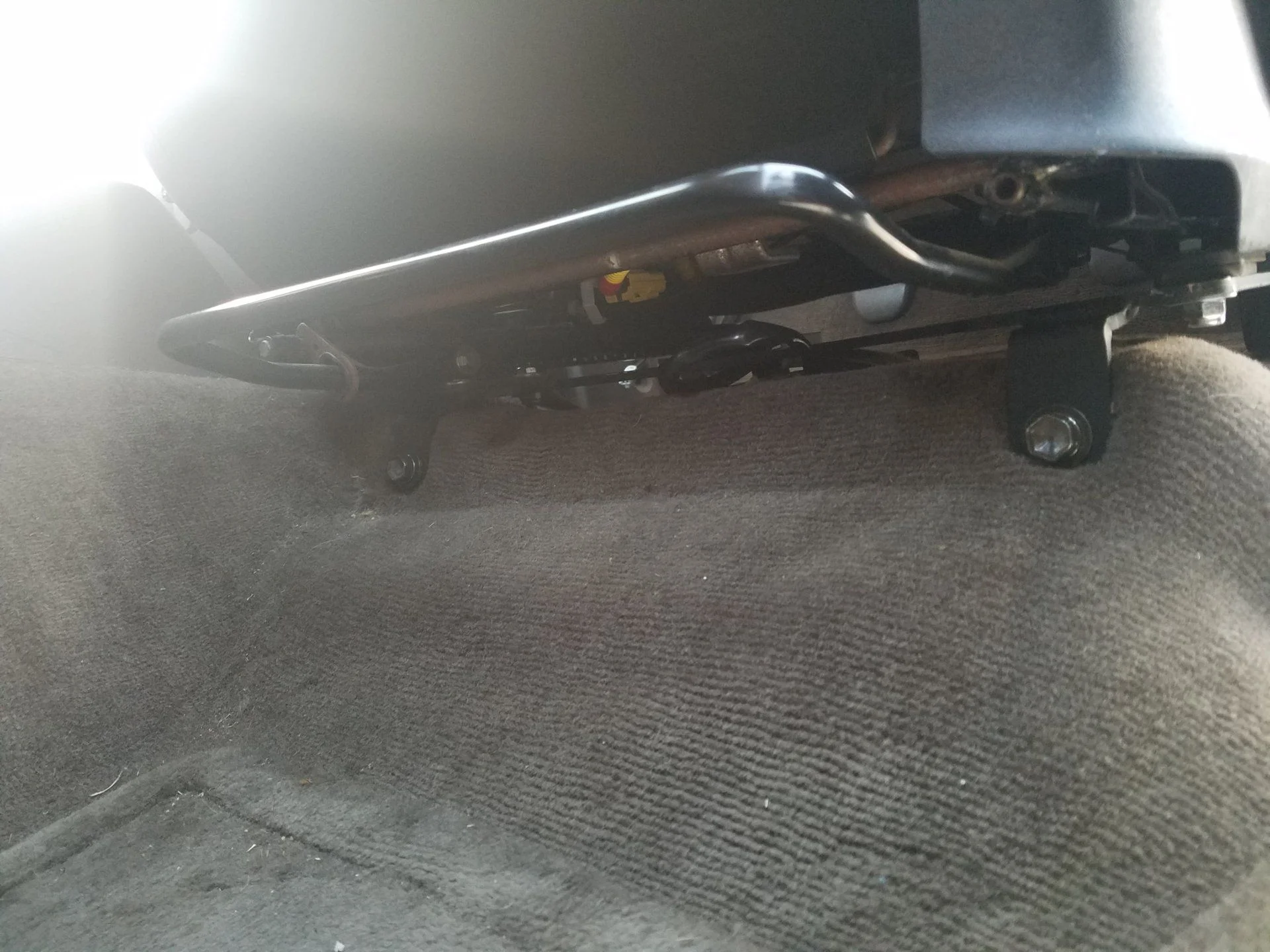

My friend @bryson and I did some cardboard engineering about 2 months ago to layout the bracket shapes and then another local mud number with a fancy plasma table translated those pieces of cardboard to nice 3/16" plate brackets. Everything then bolted together with 5/16" hardware...no welding required.
I will also note that I was able to use the factory toyota/Lexus seat belt buckle with a slight modification and a spacer....easy peasy.

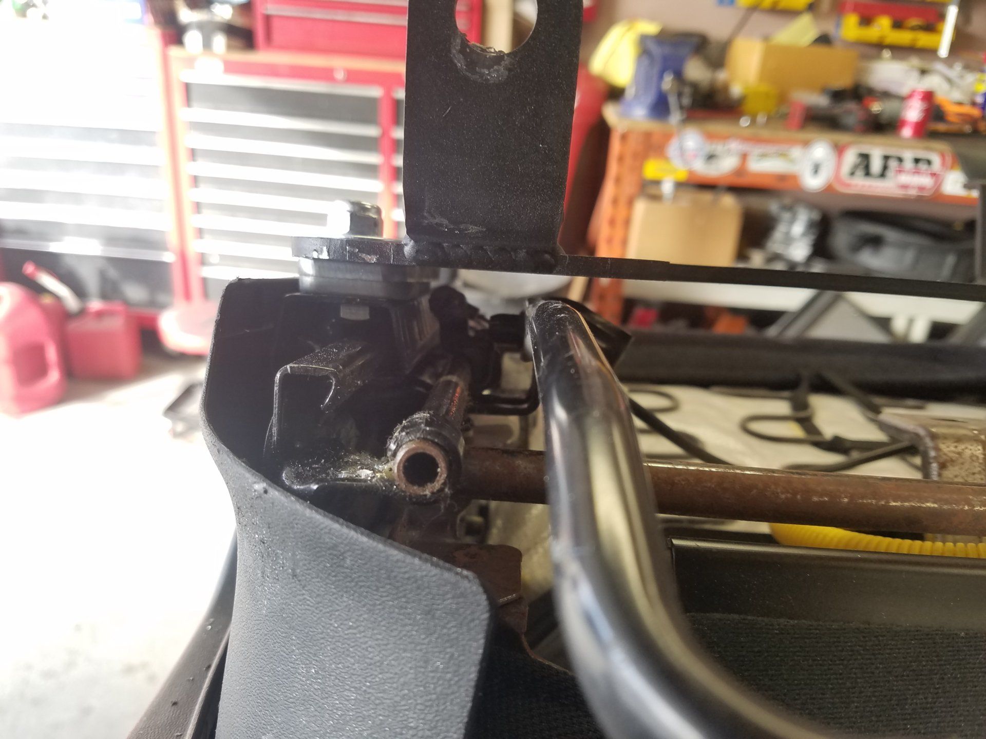

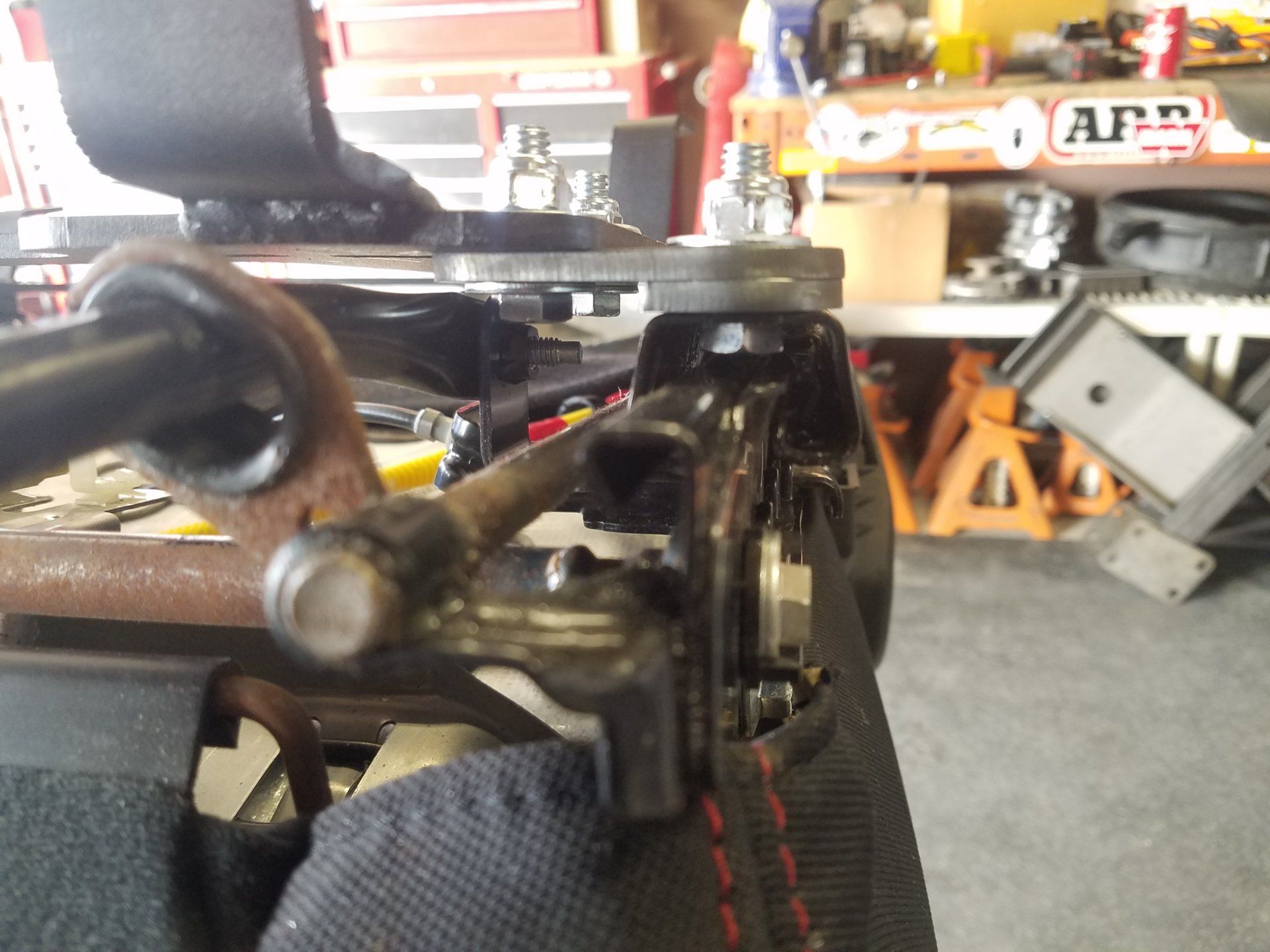

I just installed the procar elite seats in my 80 with the planted brackets. I went with these after two failed attempts with other seats. One CL find and some Audi A4 seats that I couldn’t figure out how to make work. These turned out ok but they werent the plug and play I had hoped for. The brackets fit the 80 perfectly but the seats didn’t fit the brackets without some modification. After a few hours of measuring, cutting and drilling they are in and they are a big improvement over my old seats.

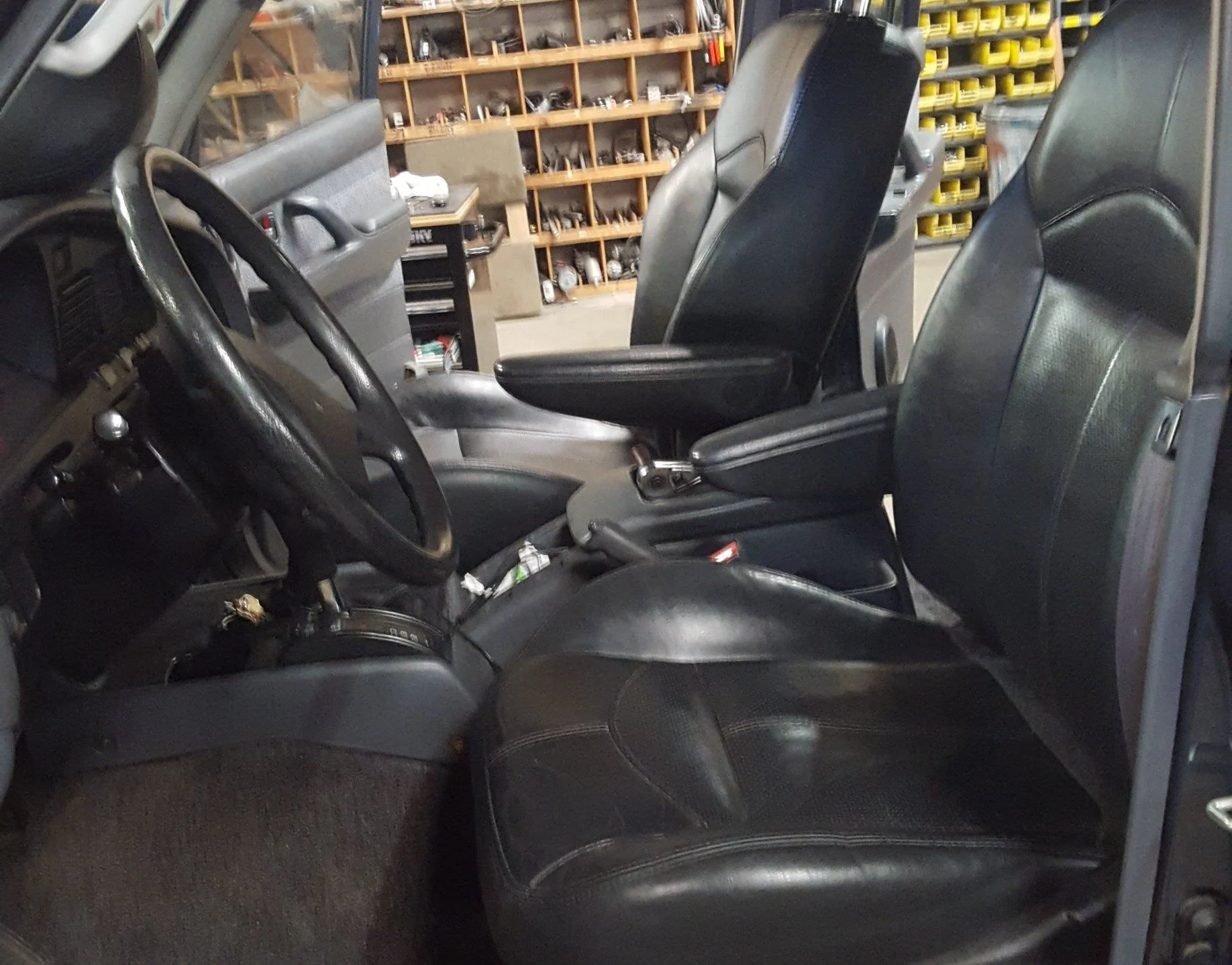

I just installed 2004 PT Cruiser seats w/ arm rests. The seat rails are only ~1/2" wider than the OE seat rails. Easy enough install if you have access to a welder. $40 bucks around here in the pick n pull yards & MANY PT Cruisers to choose from.
