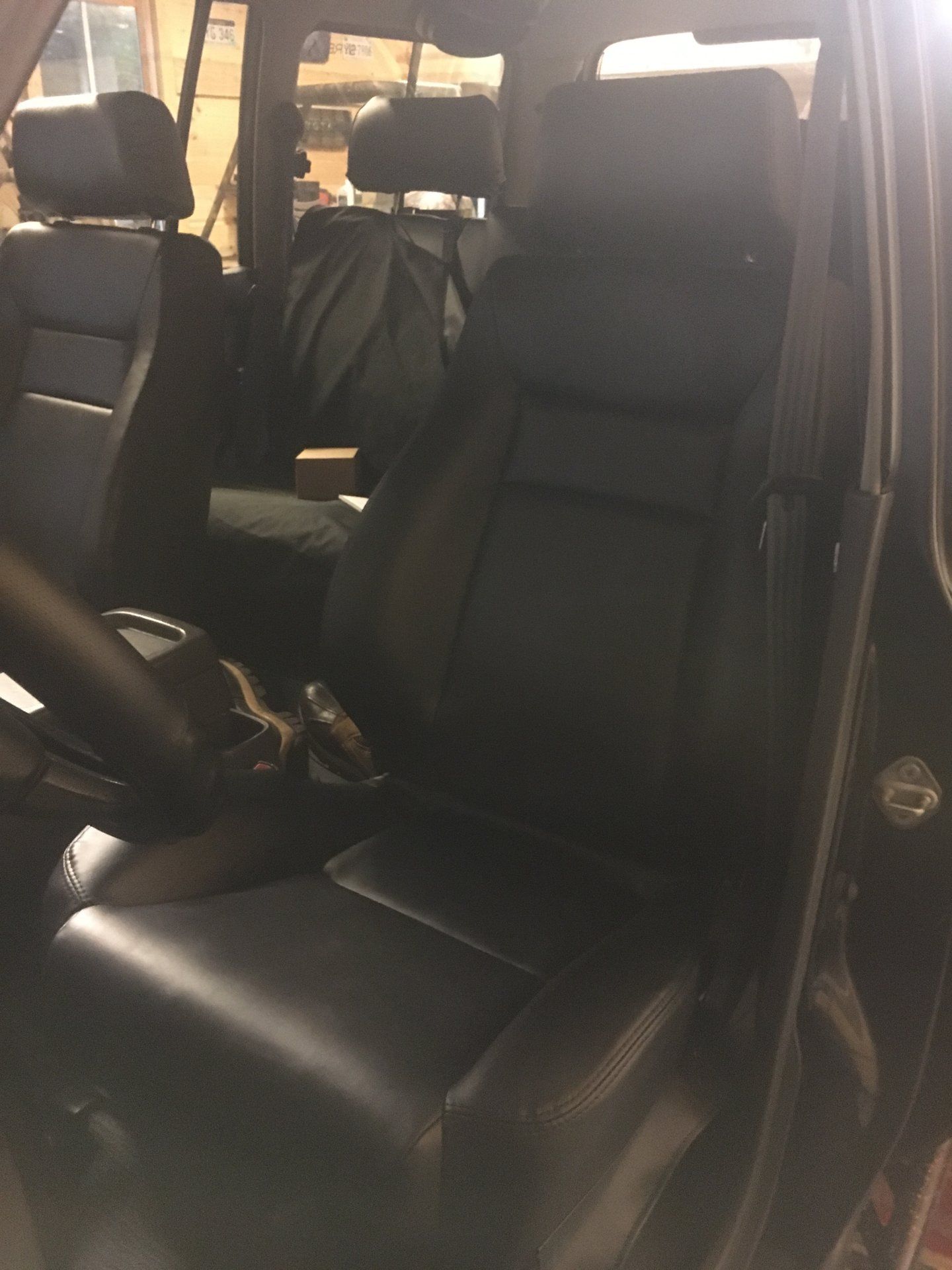

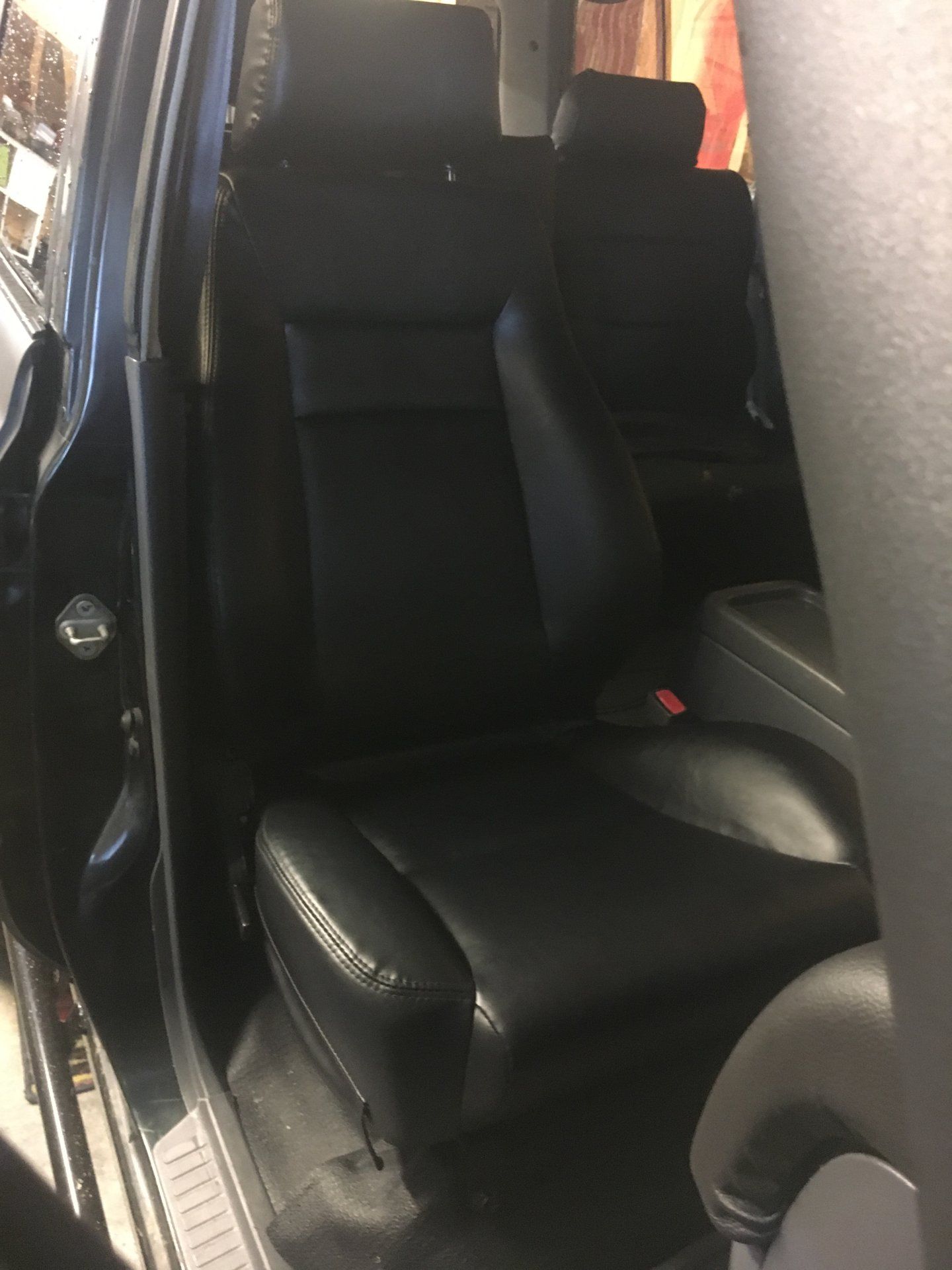

I just installed the procar elite seats in my 80 with the planted brackets. I went with these after two failed attempts with other seats. One CL find and some Audi A4 seats that I couldn’t figure out how to make work. These turned out ok but they werent the plug and play I had hoped for. The brackets fit the 80 perfectly but the seats didn’t fit the brackets without some modification. After a few hours of measuring, cutting and drilling they are in and they are a big improvement over my old seats.

I looked at every aftermarket seat out there and these looked like the best option for the price for me. They are comfortable, fit the space well, and they had good reviews. The only drawback for me was the slider had a 90* mounting bracket that I ended up cutting off. It just added some extra work I wasn’t planning on. Overall they look great and are comfortable. Time will tell how well they hold up but my 80 isn’t a daily driver so they should last for a few years.

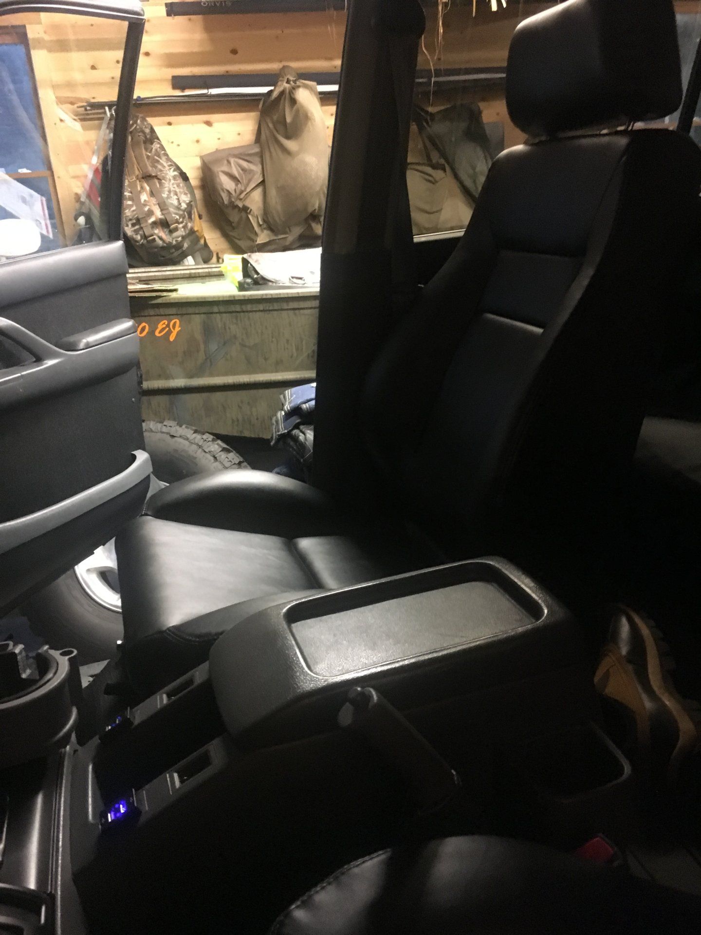

I got these and they fit the 80 perfectly. I did have to drill a couple of holes to get them to fit my seats but other than that they worked well. Planted Seat Bracket- Toyota Land Cruiser 80 Series [J80] (1990-1997) - Driver / Left
