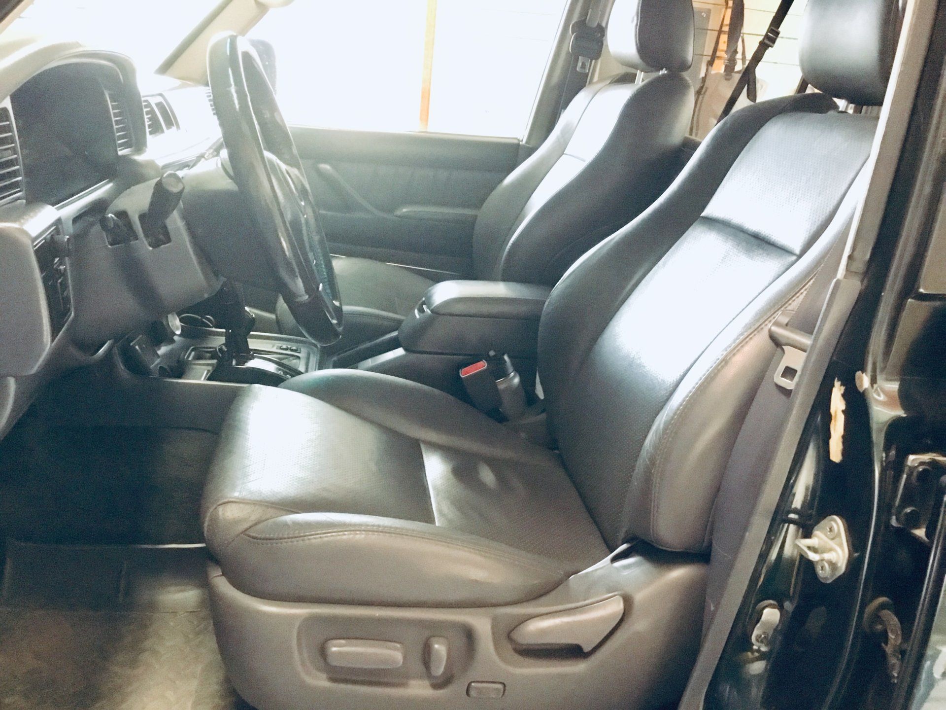

Not a cruiser but I picked up another set of 2011 VW Golf seats (same as the ones I used in my 80) and installed them into my sons minitruck. The ones I put in the 80 are leather, these are cloth. But both seats are heated with power recline (although the recline is useless in the reg cab minitruck. I've been really happy with these VW seats. Very comfortable and supportive, and not terrible to make work. Not sure if a Planted bracket will work with them or not but I would guess it would. I built custom brackets for both sets.
Cloth ones in my son's truck.
Seats by Adam Tolman, on Flickr
leather ones in my 80 posted earlier in the thread.
IMG_4225 by Adam Tolman, on Flickr
Any OCD issues with seats not matching the interior colors? Mine would go through the roof.
No OCD here. Besides there's black on the dash. I'm also replacing the carpet with black carpet and recovering the second row with black leather to match as well. Slowly redoing the entire interior so no biggie.

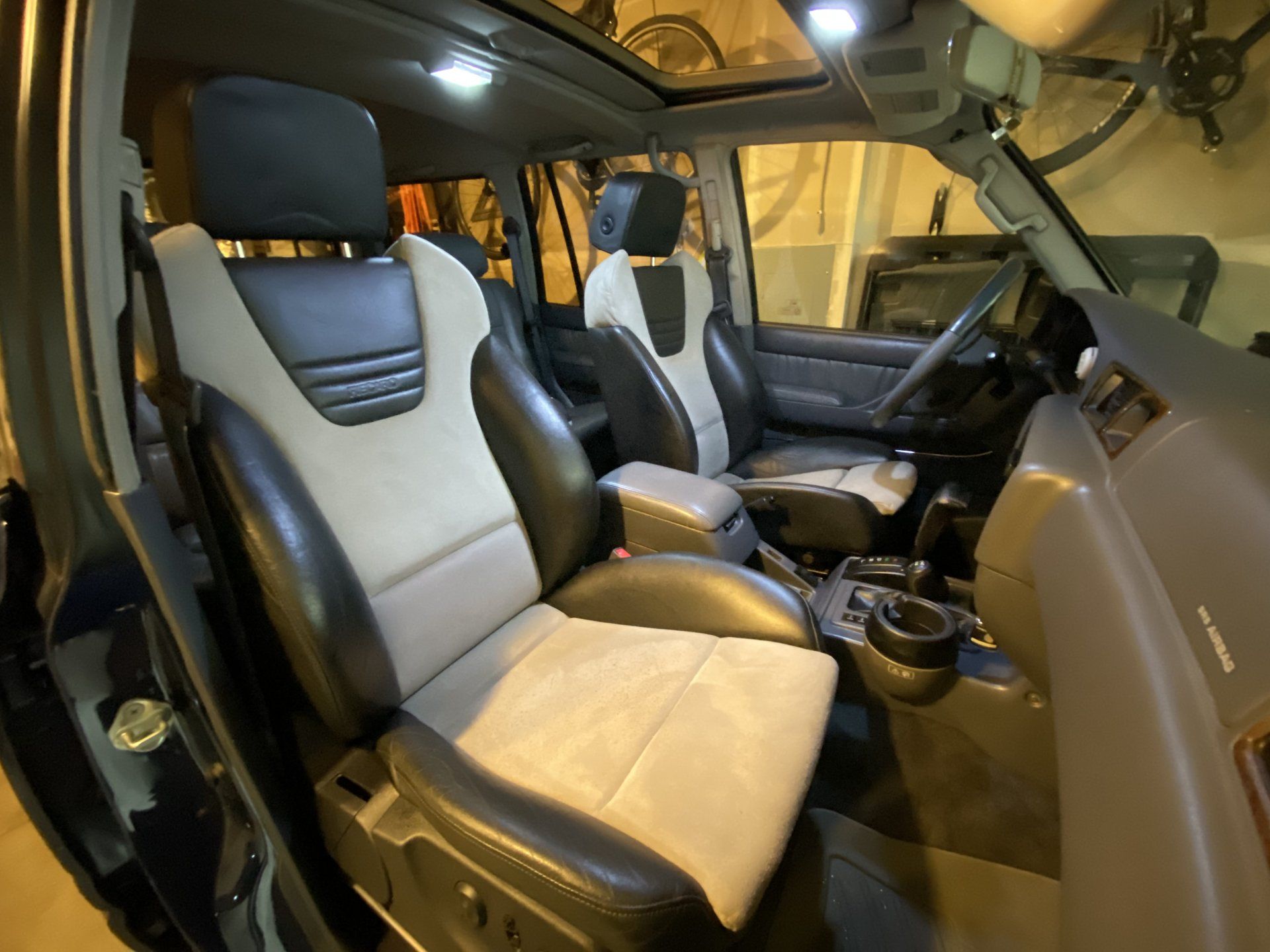

I just put some WRX seats in my 96’ LX a few months back.

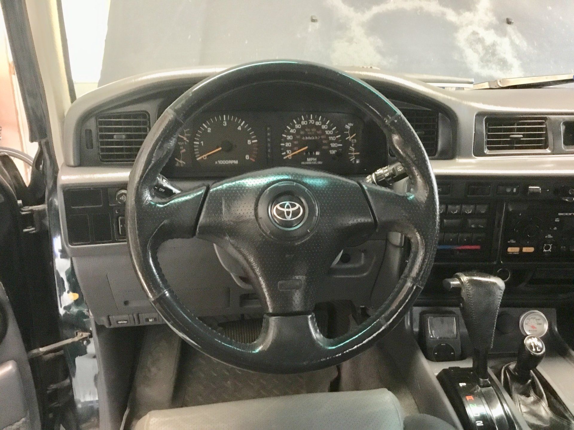

Seats from a ‘06 Toyota Solara. Perfect color match. The drivers seat is fully adjustable, passenger side is manual. :princess: loves them!!!
Also installed a steering wheel out of a Toyota Matrix. I don’t think i’ll be able to hookup the air bag though. But hey, myFJ60 never had one to begin with!
Nice to keep it all Toyota
