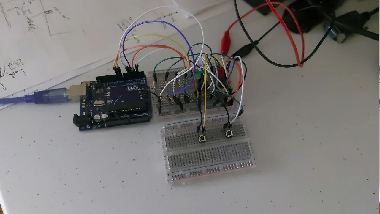

Inspection of the flasher wiring diagram revealed all, and I have been working on putting an Arduino together for this. Progress so far it that I built a Toyota flasher relay simulator and have connected up an Arduino to it and I've been busy writing code. The main target was to leave the vehicle system as close to existing as possible, and in such a way that should the Arduino or any of the other components fail the indicators would still work exactly as they did before the addition. Based on the way I have been able to do the design, that goal has been achieved. It picks up just 4 wires (plus positive and negative) for the whole system to work. The end product will be about the size of a matchbox, so it will locate anywhere I like.
Well, last night I finished the code. I have a couple of components on the way, and in the meantime I'll be designing and building the signal conditioning board, ready for when the other components arrive.
This is the simulator and the Arduino board all wired up.
Once I get the SCB made it'll be a lot tidier (I expect 🤞)

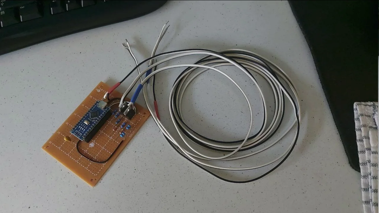

Update on this flasher project....
As you know the code is done (for the testbench unit).
I've built the signal conditioning board and installed the Arduino. That's all tested on the bench too.
I've found a business that supplies Toyota connector shells and the pins. I have flasher harness and relay connectors ordered and I'll be picking those up next week. That will make installation very simple, just unplug the harness connector from the flasher relay, plug my new 'bridge' connector in and plug the other side of the bridge back to the harness. I think I'll run the wires out to the project through a 6-pin Deutsch connector. That way I can easily run an extension out so I can troubleshoot if necessary, otherwise it'll be a short cable and tie the project up around the harness in that area.

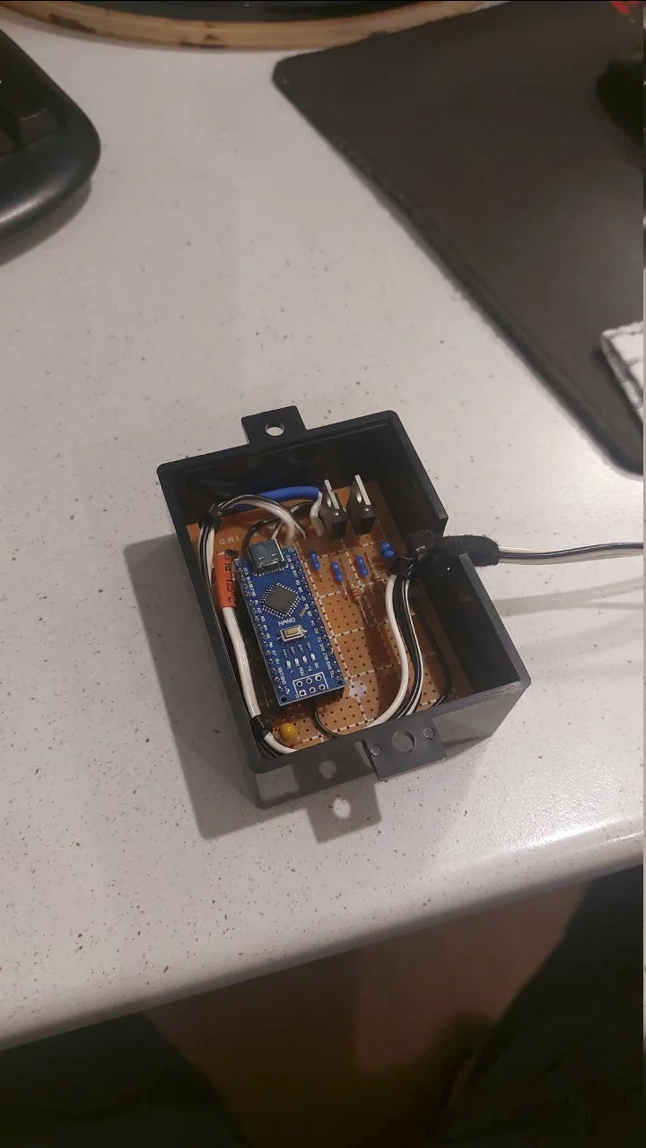

Update.
Unit installed into a small project box with a 1m wire tail (for troubleshooting, if necessary)

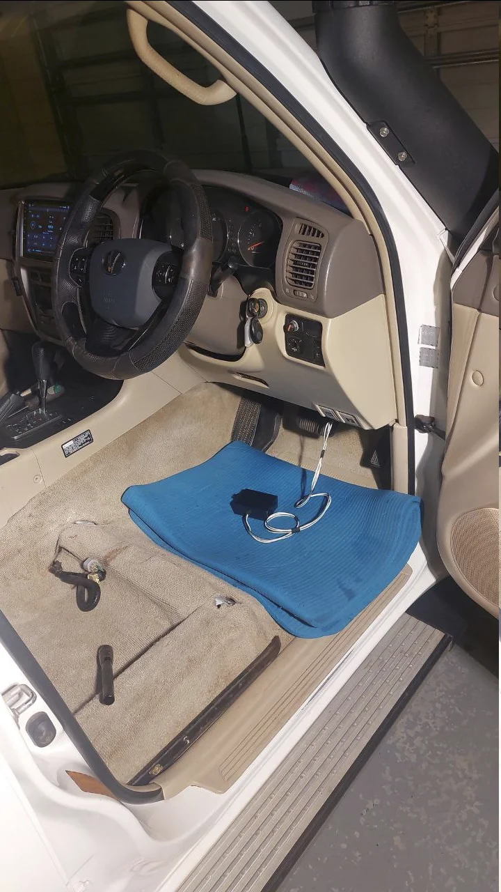

I used a small 'adapter' made from Toyota flasher relay plug and socket. I ended up removing the driver's seat to make it a bit more comfortable to get at the flasher relay connector. Interestingly, installing a comfort flasher system isn't all that comfortable!
Here's the box laying on the floor before tying it up and under the dash.
And here's a video of it working.
I'll run it in my car for a while to make sure the system is stable, but I think we can call this one, DONE!
