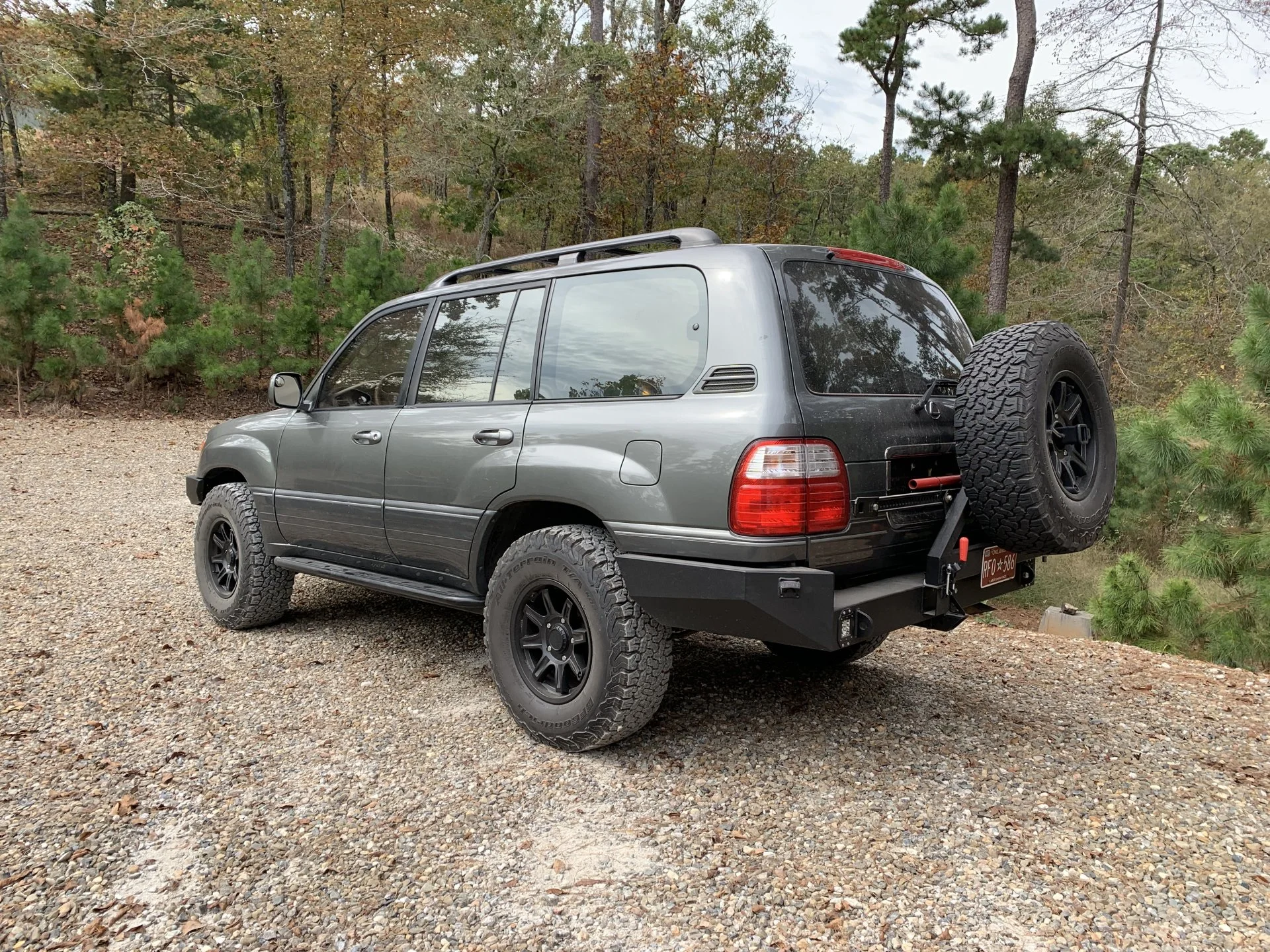

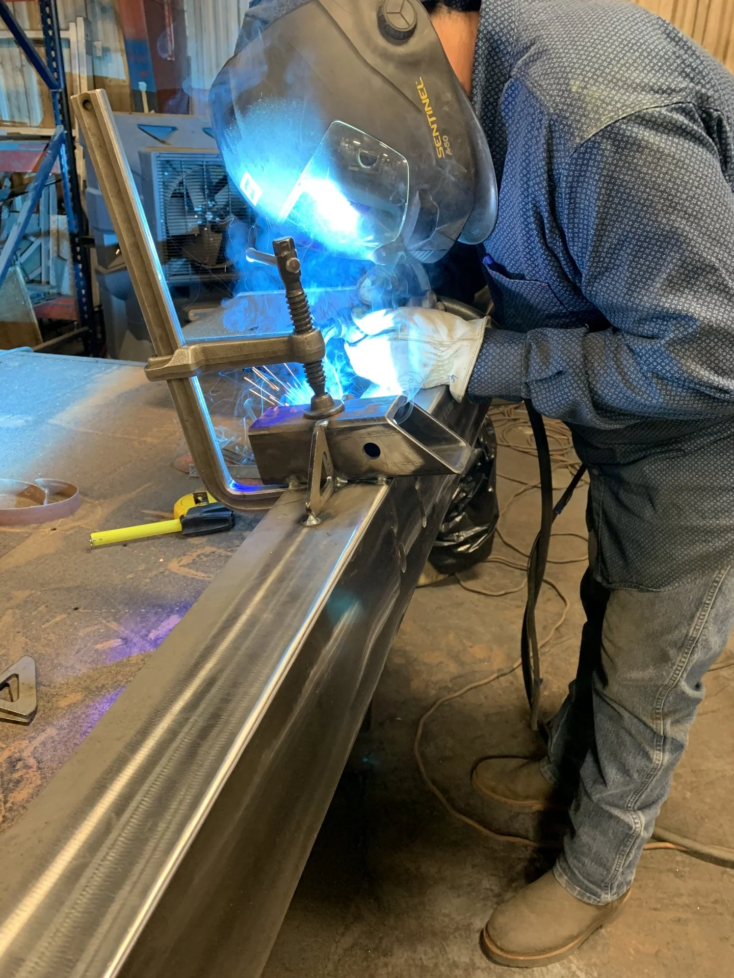

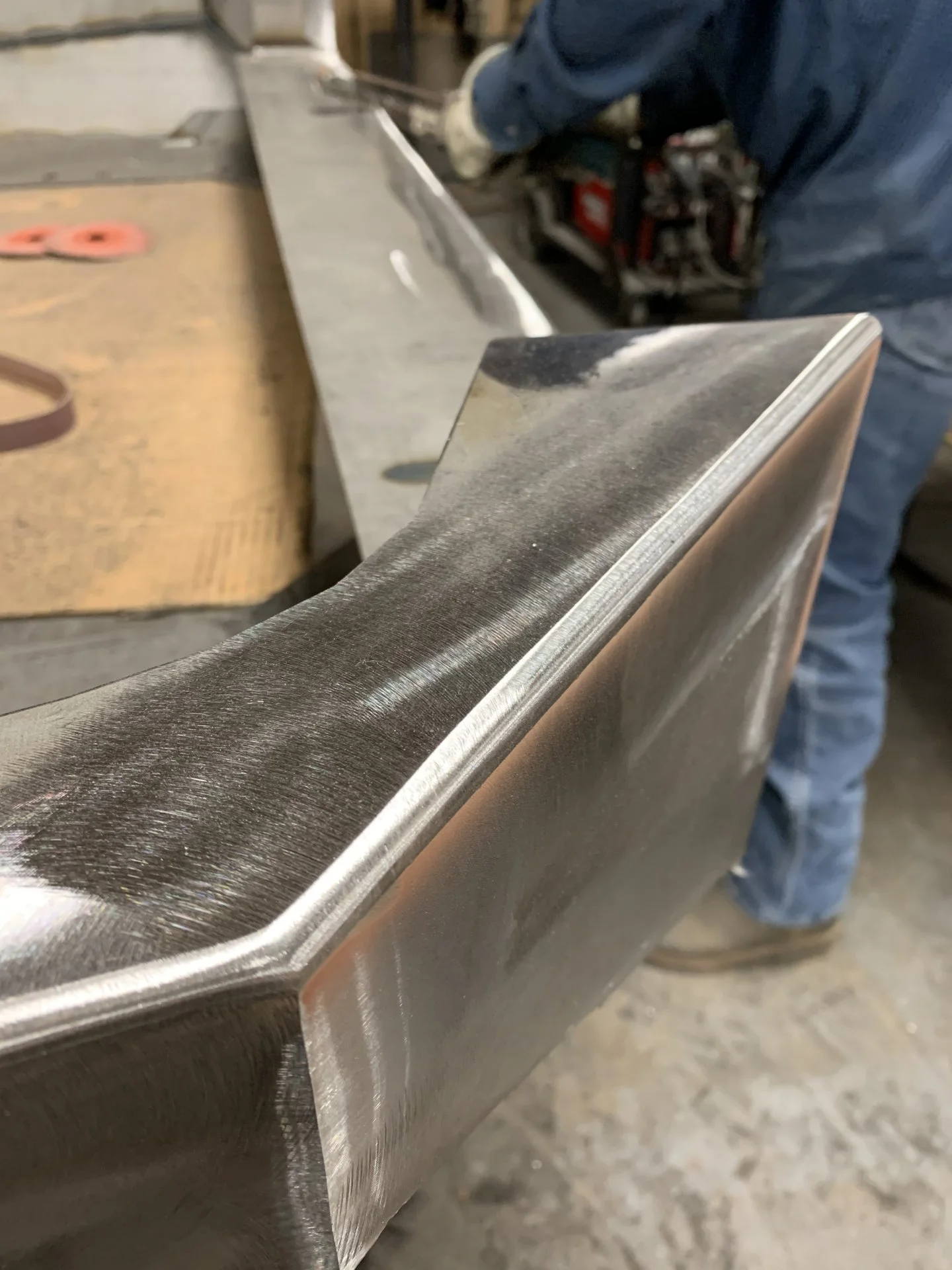

I bought the first generation of Coastal rear bumpers. They have since updated the design to be a little more high clearance in the bottom rear corners. I think the updated version looks better. Overall I am really happy with the product. If you have the time to put this together, the price can’t be beat (4x4 labs is close). The fit was perfect and didn’t need any adjusting. We probably put close to 30 hours total into the bumper and went for a really clean look. It’s not the best looking bumper on the market but it’s cheap and the swing outs are built really well.
Looks good. I've been looking at getting their front and rear bumpers. Is that the "Recessed" Receiver hitch option, or something different?
I'm not sure if this is the recessed receiver option. There was only one receiver option when I ordered. I wonder if the recessed hitch would go through the middle of the bumper like the OEM receivers on later years?
Yeah that's what I'm wondering but Costal hasn't answered my email.

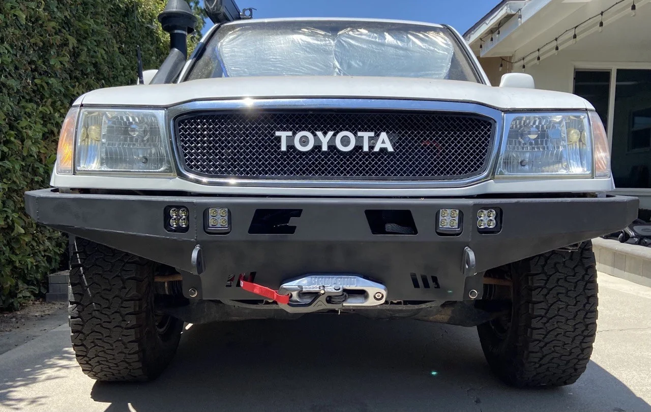

I just installed the Coastal front bumper on my 99 LC. I've been meaning to post about it. Any questions you looking for answers to?

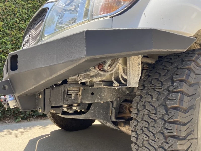

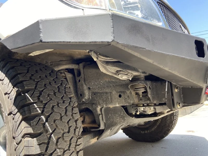

Pics. But more importantly how much is exposed on the bottom because of the high clearance. Does it integrate with frond skids ,stock or aftermarket. Did you do the bull bar?
Other than the normal frame and control arms that's exposed, the only thing exposed is the windshield wiper reservoir bottle on the driver's side under the headlight. With this bumper, you remove the factory crash beam and the bumper bolts onto the crash beam mounting points and the tow/recovery hook mounting points under the frame.

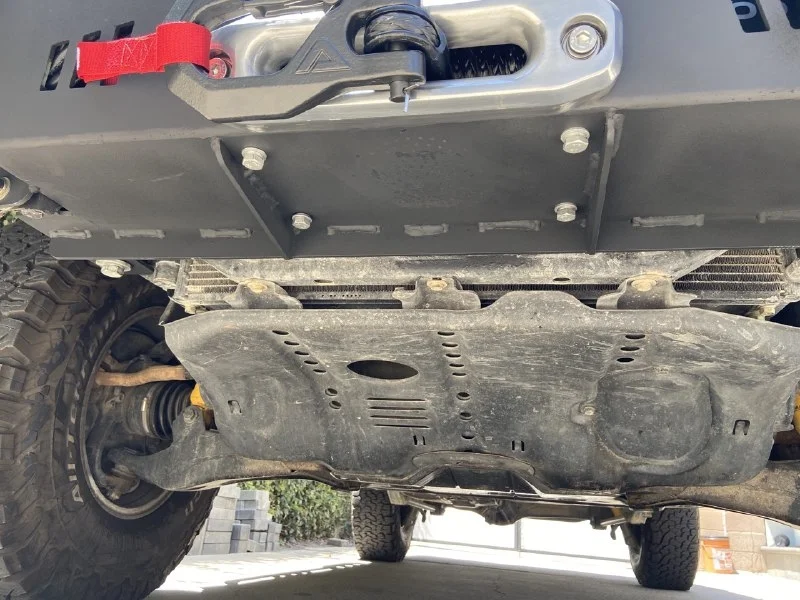

You can see the factory skid plate is still mounted to the bottom of the radiator crossmember. The Coastal bumper does not touch this crossmember or the factory skid.

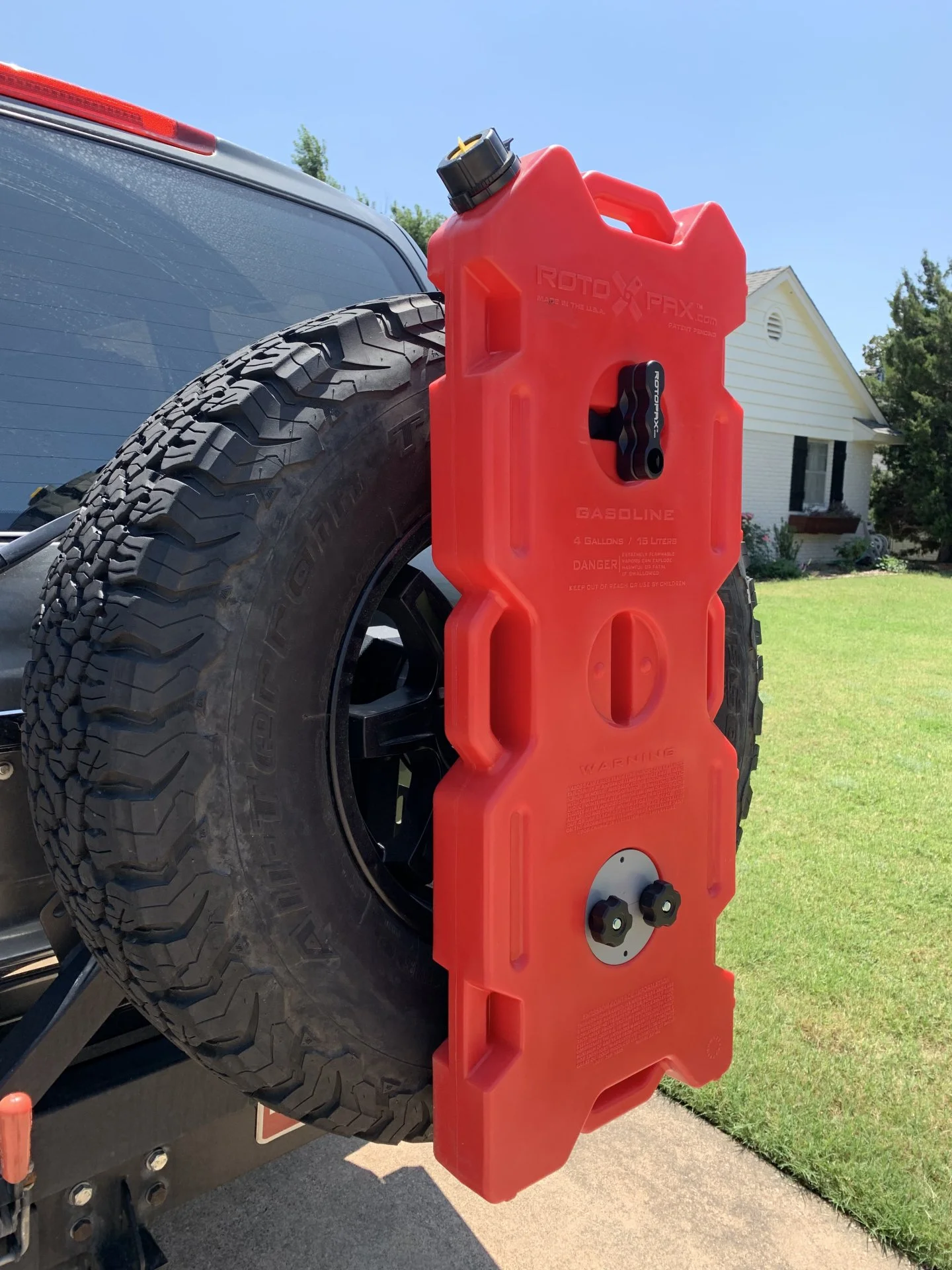

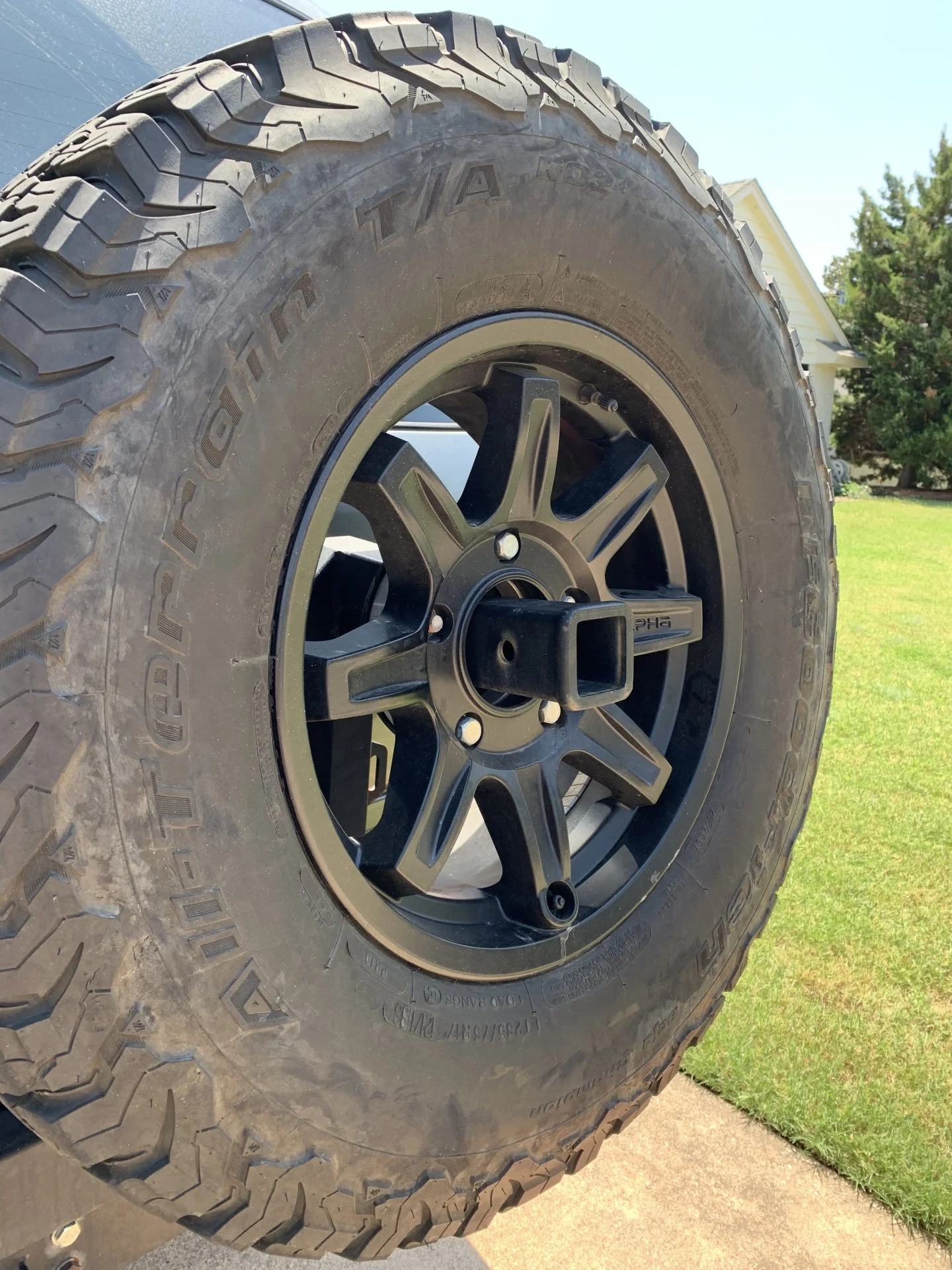

I did right side spare so I could setup a fold down table on the swing out and have my trasharoo on that side. Also, the swing out can be opened away from traffic if I’m pulled over on the shoulder of the road. The tire blocking my rear view is really not a big deal. I can still see plenty out of the rear window. I would put a 6” long 2” receiver hitch through the center of the spare tire.
