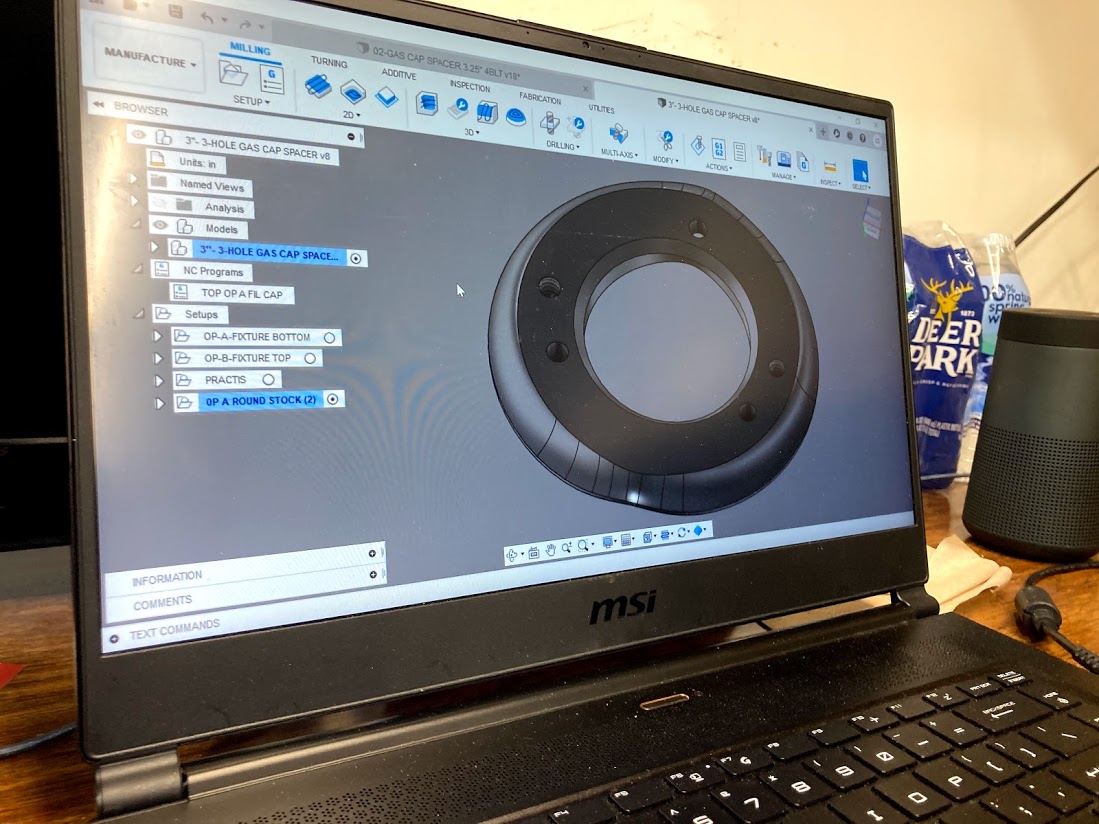

And, as mentioned here or the other thread, there are simple things that could be quicker on a manual machine rather than programming everything in to do it on CNC. The flip side to that is that when you're working with CNC you can easily do more complex things and your simple part takes on a life of it's own.
Case in point, a "simple" spacer - it could have been hidden under the gas cap and roughed out with a sander to fit the contour of the hood well enough, but it quickly went to being a "showpiece" item:
I know I'd have a hard time doing the machine work by hand and forget about turning out two identical parts by hand.
