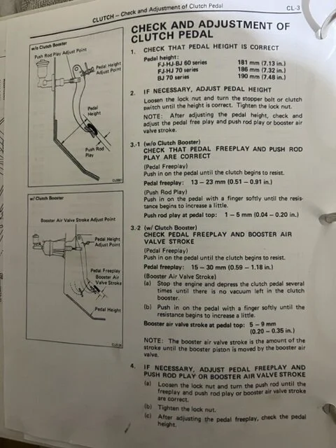

Under clutch pedal free play insufficient on CL-3 is below:
I have a booster. My clutch pedal height was at 5 inches... I adjusted the booster air valve stroke point nut on the rod going into the master (cranked the fork out a handful of turns) and retightened the pedal height nut. Extending the fork is the only way I could get my pedal to come forward. She now sits just over 7 inches as per spec. About an inch past my brake pedal. Pedal free play and air valve stroke seem to be within spec as well.

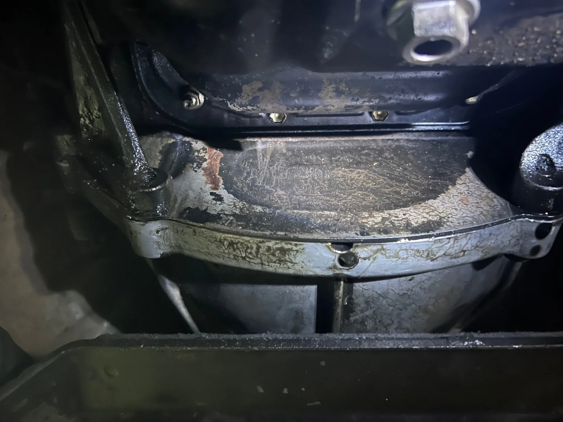

No leaks on master or slave anywhere to be seen. Additionally, I do not have a clutch inspection plate on my bell housing as seen here (missing a bolt…its in the mail now) so I am unable to inspect my clutch. There is a drip of oil seen below, but not enough to warrant showing up on my garage floor:

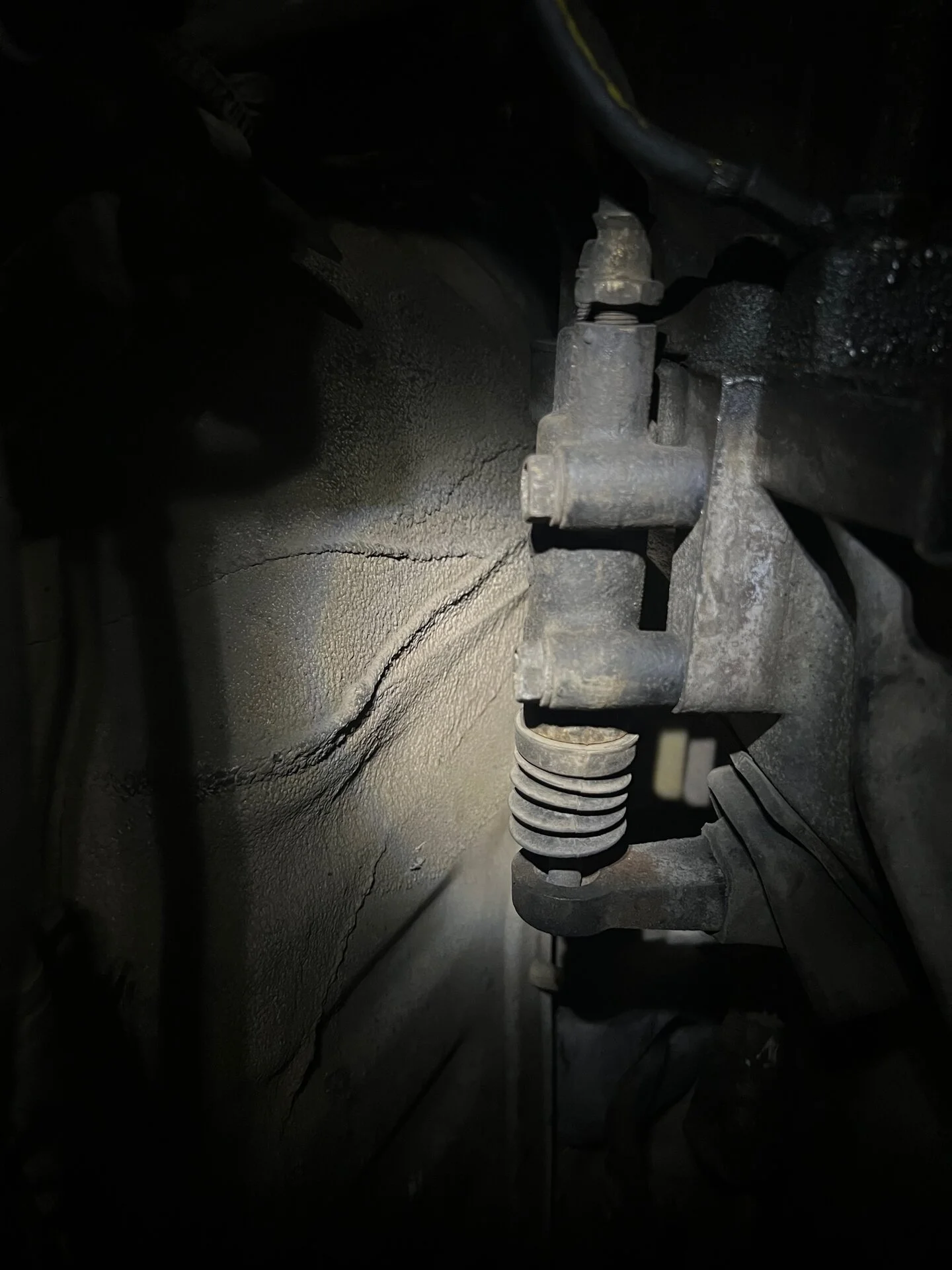

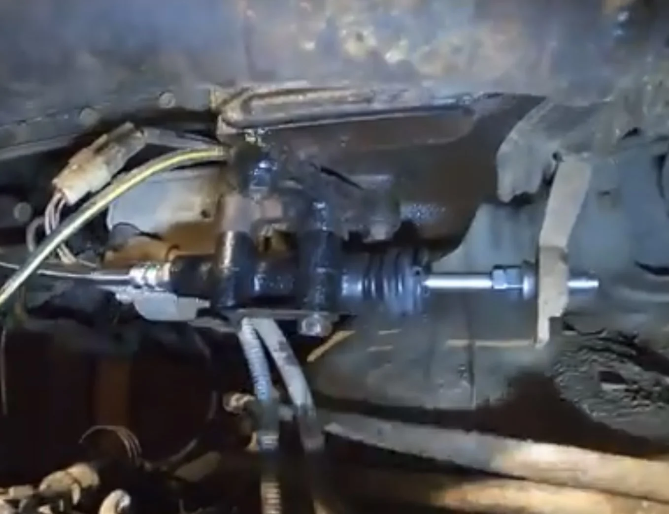

I have a shot below of my slave attached also. There are mentions online that I should have this adjusted correctly, but I am unable to locate how to do this in my FSM.

Also, here is a picture of an early 60 series slave which is different then mine and has the adjustable rod for the fork.

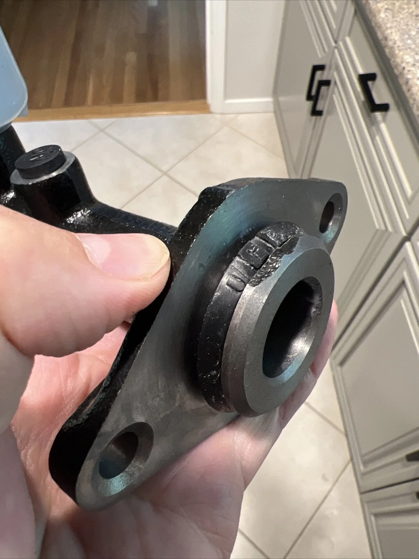

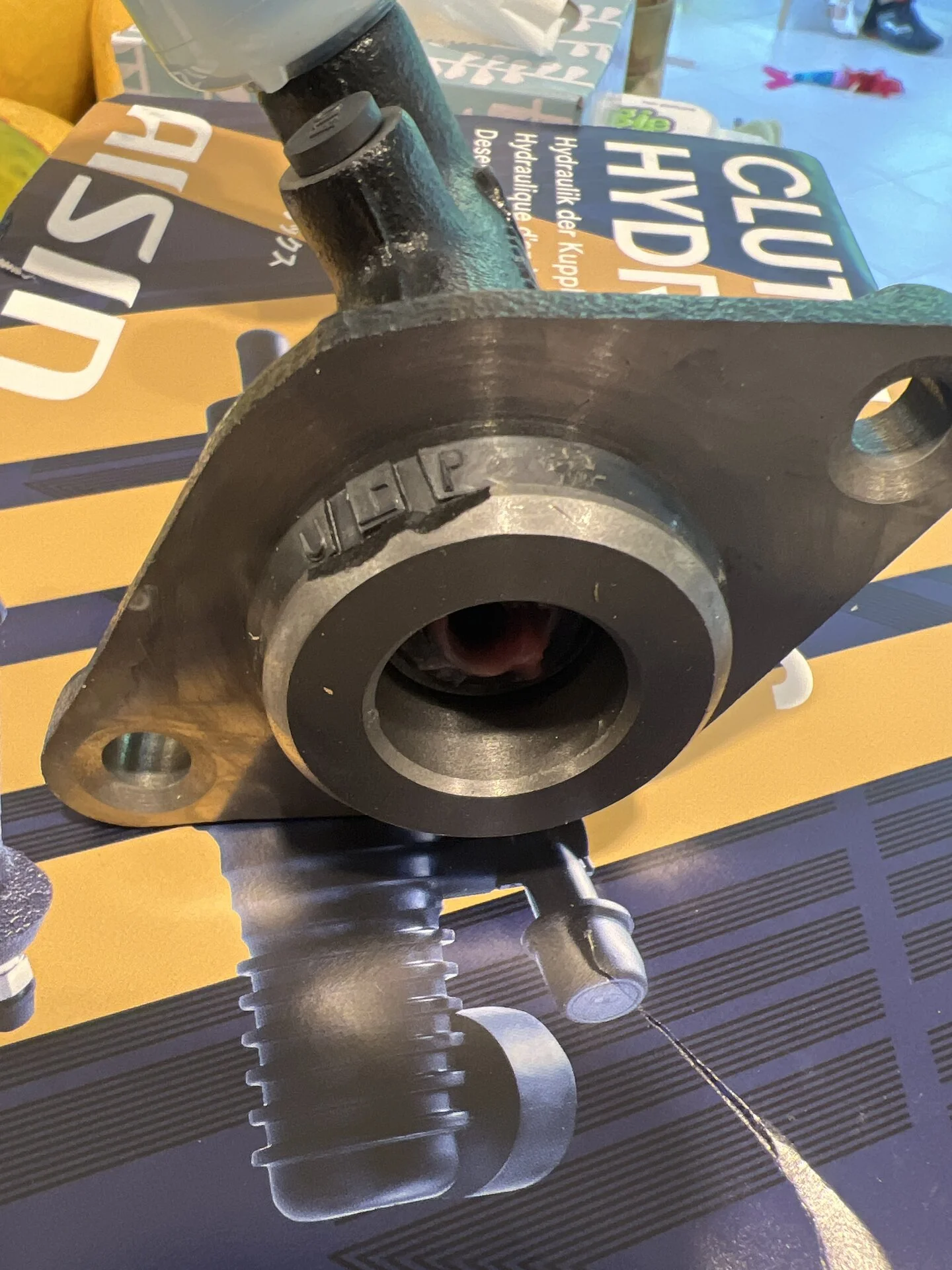

Both came in the mail, but this area on the master looks like it is deformed. Anyone else confirm if it’s supposed to look like this?
Do you mean the black spot on top of the machined end ? It looks to me that the cast there was actually not as large as it should have been. So after machining this slight uneveness shows with intact paint. If this is the only part there is nothing to worry about. Is this genuine Aisin ? They will have a quality control which won't let the part through if not 100% up to working order.
Be super correct with checking / adjusting the rod to piston clearance.
It is Aisin. Didn't want to take any chances so I have a new one coming in the mail and this one is being returned.

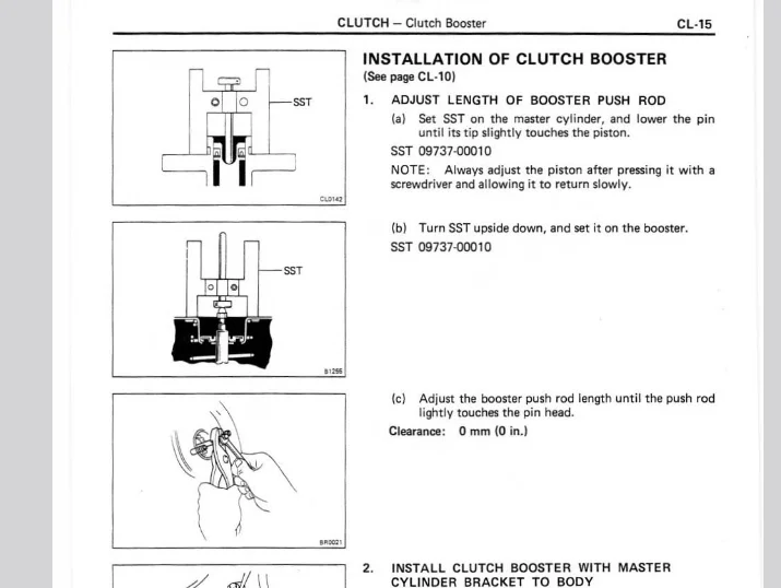

Is the how to for adjusting the rod to piston clearance in the FSM? If it isn't apparent by the picture, my model has the clutch booster.
Yep, that is clearly described there.
As I see it they want to make sure that the pin of the booster is just touching the piston without moving it. That would make sense.
You don't want to push the piston as it will start to pump fluid down to the slave cylinder and will then not allow fluid to freely equalize in and out of the reservoir.

New clutch master showed up with the same issue. I find it hard to believe that Aisin would send me 2 defective ones? This what they all look like now?
@relaxedcruiser, seems like it may not be an issue you say?.. anyhow, the Cruiser has been down 2 weeks now so I’ll try and install it.
Oh no...
The raw cast seems to have the same imperfection through that batch.
I would use it, no worries - the action takes place in the cylinder and that rubber seal behind it is not affected. In my opinion this is a cosmetical imperfection.

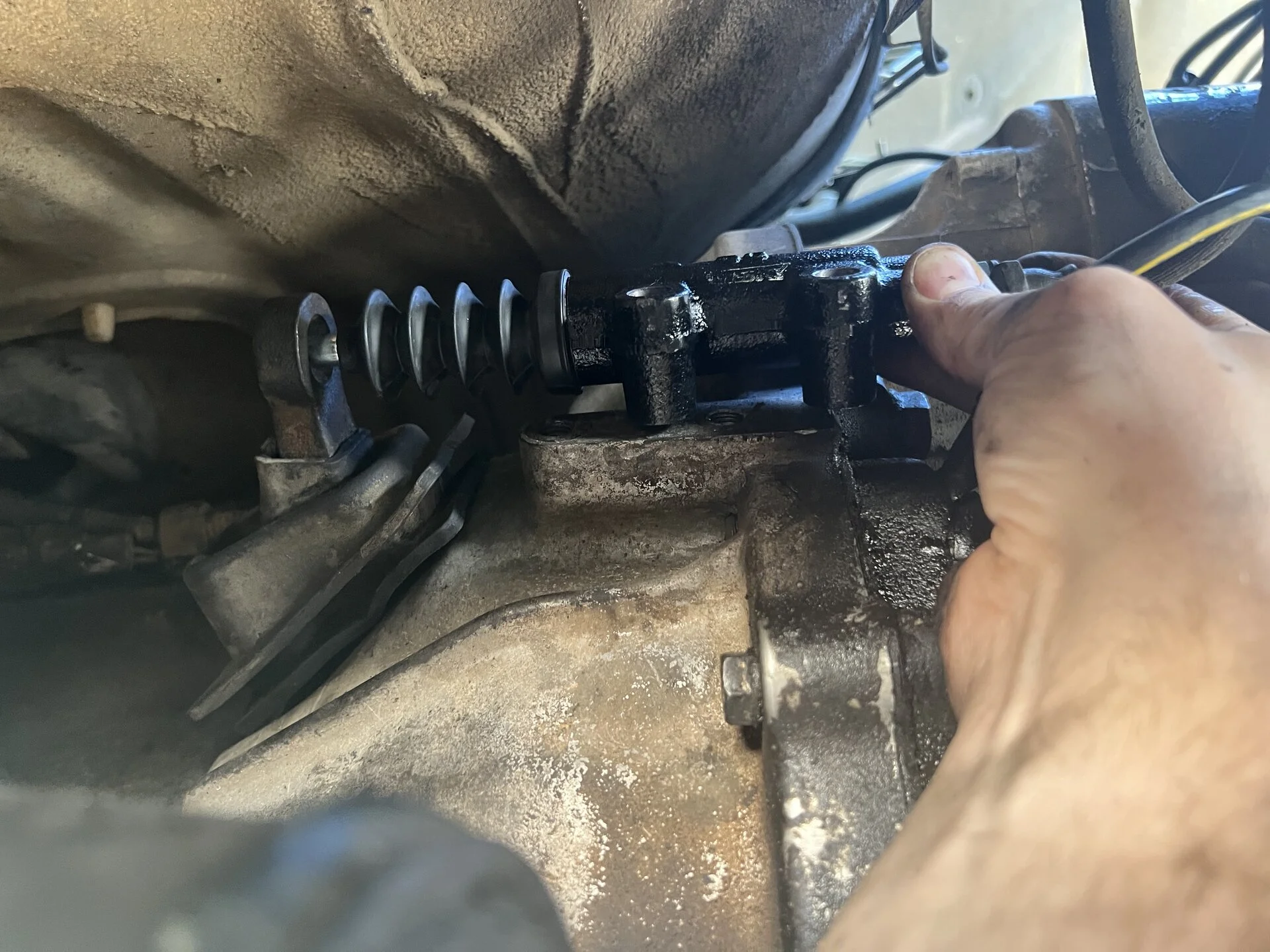

I went to swap the slave cylinder and it was leaking fluid under the boot. Swapped it out for the new one, new master installed no issues, and bled again.
Drove it up and down the street, only time will tell if that solved it.
Thanks for the help all. Here is the new one as I am installing it.
