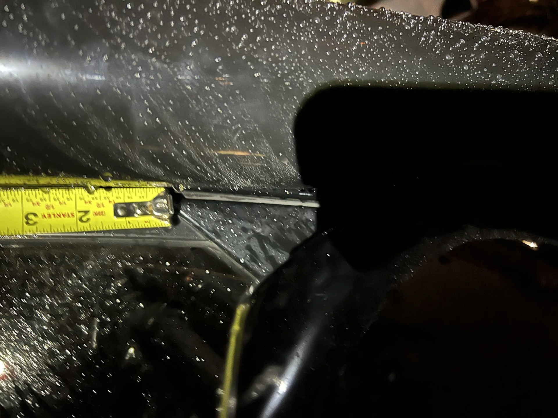

Would you mind grabbing a measurement when you have a minute? From the trim plat to the ~end of the pipe?
14-13/16” from top of the triangle to the pipe.

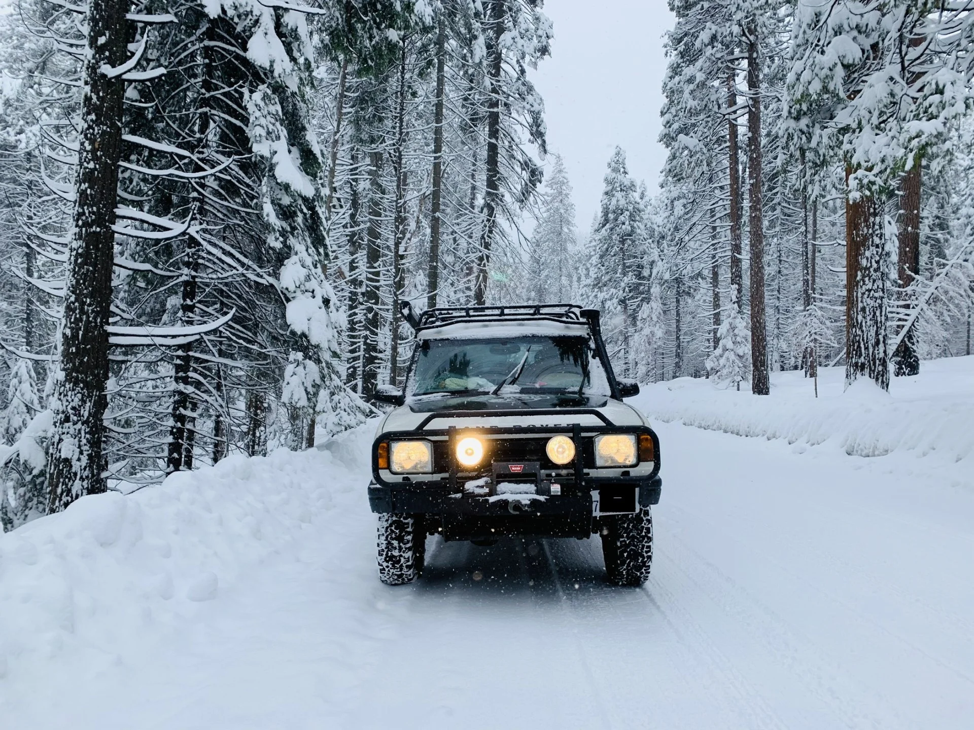

Do it! Here’s mine for reference. 🙂 Interested in your snorkel if it’s still for sale.

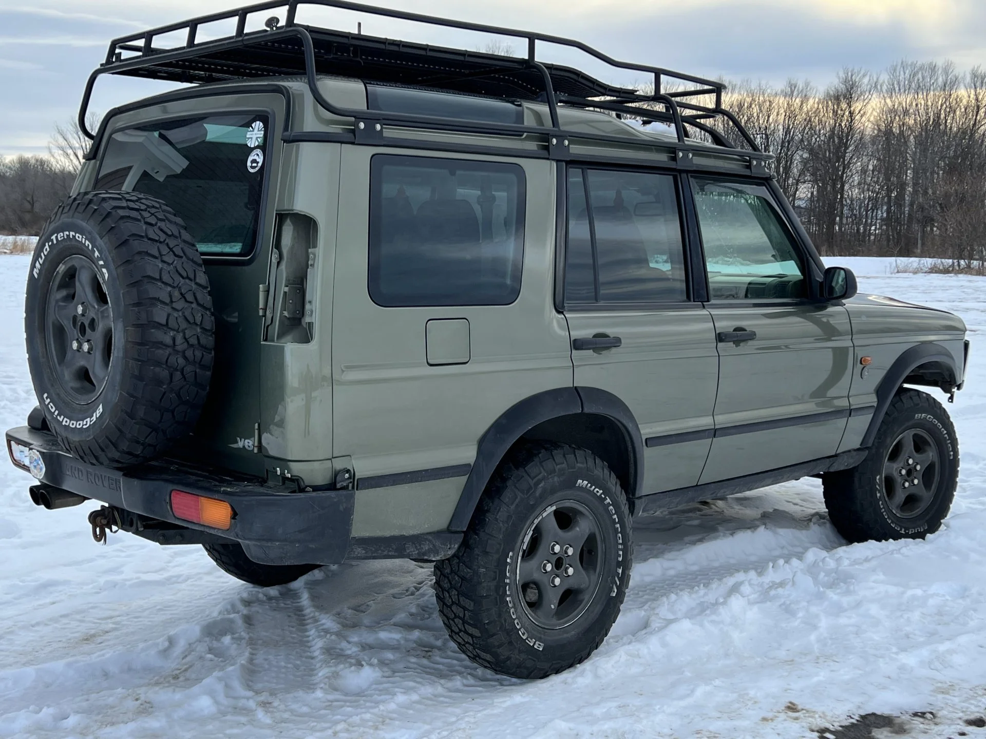

The snorkel just arrived yesterday. Drop me a PM. Here's the disco as it sits in my driveway.
