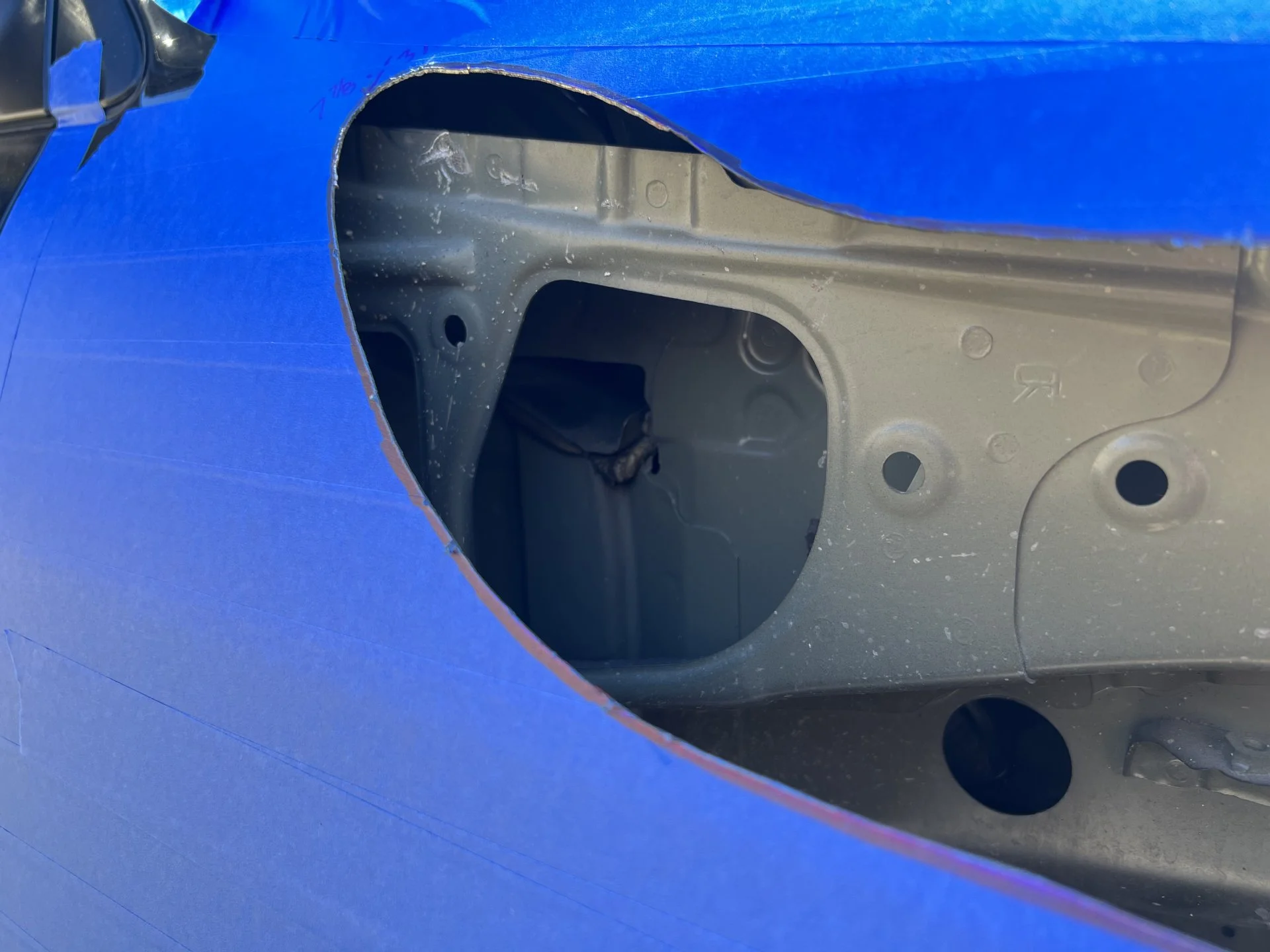

I did add touch up paint to the exposed metal. I bought a cheap harbor freight saw, made quick work of the cutting.

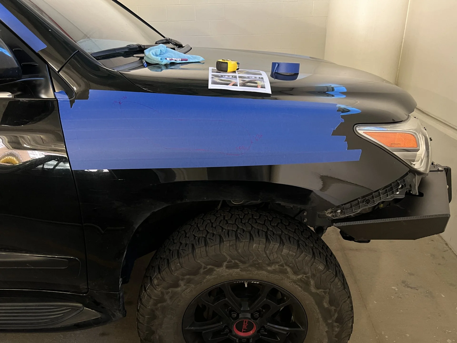

Also, decided to take it back off and work on trimming it more. I’ll try to figure out measurements from reference points on the vehicle. Suggestions welcome!
Here’s my first attempt. Looks good enough to chop chop!

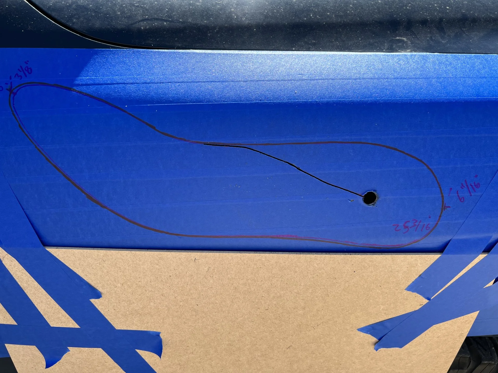

Is everybody starting with a hole saw coming from the engine bay side? Seems like that might be a good for sanity since you know where that spot would line up on the template area.
I just took a 3/8 bit right thru the center of the outlined area, then used the saw to cut from there.

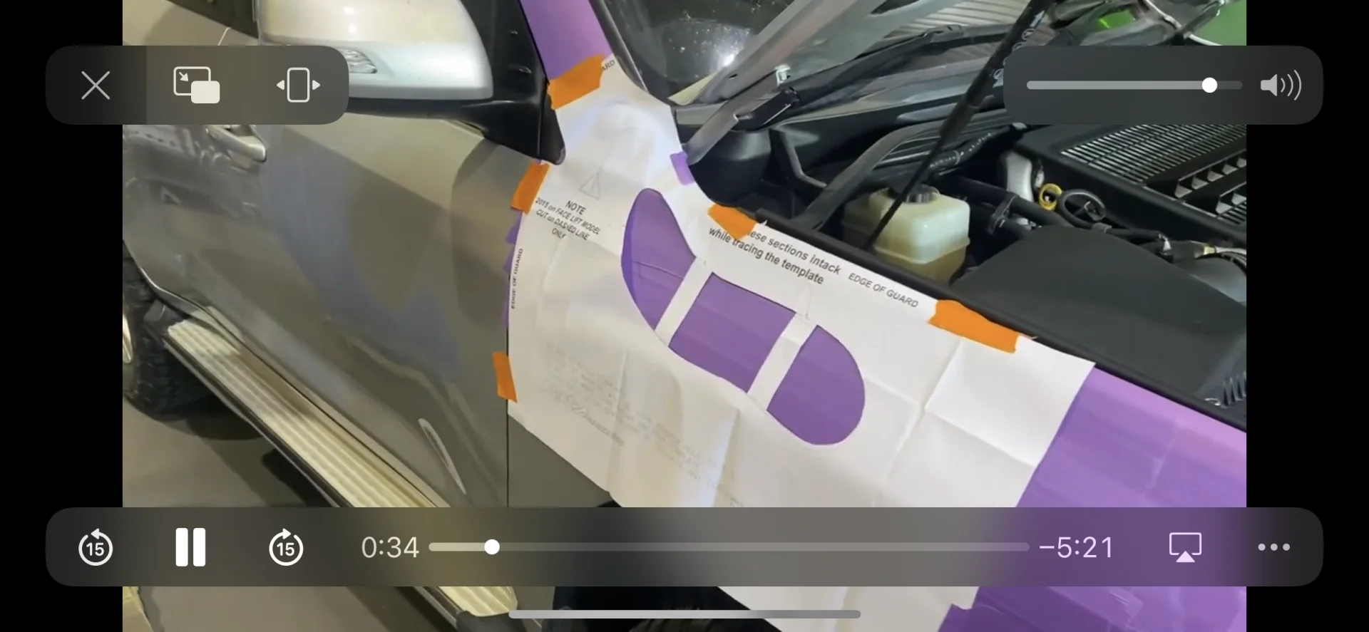

no, just some measurements from various parts of the fender. So we're dealing with 2 sets of measurements and 2 slightly different shapes.
Wait what???? The vid in post #37 shows this:
That video is for a different company 🤷🏻‍♂️
Guess that would explain it. Maybe I’ll send Fabulous Fabrications a link….

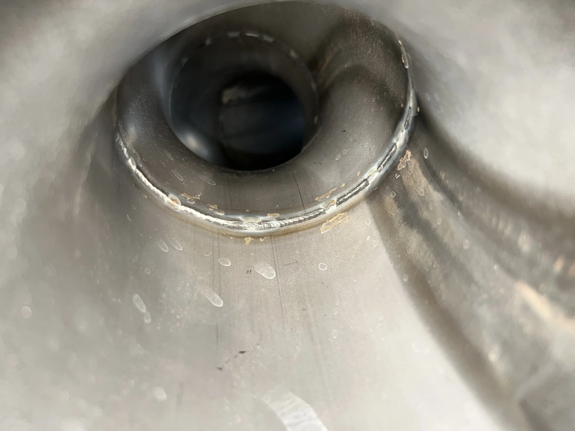

As a side anecdote. Seeing the relative simplicity of this product, I looked up what it takes to bend a 4-5” metal pipe, and it is not trivial.

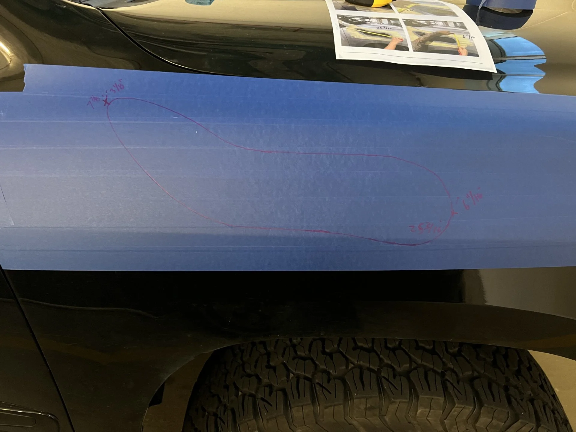

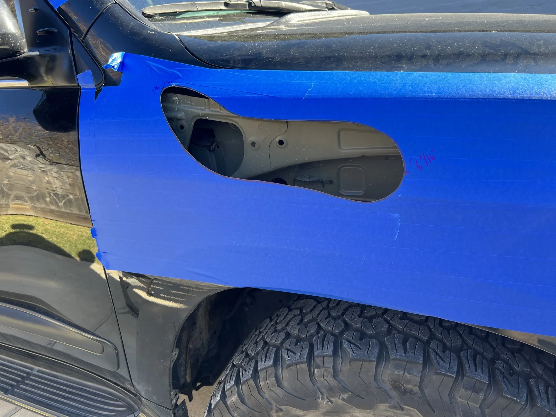

Quick tip: cutting the bean out seems to be more accurate than fumbling with the outside trim. The black line is from the bean and 3-4 measurement verifications.
Also, jigsaw on fastest speed (and the blades I linked earlier) cut like butter.

Their Facebook page shows a lot of pictures of them welding, sanding and powder coating these things. I don’t think any part of these is bent.
Ahh.. the transitions looked smooth enough that I assumed it was bent. Can you tell when holding one in hand? I’m also not a metal fabricator…so what do I know?
If that’s the case, then seems like they’d be worth every penny with the labor necessary.
The top of the bean suckkkks (closest to the a pillar) with a jigsaw. Take your time, or cut your blade down. If it’s too long, it will hit the metal below the fender and try to pop out.
Here’s a pic of the inside. It’s seamless from the outside:
