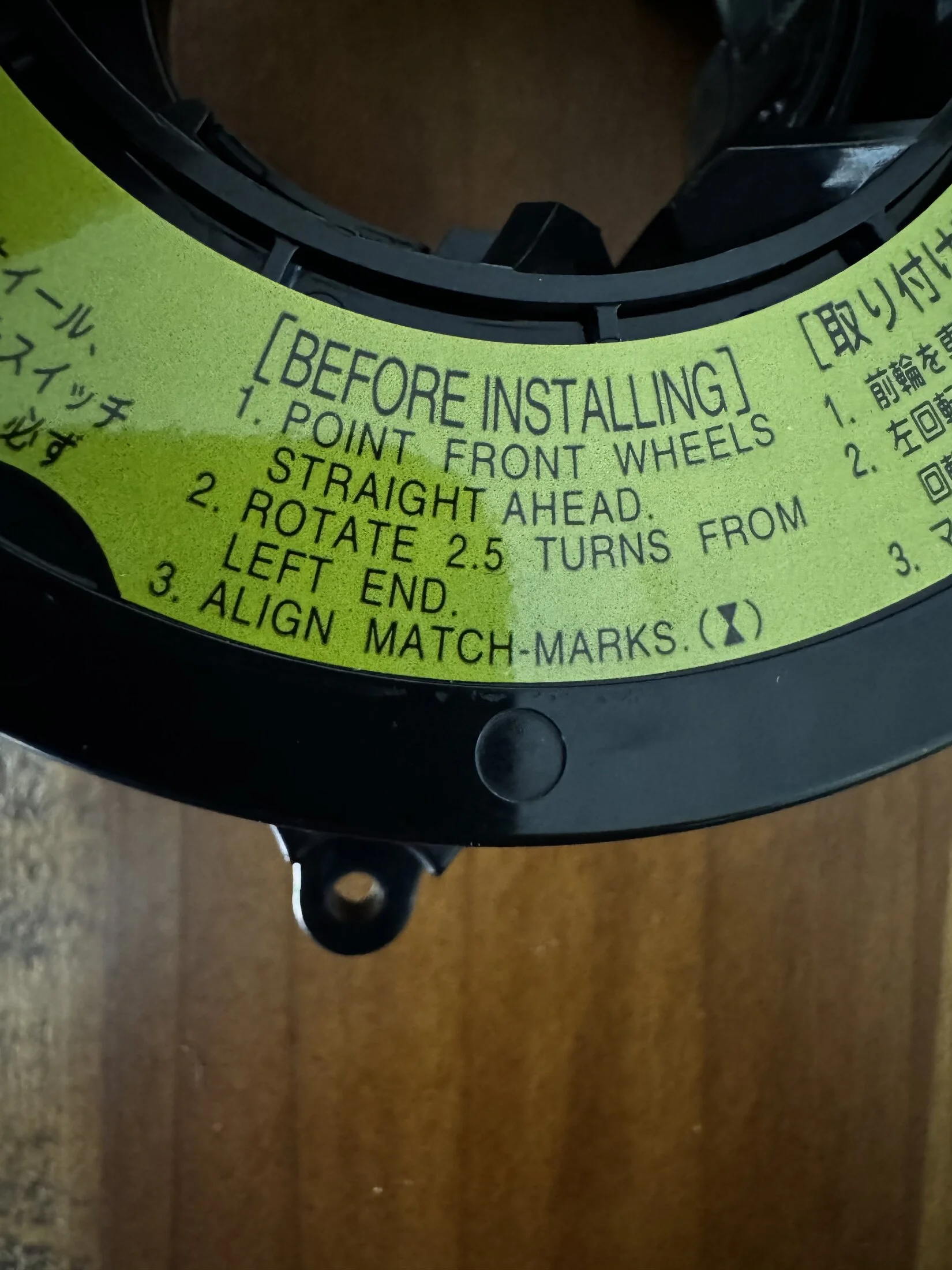

Yes, mine has installation directions printed on it, which specified how much to unwind it. '99 LC.

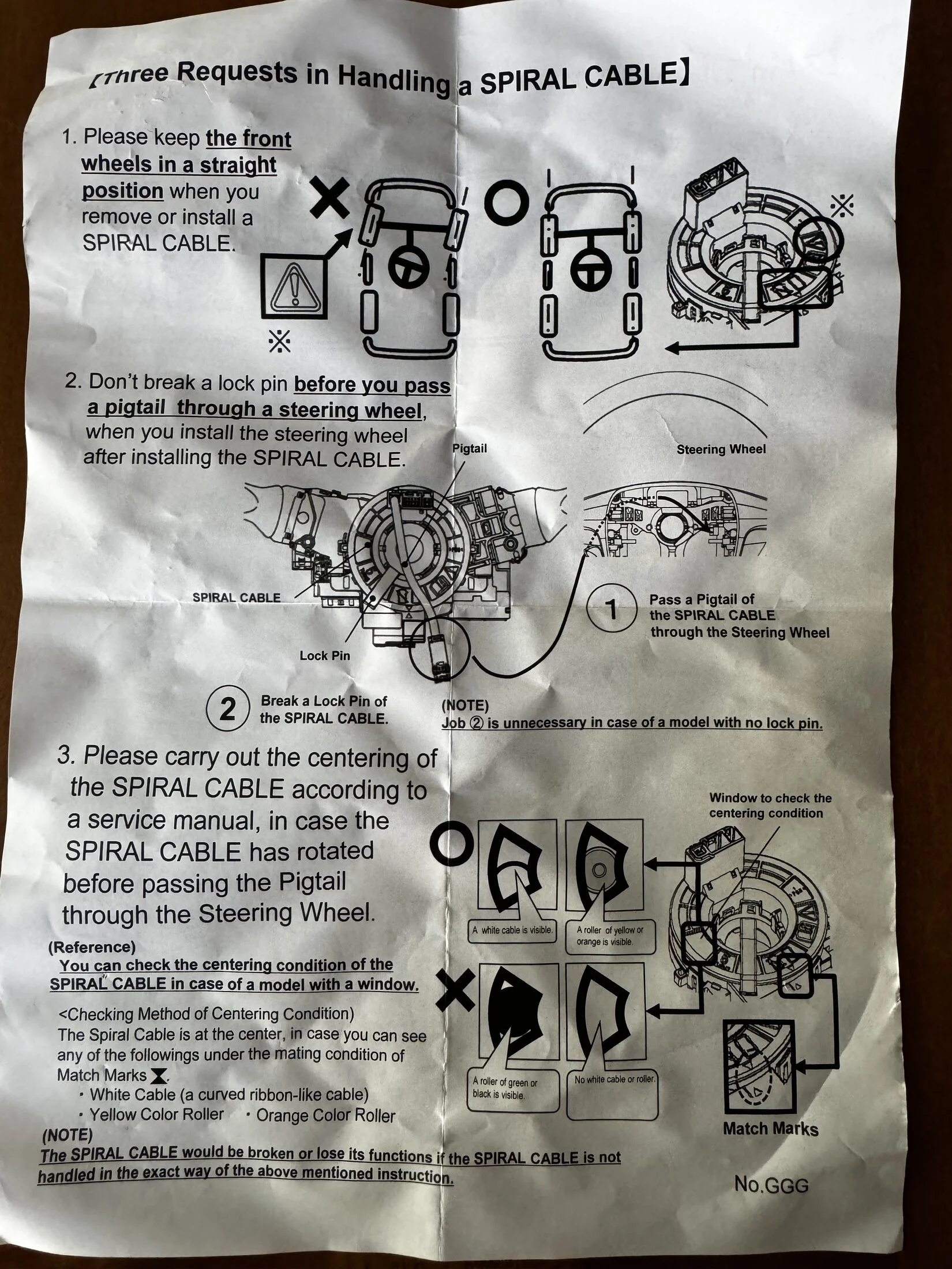

I received the CS this afternoon and it came with some paper instructions I'll attach below:

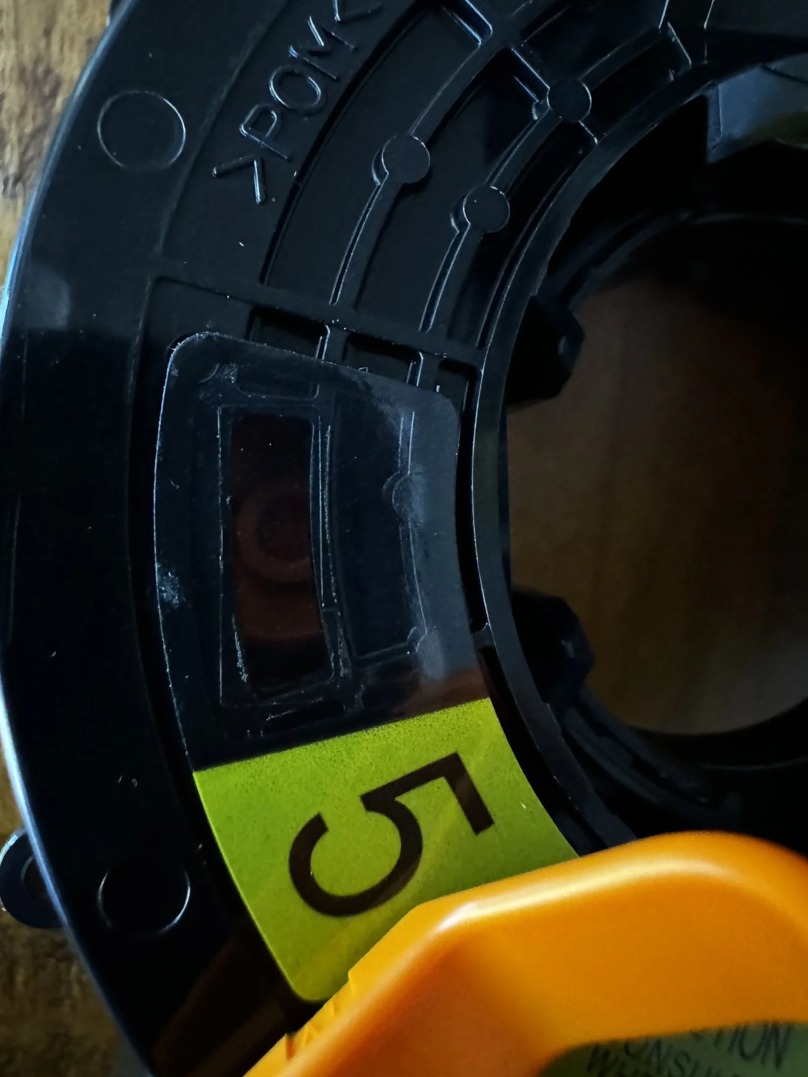

I've got the orange disc lined up in the view window, as seen below

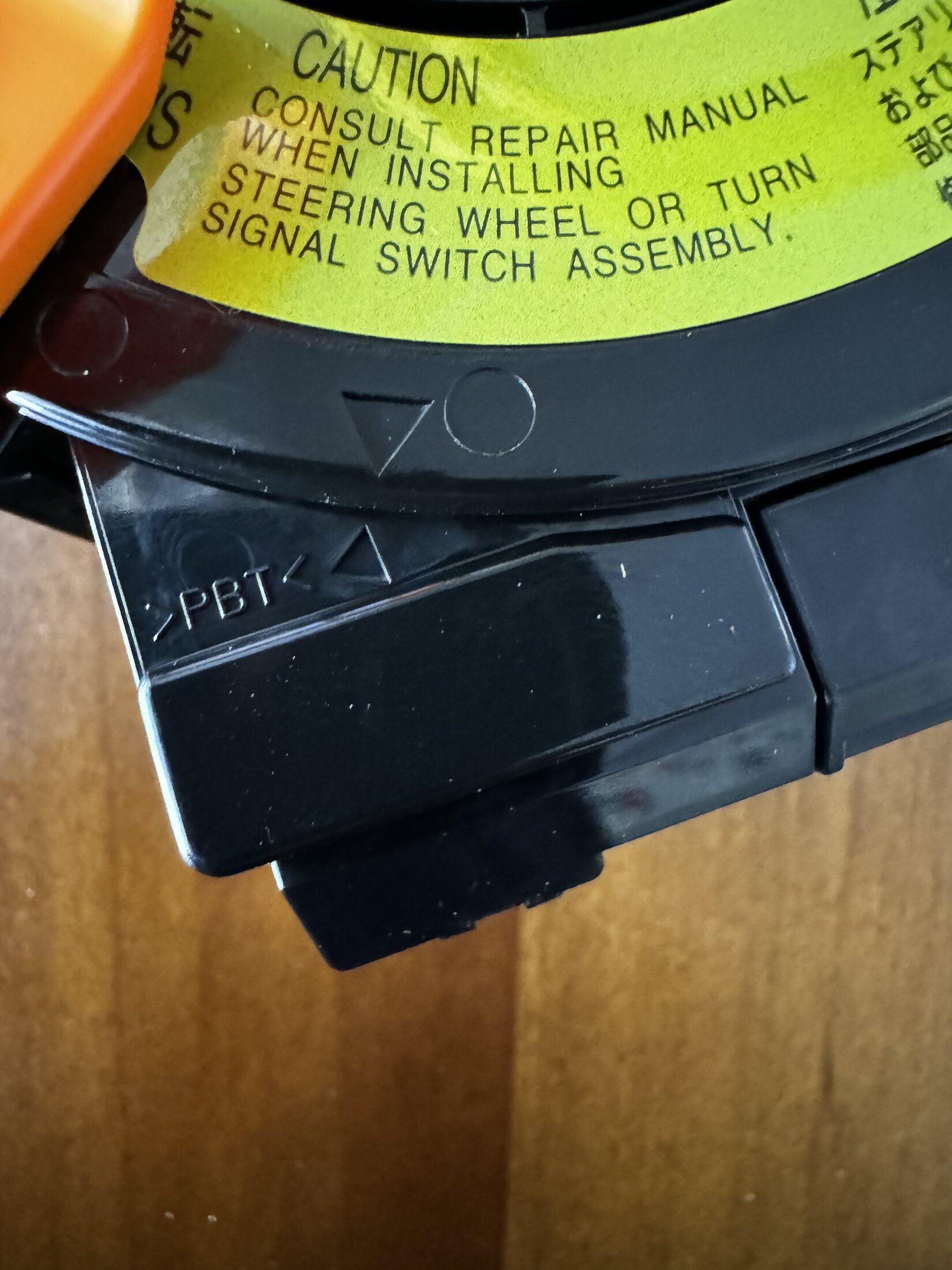

The two arrows are in line on the side of the part
So do I still need to unwind it 2.5 times to the left as indicated on the part, and then re-align the 2 arrows and make sure the orange disc is in the view window?

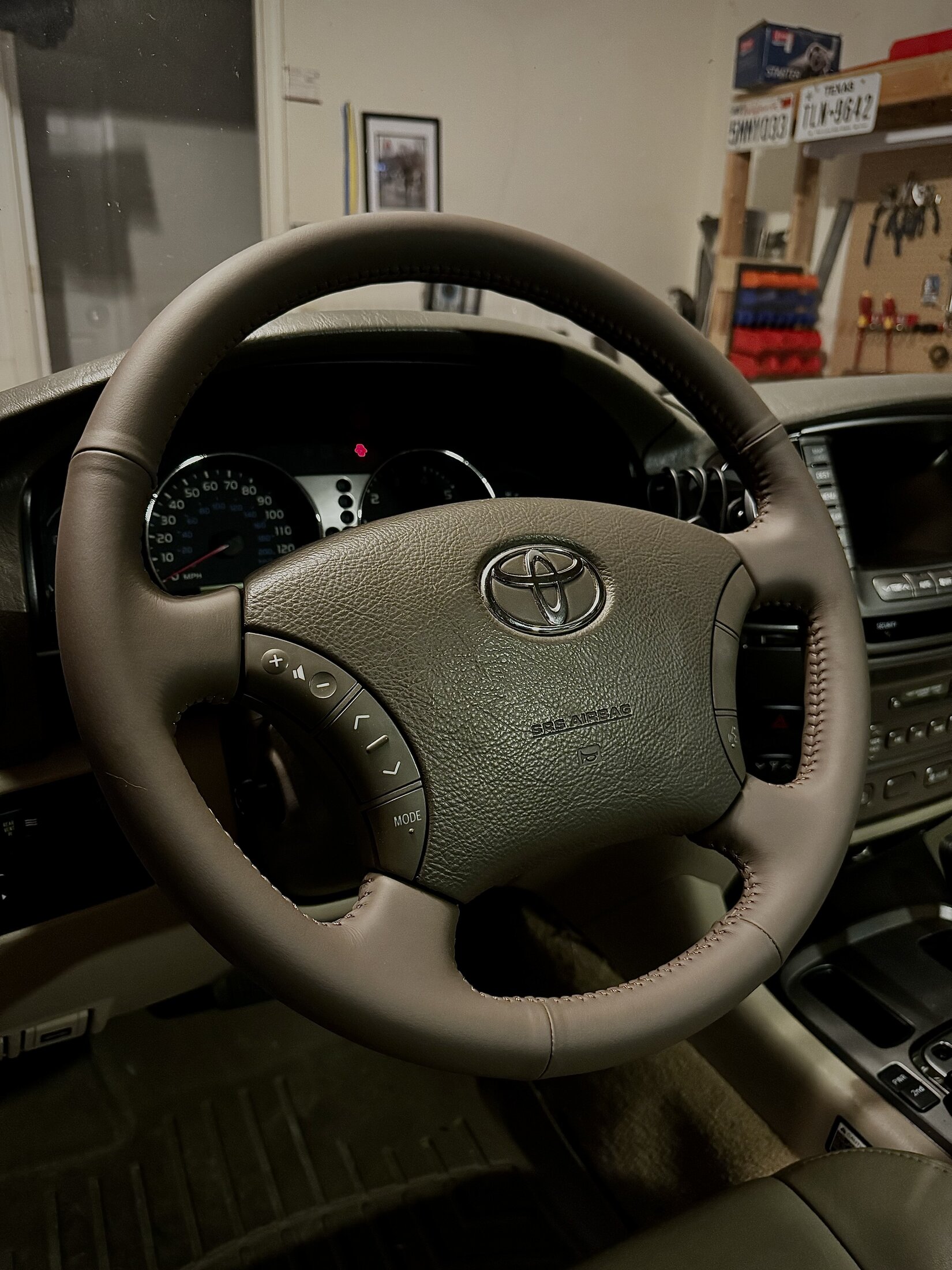

Figured it out.
New steering wheel, new clock spring. Smooooooooooooth.
Figured it out.

My FSM for 2001 LX leads me on a wild goose chase about the clock spring ("spiral cable"). It jumps you over three or four sections but I cannot find anywhere that it actually addresses unwinding the spiral cable. The cave art drawings and pidgin English on the new part and enclosed instruction sheet do not inspire confidence.
I have watched the videos on YouTube and nobody bothers to unwind when installing a new part, they just screw it on, connect it, and pull the lock pin. The only one who addresses this is the Australian guy whose every other word is f*** and it's hard to follow what he is doing.
From my studying this, I am forming the impression that the winding procedure is for spiral cable assemblies that are removed for deeper work in the steering column, and are going to be re-installed (without being replaced). SO the winding procedure ensures that the spiral cable is centered when it is re-installed.
Whereas, a new spiral cable assembly out of the package, has the lock pin in place to hold the cable in a centered position, and winding is not necessary, just do like the guys in the video and screw it down, connect it up, and pull the pin.
Clear as mud. Is this right? Would really appreciate any advice, I will need to get it done soon.

From what I have read, a new clock spring should smoothly unwind 2.5 turns from center, and 'wind' 2.5 turns from center. This allows the clock spring to have more excursion (winds) than the steering wheel will ever give it. They are shipped 'centered' and ready to install on a truck whose wheels are centered.
