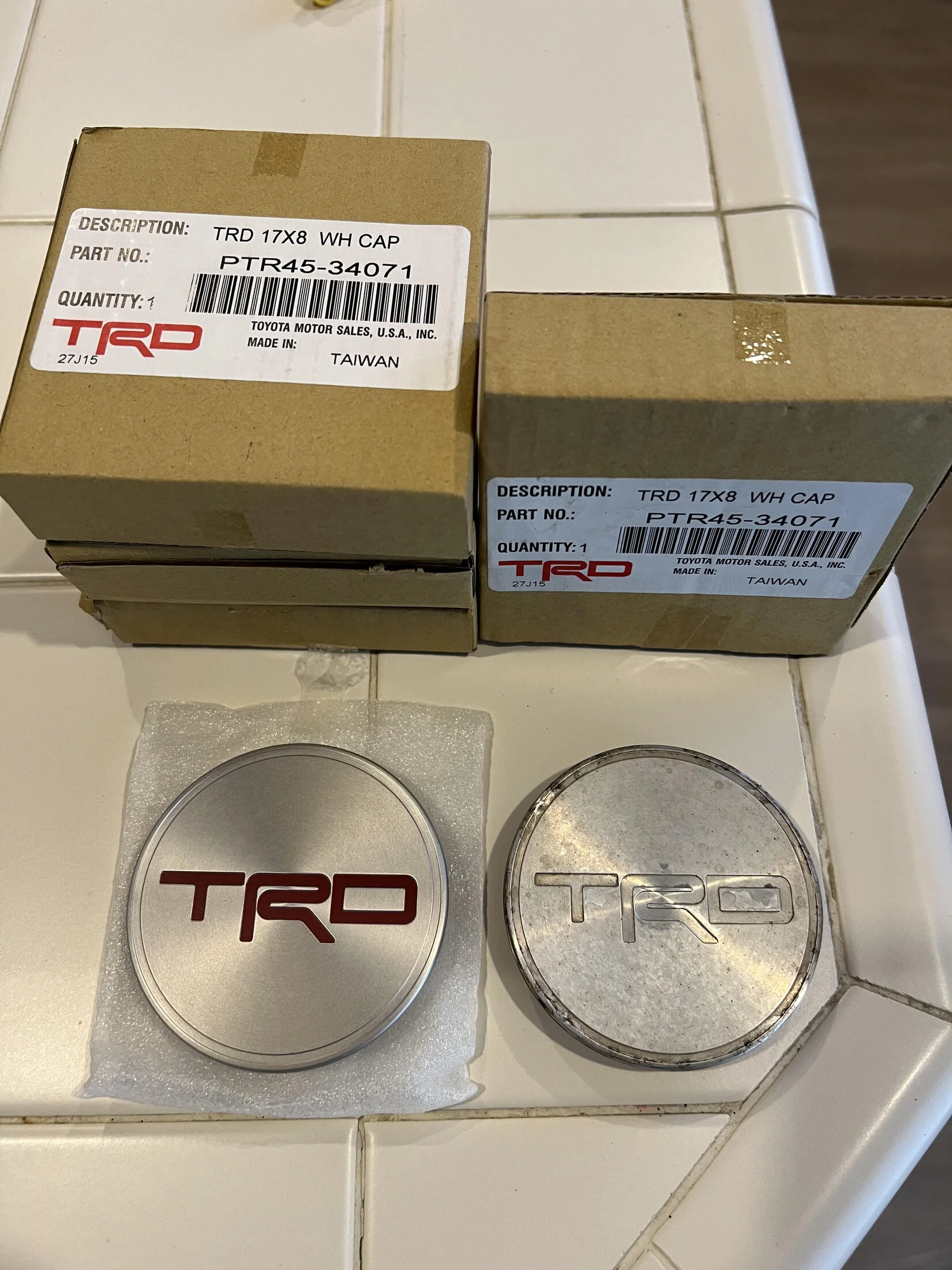

Before installing a set of Rock Warrior wheels, I'm looking for insight on the best protection for the trd caps. Clear coat, ppf, etc? I want to help prolong the fading/damage that happens to the factory finish on the caps. Any insight or tips from others that have done this is appreciated!

My worry with the 2K after looking further into it is how shiny the finished product is going to be. I'm trying to keep the look as "factory" as possible with added protection. I don't want the caps to have a super high gloss finished look.
Just install them and a couple of times a year wipe on or spray on some Boeshield T9. That will keep any corrosion away. Spraying actual clearcoat might result in fitment issues since they’re so tight fitting as-is and basically zero tolerance for adding more thickness.

This is matte 2k clear is what I'm currently leaning toward. I'm still hoping someone has done this and has some input and how it held up over time. I've held onto this caps for a while and as we know replacing them is now impossible so I want it done correctly.

FWIW if anyone else is looking to do this in the future, I reached out to Spray Max (maker of 2K clear) and they strongly recommended not using their product for this job. Prep work for their product requires sanding and scuffing surface to ensure the product works.
Boeshield has been used for a very long time and is a well known great product.
Per spraying, yes everything always needs a scuff, the clear fills in the micro scratches. But as it is perhaps not the easiest, they recommended against.
