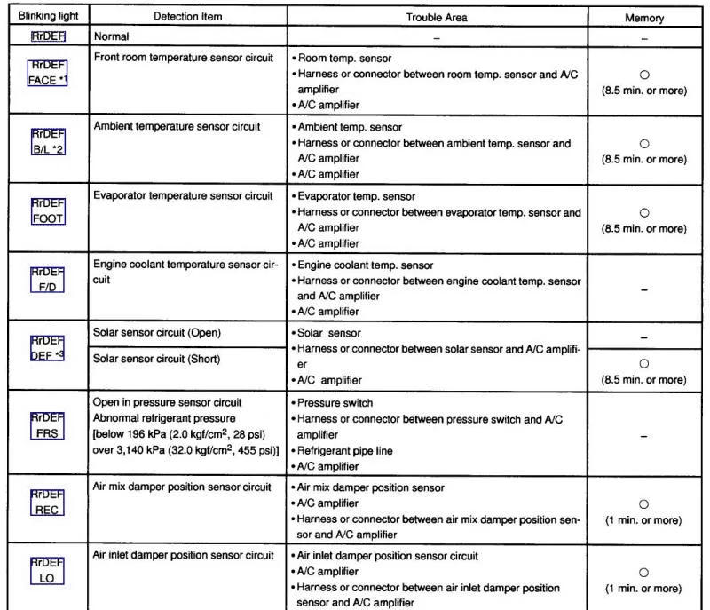

There is a diagnostic test that you can do by holding in a couple buttons or something while turning the key. It tests the flapper diversion actuator gizmos and tells you if one’s bad by flashing a code in colored lights. Seriously. I’ll search and report back...
Wonder if its as simple as this...hold recirc while you turn on key..
Thanks...kinda like a POST test on a computer.
