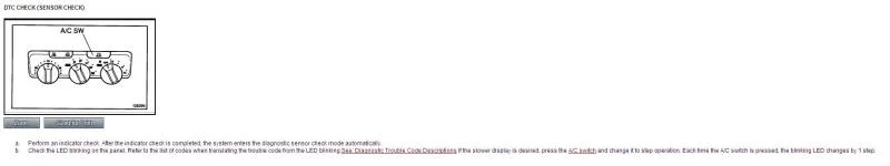

Not sure what year or model you have. If you have the non-navigation model, you can get the HVAC trouble codes as follows by reading a pattern of blinking lights.

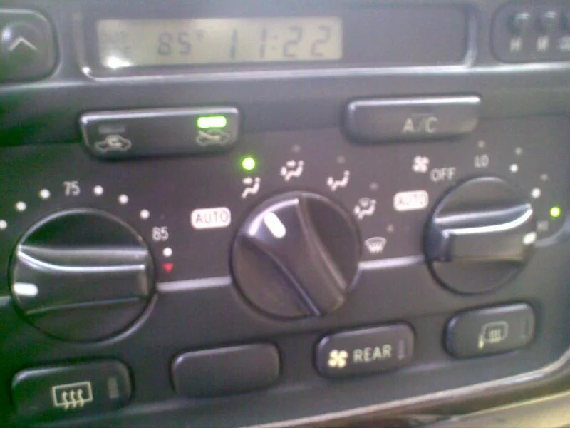

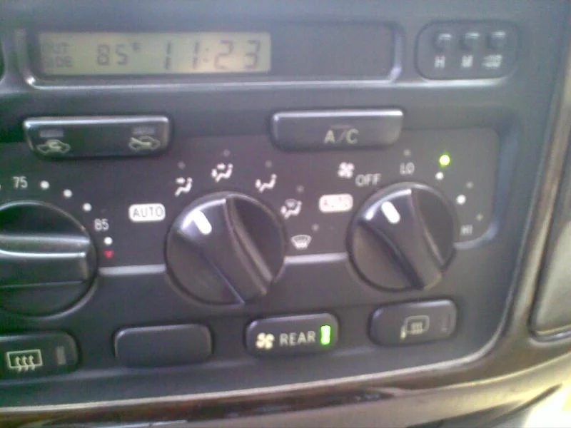

thanks for the reply. i have done exactly as said and this is the result i got. the Rear fan switch and fan speed switch position 2( after lo) are blinking. (see pic AC diag result.jpg)

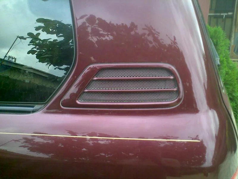

secondly, i noticed that when i switch on the fan only i get air blowing out of the rear vent of the vehicle. ( i have not taken notice of this since i bought it 2 yrs ago. then ac is working.) see pic rear outside vent and rear outside vent setting when i get the air blowing out of the vent.
is this condition normal or it could also be part of my problem.

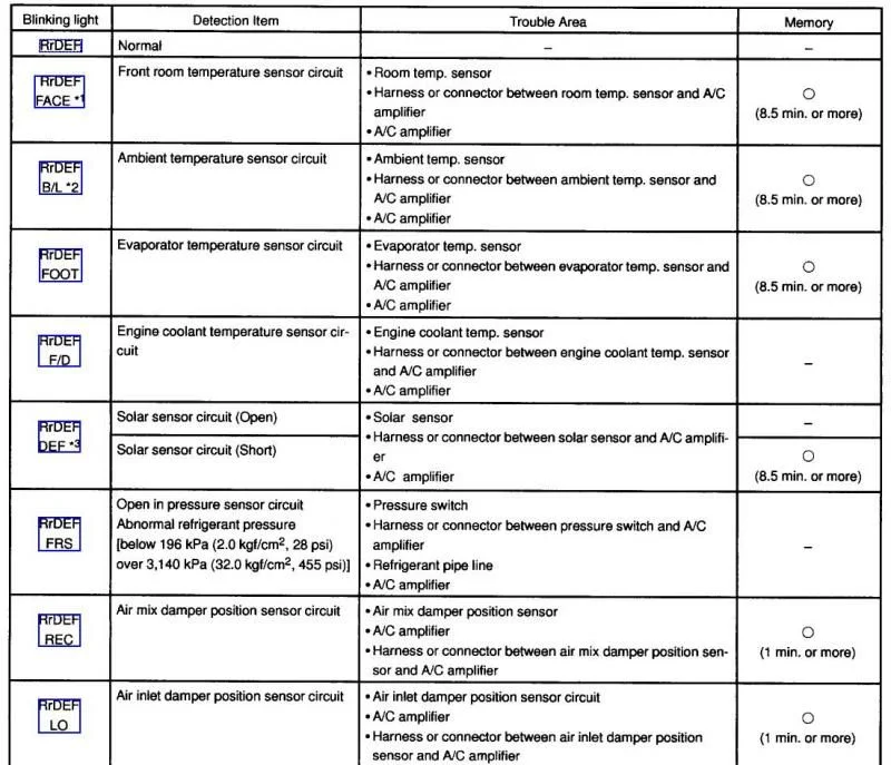

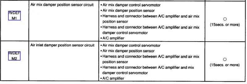

here's what I have scanned in. There is one additional page from the Factory Service Manual (FSM) which tells whether the fan speed you see blinking is M1 or M2 I'm going to have to get tonight. But I'm not sure that this totally explains why your compressor shuts off either.
I "think" what you're seeing is the last one, the "Air inlet damper position sensor circuit" error, labelled RrDef/M2.
Air will blow out of the rear vents if the circulate/ventilate switch is set to ventilate pulling in fresh air. The other circulate setting only cools the air inside and no air would blow out of those back vents.

I have this pic you sent to me. its M1 posiiton and Rear Fan switch that is on (look at my pic again) it is not the RfDEF switch light that is on.
The Page does not talk about the Rear Fan Switch at all.
Re_guderian,
Mine does the same, I think it's because there wasn't a provision in the FSM for the rear air. Anyway, I scanned all 50 pgs of the FSM regarding AC diagnostics into a pdf. Send me a private message (PM) with your e-mail and I'll send it to you. It's about 40MB zipped. Somewhere along the chain of ownership of my FSM, somebody cut out all the pages. It's a pain to keep stored neatly, but easy to scan. :grinpimp:
