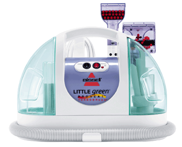

I removed the B-pillar cover and tested it with a Bissell Little Green mini hand cleaner wet vacuum and a 50/50 mixture of water and Folex carpet cleaner from Home Depot (which I have used on carpet for many years with great success). It worked great on the pillar cover so I got bold and did the whole headliner. This latest truck had been smoked in (cigars) and after two full passes on three days across the headliner, it looks absolutely brand new. I was amazed at what came out in the discharge and I couldn't be happier. Neither the Folex or the water caused any damage, and because I didn't scrub it with anything, the headliner looks new and isn't rufffled or fuzzy.
