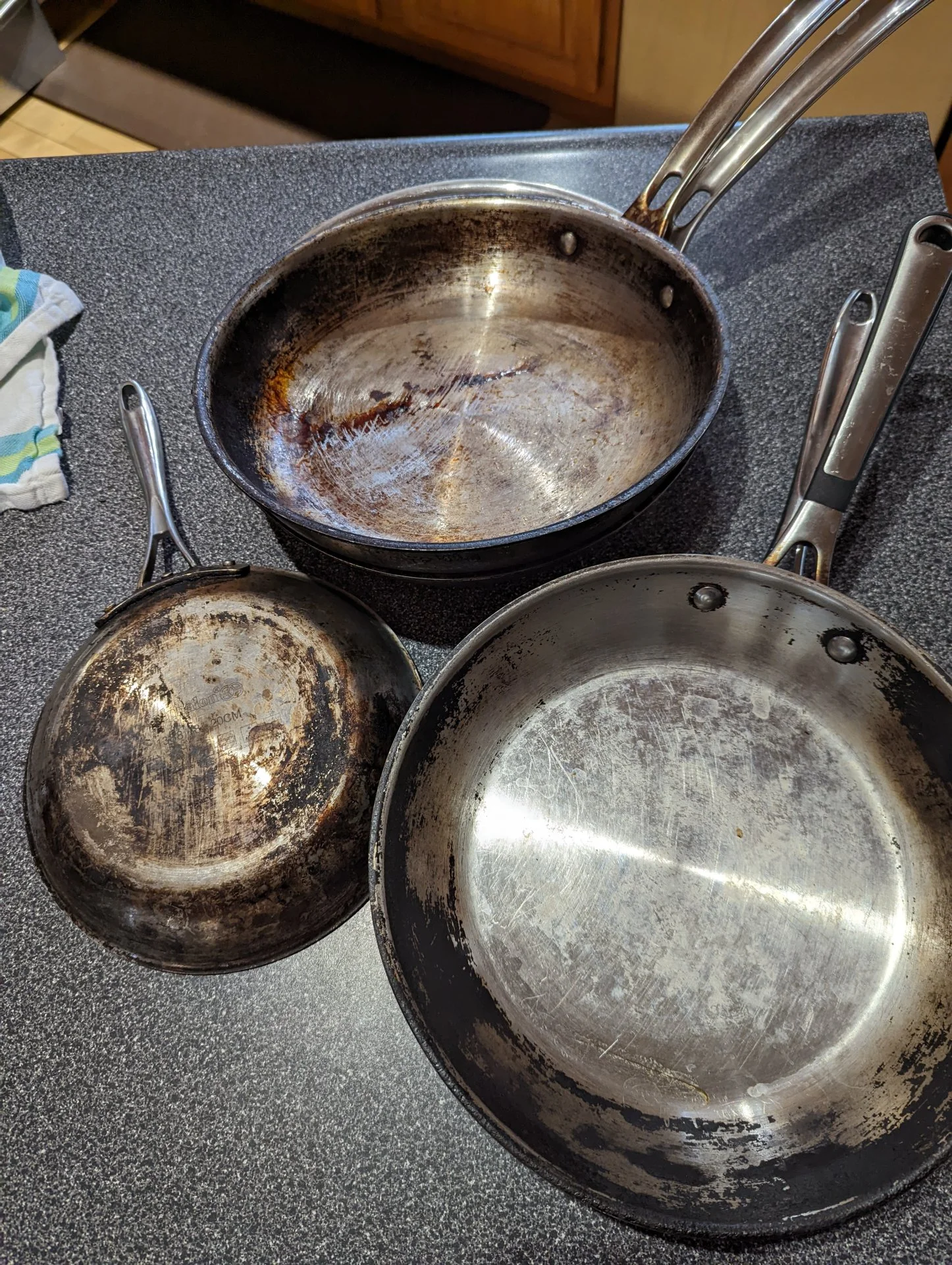

GF is forced to close her restaurant (thanks COVID), so we're frantically cleaning the place out. She has a pile of used saute pans, all of which saw heavy production over the years. Most of them are junk but there's a few nice Viking and Calphalon SS pans that I'd like to clean up and restore.
Anybody got any tips on how to get the many layers of scorched stuff off? I've tried Brillo pads and Bar Keepers Friend with not much luck. I did try boiling some lemon slices in water in them, and that seemed to help, scrubbing with a brass wire brush. But that won't get the stuff off the bottoms.

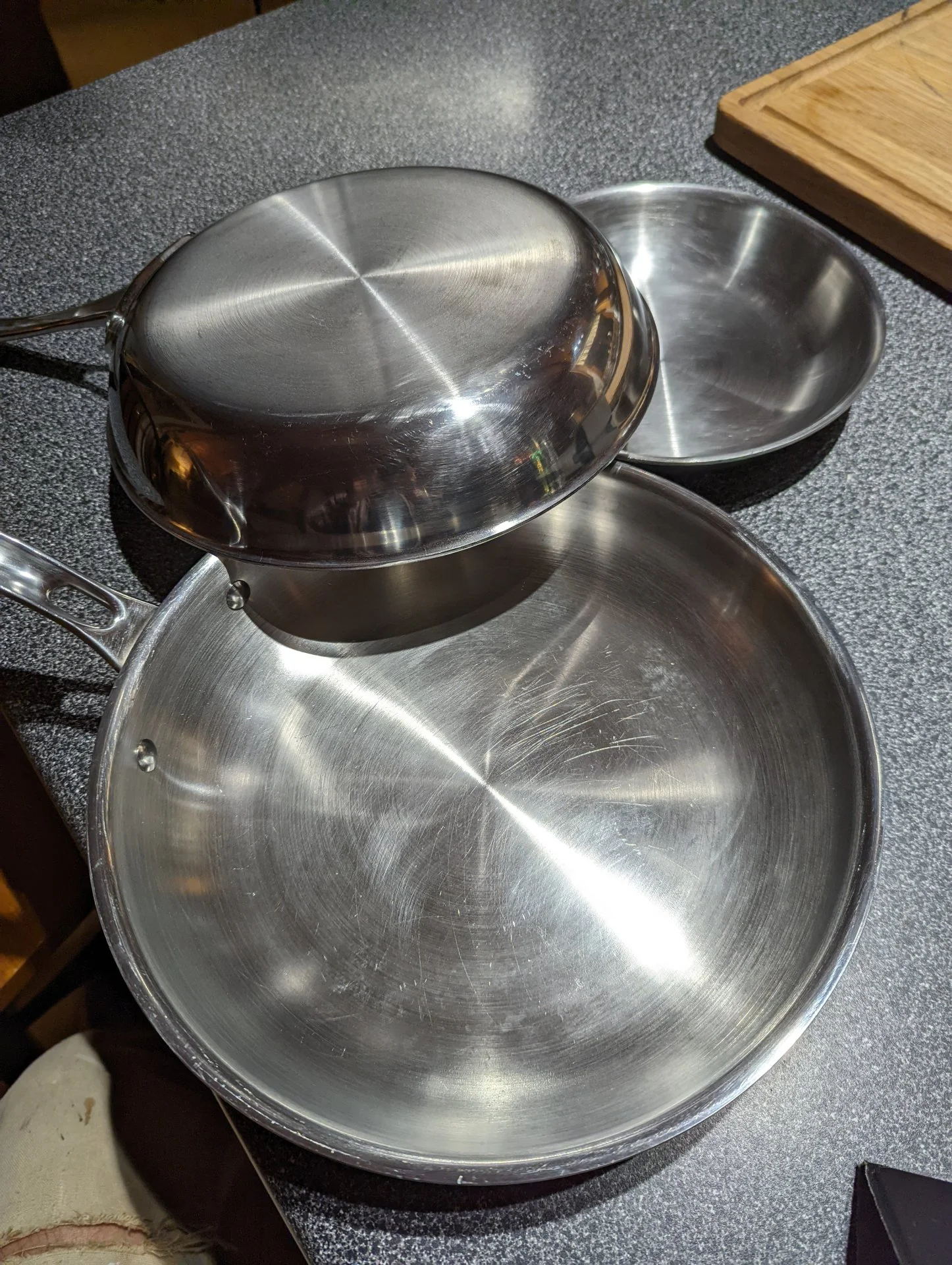

Circling back to close the loop.
Tried Bar Keepers Friend and SOS pads, barely made any difference after lots of scrubbing.
Tried the HD Easy Off, I wasn't impressed, it just didn't do much.
The other day I was cleaning out the garage and came across them, I was gonna just toss them into the scrap metal pile. Then I had an idea: the Easy Off just needed more time and heat. So I hosed them down with the stuff, used the entire can, and put them inside a black trash bag, which I set out on the lawn in the sun. Let them marinate all day. Later I pulled them out and the black goo scrubbed right off with a SS scrubby pad. I gave them a quick sanding with some 600 sandpaper, them a final scrub with Bar Keepers Friend. They look almost brand new now.
Thanks @jvalex for the idea
