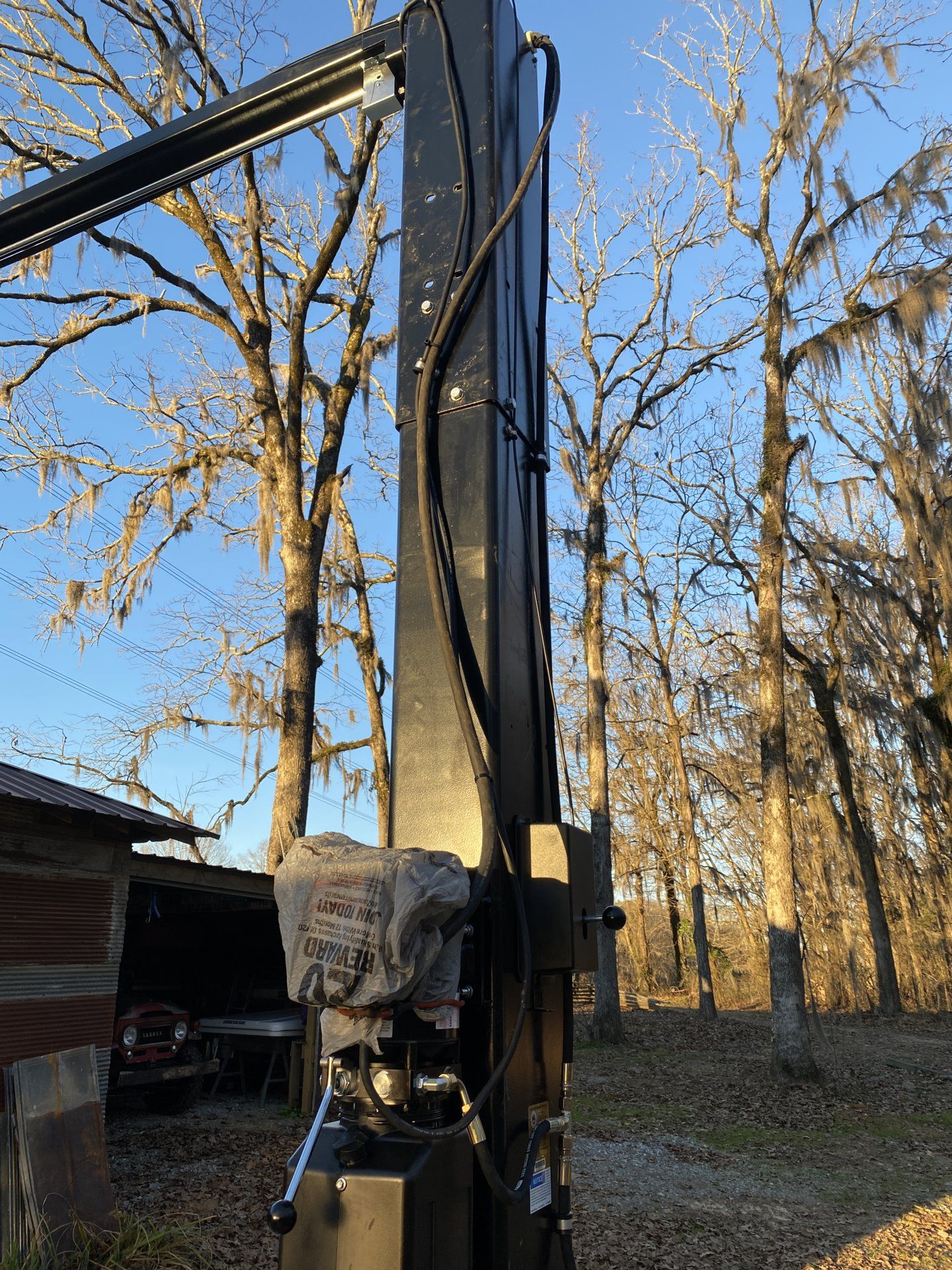

We went to wire my lift up and using the crappy diagram just could not get it. Broke down and called customer service.
Turns out they sent me a 3 phase motor.
they sent a new one and yesterday after work I got it installed.

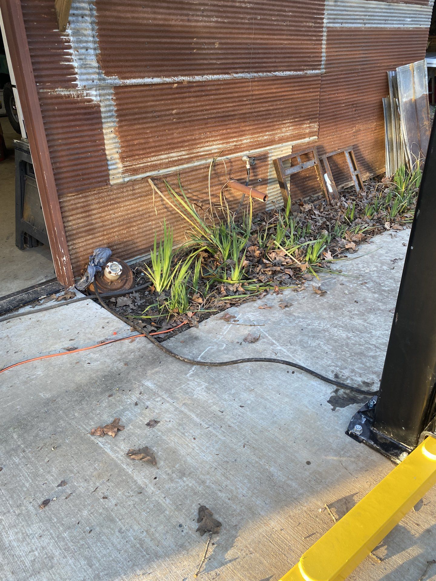

I got all the air bled out and the temporary wiring hooked up. I looped my 30’ welder extension up and over and bought a new extention cord off Amazon to get it going until we wire the shop.
Red and Mitch approved
Plastic bags to keep the rain out
