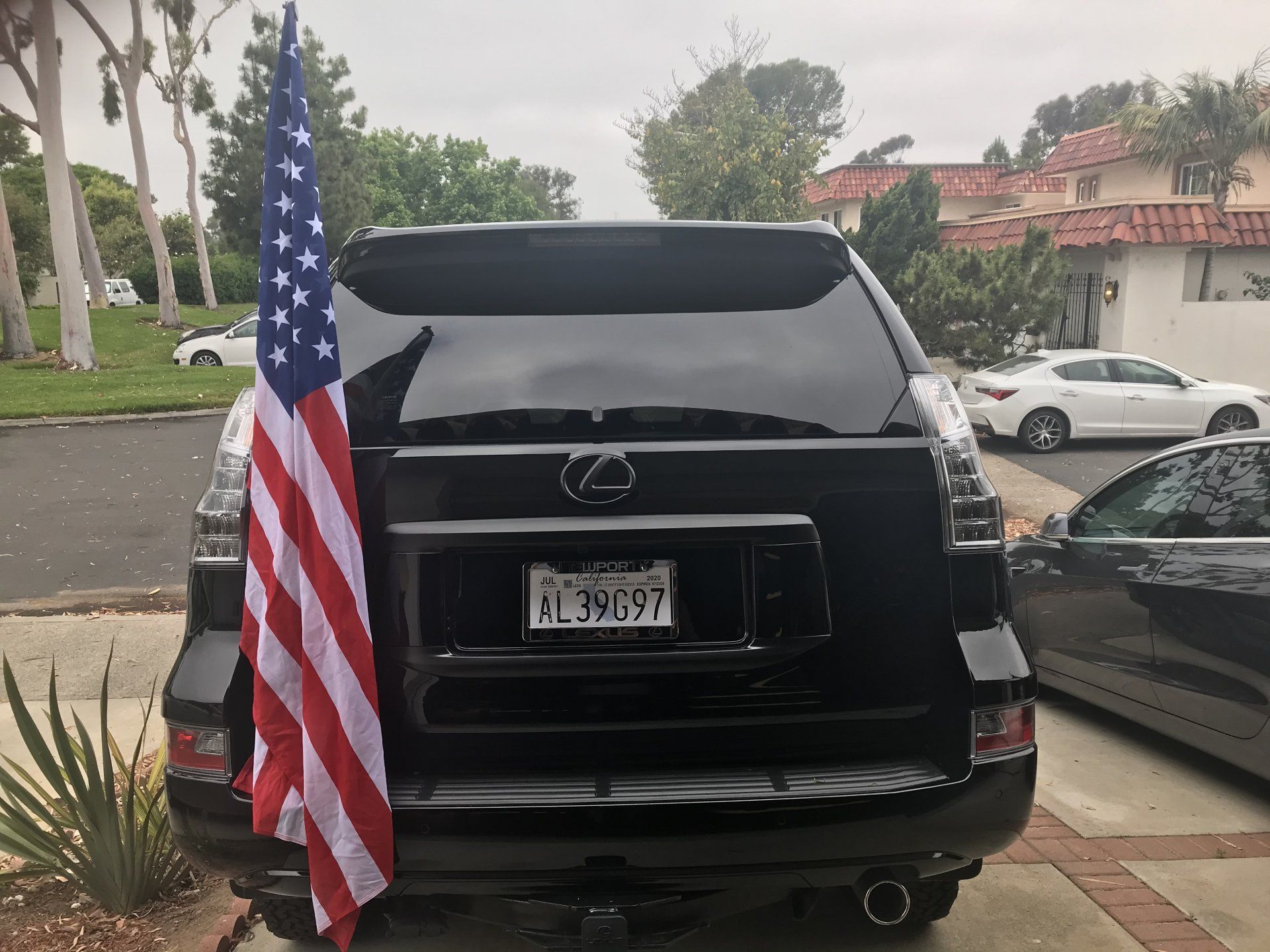

I think it turned out great! I'll move on to the sides in the next week or two.
I've also ordered BlueBat overlays to get rid of the Altezza look. "Red with the signals cut out" This should clean up the rear nicely.

It's black. The Dip Coat is supposed to make it even darker. I'll try to take better pics tomorrow after the coat.
I need to get another vinyl quote before I move forward with spraying mine. Yours turned out great @Littlehouse, I've never heard of that product before.
Thanks Tex. Check out Dipyourcar.com if you go this route. The HyperDip is specifically made for cars, and supposed to be darker than the regular PlastiDip. I got this kit for simplicity and didn't even use one can for the work you see above.
The bottom photo shows best the color! ;)

That’s the beauty of dip. The second pic above is the ultimate prep. It’s not like paint where you tape all the way up to the emblem or trim. You leave space and spray onto the paint. The real key is to spray the same thickness on the paint as the emblem and trim. The Dip will cut itself perfectly when it comes to a break. Plenty to do the front and the rear. The kit comes with 3 cans, and the back didn’t even finish one can.
