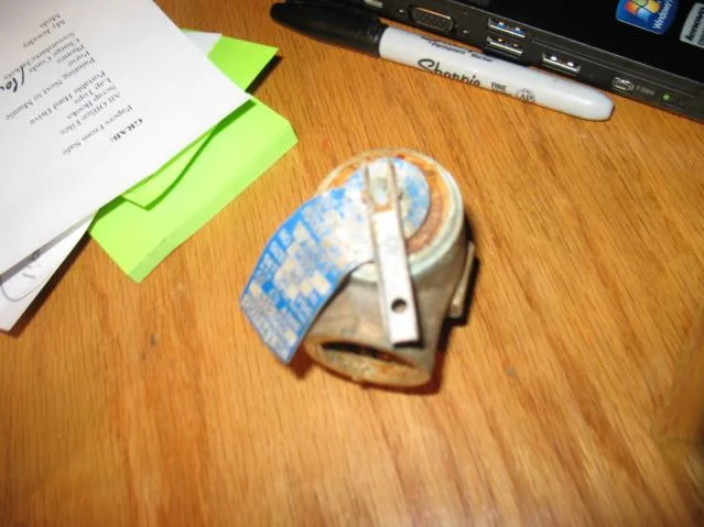

After watching the exploding water heater video on Mythbusters, I went to the basement to check the T/P valve on the water heater and the P valve on the radiant heating boiler. The Pressure valve on the boiler has been shot for a long time
I'm such a dumbass for not checking this annually.
A word of caution: if you see scaling on your valve or it just looks plain jacked up, do yourself a favor and get a replacement instead of operating the tiny lever on top to see if it operates smoothly. In some cases, it may just stay open and boy, would you be pissed off
Anyway, just a holiday reminder to check your over Pressure/Temp valve for the sake of your loved ones. Also, make sure that the hard pipe that is attached to these valves drain the water *away* from the valves. Some jurisdictions require that this drain pipe takes the hot steam outside the home, others have you direct the hot steam right above the floor. In my case, the slope wasn't correct and the boiler Pressure valve was sitting in water since 1985. Again, I feel like such a dumbass.
These valves can be found in most big box stores but I found the price to be much better in a true plumbing supply house ($38 vs $24 for the same exact model).
