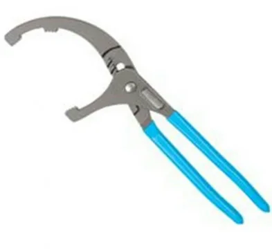

A pair of these,
a well-sealed hole in the floor, an electric impact wrench with a 22mm deep socket, and the shocks are off in literally 30 seconds. :lol:
