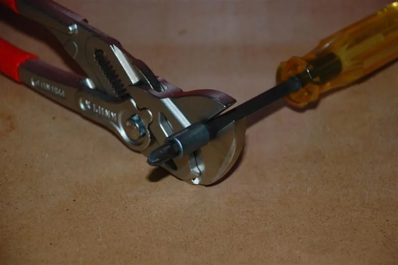

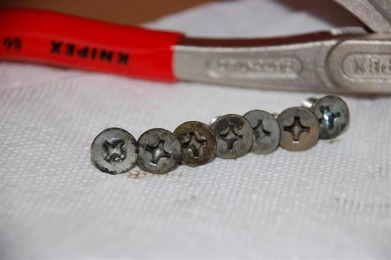

I grabbed my newly acquired Knipex Plier Wrench (thanks Robbie for telling me about these wonderful pieces of engineering!) and used an Apex (R) bit in an Apex screwdriver style holder and decided to try tightening the one that had cammed out. I heard it creak, and I reversed the pliers and was able to back it out with only a reasonable amount of effort! Was I on to something??? I creaked the next screw in, and it came right out! All the rest of the screws came out easily with this method of tightening till it creaks and then unscrewing.
It may have been possible to brute force them loose, but tightening them first seemed to make a big difference. I swear it worked for me.
If you're trying to remove them and you start to cam out, clean it and try tightening until you hear it crack. Then back it out normally. This might save you having to drill out a screw.
Pics show Knipex pliers on driver, and my screws with the one that almost screwed up my whole evening.

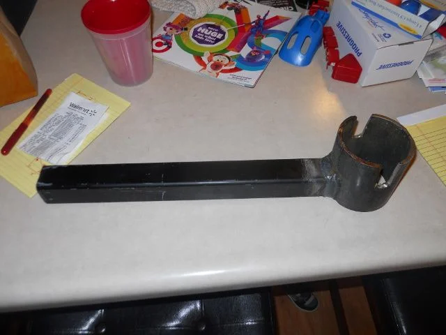

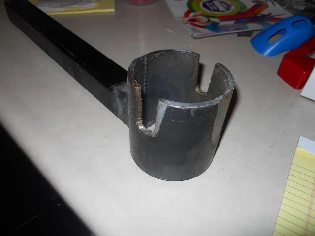

I made the tool below to hold the crank pulley while I removed and installed the bolt. The steel tube is 3.5"OD, 3/16" wall, and the slots are about 3/4" wide by 1.5" deep. The tube slips inside the crank pulley and engages the bosses in the casting. Worked pretty well.

Heh - that's a great way to hold the pulley. Was it stable with force applied or did you have to secure it somehow while you cranked on the bolt?

It stayed in place pretty well, actually. The recess in the front of the pulley has a bit of a taper, so the end of the tool "wedged" in place with a light tap from a hammer. The handle braced against the passenger-side frame rail.
