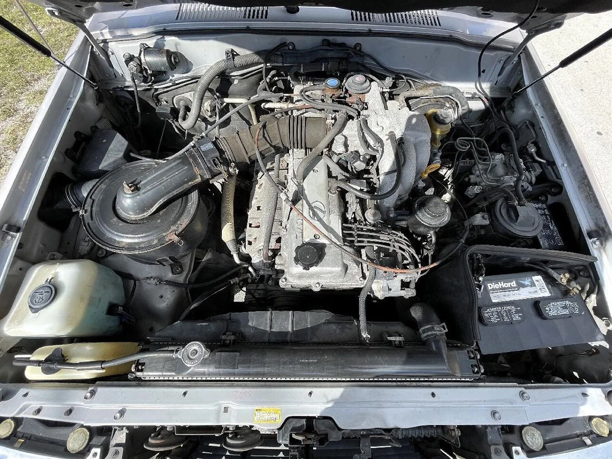

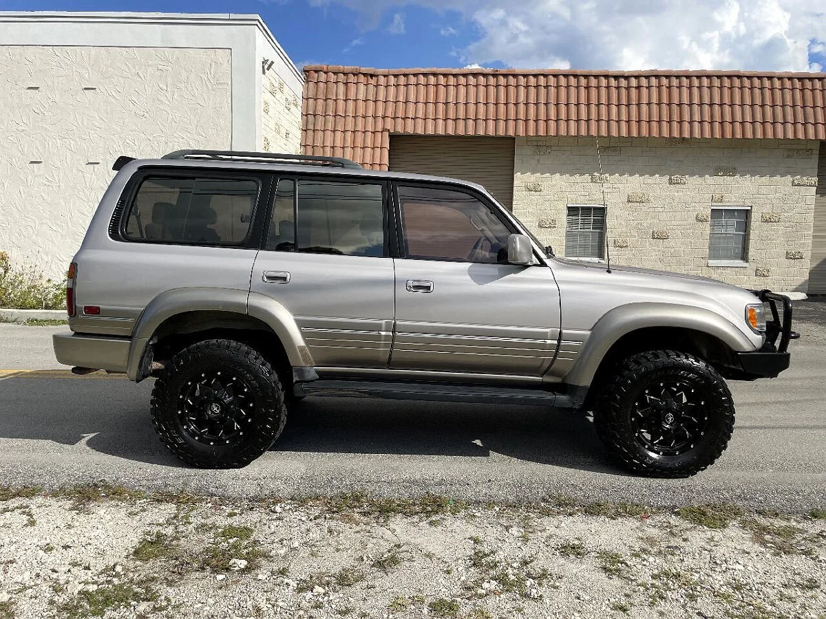

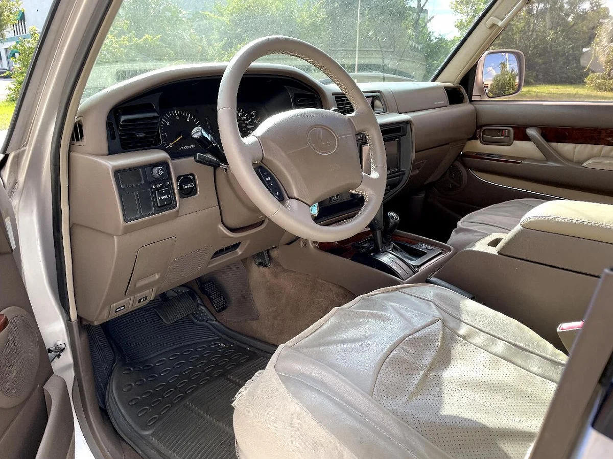

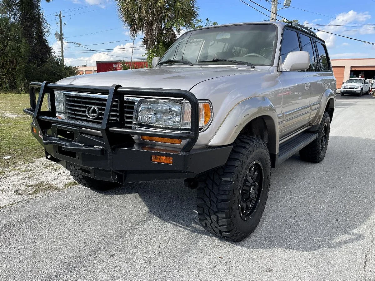

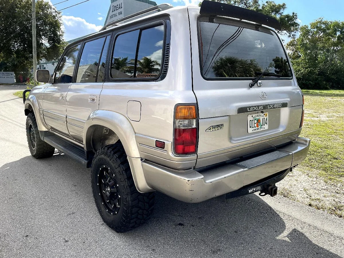

I have been lurking for a month or so, but thought I should introduce myself and my truck before I start asking for advice. I picked up this triple locked 1996 Lexus LX450 in August from a dealer in Florida through eBay. It will be a weekend, scouting, camping, occasional snow, and maybe Outer Banks beach trip vehicle for myself and my two kids. My fiancée isn't in love with the truck yet, but maybe she'll come around. I had it registered as historic, so definitely won't be a daily driver. It was originally a Texas vehicle, so very little rust on the underside. The interior could use some restoration and I may eventually repaint the exterior. I am getting ABS and Check Engine (EGR) lights on the dash, so I'll have to investigate those issues. I'll update this thread as my journey progresses. I welcome any advice or comments they community may have.
1996 Lexus LX450
Triple Locked
Color: Champagne Pearl
Miles: 204,594
Purchase Price: $13,500
Previous Owner Mods:
ARB Deluxe Winch Bumper
OME Lift Kit
XF Off-Road 17x9 Wheels
Mastercraft Courser 295/70/17 Tires
Pioneer AVH-X490BS Head Unit
Rear View Camera
Tow Hitch
