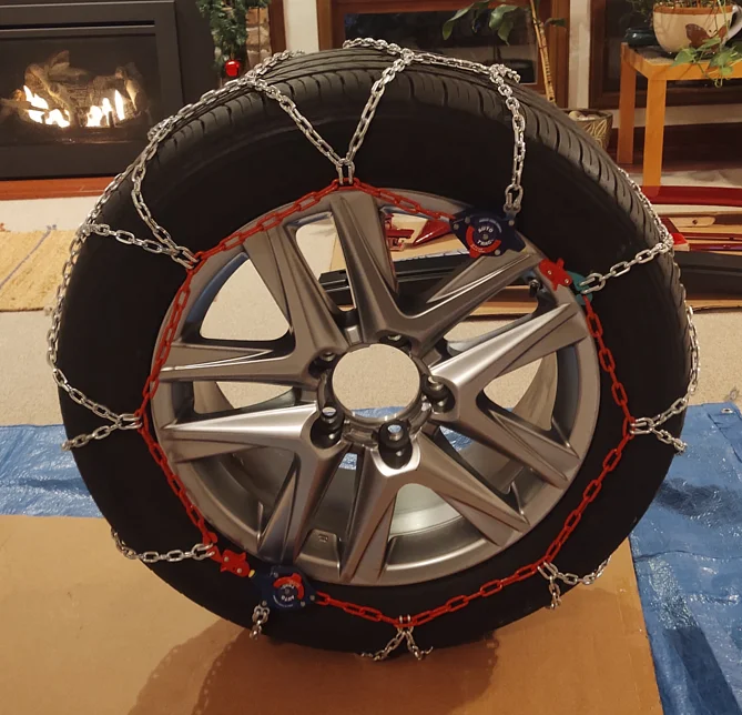

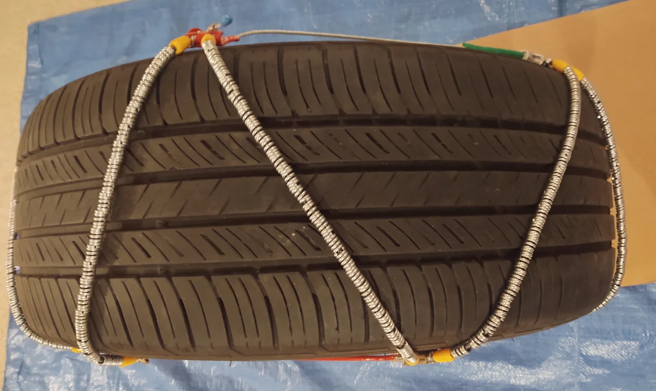

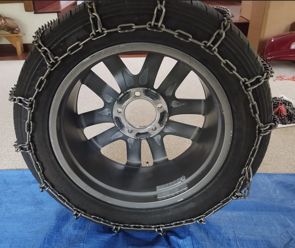

Here is what I've tried for fit using my spare...

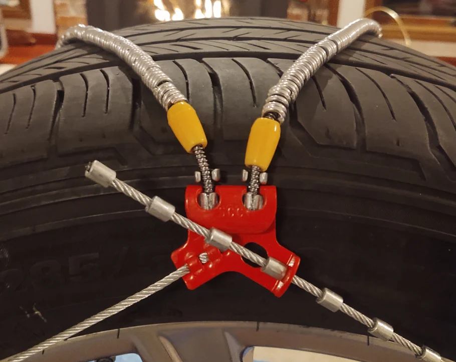

Security Chain Company Z-579 Z-Chain
They are the z style (at an angle to the thread) - good, but the fit is not so great requiring a spider that is not included with the cables - not a big issue as I can buy them separately. What I do not like is the ends of the cables that are sticking out and you are supposed to tuck under the plastic sleeves (green in the picture) not very secure.
Amazon product ASIN B001H9GQR4

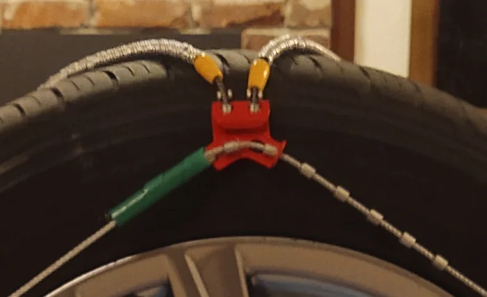

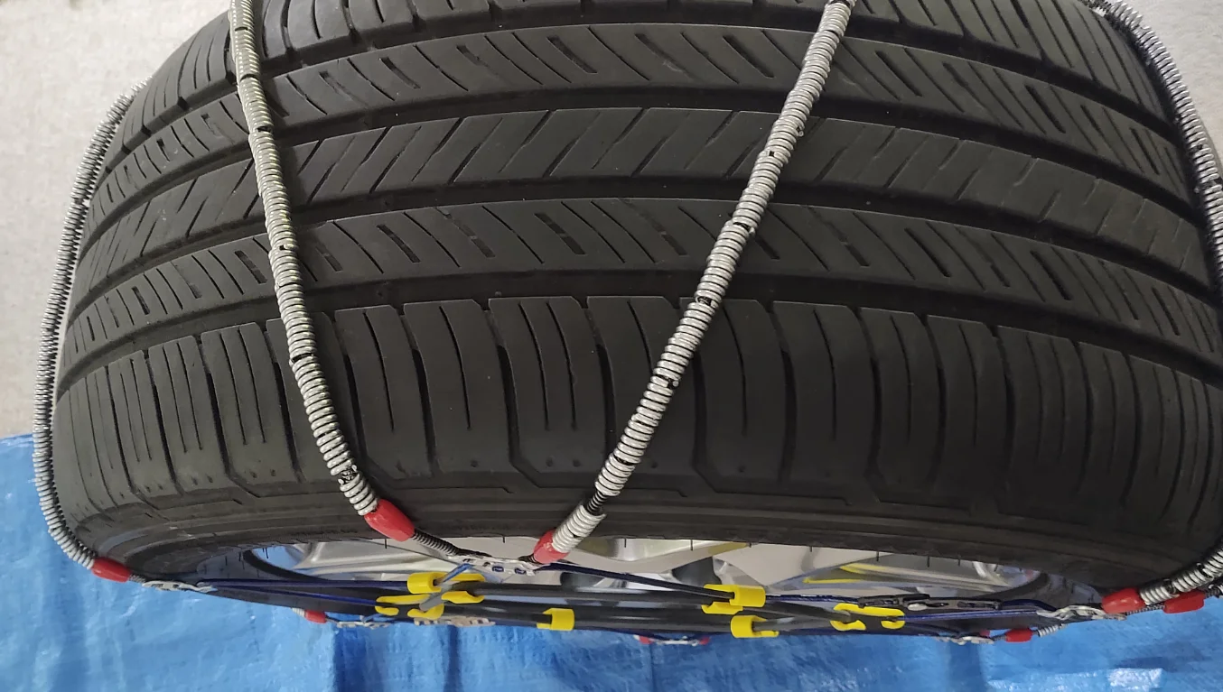

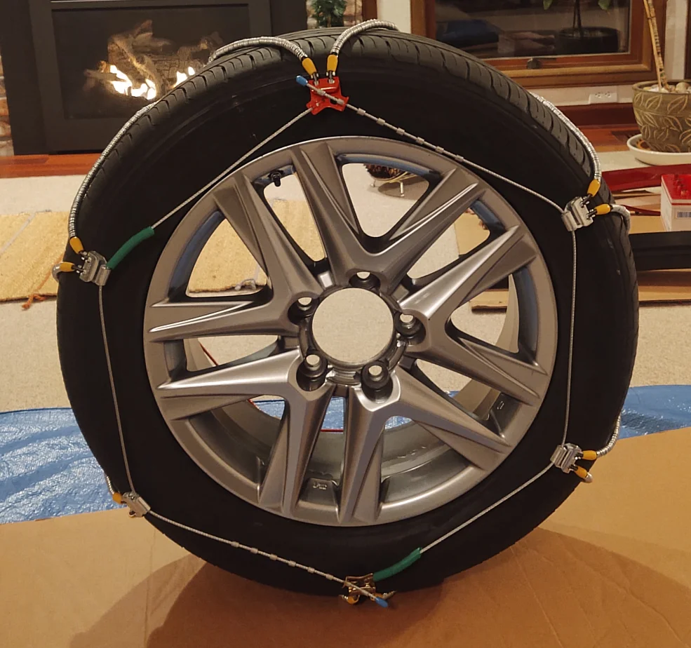

Security Chain Company SZ451 Super Z6 Cable Tire Chain
Amazon product ASIN B000HZBRSC
[Update 2020-02-10] They are z-style like the Z-579. They do come with the rubber tensioners. Spare tensioner is SZ1176. The cable disconnect is more secure and also harder to hookup. But they do feel lighter weight and the way the Z cables secures into the Y plates is not as good. They are also on the large size for my tire size, the rubber tensioners being kind of relaxed. Compare the tensioner pics with the pictures for ZT751 both installed on my tire.
This is the smallest profile chain, but it is still not fitting the front wheels because of inner cable (round around the wheel connecting the Z cables in the back) rubbing on vertical arm (from spindle to the UCA). A chain with a larger inner cable diameter is needed. The clearance between plates and the vertical spindel arm is Ok but small. The clearance between UCA and cables is good. [end update]

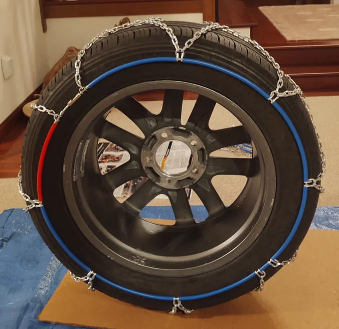

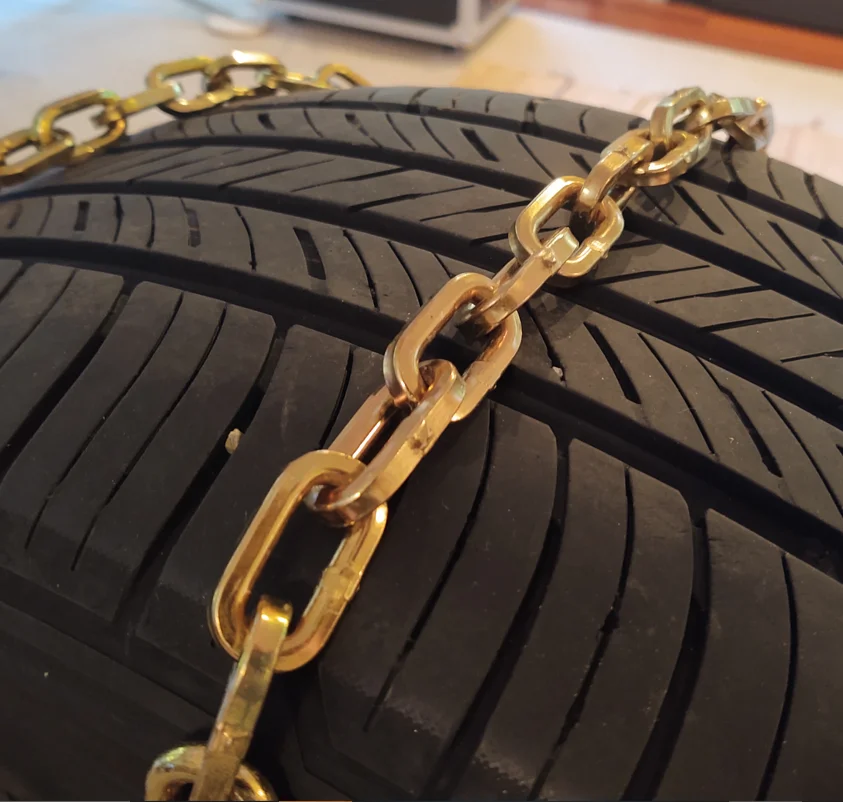

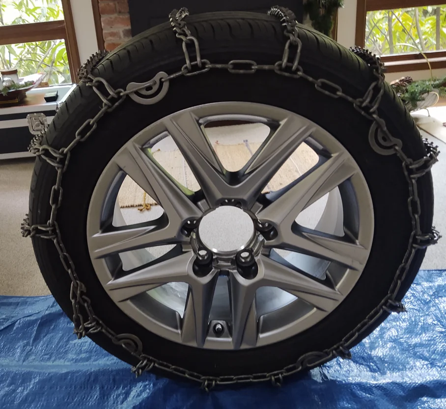

Security Chain Company QG2828CAM Quik Grip V-Bar Light Truck CAM
Amazon product ASIN B00HRI5MQA
I got them in sale at 30% their cost so I posted them in classifieds before returning them; too aggressive for my use.
For my tire I need to cut 3 links from each of the two ends to make it a perfect fit, with no links flapping around. They are not suitable for dry pavement or even thin snow as they are going to damage the pavement due to the V-band claws.
The steel has a gray coating not sure if paint or just a clear coat.
Weight 14.4kg / 32lbs.

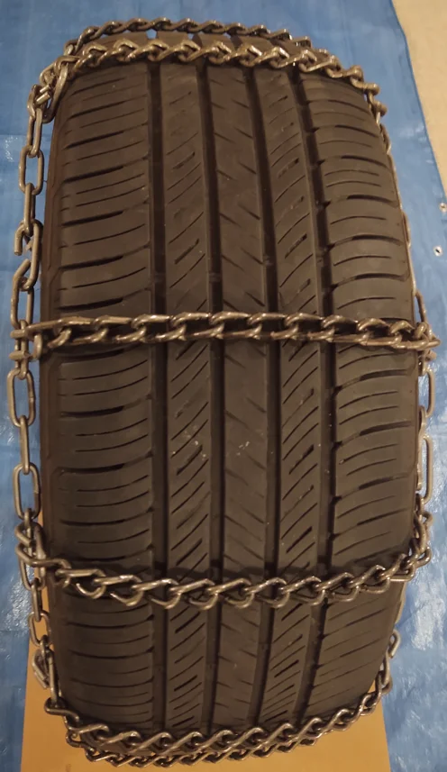

Peerless 0232805 Auto-Trac Light Truck
Amazon product ASIN B0091RCM5Y
This is a lightweight chain even compared to the other chains listed here, so you can say it is a very light chain. The slack control system is clever, but I do not trust it being made of plastic. It also not working quite well on my size tires and the chains overall are a bit large for my tires. The plastic tighteners are loose around the wheel and can possibly scratch the wheel. They are not listed compatible for my size, but I just had to try it.

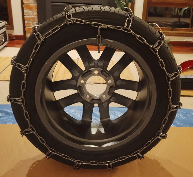

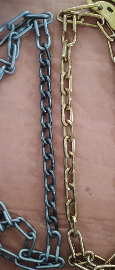

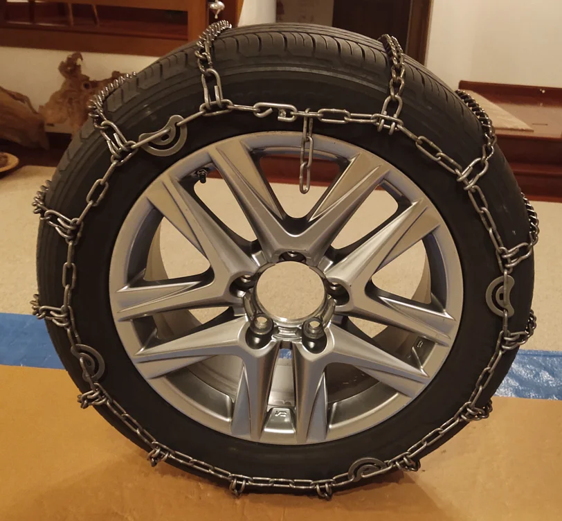

Security Chain Company QG2128
Amazon product ASIN B00JFS9Q30
They are very similar to QG2228CAM in fit and build. The difference is that they are zinced, and the chain links are made of square wire instead of round. The links are regular oval links not twisted. Wire thickness about the same.
Weight 12.29kg / 27lbs
These have the best fit of all devices I've tried on my wheels.
The fit in the back is great.

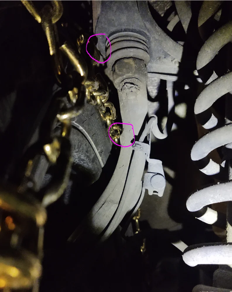

The fit in the front is not good. The chain is very close to the UCA and it is actually rubbing on the vertical arm of the spindle.

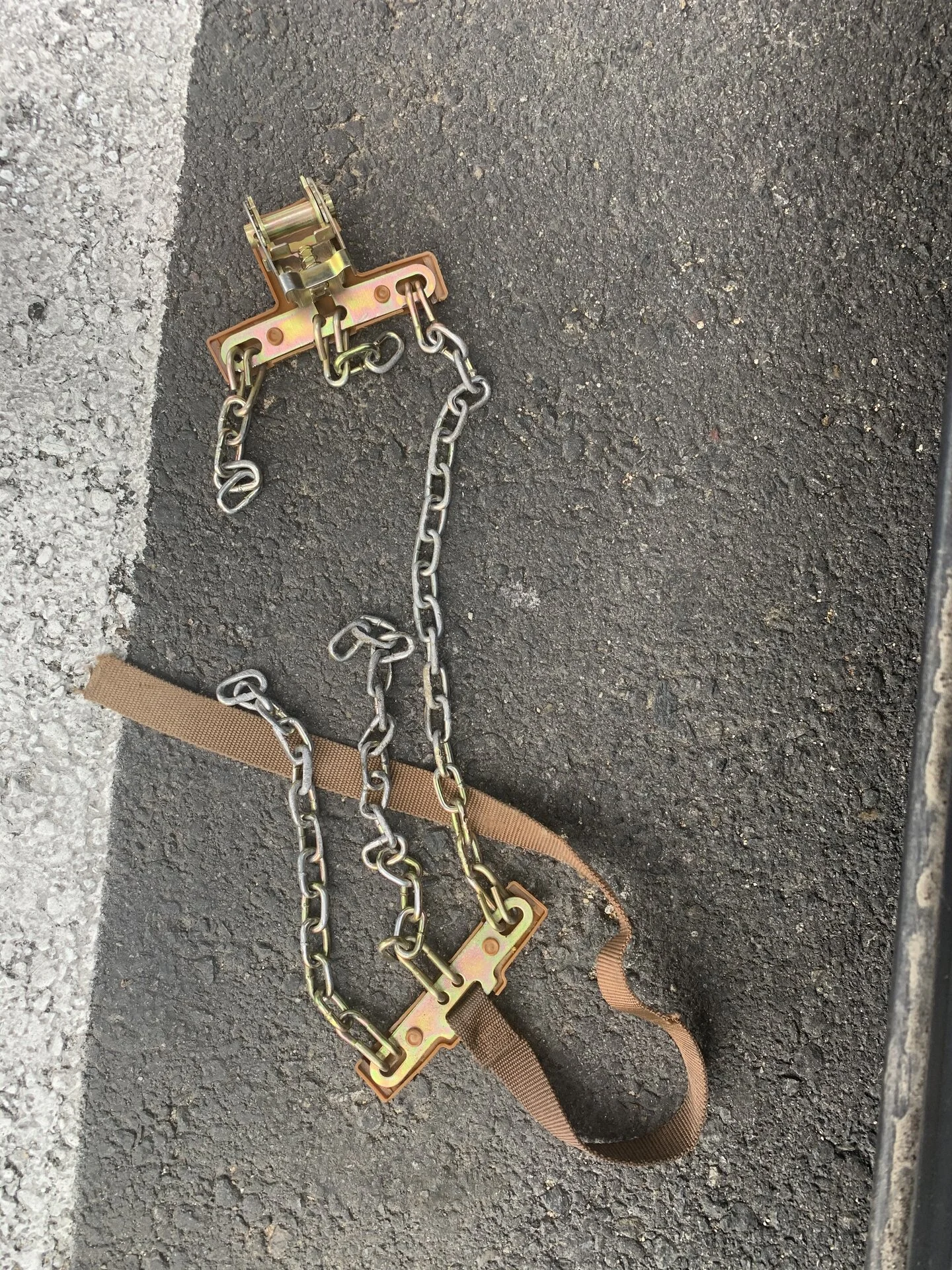

For storage in my trunk, I used a Home Depot Husky 12" tool bag. They fit well. The Harbor Freight Tools Voyager 12" tool bag is larger than needed.

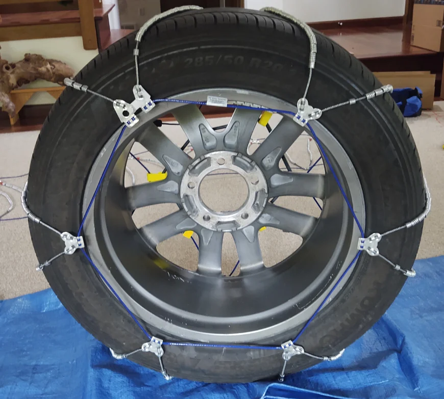

The cams are keeping the chain very tight, but just for insurance I also got a set of spider tensioners: TireChain.com 39225 Truck SUV Spider Tensioner Tightener Bungee Tire Chains
Amazon product ASIN B07DWP2P82

Brake lines are not an issue on the front unless you throw a chain/cable and it wraps around the hub. That same damage can happen on the rear axle.
There are 5 points of possible contact on the front of the LC and 4 on the LX. I used a 3/4 inch block of wood as a go-no-go gauge.
#1&#2 -CK at the fender front and rear of the tire and minor turns.
#3-Aft tire contact on the frame at full lock turn.
#4-Ck the UCA and spring perch area (side wall bulge on the inside top of tire)
#5-Hard right turn tire tread clearance at KDSS bar (W/KDSS only).
