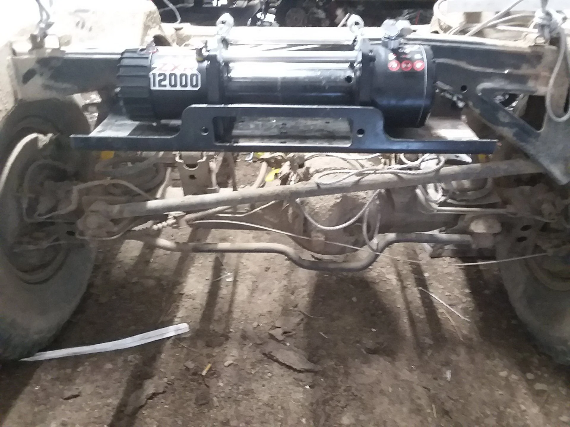

What I have in mind is locating the winch behind the last cross member on the 80 chassis. The one that also holds the bridge for the coil spring mounts. I'll fab a generic winch mount there. One that I can change the winch out later if I needed to. The cable would exit in the center of the chassis to the rear. There it will contact a boxed and reinforced single groove sheave. Through the sheave and exit to the drivers side. Into another boxed single groove sheave. Like a crane, they would both have centering runners welded into the box that houses them so when the cable was slack it would not run out of the groove slack or under tension. After travelling around the second sheave it would travel through a tube ( I think) directing it to the front of the truck along the drivers side. For safety purposes in case of cable breakage.

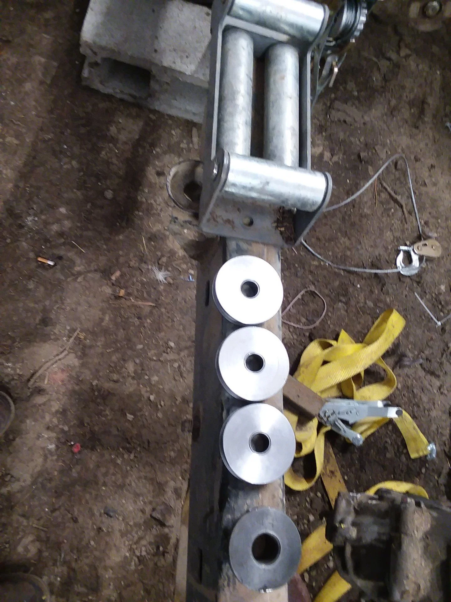

The pulleys I am using are 3" diameter billet with a 3/4" bronze bushing. These are parts ordered for a bend pac hydraulic car lift. They are each rated for about 6k pounds. I ordered three of these. The Sheave block I build for the back of the frame will house two, with the third for a spare of if I need it to redirect cable under the chassis. I'll post pictures of everything once it arrives.

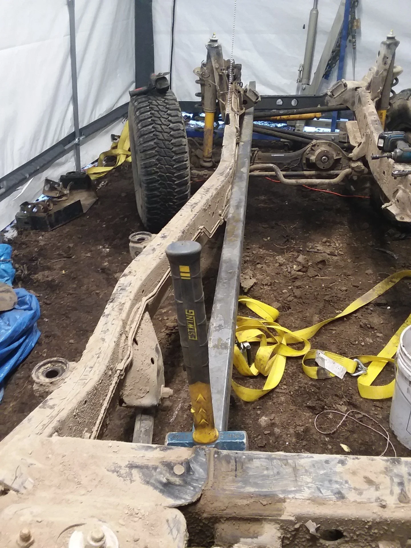

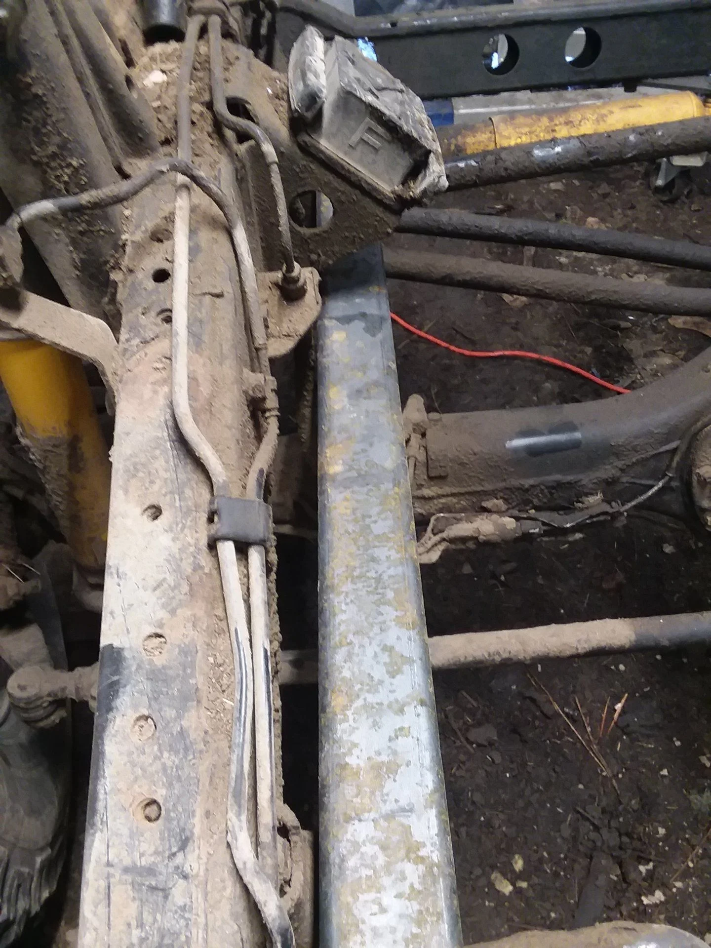

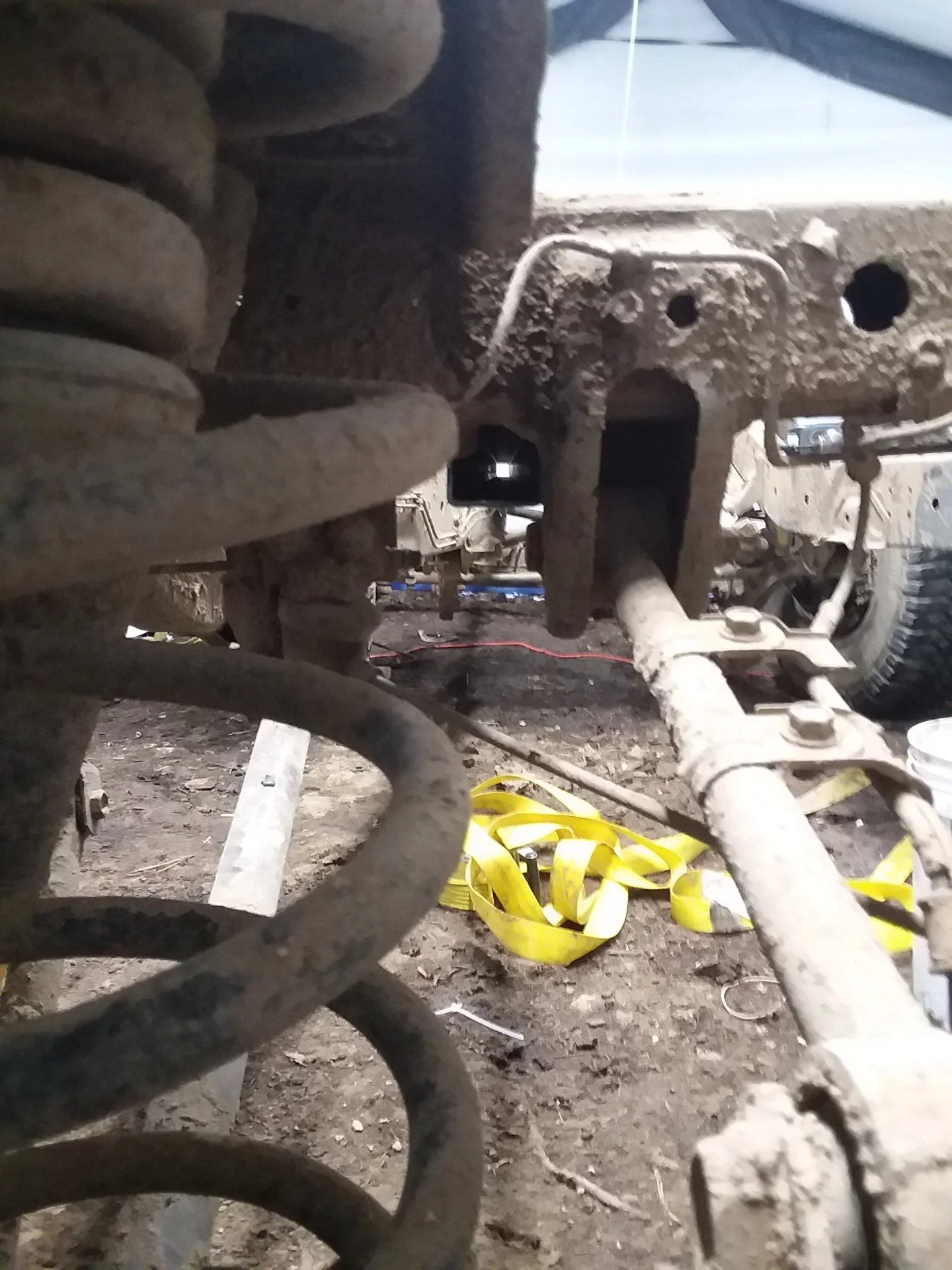

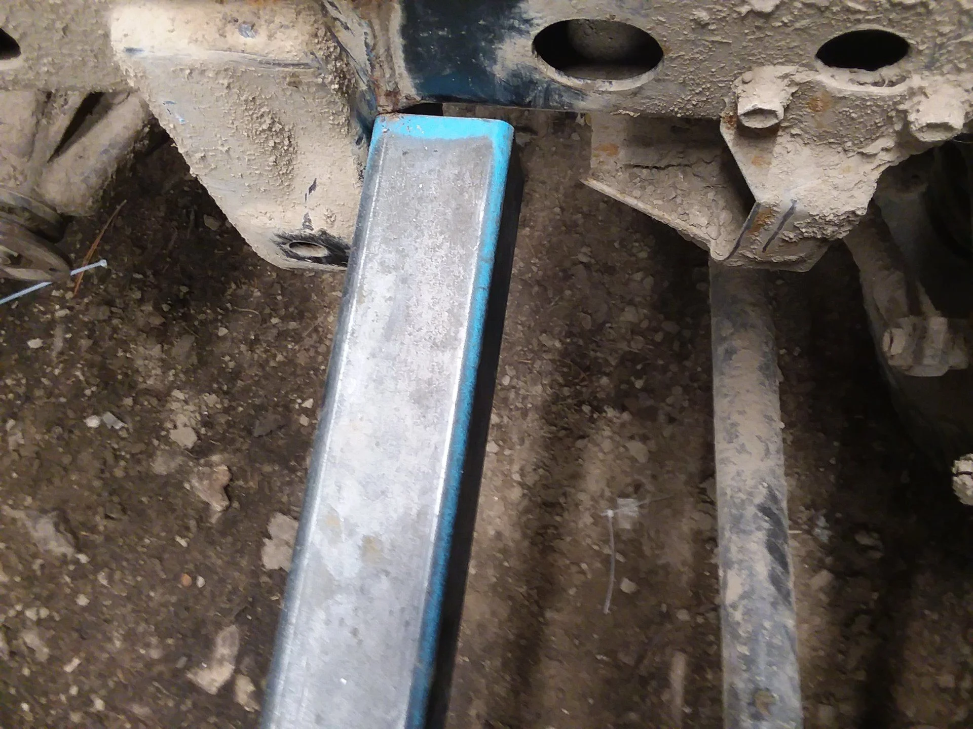

Made some headway on this today while working on the truck. I decided tubing was a better way for the cable to travel versus being exposed under the truck. This will protect the cable should anything happen but more importantly it will protect the other parts under the truck should the cable break. Here are some pictures of where I'm at.

for this reason I would strongly avoid to keep the line inside a tube .
inside a tube will make it difficult to unwind the rope /cable in case you need to .

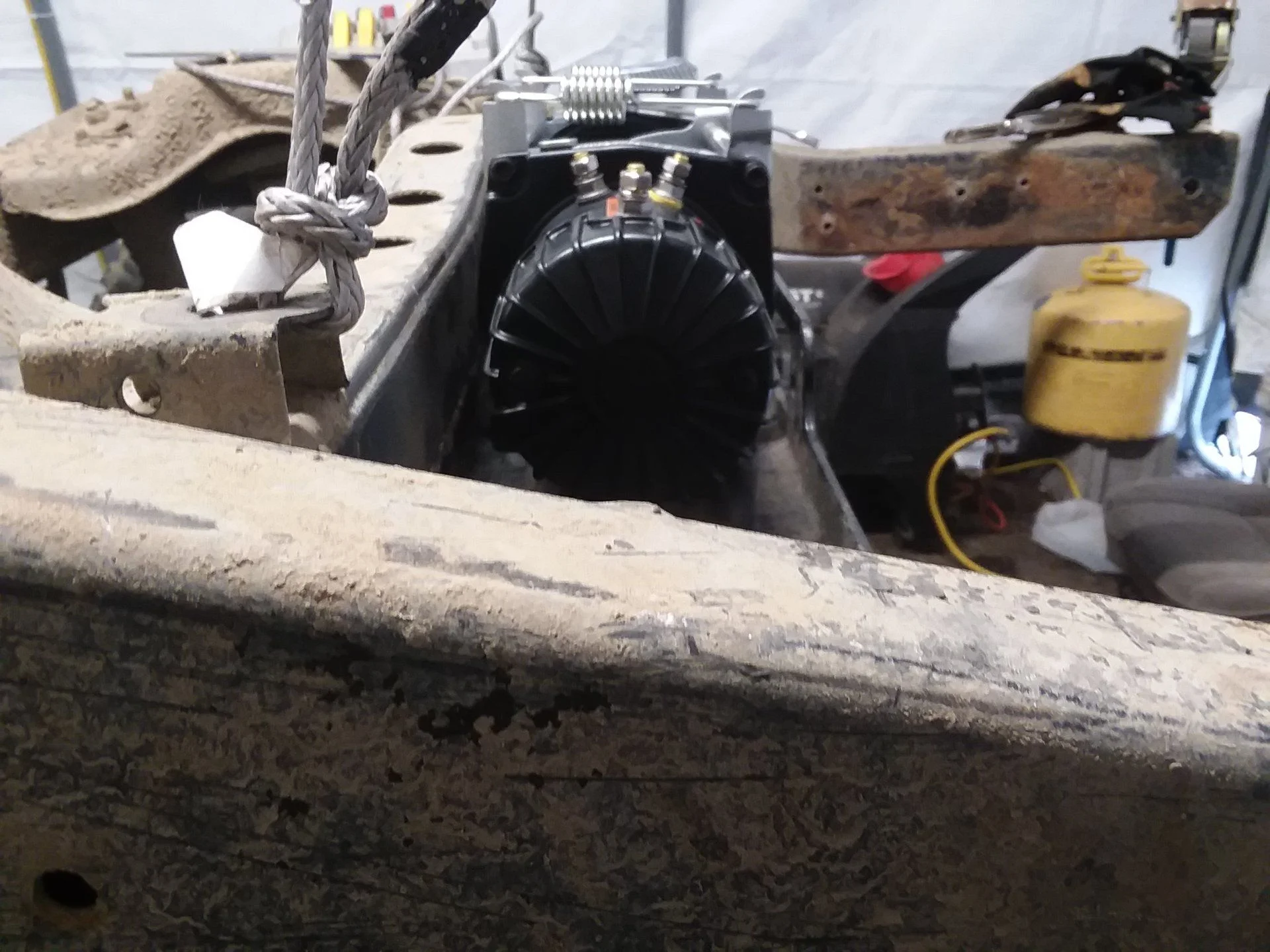

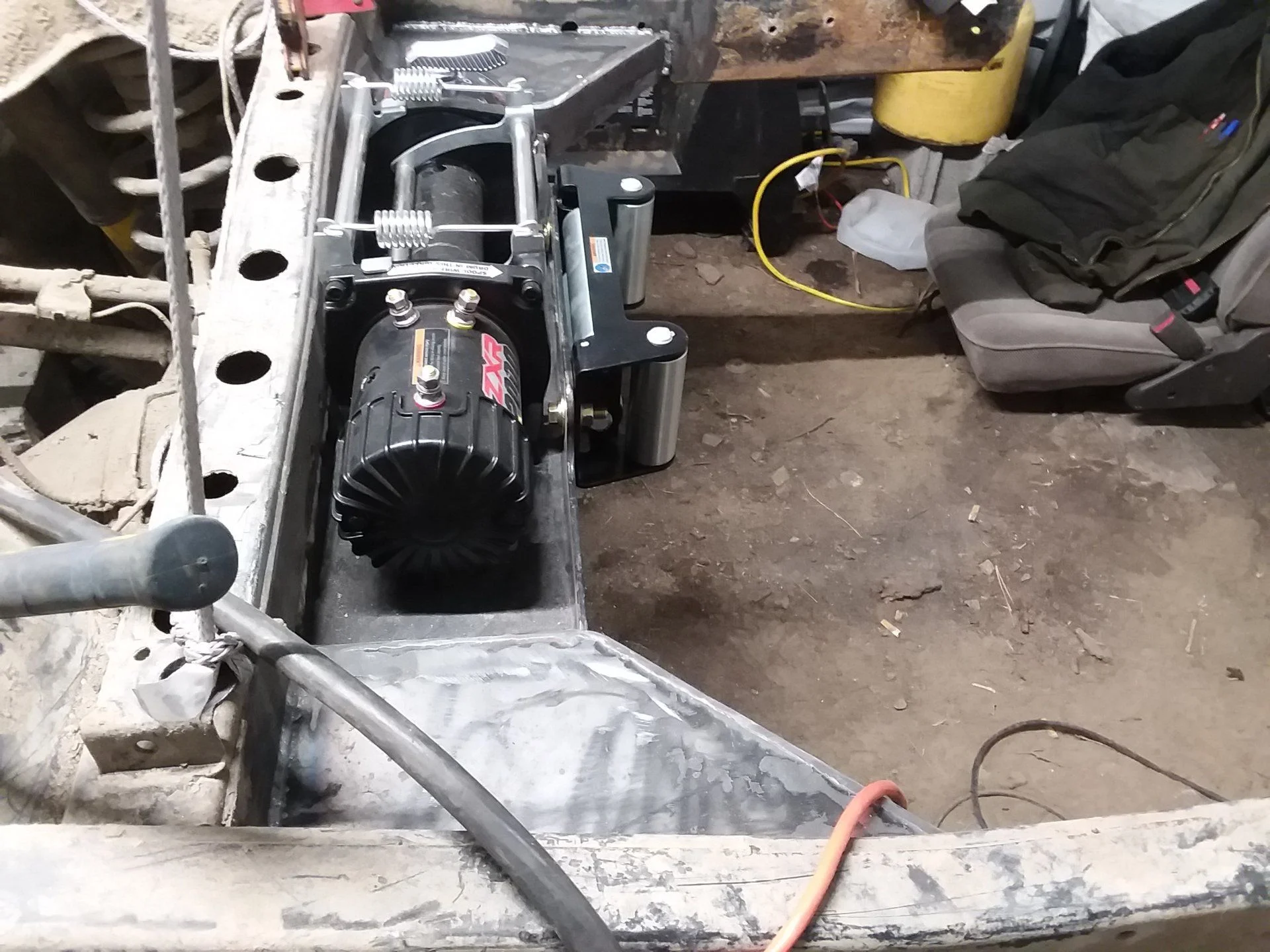

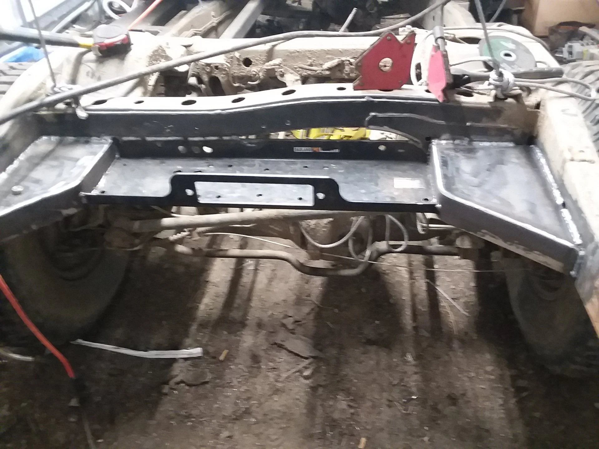

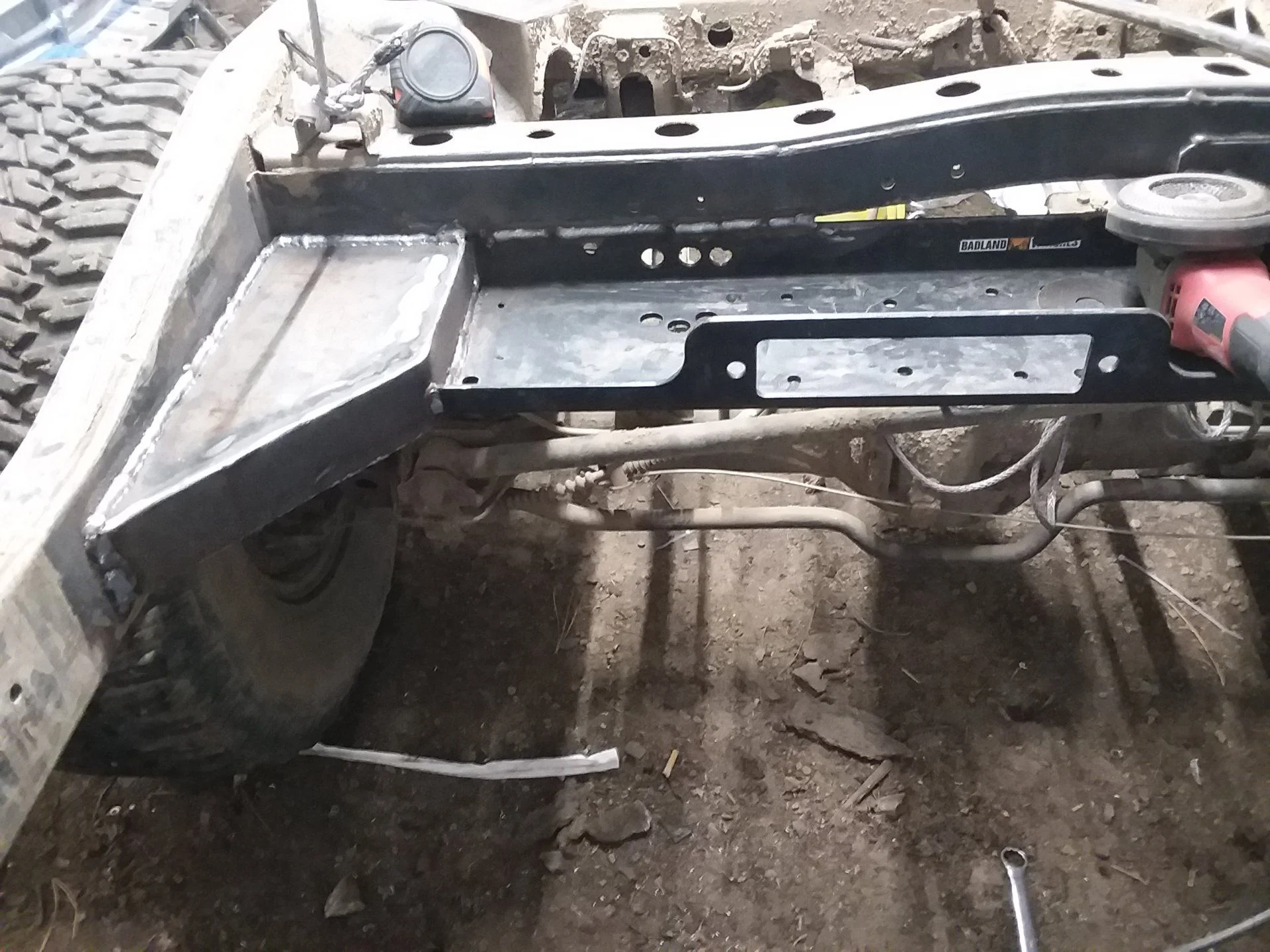

todays work on it. I used a universal winch mount as the base. Located it as low as I could on the rearmost crossmember while still giving clearance to all of the suspension components. Burned in both sides and started on the gussets, sheeted them out top and bottom. At this elevation it is about 2" higher than the tubing going forward. This will need to be corrected in the rear sheave block but shouldn't be much of a problem using winch rope.
Here it is all welded out. Still have some grinding to do but otherwise it's ready for primer. I went ahead and assembled the winch with the roller fairlead but I am not sure I will use it. I have a number of hawse fairleads on the way. As a side note, this added a ton of strength back there. With the addition of the rear bumper structure this will be as solid as a one ton truck back there.
How hard will it be to remove or repair that winch if needed when the body is installed ?
If it was getting some sort of standard bed, no harder than loosening the bolts and lifting the bed up about 8". Mounting bolts are removable from the bottom, cable leads are easy to reach and remove.
BUT, since I am building the bed that is going on this truck, I will likely build in an access for it.
Can you rotate the electrical and free spool 90 deg? Just so they’re not right on top?
I’m sceptical of those 3” bend pak pulleys. There is a lot of load, and these are going to
see offset loads, not consistent. I’d think that each should be at your working load limit,
capable of 12K. Binding side load is what I’m thinking without knowing your routing.
My thoughts are with Renago about the tubing of the cable, I’d think to leave it
open but I see your thinking.

The pulleys are rated for more than 12k pounds, they are solid stainless with a 3/4" shaft. I fully understand the loads involved, you'll see what I mean when the rear sheave is completed. No one piece or pulley will be bearing the weight alone. As far as rotating the electrical connections and free spool, I don't know why I would. There will be plenty of clearance in that area. With the connections covered with rubber boots there is no problem there at all. This project is getting a custom fabricated bed, most likely with an access to the winch ( I just typed that in the question above) I have a plan for outboarding the free spool lever, won't be hard. I don't understand the concern of the tube? It's just a protected clear alley way for the winch rope to travel without getting abraded, dirty or hot. It is there to keep oil, fuel or anything else from coming in contact with the winch rope. It will not be a structural piece of the winching system and will bear no weight in a pull. A centering fairlead at each end will assure that it passes cleanly through without contacting the tube at all...
