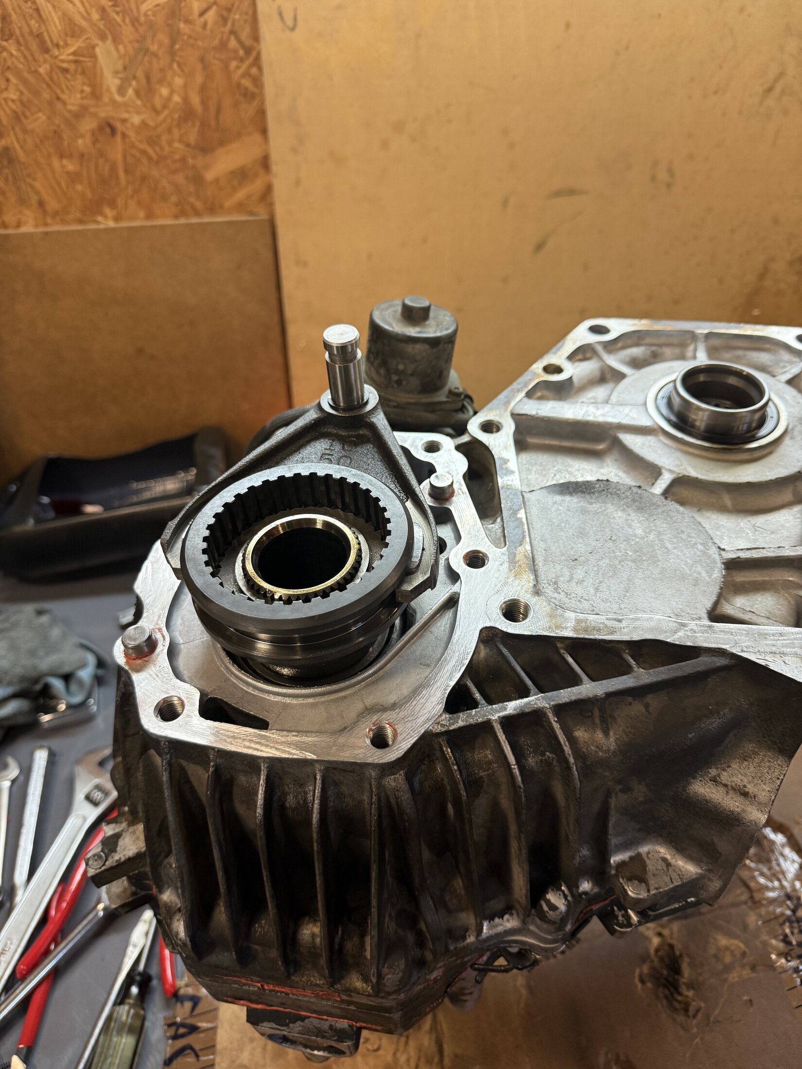

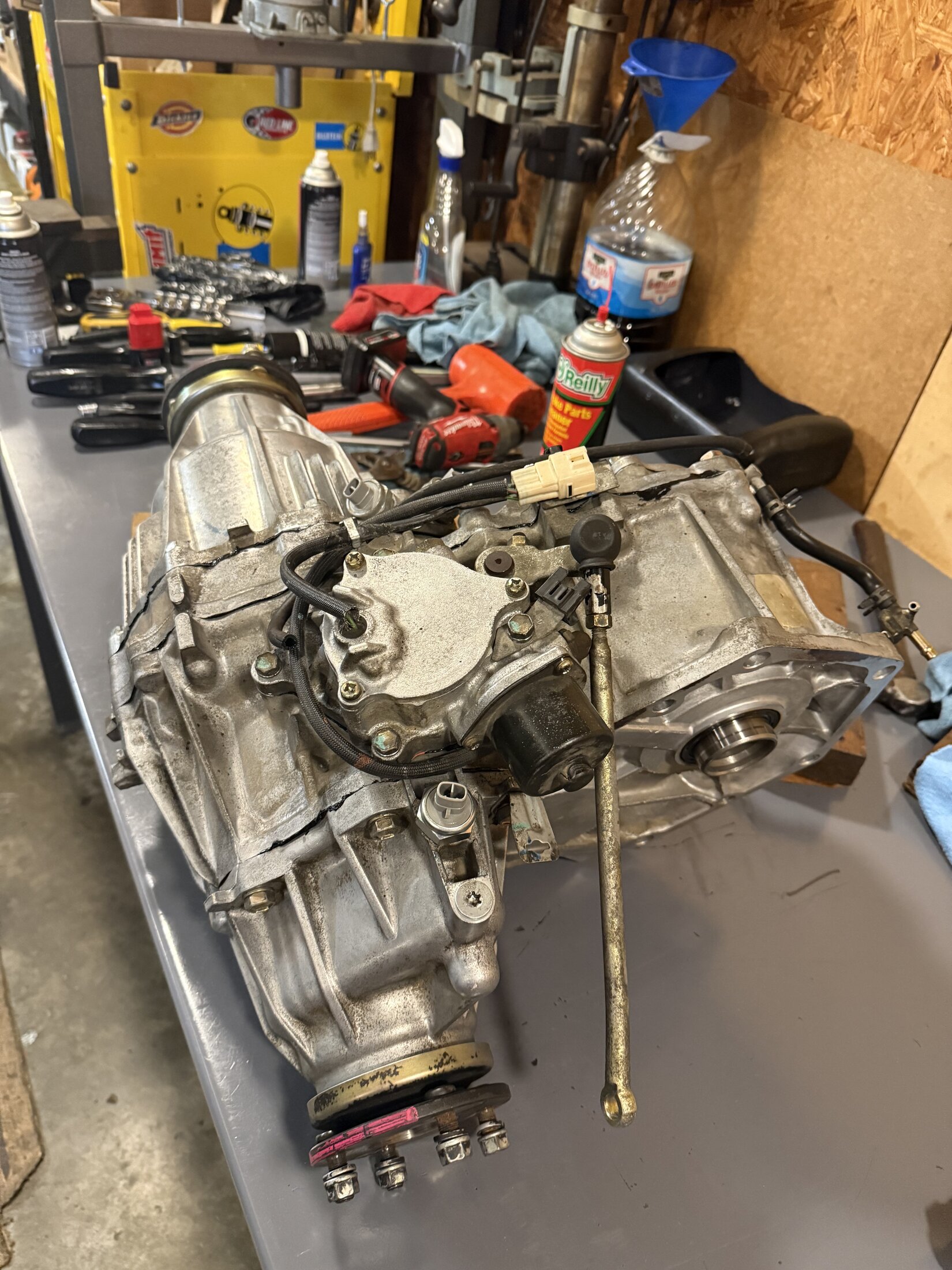

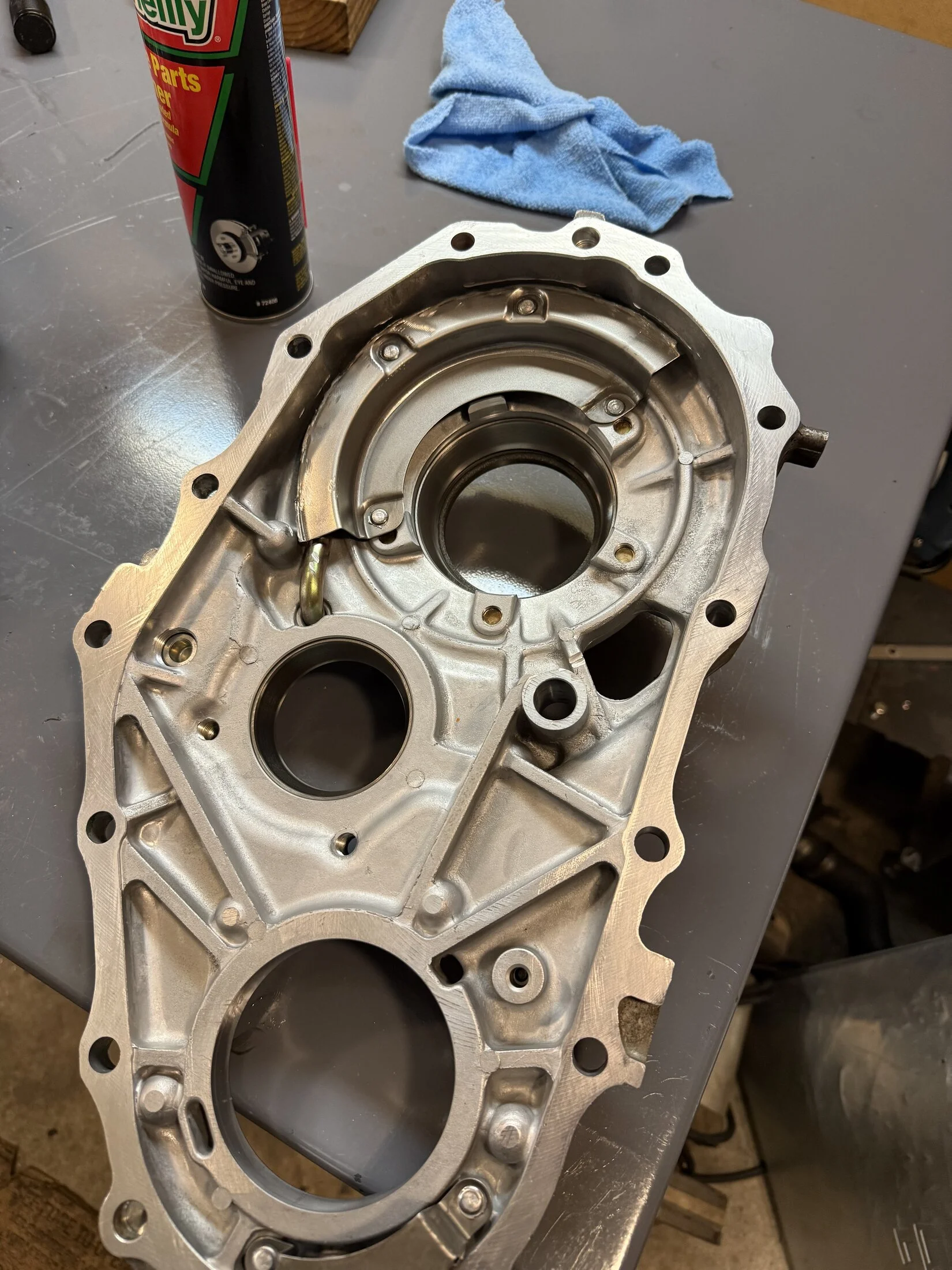

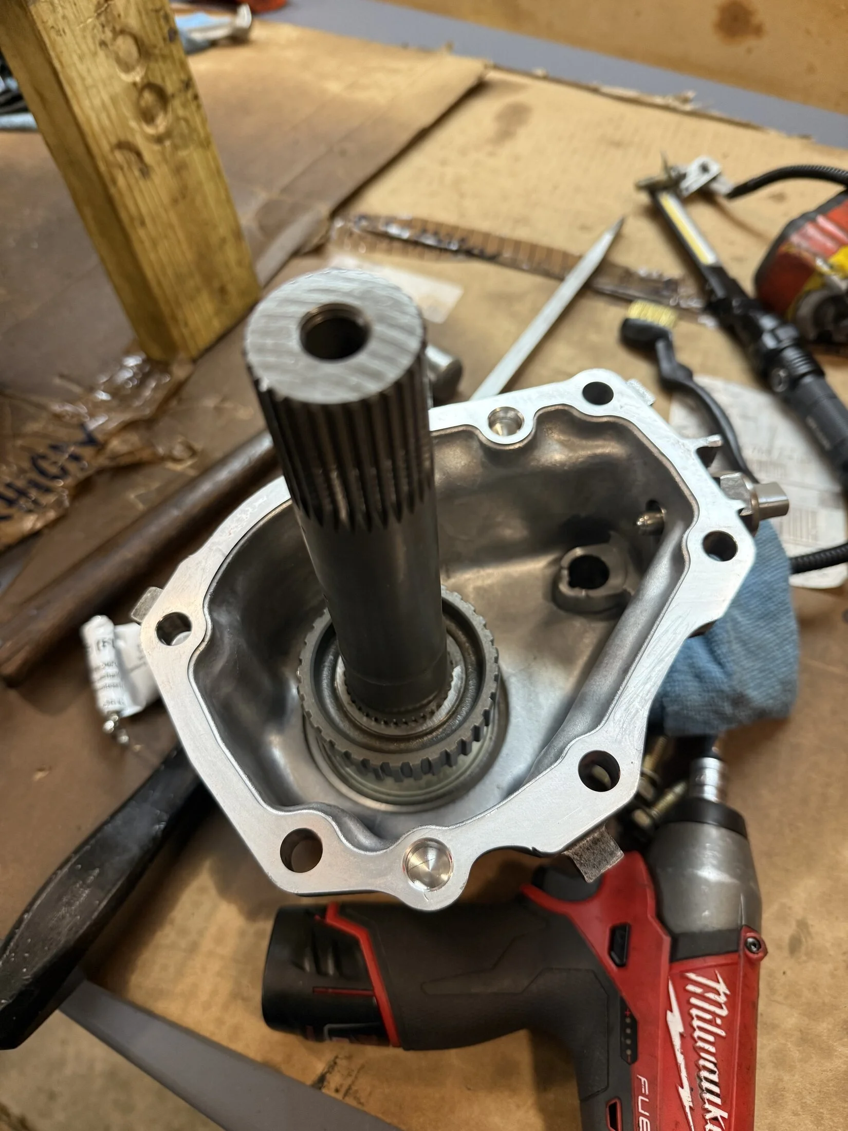

I pulled this transfer case out and forgot to engage lock with the intent to reseal the rest and front housings and install new bearings. In that process I found oops forget to engage lock and you can’t get the front housing on very easy with the lock
Collar not in the engaged position.
But I had to split the cases to install the low range gears so this created removal of CDL actuator … reading the manual it “hint engage lock “ but the cdl motor was unlocked when I removed it. So that is how I got it back to lock and stop electrically and then bolt it on the transfer case.
