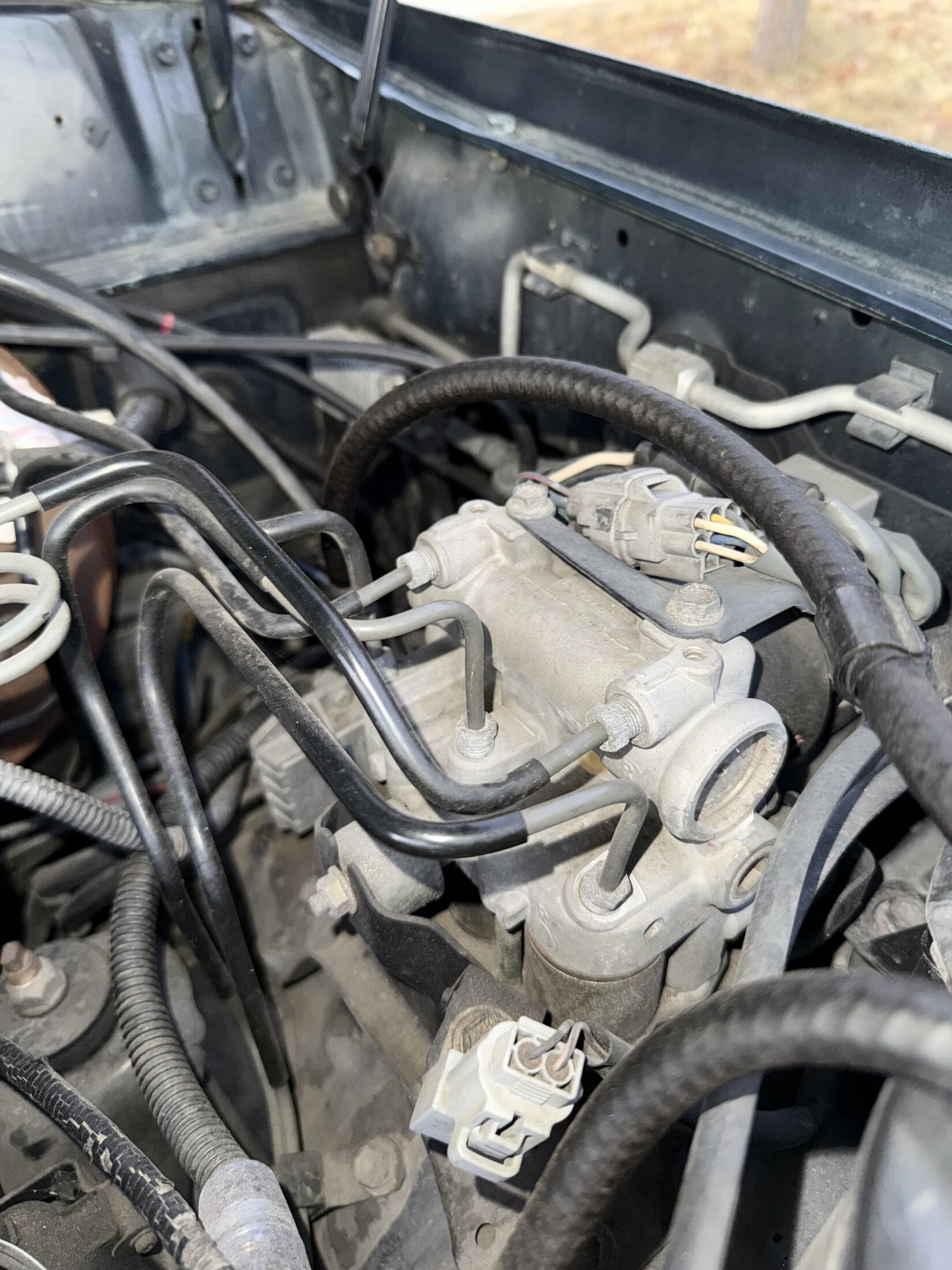

I was reading up on the ABS and it looks like not all 94’ came with it. So then I went out and looked under the hood and found this. Does this mean I have ABS?
This would also mean that anyone 3x locked should have ABS.

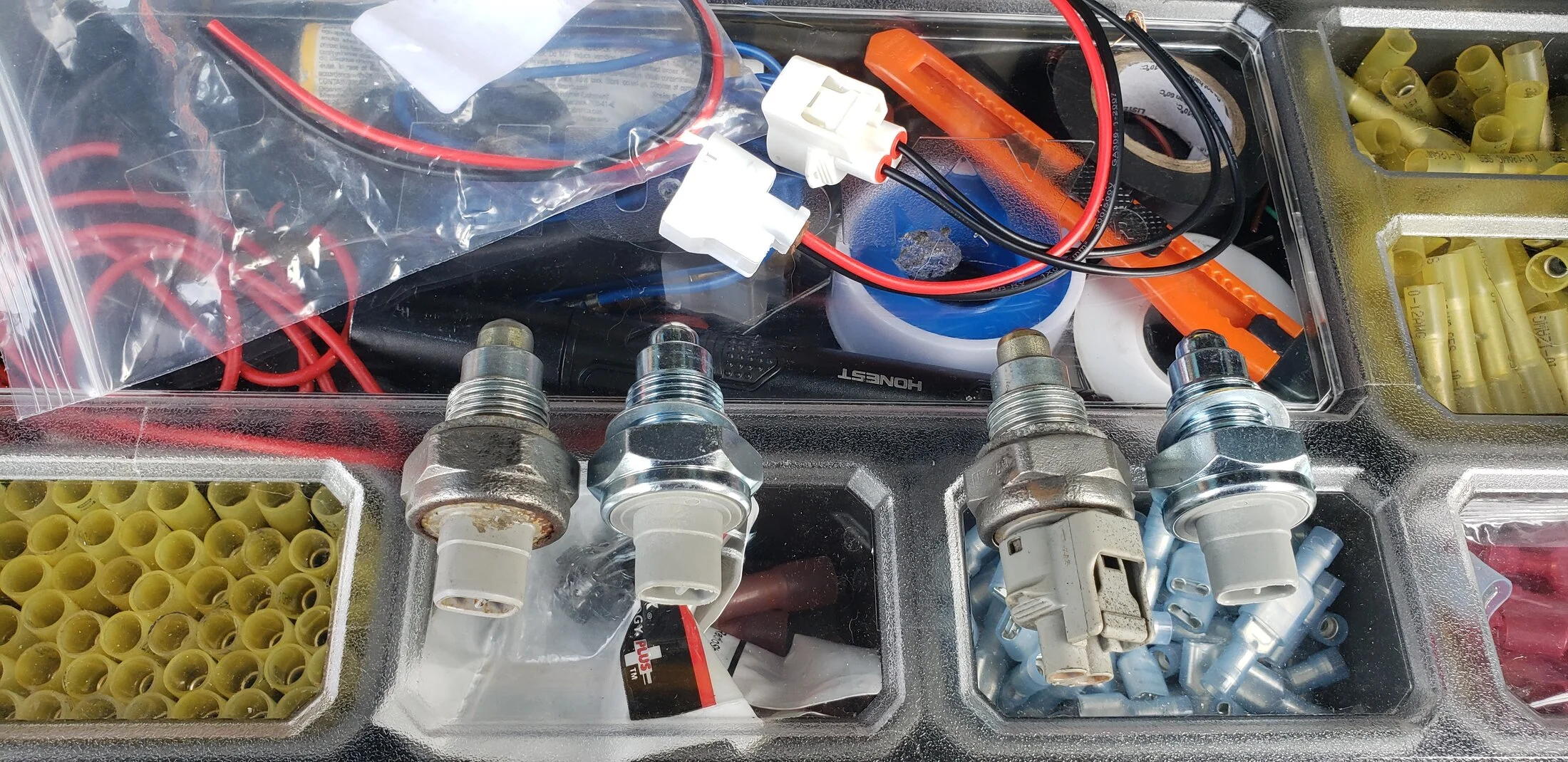

These low range switches can have problems. Ours works intermittently, so I installed the CDL switch and all is well.
