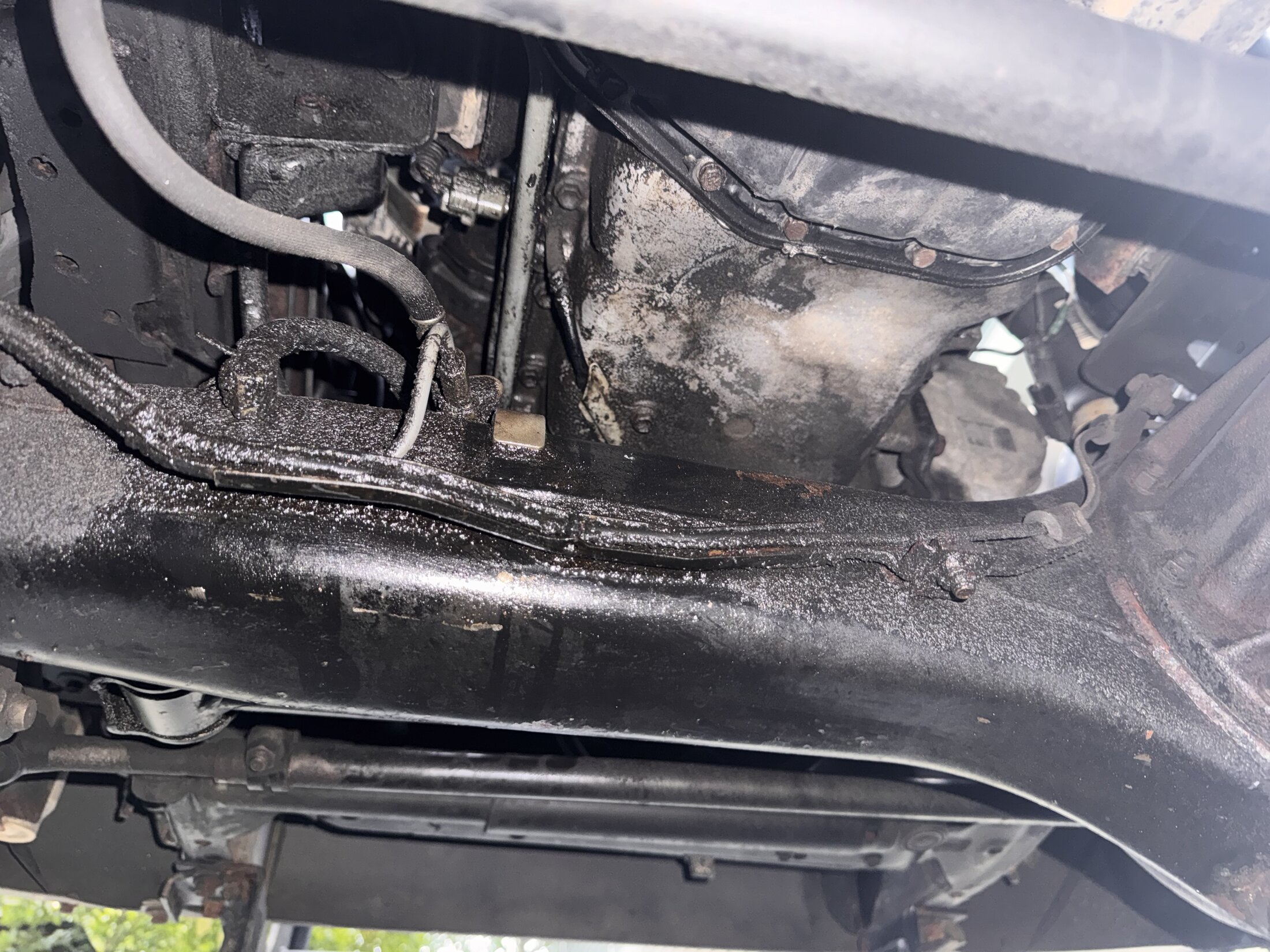

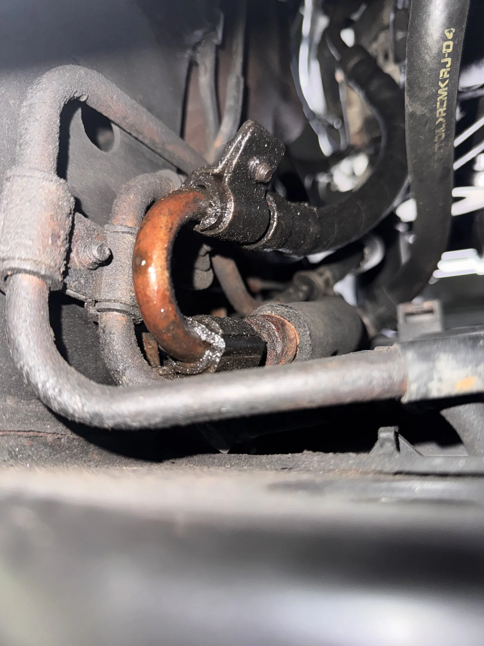

Photo #1 is likely the oil cooler seal

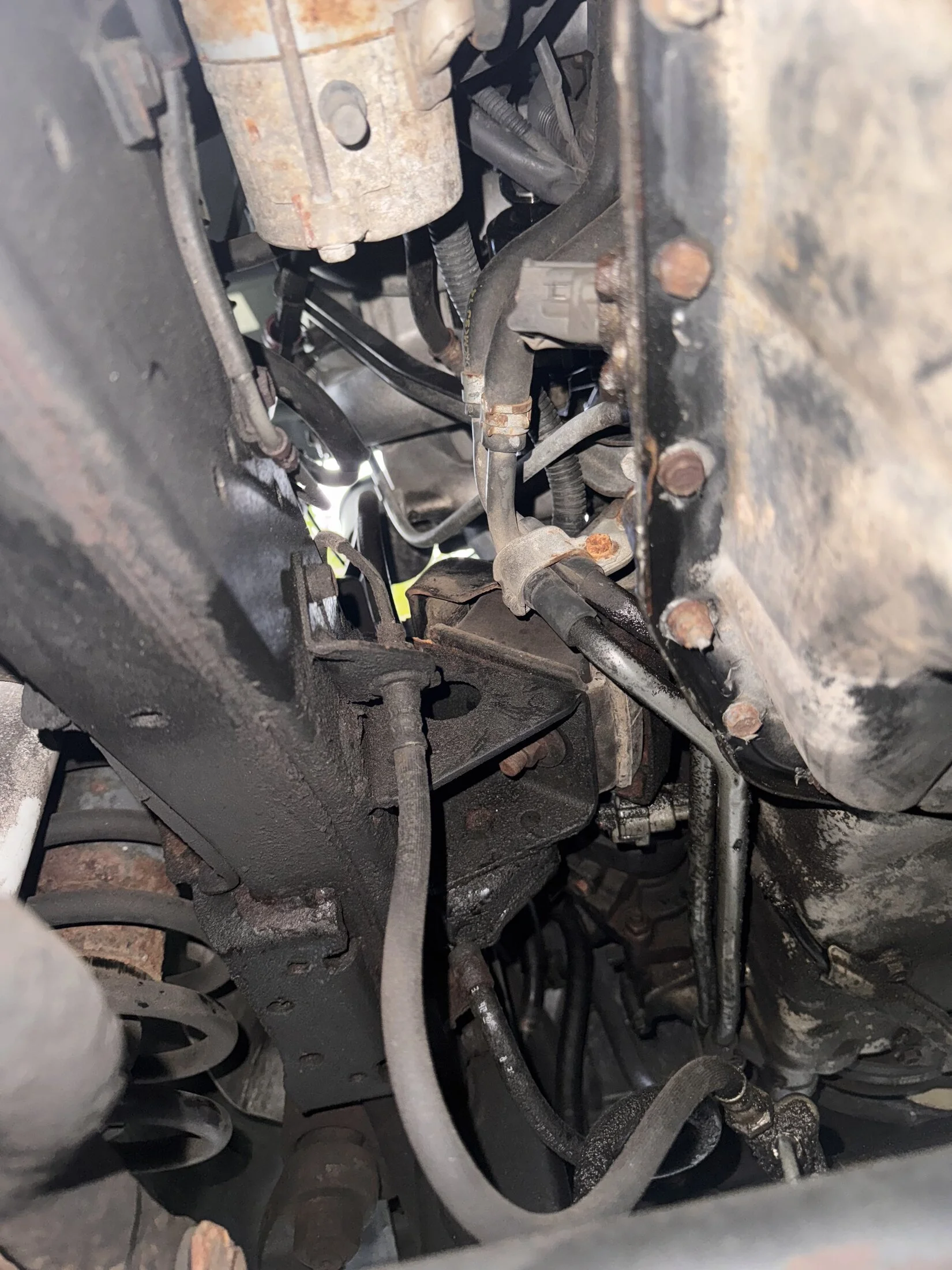

Photos #2/#4 are either the power steering pump rear seal or high pressure line, or both
Photo #3 is either the rear main crankshaft seal or the ever present pan seal leak between the upper and lower pans.
Keep an eye (or ear) on the power steering; if it starts to groan, top it up with ATF.
Nothing looks dire; clean it well and drive it.

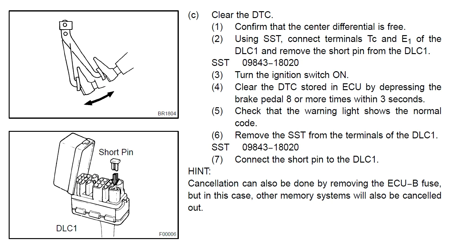

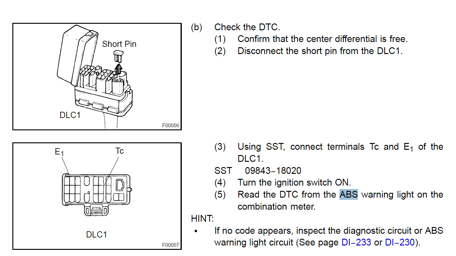

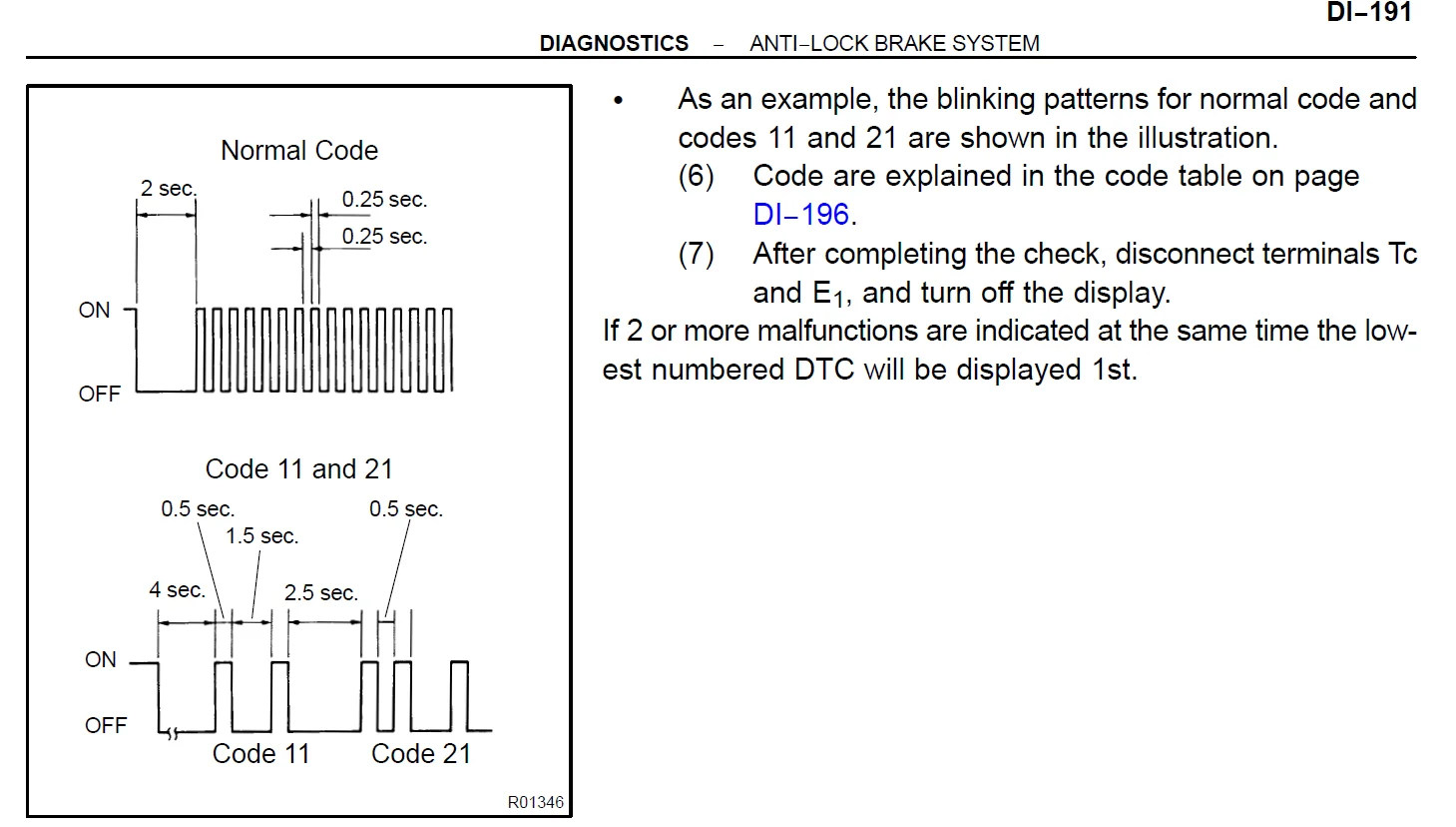

I'd check the ABS error code(s) first, before I did anything else. The procedure is on page DI-190 to DI-197 (the code definitions are on ppg DI-196- to DI-197)
This is the diagnostic connector on the engine side of the firewall, below and to the left of the wiper motor. Use a paperclip to connect the two terminals, but make sure the metal terminals contact the jumper wire.
Not knowing the vehicle history, I'd try to clear the code, after recording it, and watching to see if it returns:

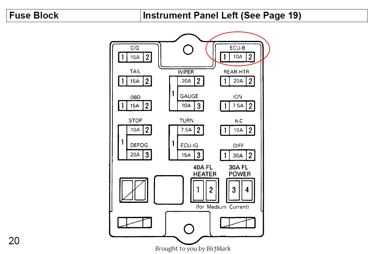

If it were me, I'd just pull the fuse, wait a minute and put it back in.

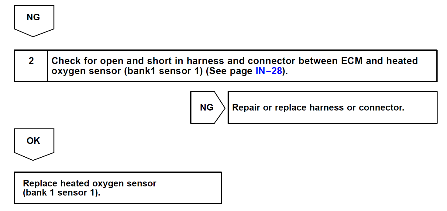

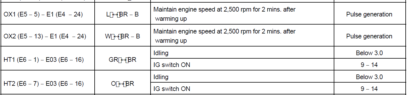

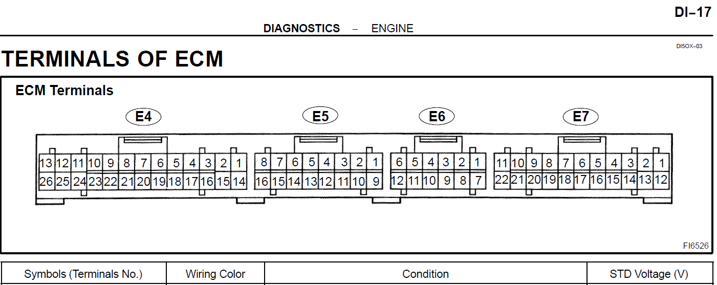

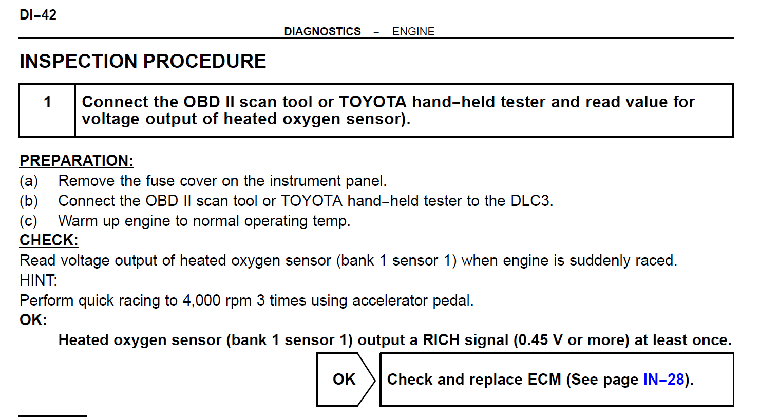

Your P0125 fault may or may not be the O2 sensor. Here's the Reader's Digest version:
You will need a multimeter to check the O2 circuit. It doesn't need to be a multi-million dollar unit, get a $20 meter, if you don't already have one. After you use it for a while, and decide you need a better one, give it to your kids. They'll have fun tripping all the circuit breakers in the house.
This looks daunting, if you don't have any electrical/electronic background, but think of it like you would if you were trying to find a plumbing leak. Except you can't see the leak, even if you find it.
To find the correct terminal to measure, use the Alphanumeric code to identify the correct terminal block (top image) and then find the numbered terminal within that block. For example, OX1-E1 connects the #24 terminal of block E4 to the #5 terminal of block E5. You need to make these measurements with cables connected, through the back of the cable connector housings. Use a paperclip to extend the terminals out of the connector housings, if necessary.
You can ignore the "pulse generation" signal values (unless you have an oscilloscope, and even then, ignore them); as long as the voltage changes constantly, you're OK.

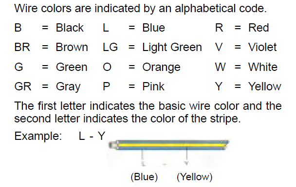

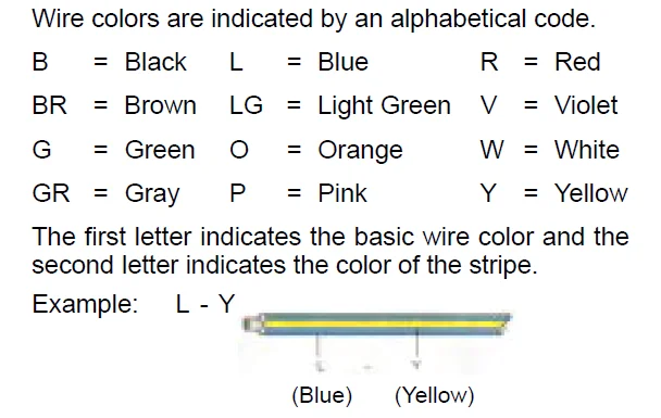

Wiring colors are always in the format [main color]-[stripe or tracer]:
Do this, before you buy new O2 sensors.
What makes you think you need a new transmission pan?

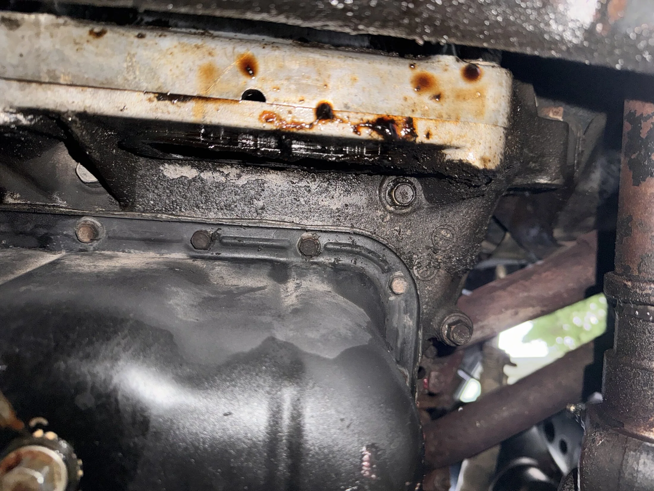

The trans pan has a pool of fluid/oil underneath slowly dripping. One mechanic told me I need to get it replaced. I’m going to clean everything underneath and start checking to see where some of the leaks are. I can definitely smell burning oil throughout the duration of my drives. Nothing sound bad on the engine though.

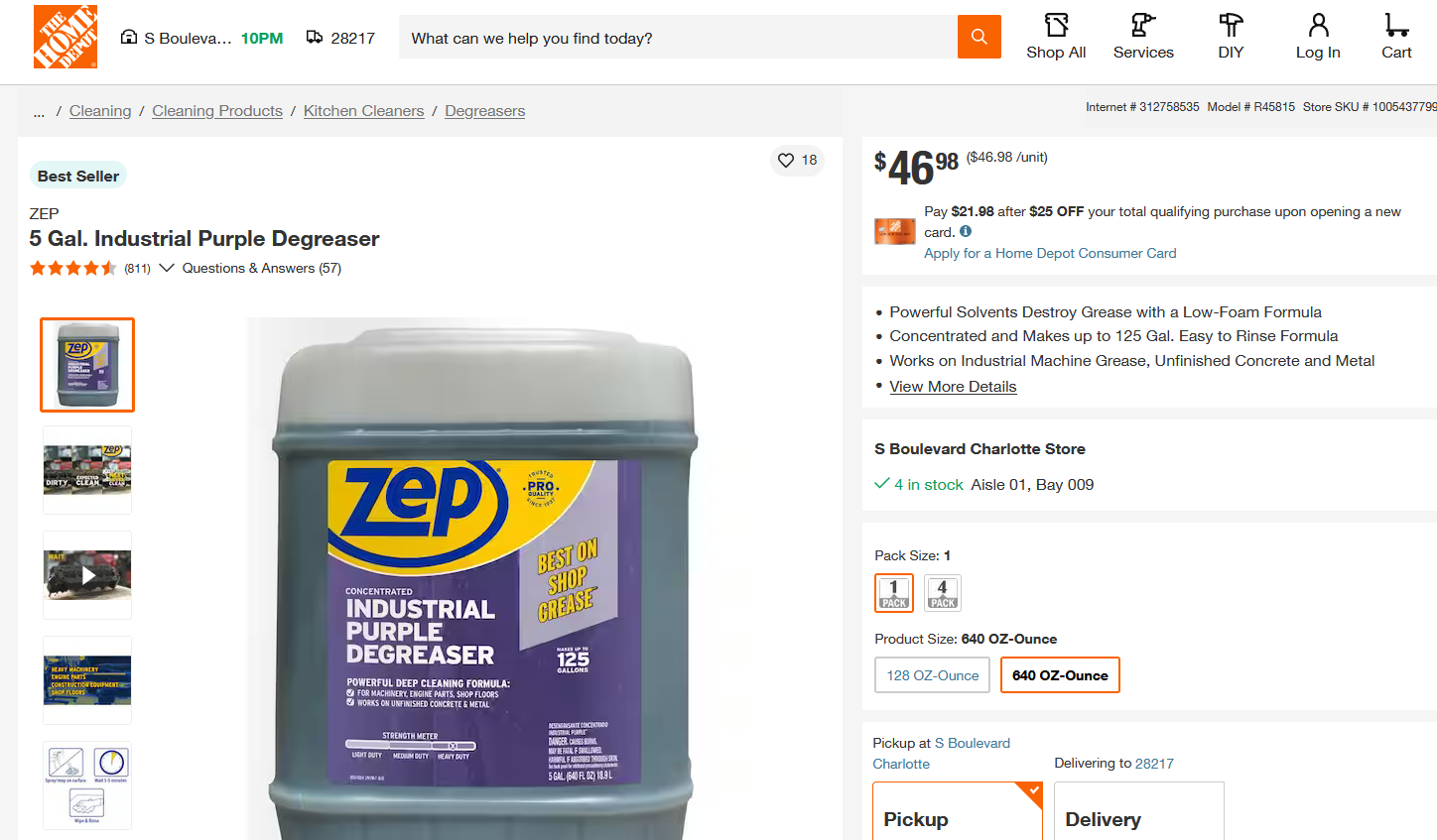

Before you replace it, find out exactly where it's leaking from.
Burning oil smells are likely due to oil spraying on the exhaust. Not a good thing. If that much oil is spraying, you've really got a leak you need to fix.
Get a five gallon container of purple power and a venturi hose sprayer. I have a GuardAir sprayer and I think it's the best money I've spent on a tool in a long time. You do have to have a compressor to use it, but a really small one will work fine. It gives you the ability to get a low volume, low pressure pressure wash that really cleans, especially the engine compartment and underbody where oil and gunk accumulates. The long wand and small nozzle lets you get anywhere you need to be to clean.
Once you get the surfaces clean, you can clean a month's worth of grime in short order, using only water. I use mine every time I open the hood to do any work. It takes five minutes and I don't have to work on in a dirty engine compartment. The low volume means it's effective without making a swimming pool under the truck. I can't recommend this tool enough. If you're taking care of your own maintenance, you need one.
IMO, it works as well as a professional hot wash, without the cost and without making a mess as it cleans:

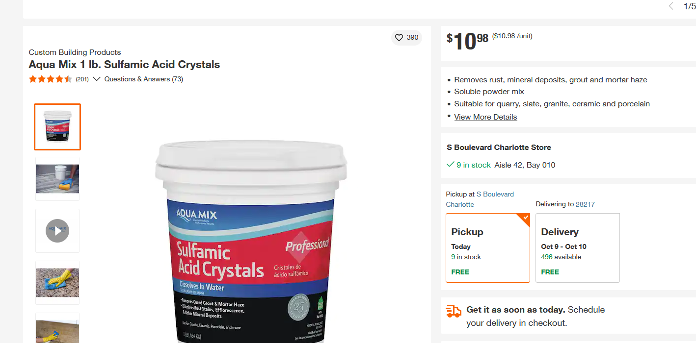

You can clean the overflow tank and pretty much restore it to like new appearance with a sulphamic acid mixture; it's sold in the pool cleaning section in powder form.
There's no way to tell where all the crap in your overflow tank came from, and you're better off starting with a clean tank so you can gauge the condition of the radiator's interior.

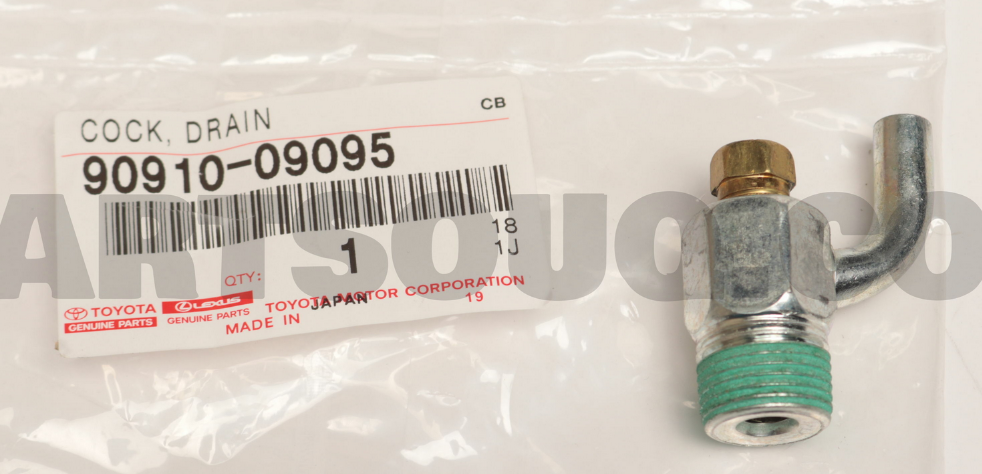

Lastly, I replaced my block drains with the 100 series engine block drains, 90910-09095, which have a 90° drain tube on them, so you can attach a drain hose and drain the block into a bucket, instead of washing the entire driver's side of the engine compartment in engine coolant. Well worth the investment, IMO.
It works on the siphon principle, so you put pickup in a gallon container and spray away. Great for mixing exactly what chemicals and ratios you need for any use. The Chinese copies are much cheaper, and probably work just as well, I'm just not buying anything from them if I don't have to.

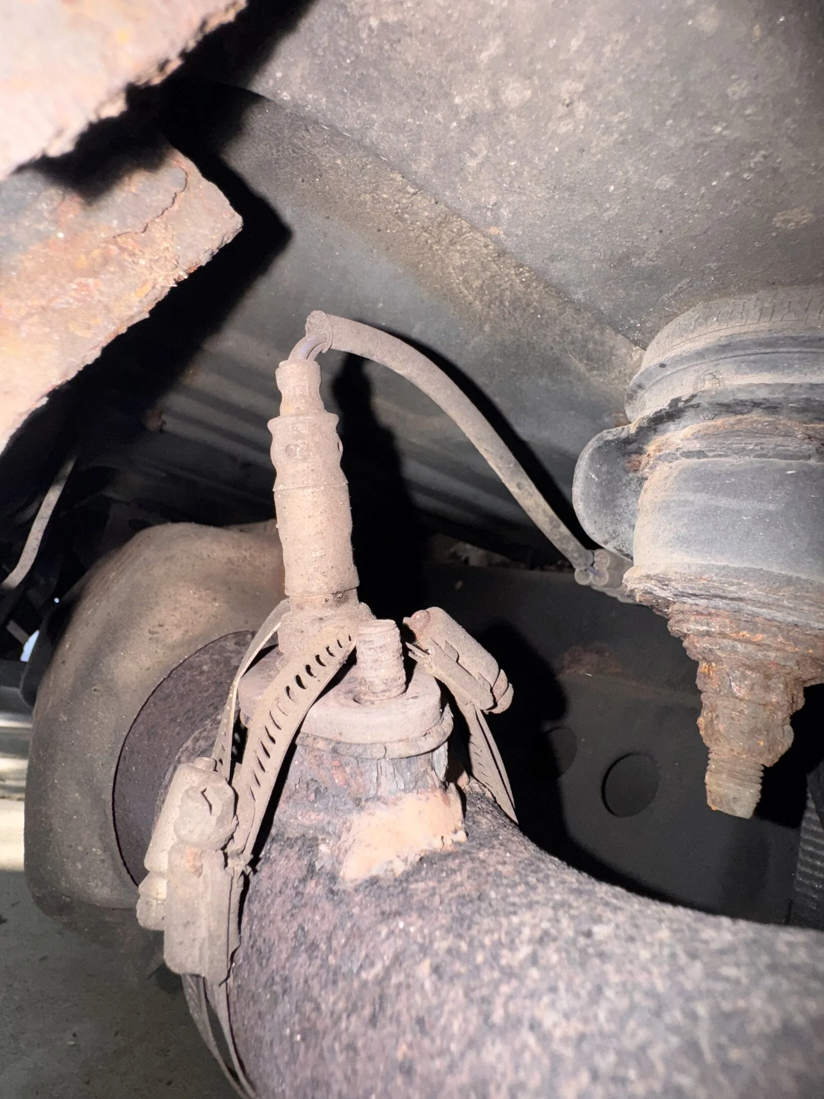

Here is a photo of the 02 sensor. Might be having an effect since the previous owner used two clamps to hold it in place.
