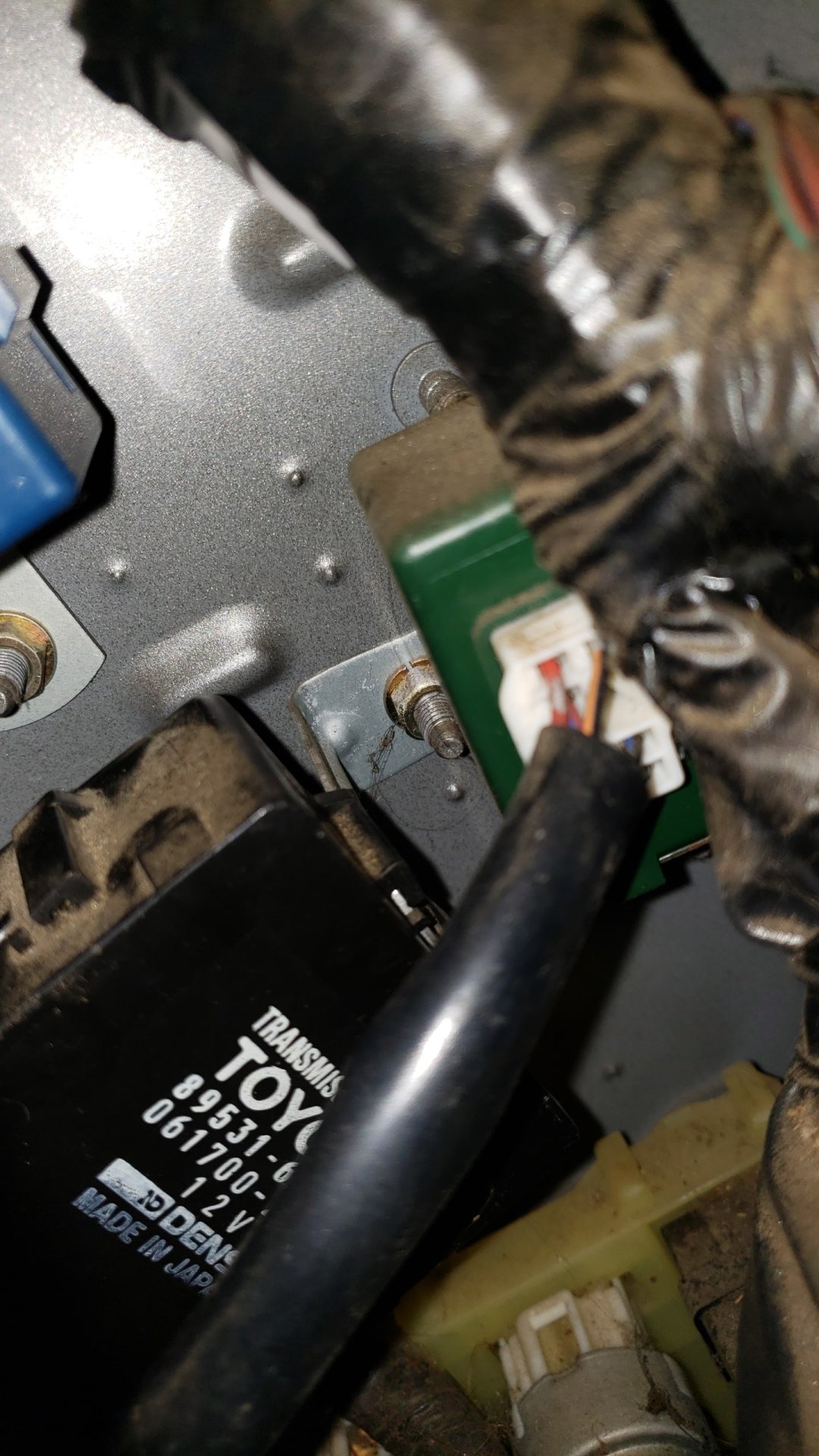

Hey folks, I've searched the forums but no one has mentioned exactly HOW to get the relay out to do the 7 pin mod or test the relay. I've gotten the ABS module out of the way (sort of, I had to un bolt the brackets as those 4 tiny Phillips head screws are locked in with force). Now that I've got the relay exposed how on earth do I get it out? I'm upside down twisted sideways & cannot figure it out with any sort of delicate approach. I'm not quite ready to go full unga-bunga on it since there are so many tiny wires in that small space. Any advice on how to release the relay from whatevlding it would be greatly appreciated. Thanks all!

Yep, but my question is for a more detailed explanation of "unplug the harness" in particular i want to remove the relay from the truck so i can test the relay on the bench. I can't figure out how to get the relay to release from whatever is holding it into the truck. My Center Diff light isn't lighting so I want to test the relay before I proceed to removing the actuator from the top of the T-case. Thanks!

With all that said, my question is ridiculously simple. What's the magic trick for getting the relay released from the side wall of the vehicle? I'm guessing that it may just be one screw from research on the web parts sites but I always want to check the group here to see if I'm missing something easy.

The relay is held in with a bracket that is inserted into the far side (towards firewall) of the relay. Given the age of the plastic, I didn't want to try and compress the tab in the relay case to get it to release from the bracket so instead I unscrewed the two 10mm nuts that hold the adjacent relay (it was blocking access to the nut that is holding the CDL relay) and the CDL relay brackets. See image below for context. The firewall is to the right.

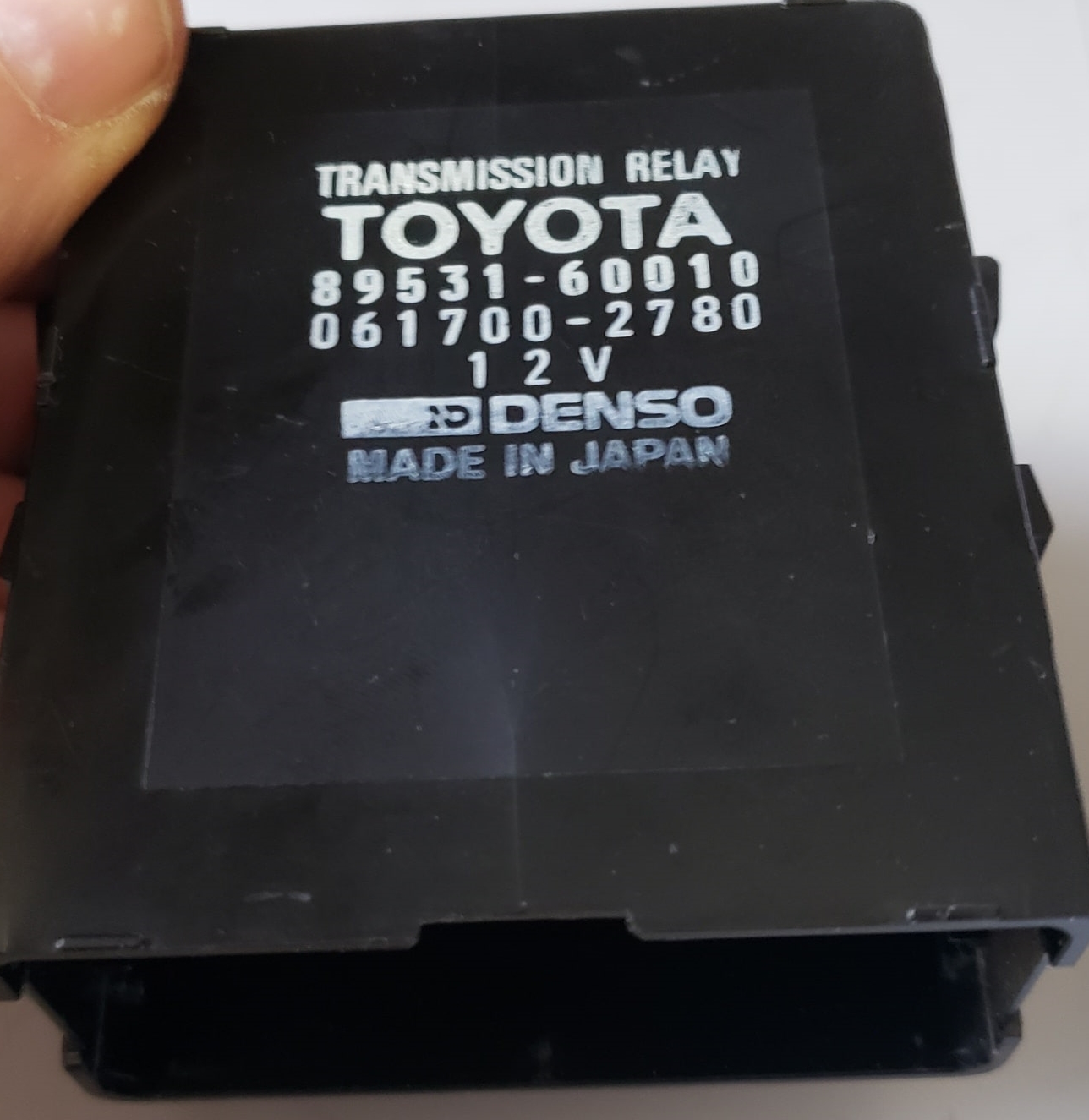

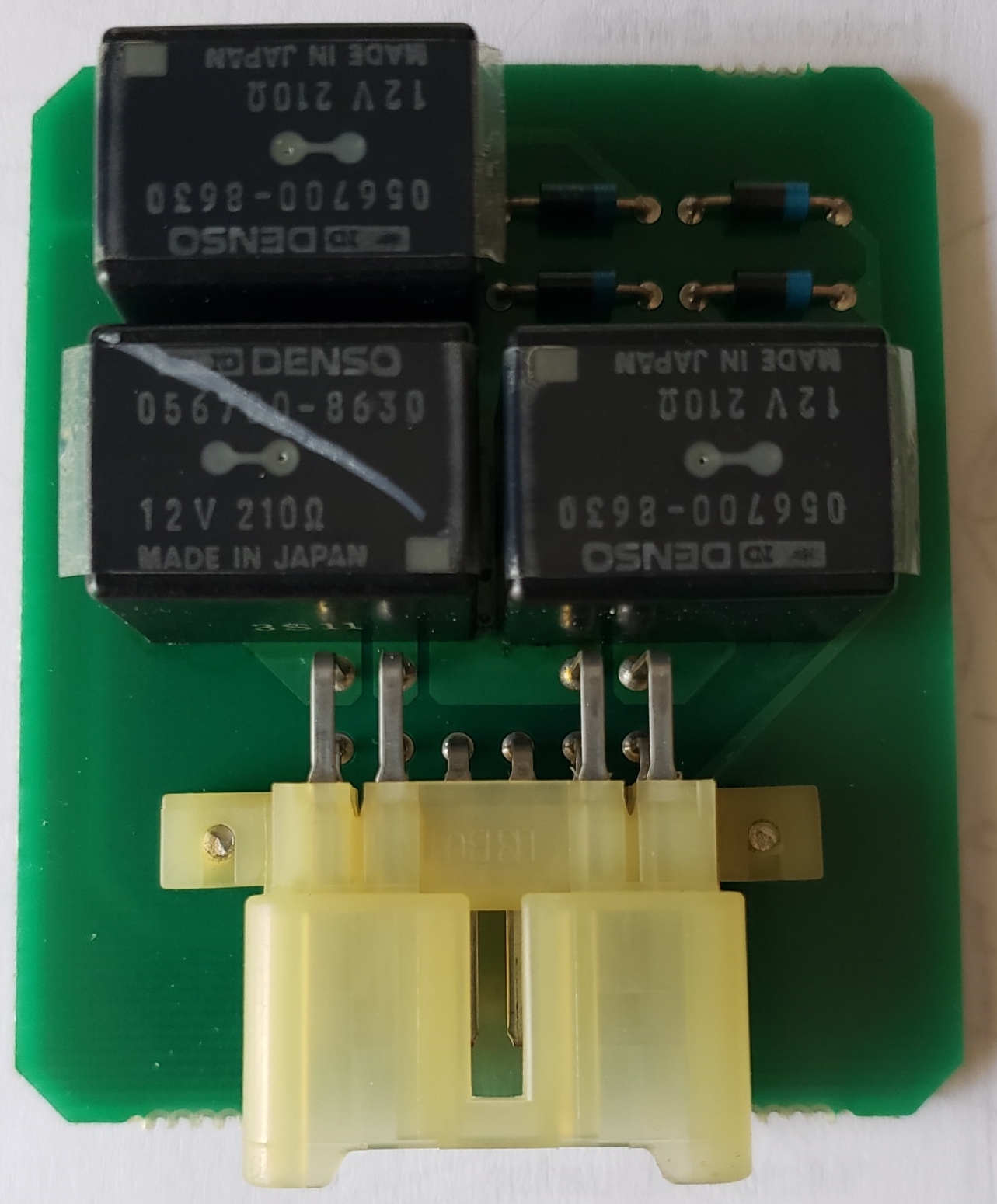

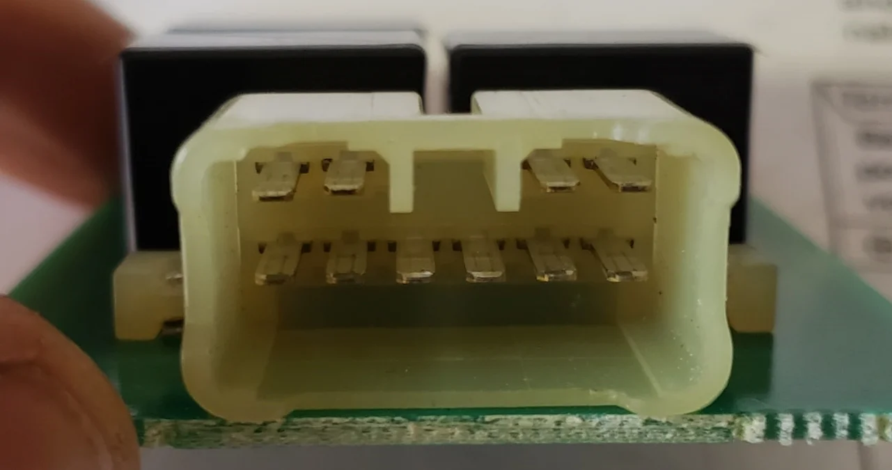

Once the two nuts were successfully removed, I got the bracket and relay back onto the bench for testing. Here are three shots showing the relay case (for those that need the part number), the end of the relay that corresponds with the graphic in the FSM, and the internals of the relay showing the actual relays and diodes.
Once I had the relay inside I followed the FSM testing procedure. I have continuity between pins 1&2, 2&4, but when I tested for continuity across the diode at pins 6&7, I had super high impedance (over 570 ohms when leads were oriented one way relative to polarity, and then nothing when they were reversed). So I moved on to the battery positive voltage tests. I do not have continuity between pins 1&3 when battery positive is applied to pins 5&6.
