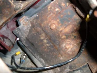

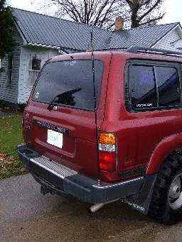

Here is a couple of pics on how I mounted mine. With it being mounted in plastic you have to ground the metal base, I used a big yellow connector and cut out the end of the loop and slid it in the screw mount and tigtened the assembly down.
