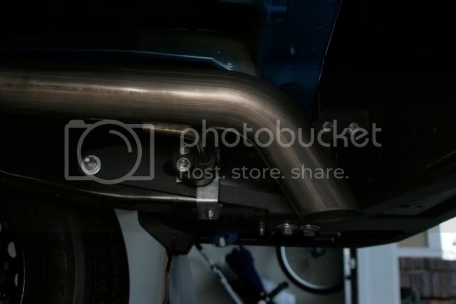

Also, personally i wouldn't ruin my rear bumper to place the exhaust through it unless that is a look you are really wanting. I would just do something like we do on the FJs. This is the allpro high clearance exhaust.
yep tha tis my other option I was talking about....bend down and flush with lowest point of bumper... :hillbilly:

yep but wont decide until I see how the pipe looks once tucked up higher and how it will work....it will compromise the powder coating and not sure how that will handle the heat...so not sure if going to cut a hole or just angle it down and cut it off even with lowest point of bumper... i will post it when it happens...likely be this Spring or early Summer.
I'll probably just keep it tucked up nicely under the truck. Cutting a hole in the bumper doesn't seem like the greatest solution.
