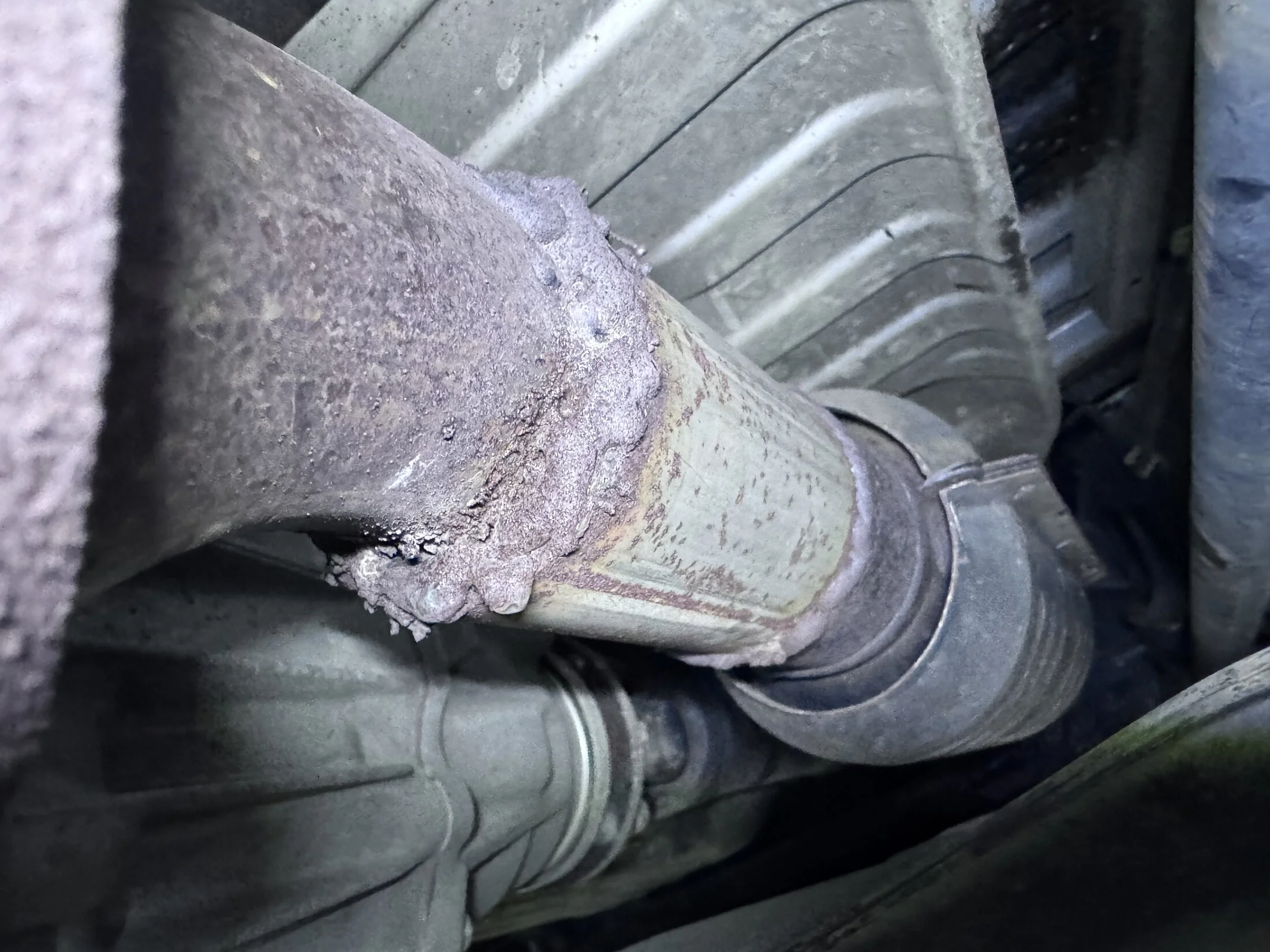

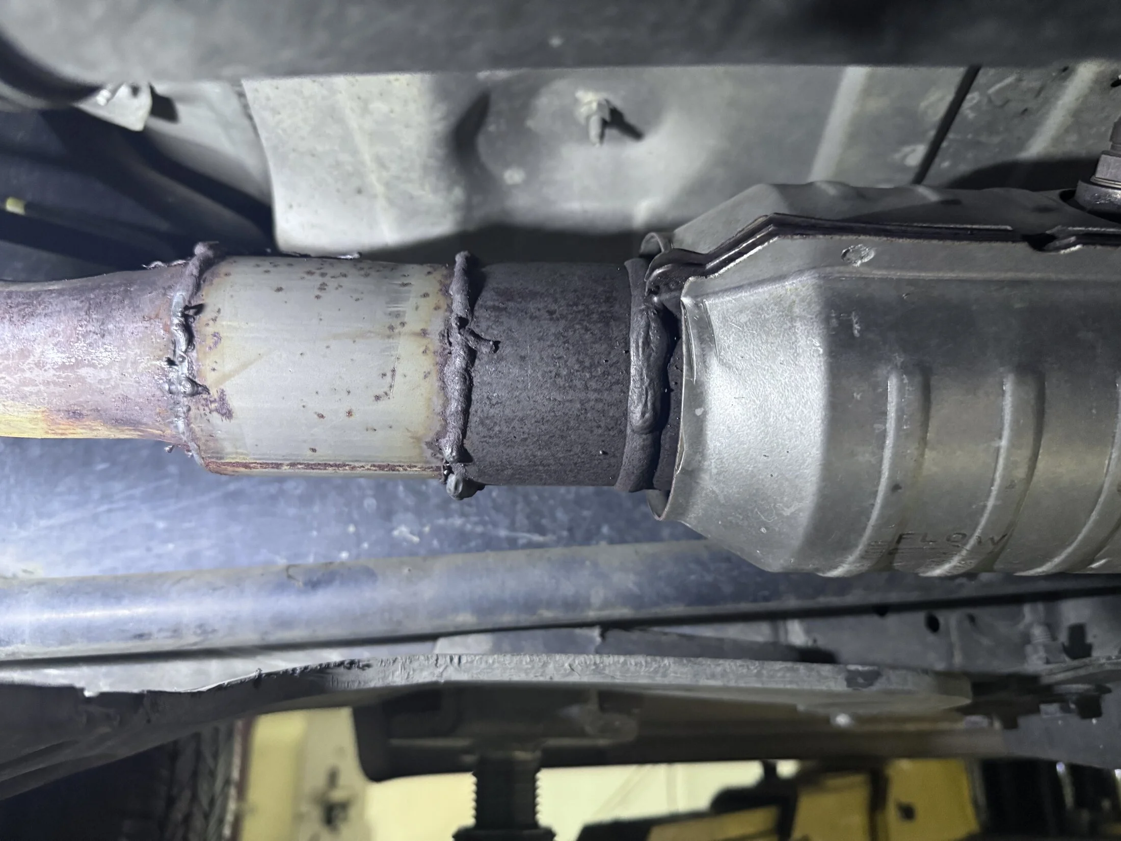

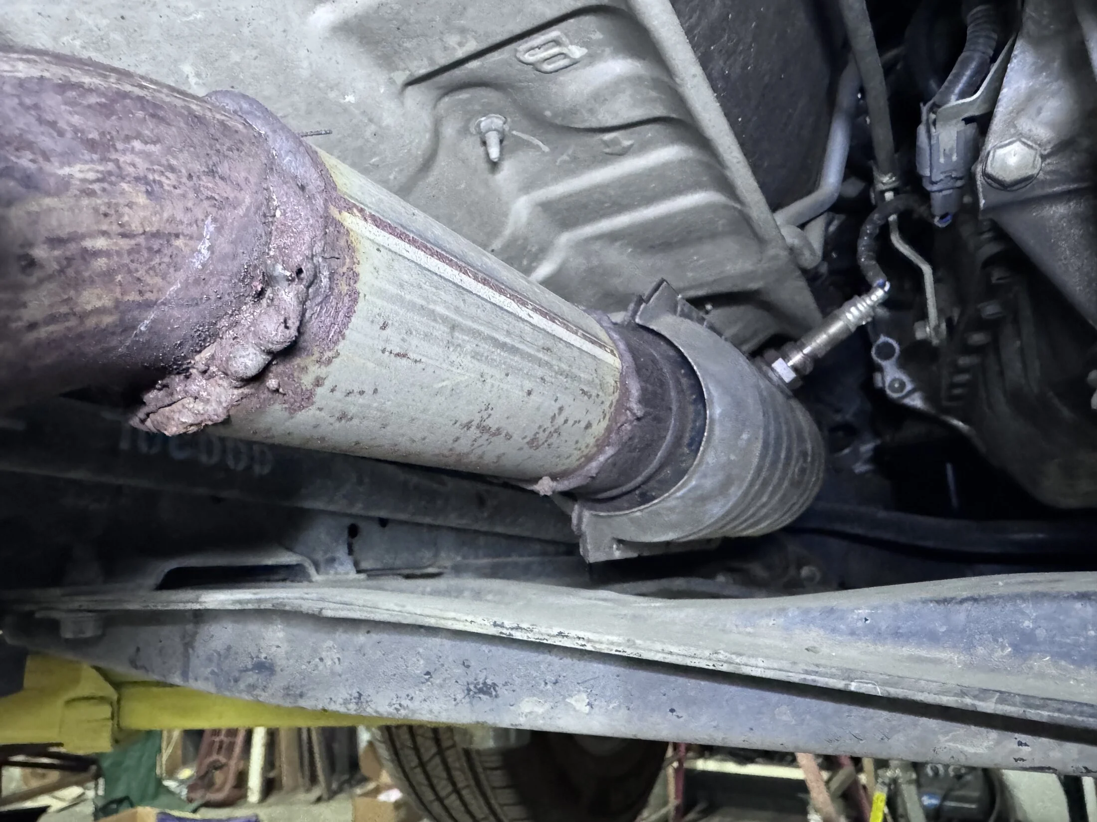

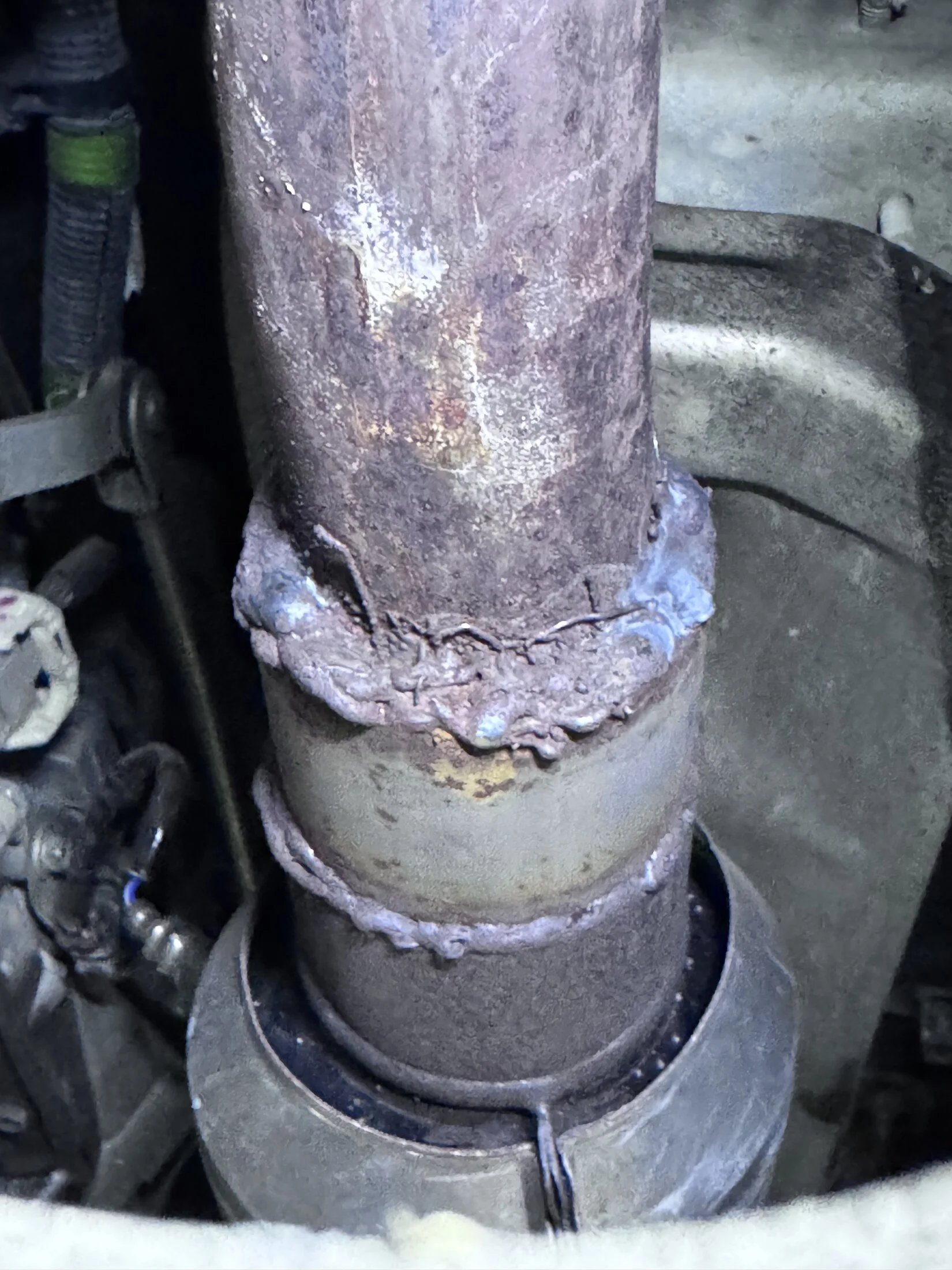

Hi guys, I recently purchased this 2007 LC and are chasing down the few issues it has. One of which is P0420 P0430. Previous owner has this work done at a local exhaust shop. (I think my 3 yr old daughter could have done a better install, but that’s besides the point)
Where would you guys go?
- through my business I could get these for $650 each? Tempted to give them a try MagnaFlow HM Grade Federal / EPA Compliant Direct-Fit Catalytic Conver - https://www.magnaflow.com/products/93142-magnaflow-hm-grade-federal-epa-compliant-direct-fit-catalytic-converter-93142?srsltid=AfmBOopO5wpc33ncCIlMi1aKkZGDu0IawYLLxbhpeSOj162iT6g5RRJ3
-bite the bullet and spend 3k on factory cats?
-or some other recommendation?
I’ve read all the other threads. On what to check first and how factory cats last longer. But starting with this mess just seeing where most of you would go on a 2007?
Thanks!

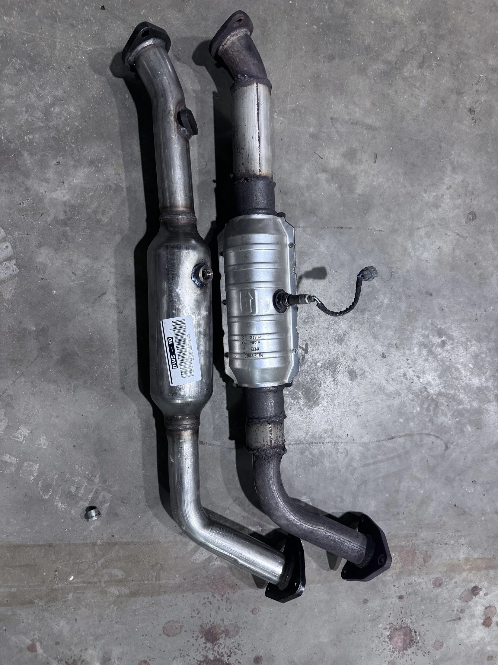

I'm in almost the same boat. My cats were stolen Memorial Day weekend, and I've been going round and round with my insurance and their "select service" shop they pretty much made me use to get the estimate done. Unfortunately, the shop ignored the estimate phase and just had the shop go ahead and fix it with universal single cats, a bunch of pieces all welded together (poorly), and the wrong screw-in O2 sensors. Total goat rope.
Was looking at the same Magnaflow OEM-ish replacement, and trying to decide if it's worth the fight with the insurance. Current AP Exhaust cats are probably fine at keeping the MIL off and passing Oregon DEQ, but is nowhere near OEM quality. Worth it? Roll over and live to fight another day? Interested to see who responds about this thread. Not trying to hijack.

I ordered the ones from landcruiserparts.net. They are a bolt on replacement. Fit nice. I Installed them yesterday. We’ll see

Aftermarket CATs, typically don't last as long. Has to do with cost (amount) of materials they use. But cost & time vs OEM, makes them a viable option.
I like the bolt on'. Since yours are already cut and welded. Best to go aftermarket and use weld on ones.

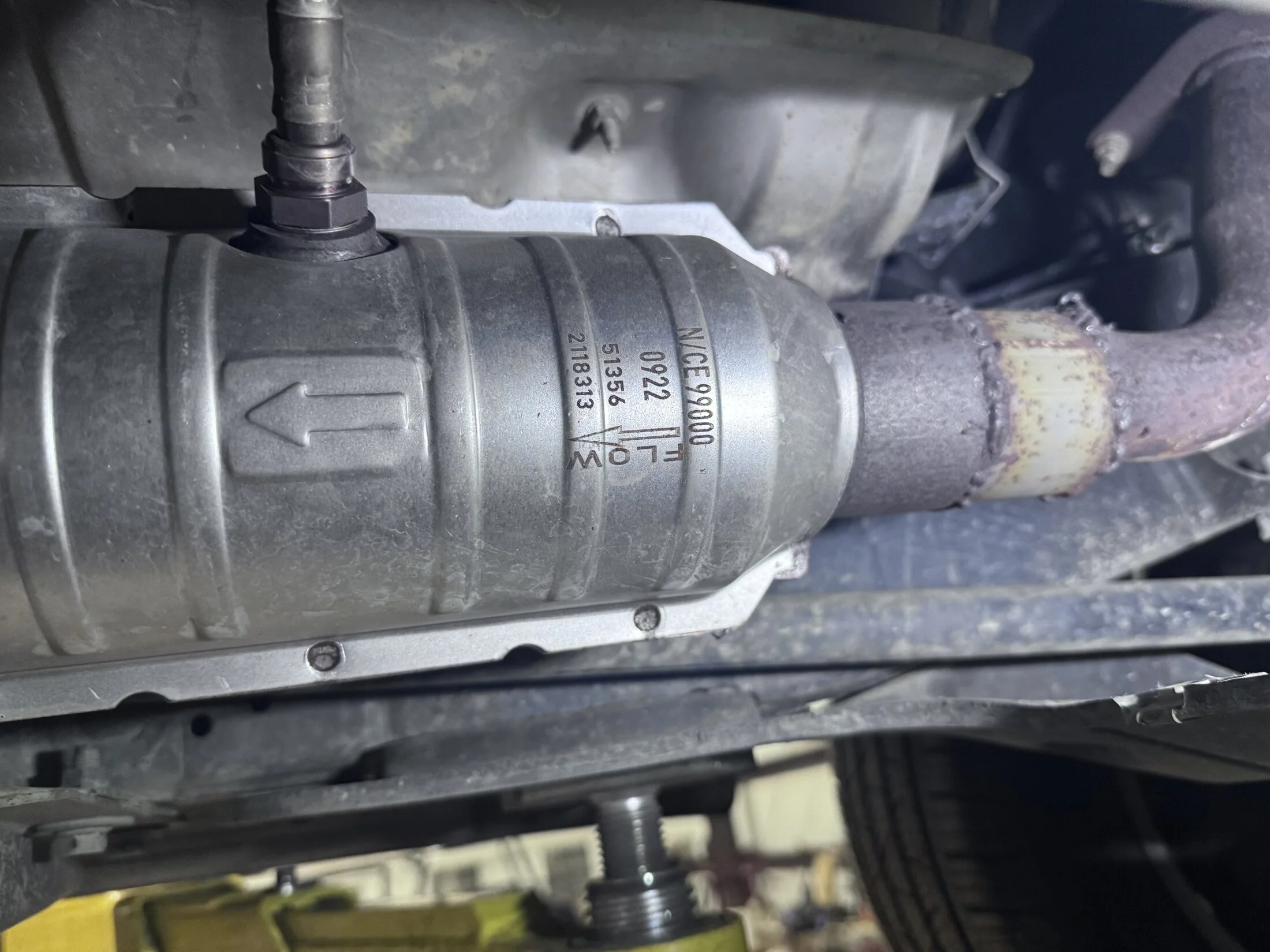

The 06-07 have A/F (Air fuel) sensor (not o2) forward of CAT in exhaust manifold. I can't see yours, likely due to angle of your picture.
They have O2 sensor between the two way CAT (Center of CAT). 98-05 have rear of CAT.
98-05 have two O2 sensors.
Also a mod to S.A.I filter, needs done. On 06-07 VVTi 4.7L
