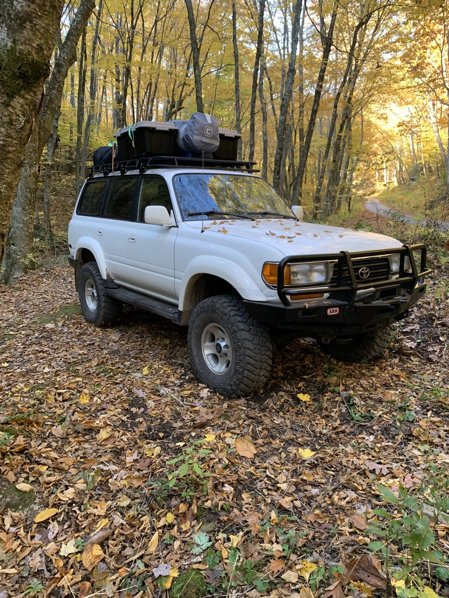

How did you determine that you are at 6” of lift? It looks like 4” to me and your caster numbers support that.
My plates correct for 7 degrees so if your Dobinson plates are indeed 5 degrees my plates would add 2 degrees to what you have.
Center hub to fender flare is 26". If I remember correctly I was at 20" stock...maybe 20.5".

I would say you’re at 5.5” of lift. Any other mods to the front axle or mounts?
I ask because at that height I’d expect your caster reading to be a bit lower. And that height is higher than what my caster plates can compensate for and still be with the factory specs

No I didnt. I intended to only get 4". The supplier told me the springs would settle, but they certainly arent going to settle that much. Originally it was about .5" higher, so it has settled a little.
The stance is great and I like the clearance, but honestly I dont need it. I think swapping the springs is likely what I'll do. What other issues could I get into down the road, beyond the caster?
I added an adjustable Panhard and DC shaft.
