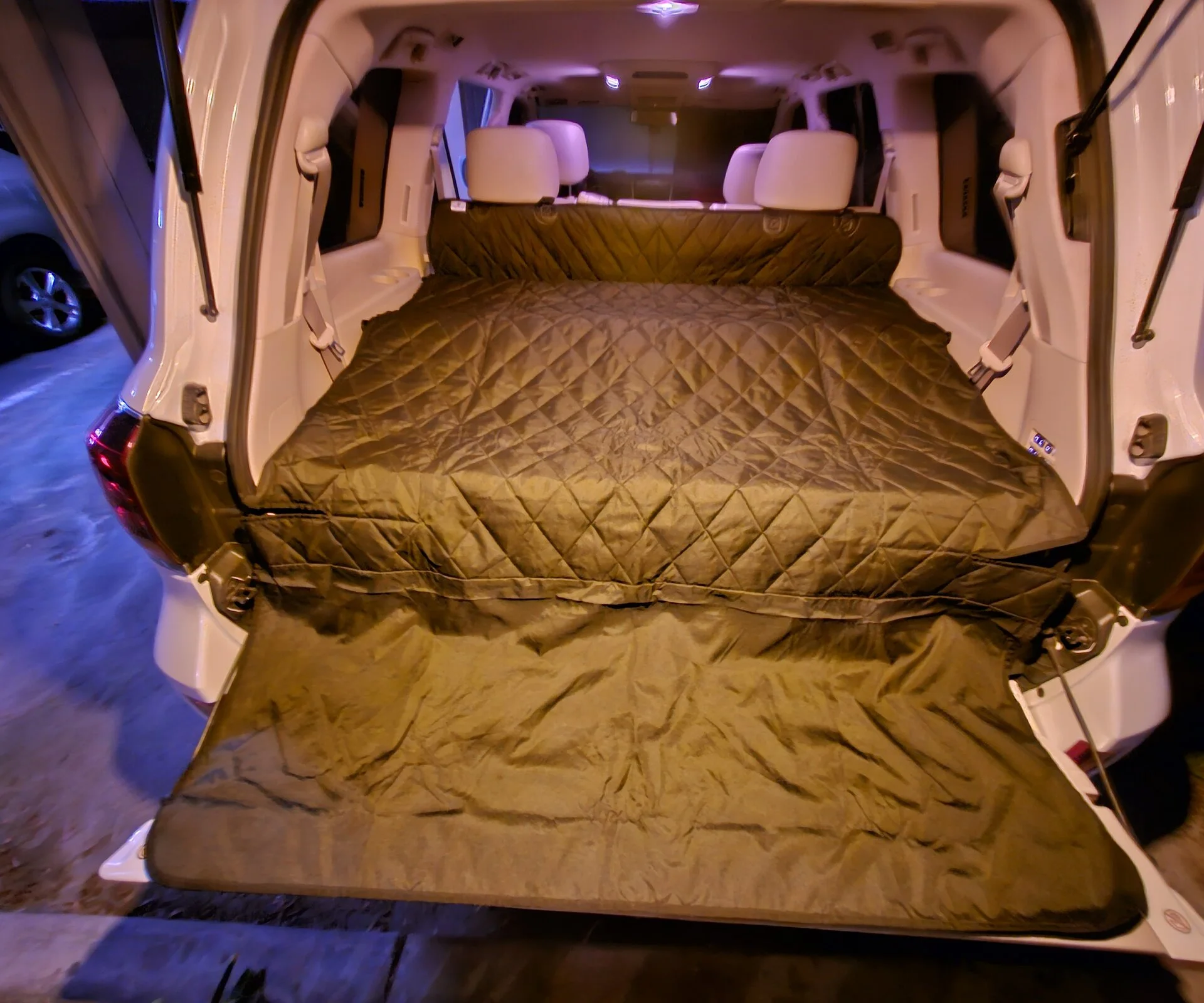

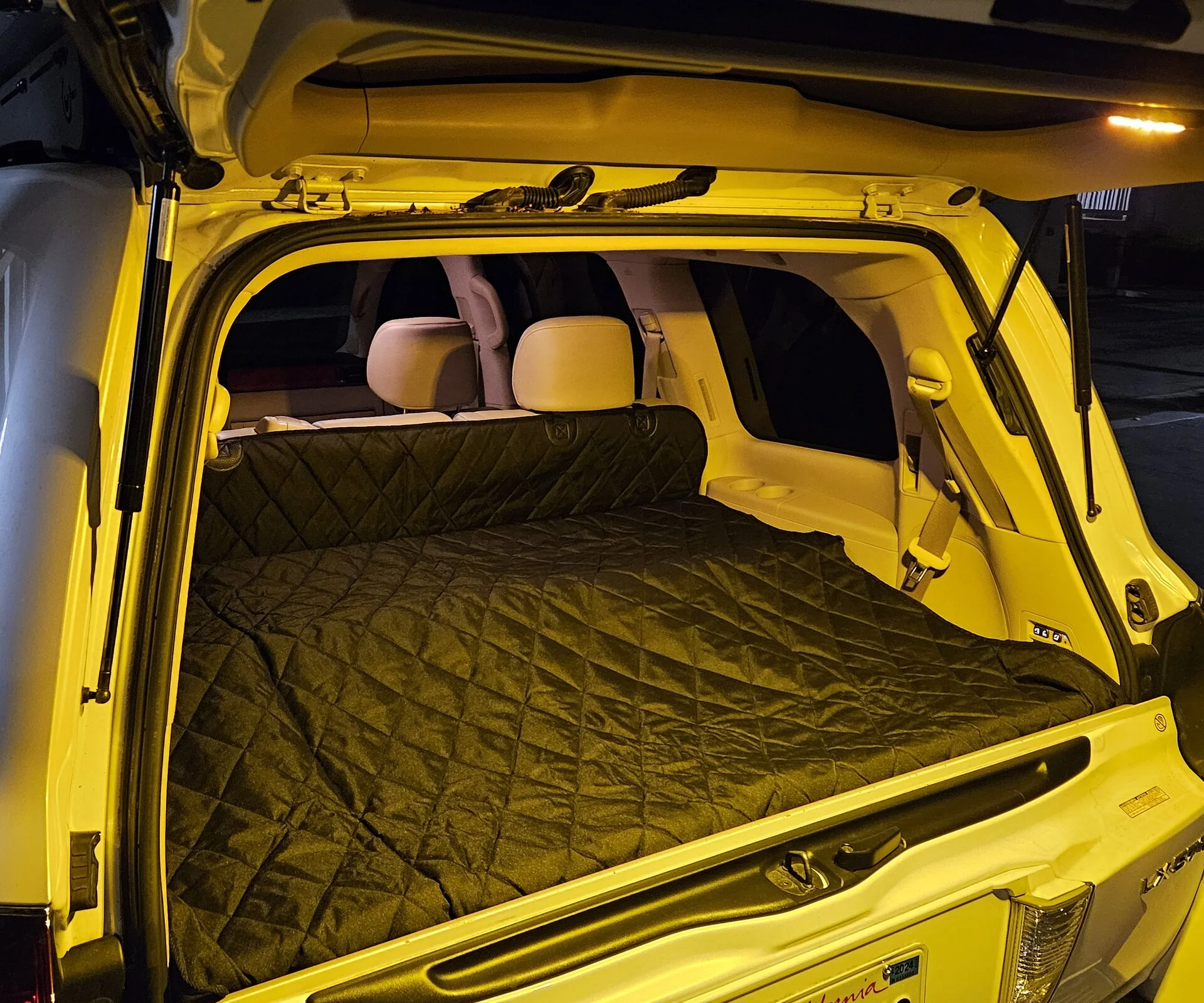

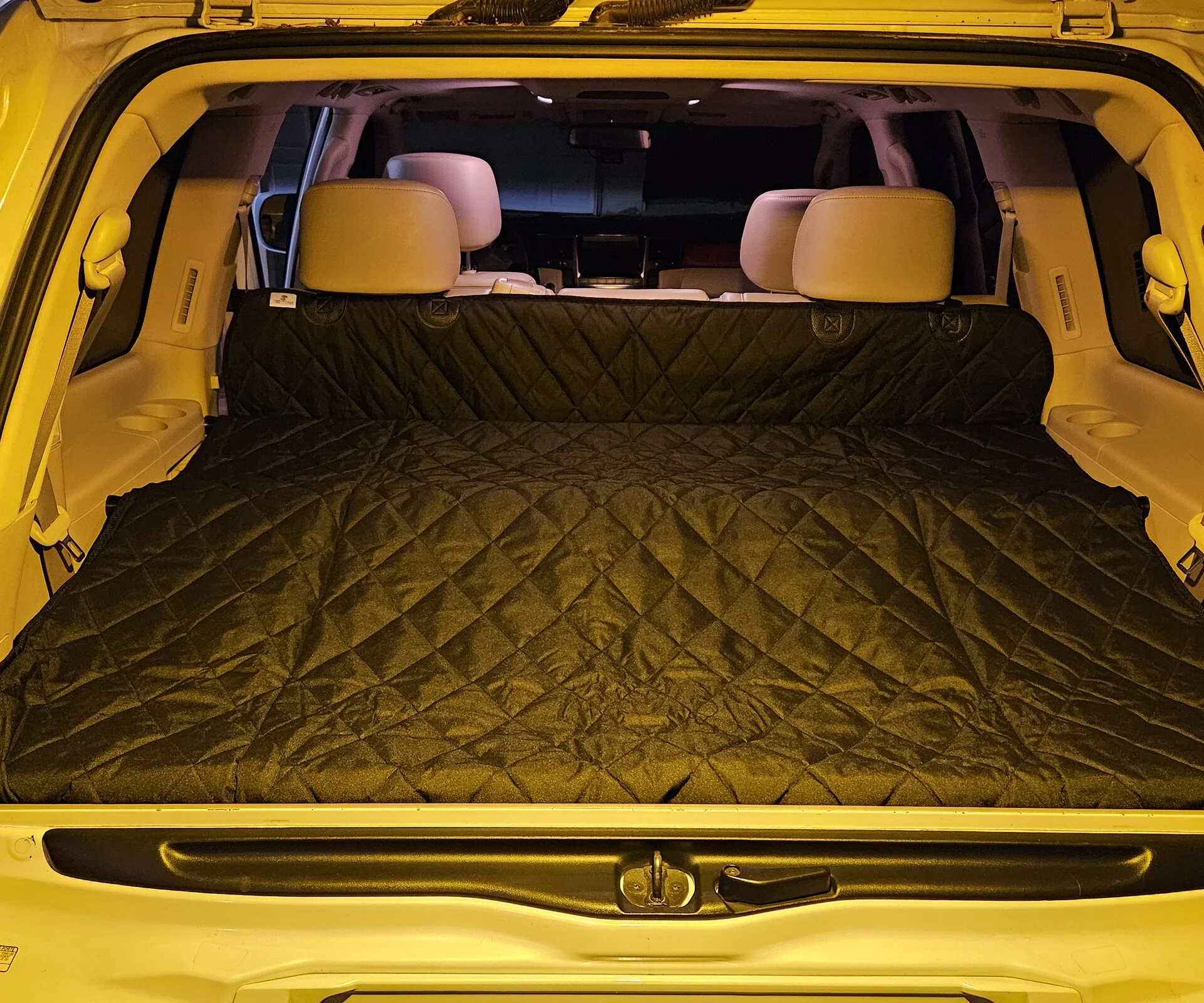

Here's what I came up with. The cover is suspended over the cargo using tension poles. The beautiful thing about this cover is it is long enough to extend over the tailgate, which I was having trouble keeping clean standing on while putting up my rooftop tent and using as a makeshift table. The other good thing about using this cover is if you have dogs or messy cargo, you can remove the poles and use it as a cargo mat. Added value.

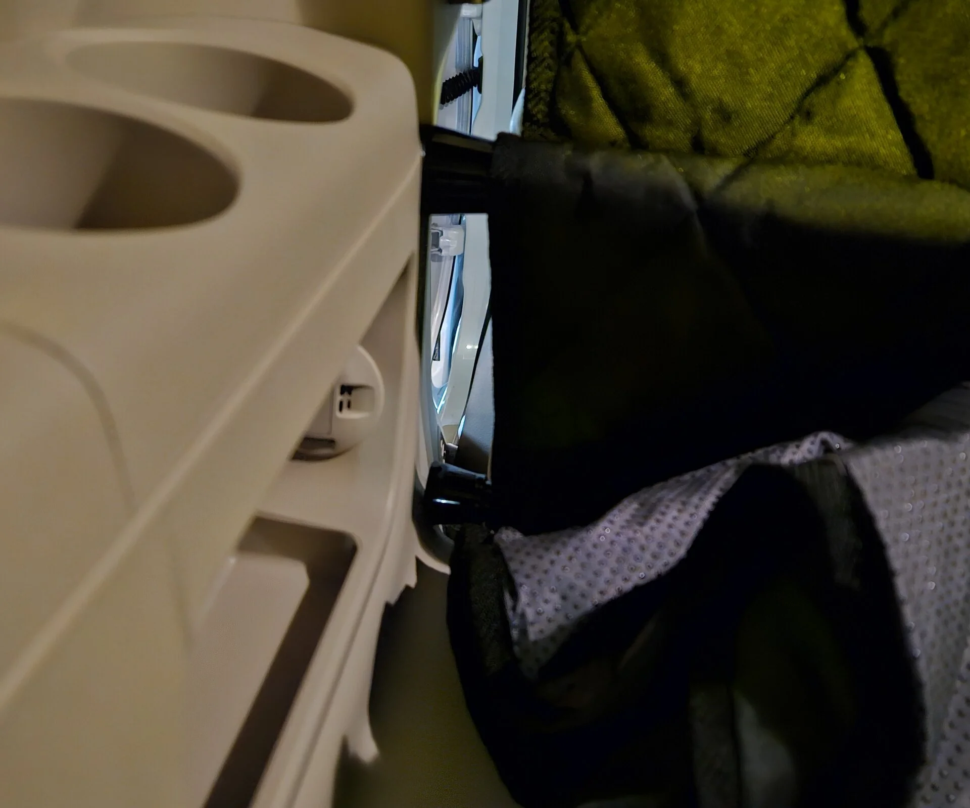

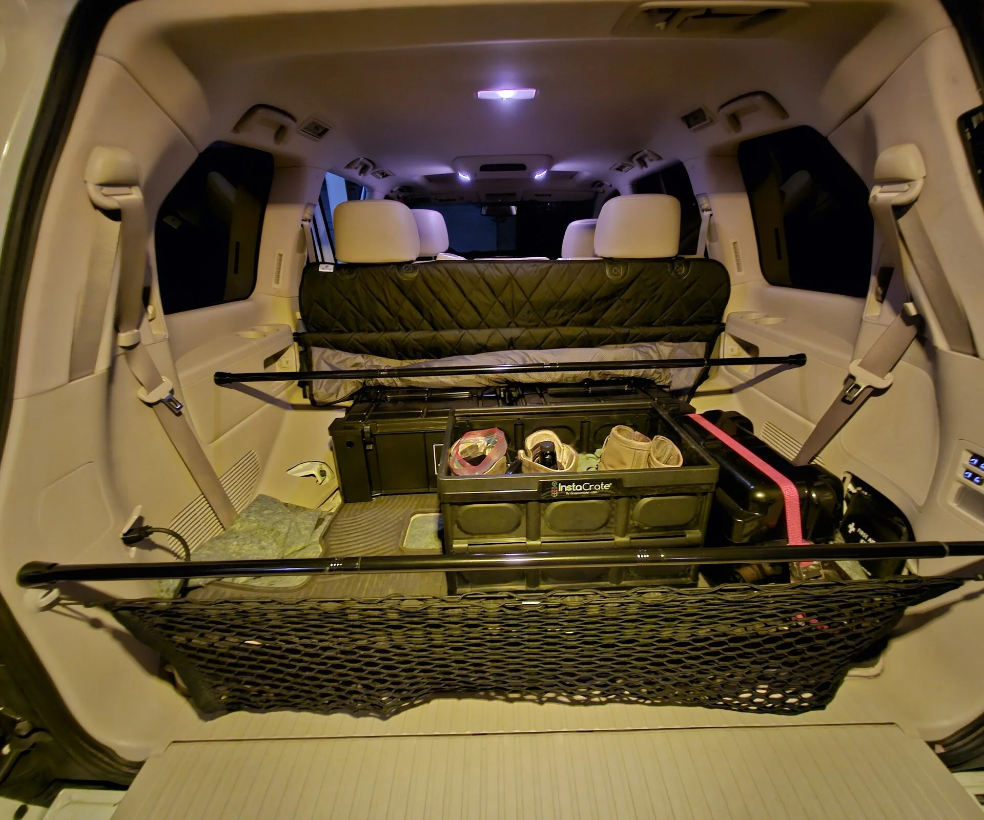

I found that these spring poles are the best choice for price vs stability, but they still can move out of place while off-roading. The fix for this is to use a retaining socket to stabilize, while still using the spring poles to keep tension and keep from rattling.
