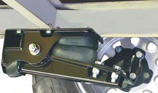

Jamie, here's a thought. Take this (yeah it's small)
Mount it on a set of something like this with a bit longer arms and some shocks. Mount to a frame spacer to gain a little height. Run the same size tires as the truck. Instead of fenders run aluminum truck tool boxes etc. That you can take anywhere we have been going lately.
