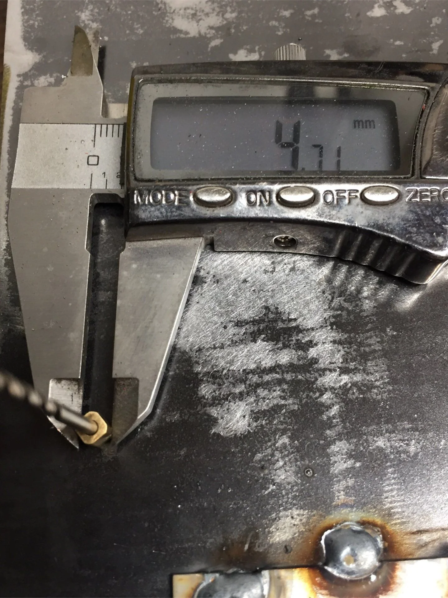

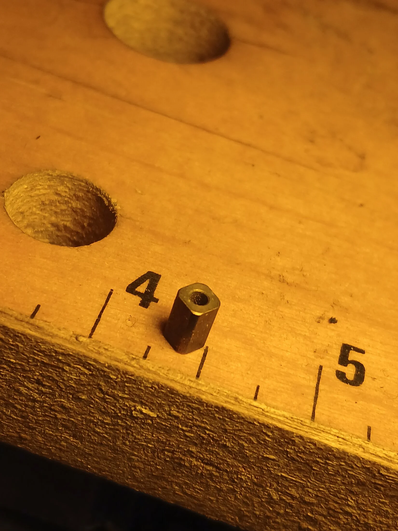

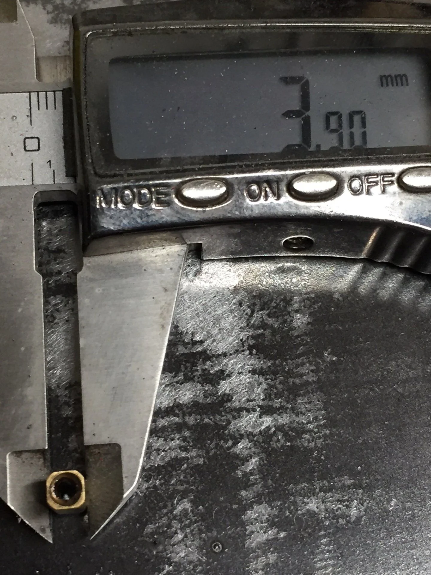

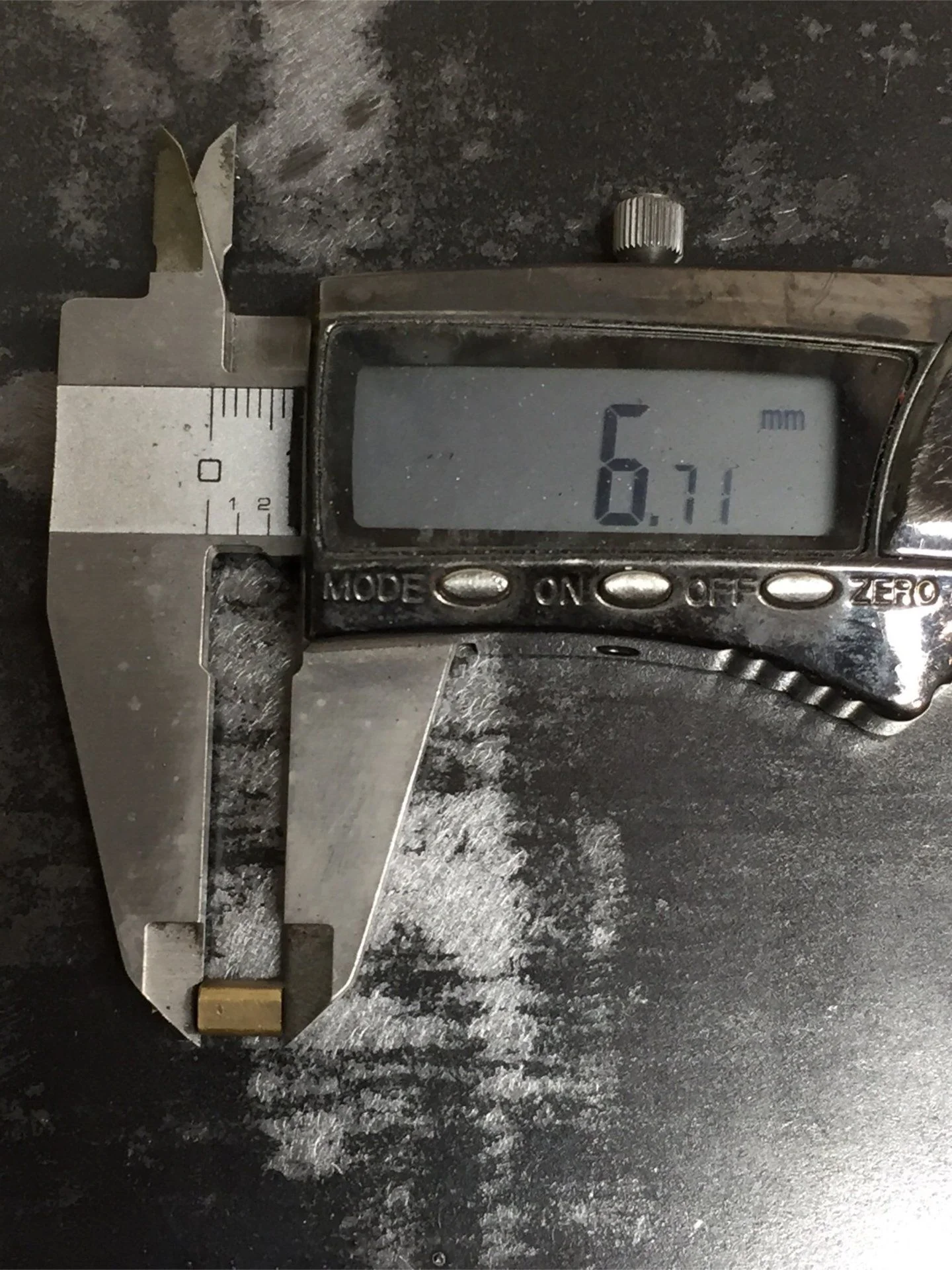

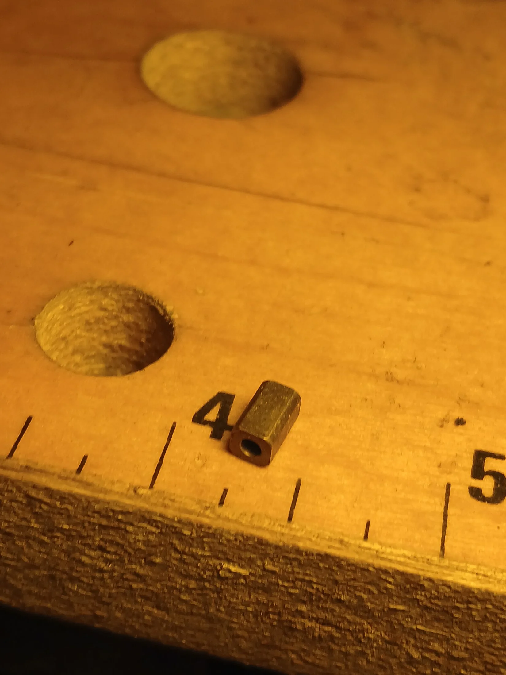

Dang, two carbs missing weights. Usually it's the stopper. I have a spare carb I haven't put back together. I can take some photos/measurements of the weight if you want to fabricate your own. wouldn't be too difficult.
Yeah, I know. The cruiser gods weren't looking down on me favorably last night...
If you have a spare minute and could take some photos/measurements, that would be great. Thanks!
Kris
discharge weight measurements
The end that fits over check ball is hollowed out a bit
the hole is about a 5/64" drill bit
Note the weight isn't square, the 4 corners are 45ed

Does the 5/64 hole go all of the way through the weight or just counter sunk at end ?
The hole goes through and widens on one end. the weight sorta nests on the steel ball. Big ball goes in that discharge chamber. Small ball goes in the (big) accelerator plunger chamber.
