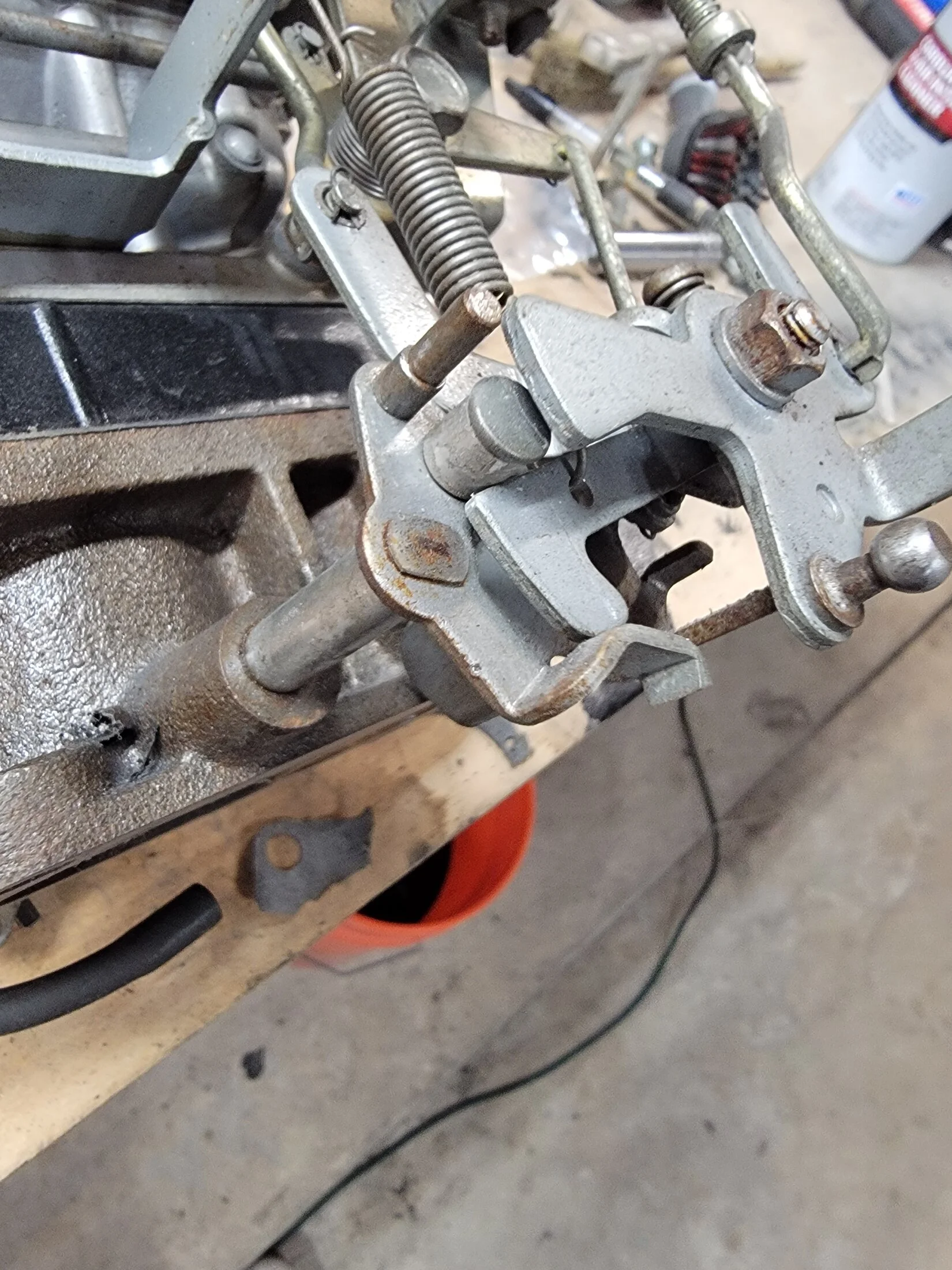

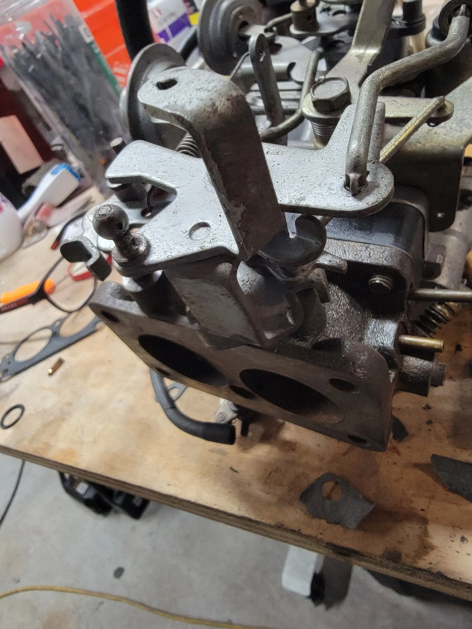

So I had a "carb guy" rebuild a carb for me and now my truck won't run. 😅
Long story short idk what's going on but I did notice this doesn't seem to fully engage and open the butter fly. Anything clearly wrong with this?
What I know; that is your secondary kicking open. It will open the rest of the way when vacuum is applied from your intake manifold.
You can search the secondary extensively here on MUD. It’s also in the carb section of your FSM.

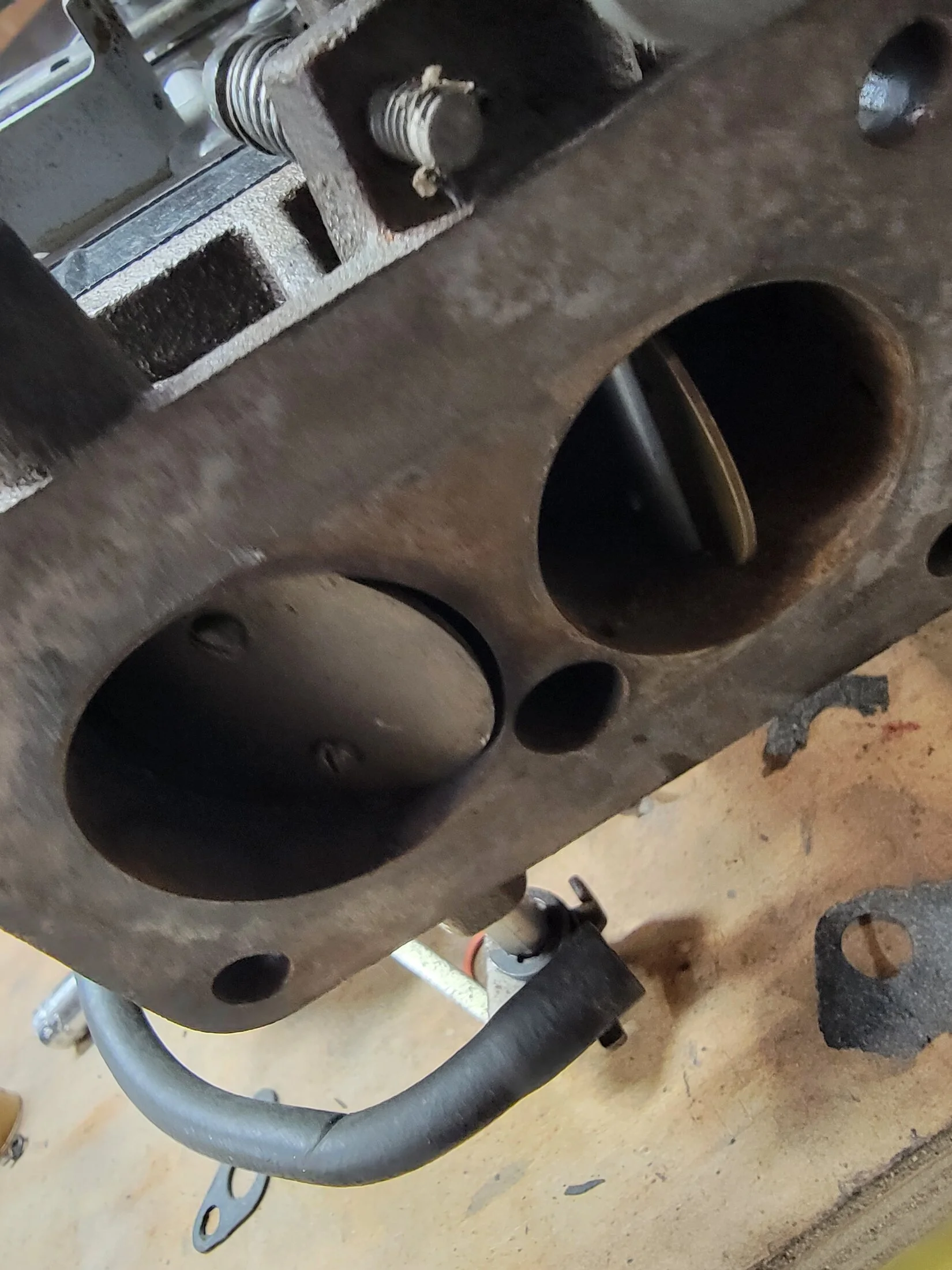

If the idle mixture screws aren't working usully means fuel is bypassing the idle circuit. Make sure the throttle plates are fully closing. They might be hanging up on something. Sometimes a gasket can stick out a little into the bore where they close. The carb could be leaking fuel thru the venturies too.
