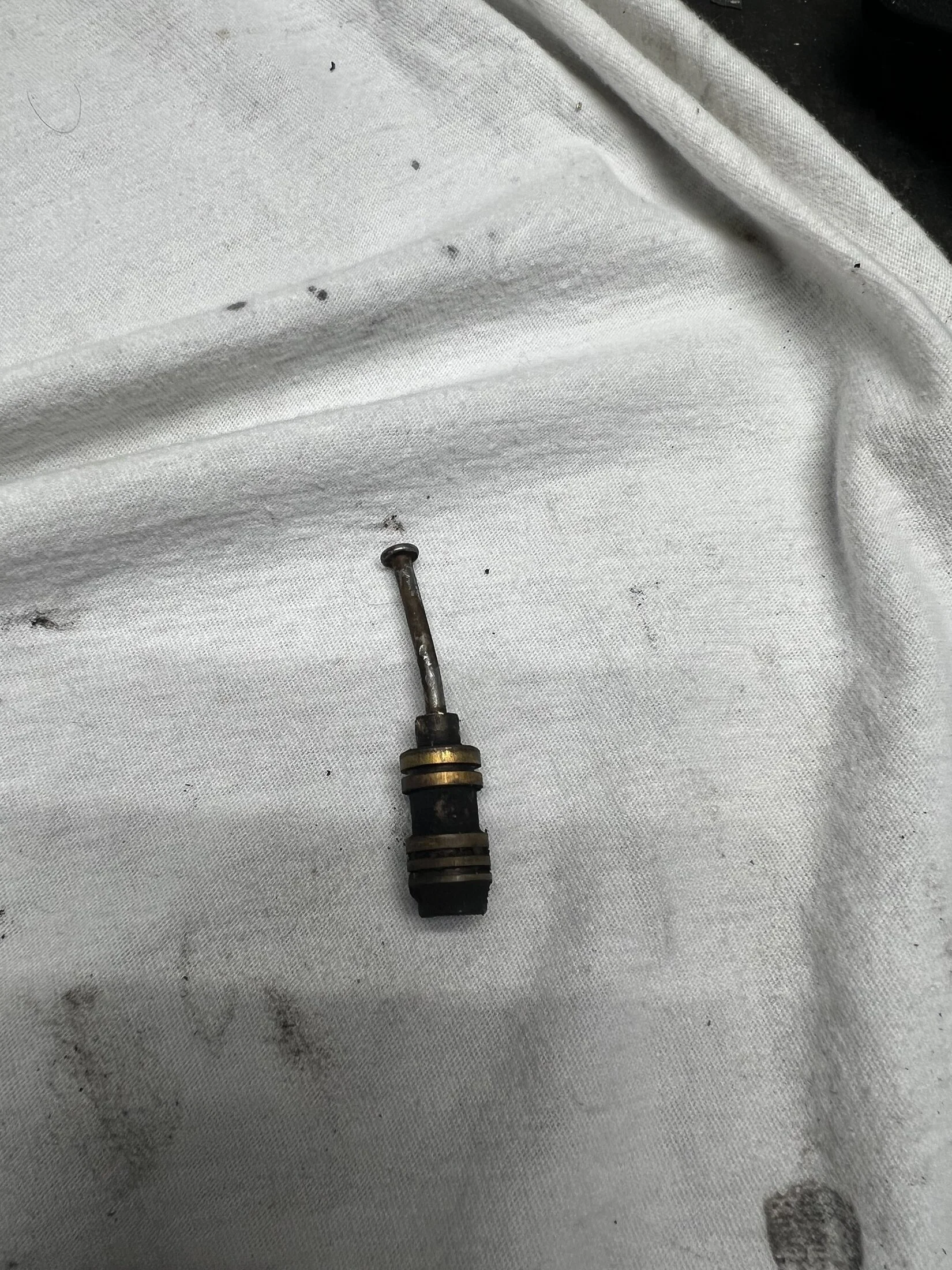

Hey guys, as the title says…
I may have got a little destructing while attempting to take apart my carb for a refresh. The power piston (part no. 21351-41011) is bent. It’s discontinued by Toyota. Does anyone make a suitable replacement or am I just screwed?
I’ve got dozens of them, but you can just straighten yours out…it’s not hard
I straightened it. I figure it’s ok just wanted to make sure. First time going through a carb to this detail and so far everything has gone awry.
Stripped the screw holding this.. (no bid deal it just needed an easy out) the power piston was stuck pretty good that required some elbow grease. (How I bent it) and the needle valve housing thingy refused to come out without brute force.
I can’t wait to get into part too. Hey heads up to Pin Head. I’ve seen that name around here on searched posts. I’m following his YouTube videos and so far so good.
