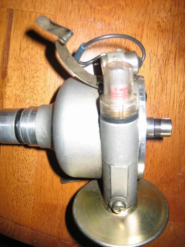

Advance - Retard
When the engine is turning, the plastic thingy moves in (advances) and if I unhook it it goes out (retards)
My dizzy looks like this one (stolen pic from the forum) https://forum.ih8mud.com/attachment.php?attachmentid=226504&stc=1&d=1209346449
I am hooking the vacuum from here
