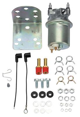

It sounds like the gas in the float bowl has evaporated after sitting a week. Then you have to crank the engine over to make the manual pump get gas to the carb. At first there’s not enough getting to the cylinders from the carb to ignite… then an excessive amount from cranking finally ignites creating smoke.
I’ve got a pump similar to this one.
I shopped around to find one still made in the USA. My last one lasted 23 years before it got too much crud in it to keep pumping. I likely could have cleared out the debris to get it pumping, but it still would be 23 years old. I swapped it out for my spare and haven’t had any further problems. After sitting a week, a month, or a year, I turn the key till the ignition is on, wait 10 seconds, pump the throttle pedal once, turn the key, and it starts. Longest it sat was for two years in a carport… it needed a boost, but I then drove it 75 miles home after filling the tank down the block. The battery didn’t recover, but the 1.5 hour trip home was unexpected.
