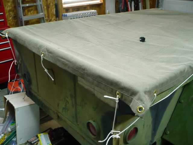

So, on the trailer it goes. My excitement soon became “are you kidding me…?” In summary, the canvas is short. Ideally, there would be a 2-3 inch overhang on each side of the trailer to facilitate good tiedowns, block water, etc. As received, the canvas was 77”x57”. As you see in the pics, <1”of overhang in length and about 1.5”in width. It seems he orders a stock 5x7 tarp and punches in the grommets (read lessons below).
You can see the width is only 1.5in wider than trailer
and length is about .5" in overhang. No way to seal the trailer.

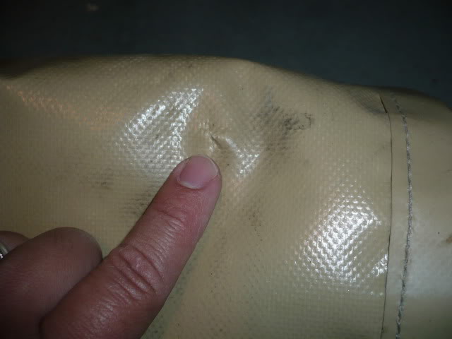

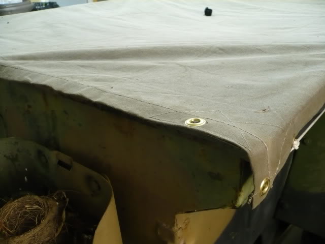

The tarp worked flawlessly - with one exception. There is a small tear (wear-thru) one one corner. I examined the offending corner and found that there was a very sharp edge. I also did not reinforce the tarp corners in any way. The plan is to put on 2 additional layers of heavy canvas just in the corners where the tarp/tralier corner interface. Overall, I'm very satisfied. I'll post more pics. Likely will be the best $38 I would have spent.
OK. Here are the pics post 1500 mile trip behind a suburban.

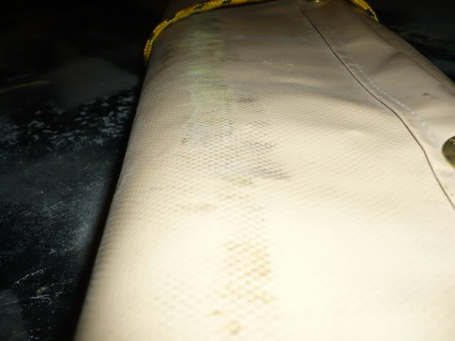

Only issue I've found is a small hole as a result of a sharp corner on the trailer. I plan on "rounding" the corners with a couple of hits with the grinder. I will also reinforce the corners on the tarp (underside) with a layer of canvas glued on with ShooGoo. The 12" spacing of the grommets actually worked pretty well with the way I tied it down. The "b" side of the tarp also had some paint transfer from the trailer. The paint on the trailer is old, and wipes of the tarp with a paper towel, so no issues.
