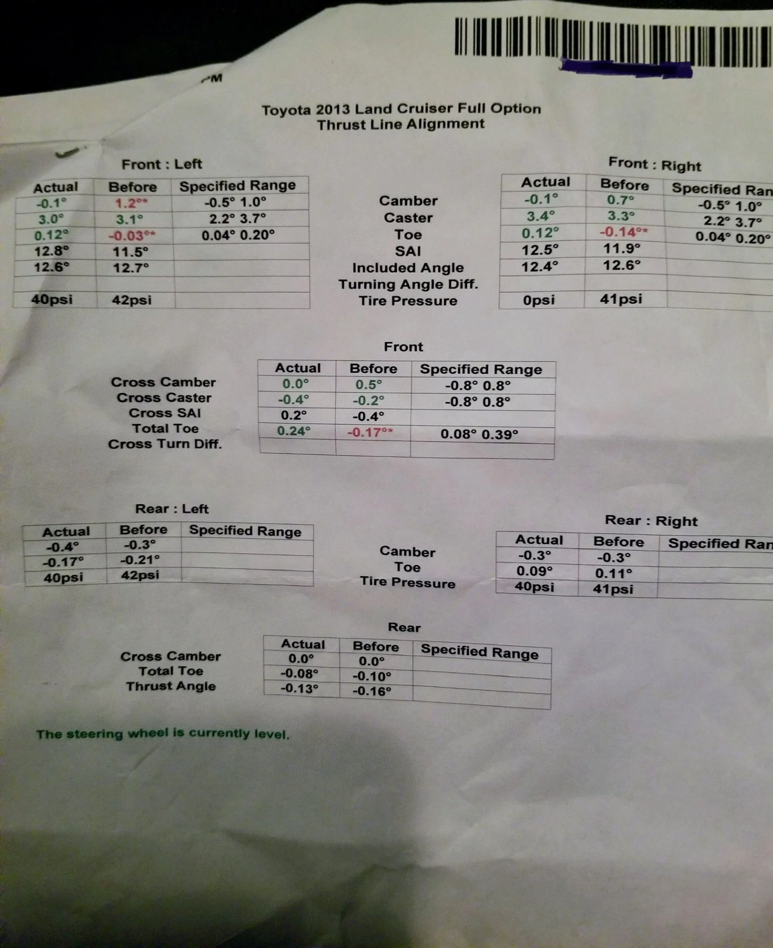

Can you post your most recent alignment specs? If we are able to see what you are setup with for camber, caster, toe..etc. we can help diagnose. These are the specs I take to my alignment shop and have them duplicate or get as close as they can. My 2013 LC is lifted with 33” tires and tracks straight with even tire wear.
Do you think these specs would work with a 18' LX on factory 21in. wheels? Thanks in advance!
