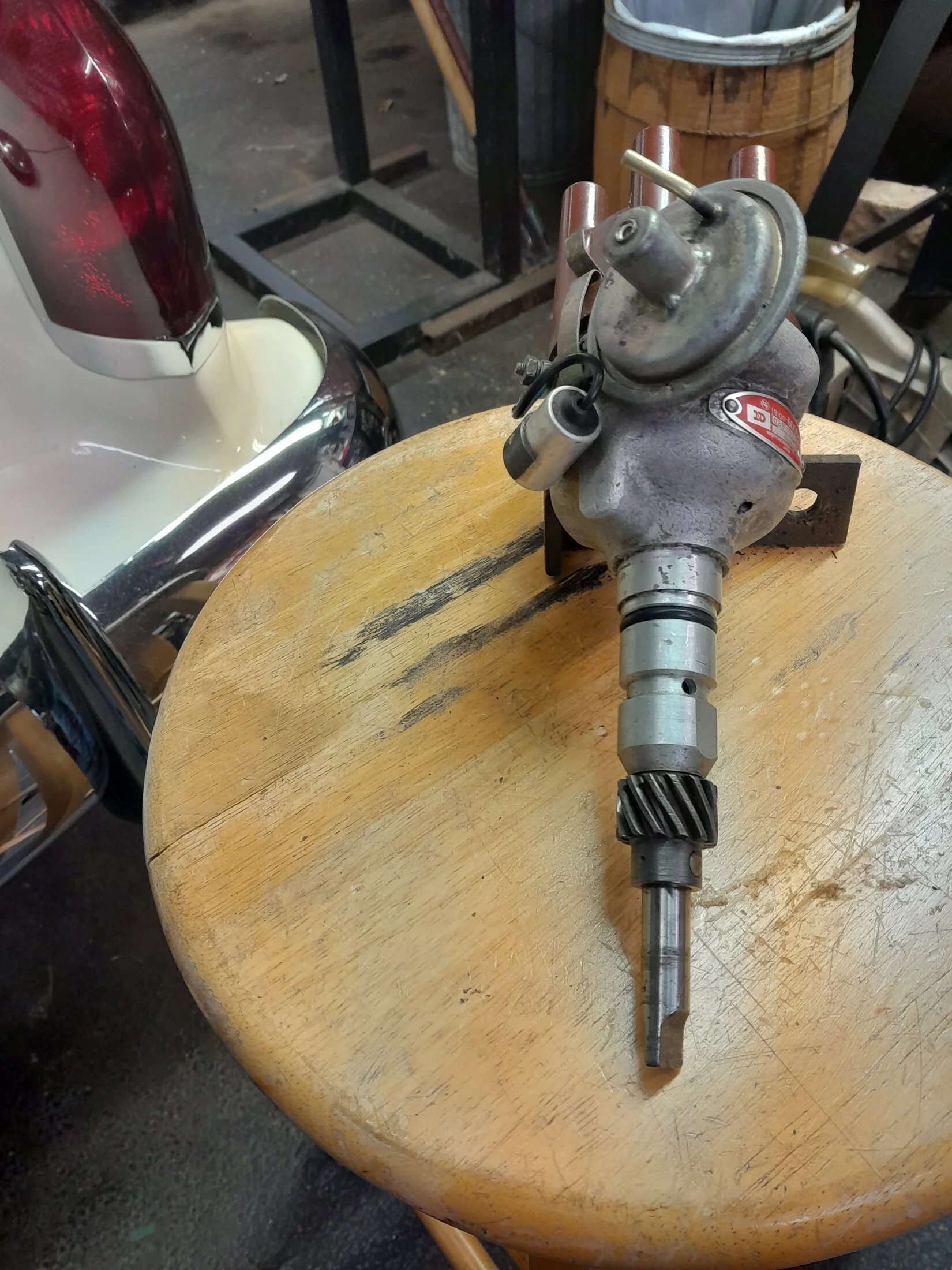

Cannot identify 78 FJ40 Distributor

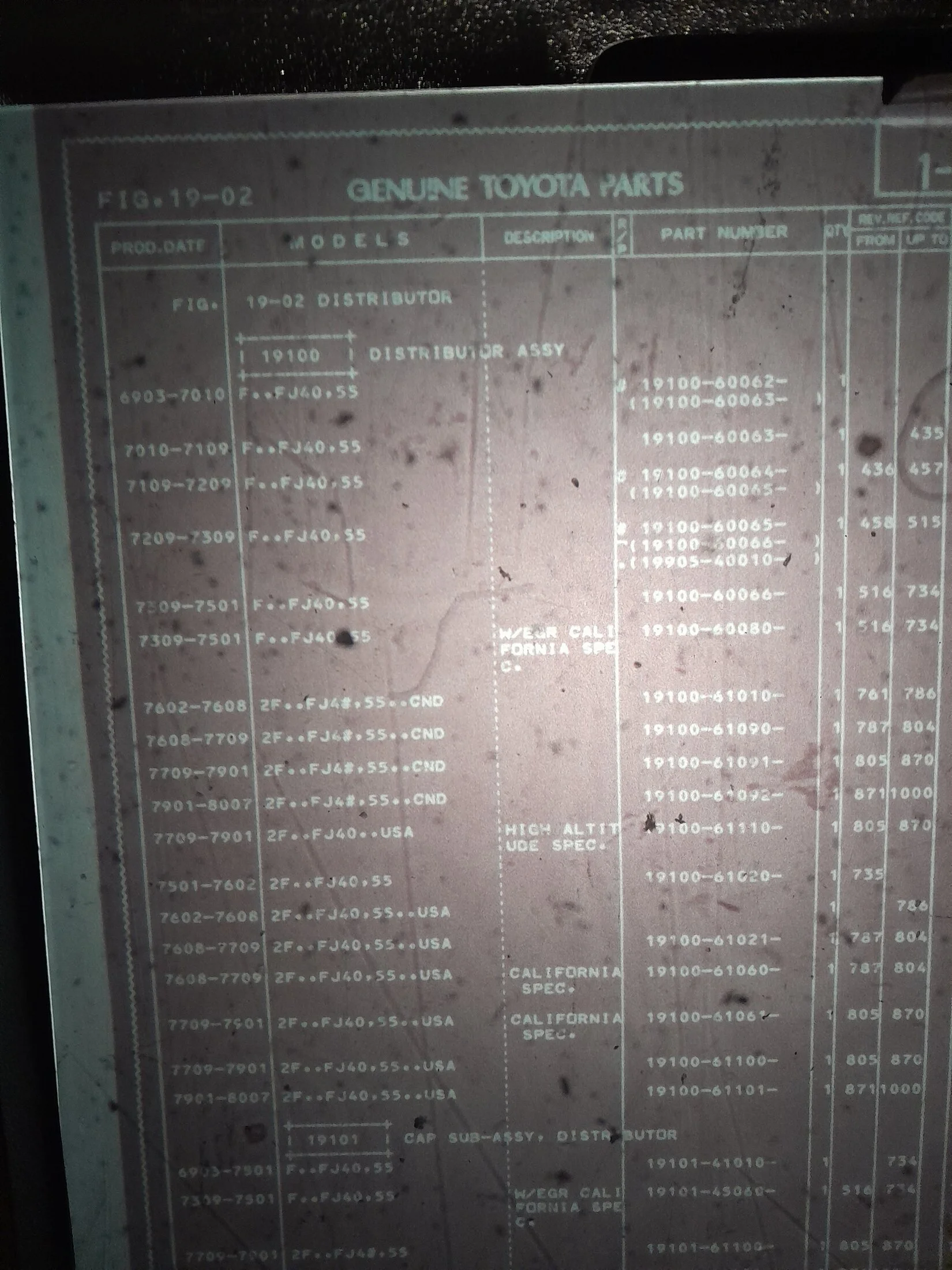

This dizzy came out of my Jan '72 fj40 and per the p/n, is correct for that period per the microfiche pic. The microfiche pic covers the period 03/69 to 07/80 for the US and Canadian markets. This may help those with the tags still intact on their dizzy to see if it is correct for their year build.

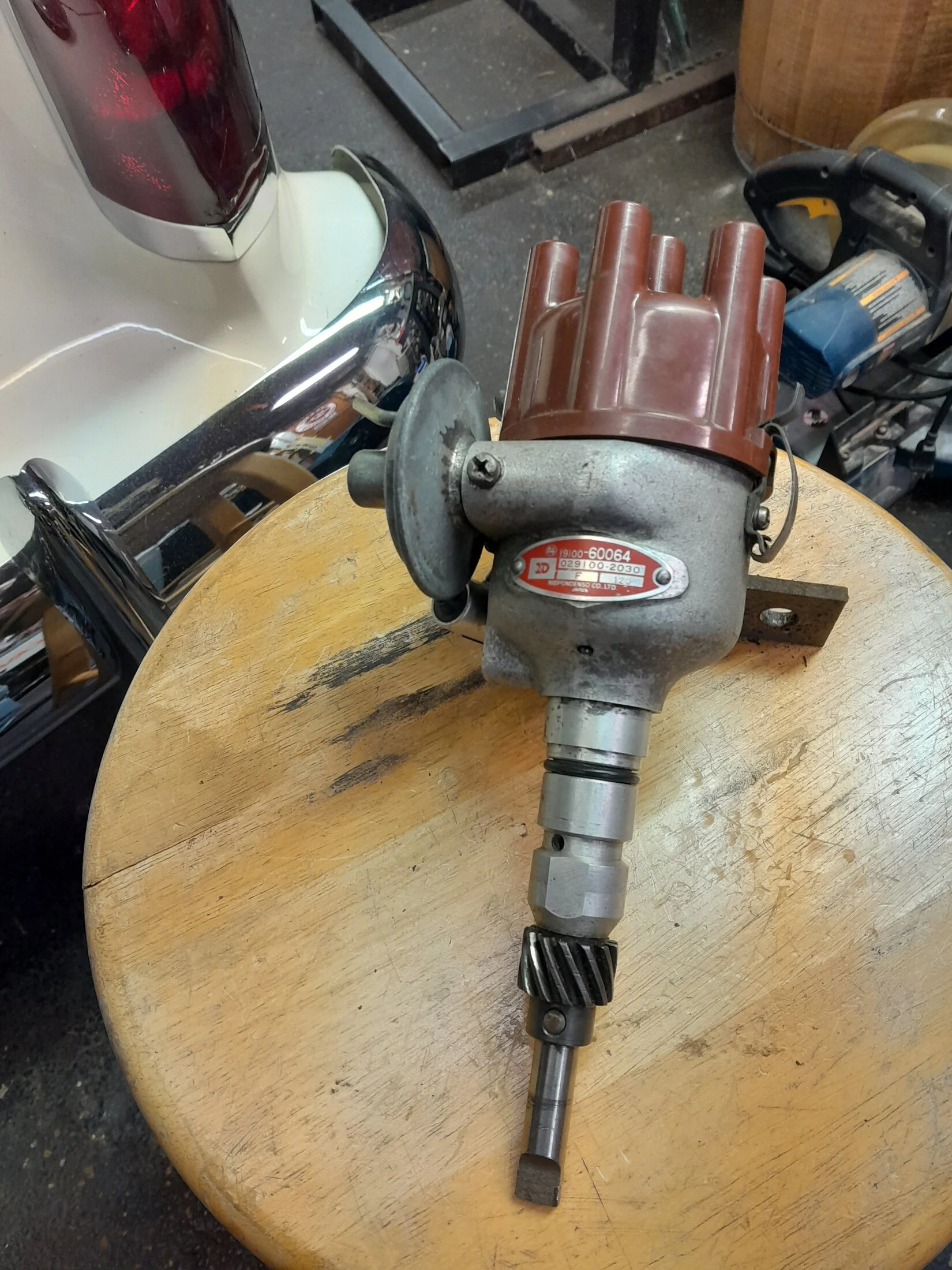

Which Pertronix would I use with the 69-74 Dizzy? Since there is no model number on the distributor, when I called Pertronix, they said they could not help. Any ideas?
For this distributor, would the Ignitor 1 or Ignitor 2 be best? And what model number should I order?

The 69-74 dizzy would be vacuum retard. I would not use that dizzy if I could help it.
If we're talking about the dizzy you pictured in post #16, then, as 4Cruisers pointed out, you can use the same ignitor that I used. Probably.

I'd be more concerned about ordering a Pertronix, when the governor weights have started to rub against their spindles rendering the original equipment distributor toast via ozone-induced corrosion. A non-aftermarket option is GM HEI.

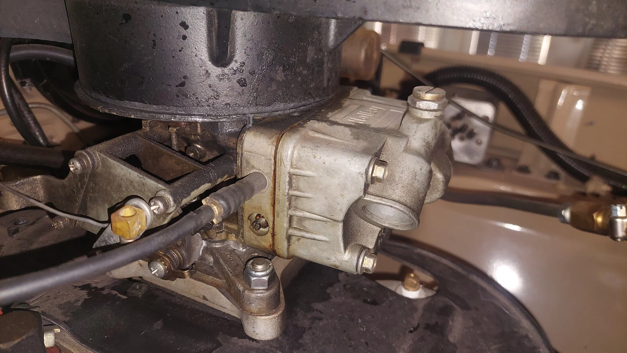

True, we have not seen pics of OPs carb. I was assuming it's a '78 like his engine.

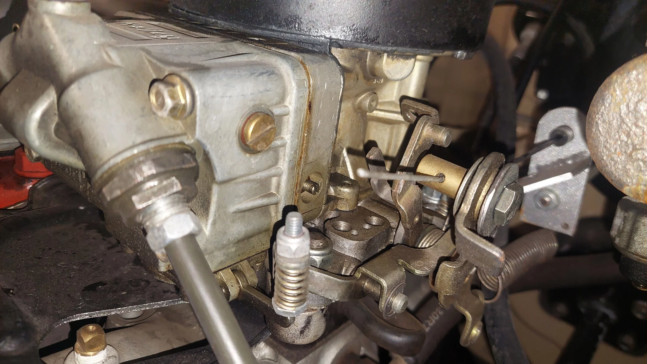

The carb is a holley 2 bbl. it is what came on the FJ
Oh, I have never owned one of those. Does it have a port for a ported vacuum source?

BTW, the distributor in question was already determined to be an advance-type

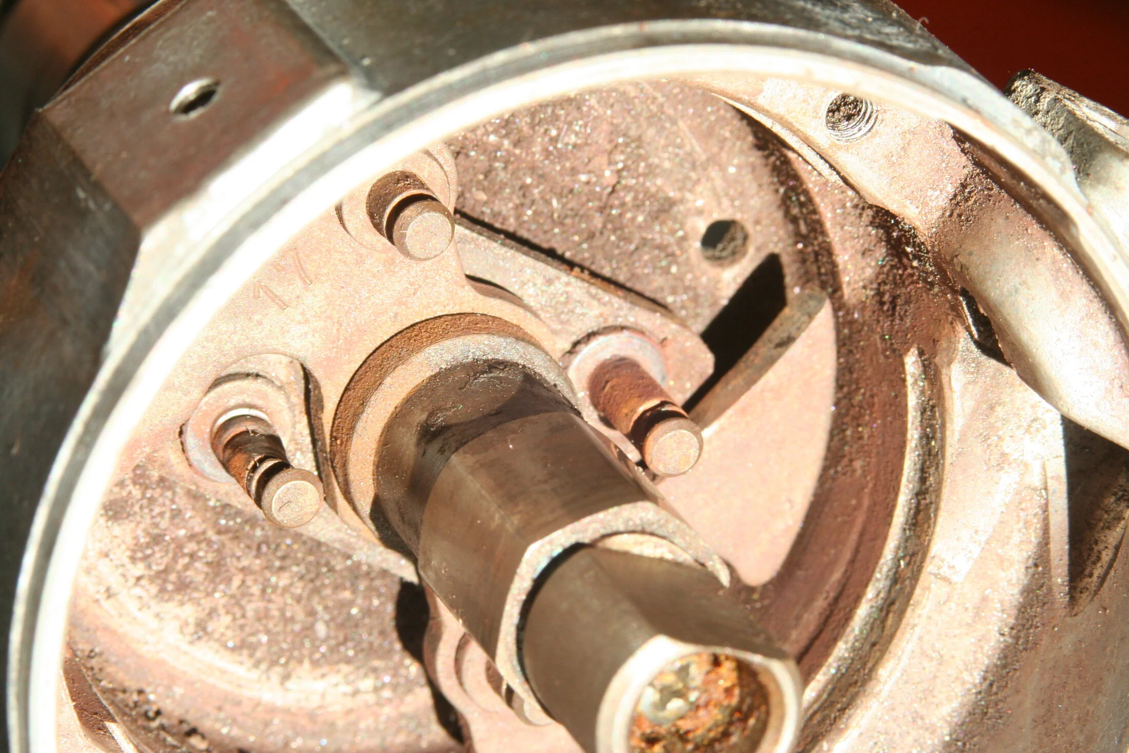

How do i tell if "the governor weights have started to rub against their spindles rendering the original equipment distributor toast via ozone-induced corrosion"
By removing the breaker plate, and inspecting the weights, springs, and nylon bushings on the cam.
The spindle on the left is toast. The governor weights ate the steel via friction and rusting.
