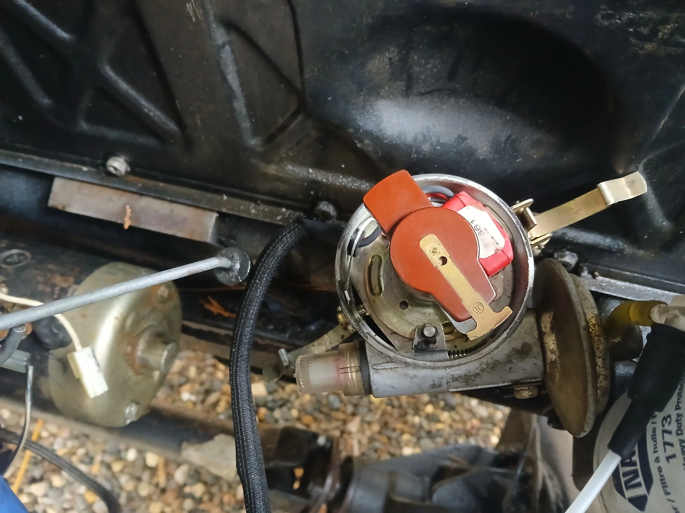

I will add this as a bookmark. Got a quick question. the hole on the distributor where the wires from the Pertronix is going to go through is pointing directly at the side plate. Is it possible to rotate the distributor so that the holes don't point at the cover plate? Or is that going to mess things up?
No. A very common adjustment. You can rotate ("Clock") the dizzy body to anywhere you want. You just have to make sure that the rotor ends up under #1 sparkplug wire, and all the others in correct order behind it.
Mine as it sits today...
Not at TDC #1, just to show the wires
