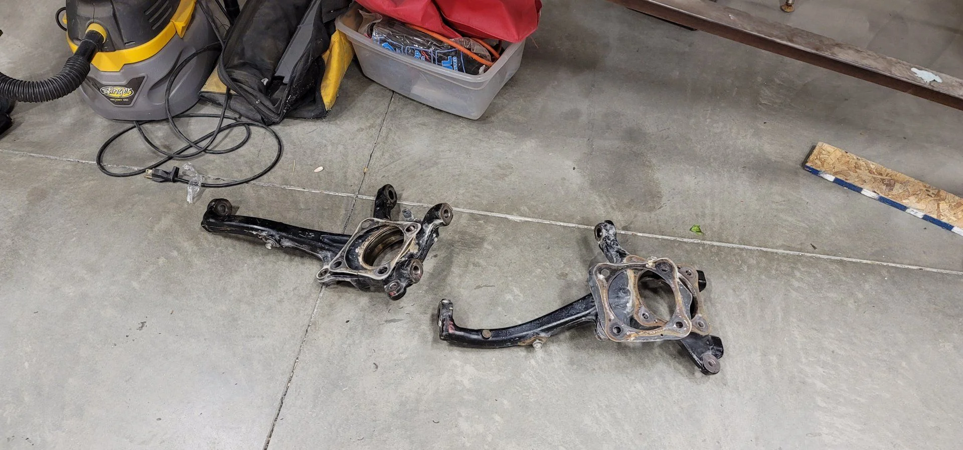

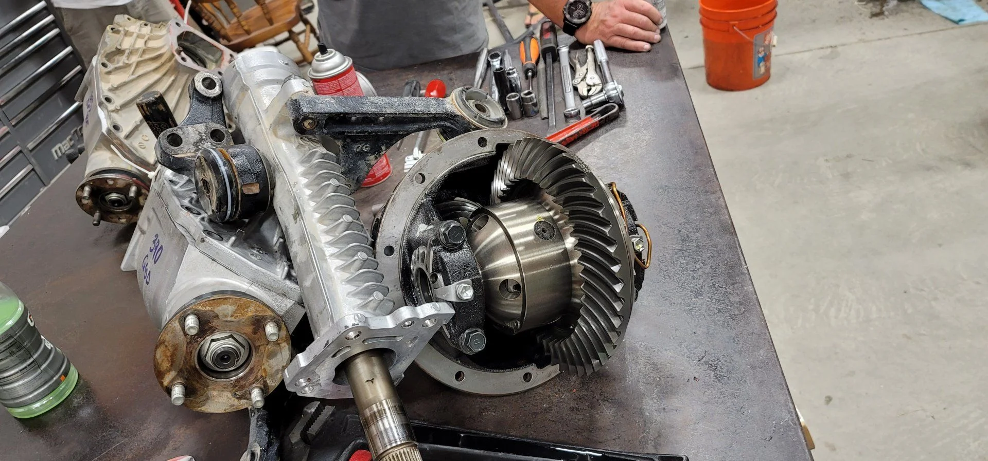

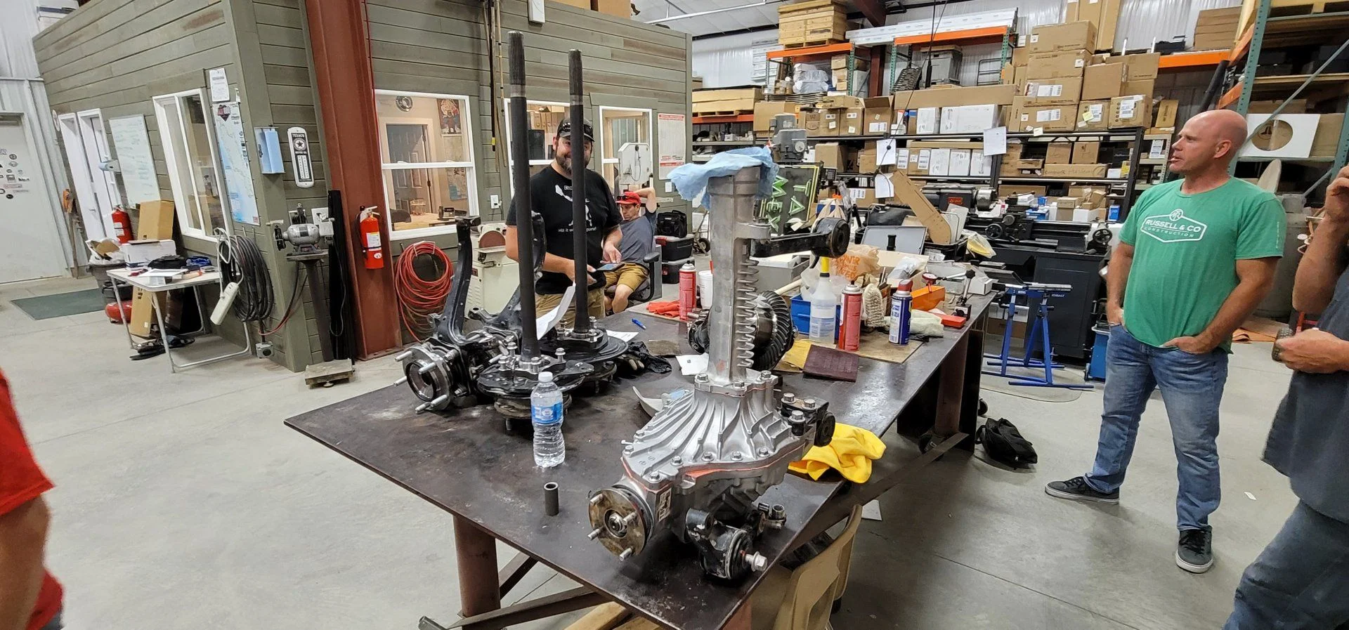

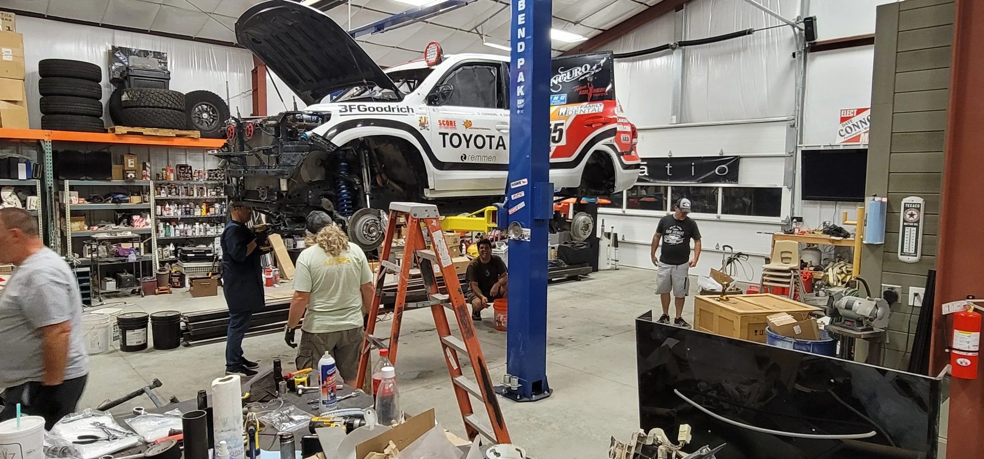

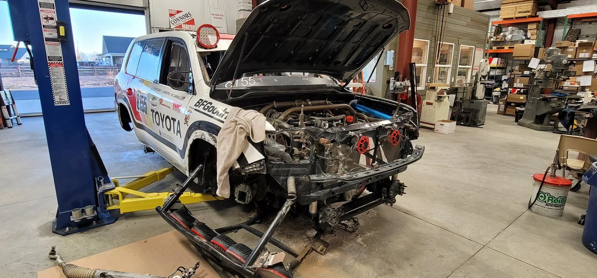

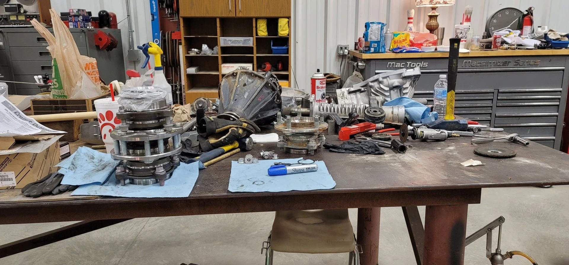

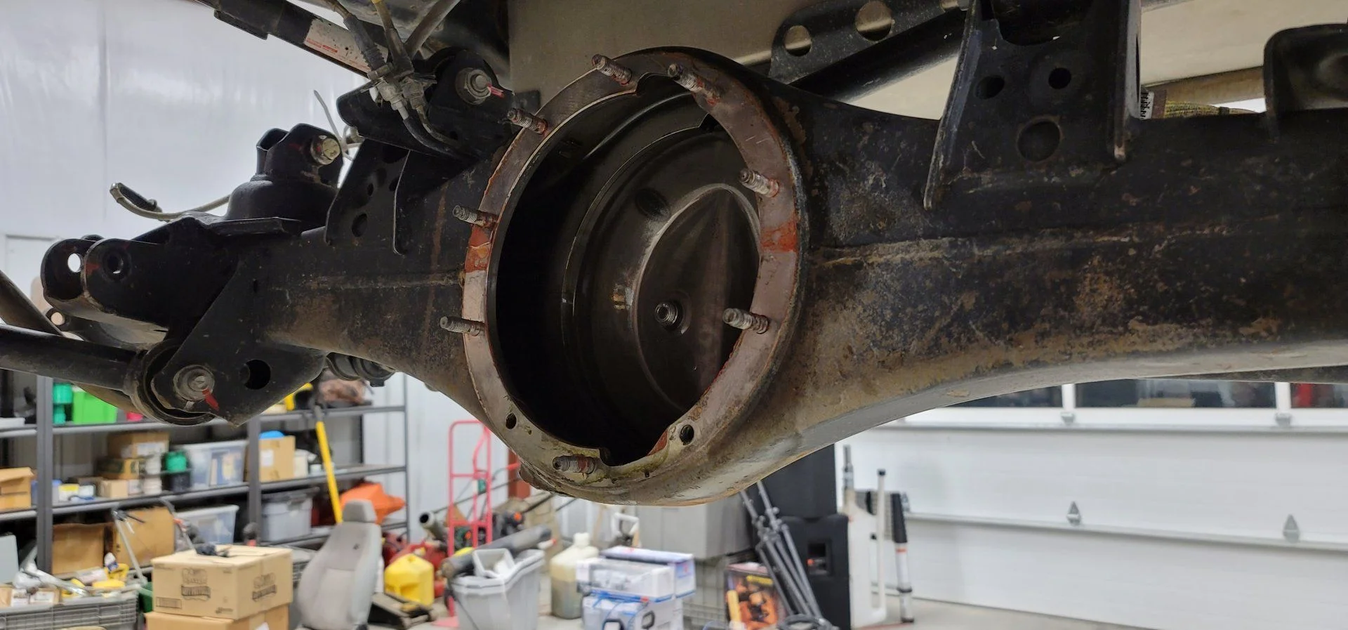

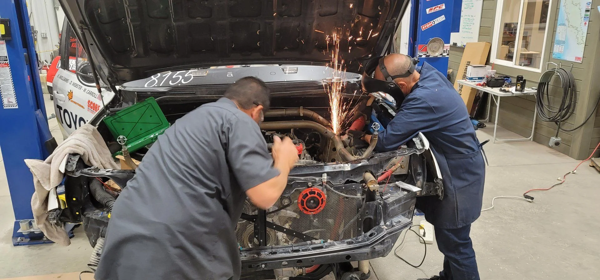

Prep is well underway for the 2020 Baja 1000 in November. We spend a couple nights a week wrenching. We just about have it as torn apart as it gets and stating to go back together. This prep includes shock & coilover rebuids, new UCA's, LCA's (front and rear), diffs torn down and inspected, new wheel bearings and axle bearings, new rack and ends, frame repairs, everything refreshed on the front of the motor, belts, pulleys, fan clutch, fan bracket, PS pump, etc.

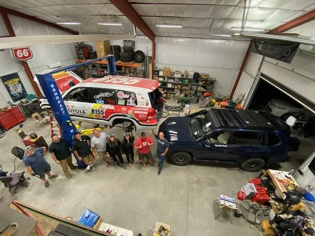

We had some special visitors this week, Rachelle and Taylor from Xelles Racing. They are driving the new Lexus J201 concept. We (Cruiser Outfitters) worked with XOverland and Lexus to build this neat LX570 and they are starting Day 1 of the Rally now. We sent them with some of the Canguro race spares just in case they run into trouble with wheel hubs, joints, etc. Go Xelles!

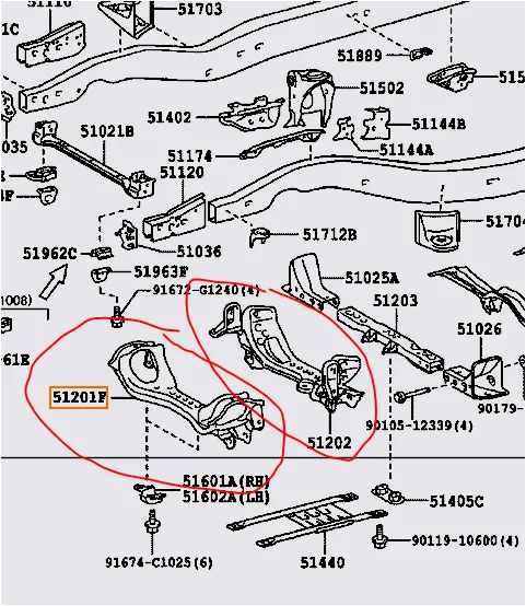

Sorry if this has been covered already, but this thread is quite long. Do you guys run camber/caster-adjuster-reinforcement on the front subframe? Seems like I’ve heard these can be an issue on tundras and other Toyota’s that are driven hard.
No, but we have to repair/weld the cam tabs regularly. If they are considered a reinforcement to the frame, they can't be used per stock rules. If they are considered a repair to the frame, they are OK. Our subframe is beat, we've repaired many cracks at the LCA mounts and steering rack mount over the years. Eventually we'll need do a completely new subframes.

we've been getting a lot of work done lately. Pretty much new everything underneath the truck will be new when we get to Mexico next month. Not to mention a new radiator, idler pulley, belt and throttle body
