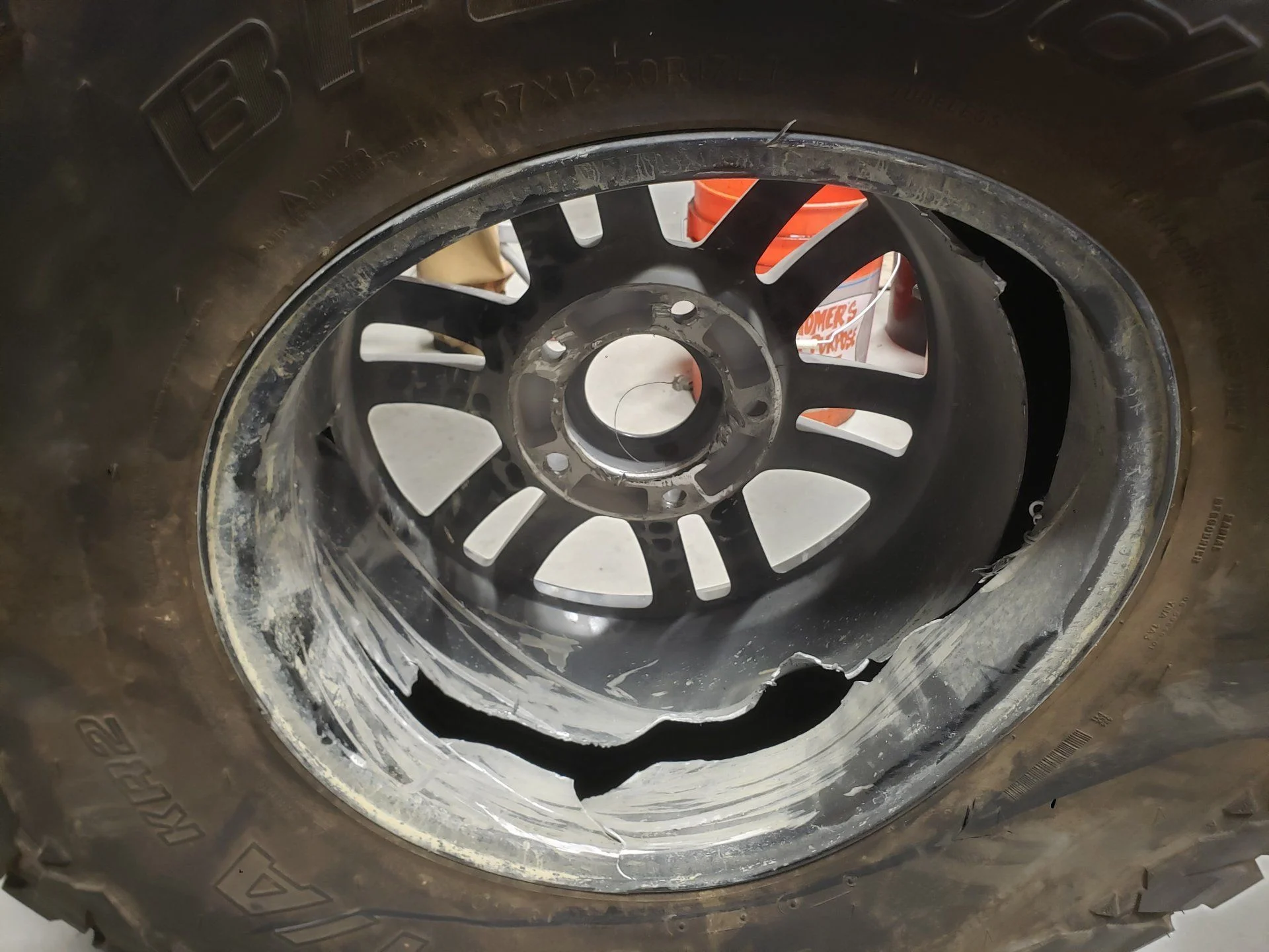

Anyone know a good wheel repair shop? This Rock Warrior needs some love :D
OK, I'll bite.
What did that?:hmm:
Yeah, quite a bit I imagine. Did it get the tread as well?
I bet it was noisy. :eek:
Sadly it did wipe out a brand new tire, it had less than 20 miles on the combo. @dmc could describe the sound it made :D
Was that an OEM rotor that grenaded?
No, it was an aftermarket rotor. We have since switched to Remmen Brakes and had zero troubles
A little JB weld and that wheel will take you to victory at Baja. :D
Interesting. Was the rotor that grenaded cross drilled or slotted? I prefer solid disks for track duty.
Never thought of the wheel barrel as a containment structure for the brake rotor. Wonder what speed Monica was at when it let go.
It was cross-drilled/slotted. All these years our only rotor failure.
@dmc was driving as I recall.

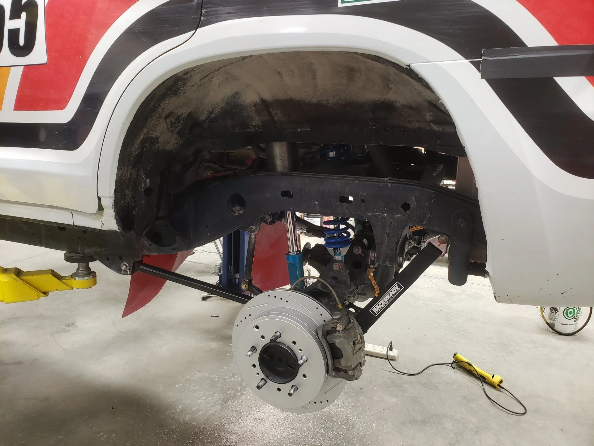

Great eve in the shop. Rear suspension is done and ready for brake bleed, tires and ride height suspension torque.
Front is coming together nicely too. Waiting on a couple parts to button it together next week.
Minty fresh bits ready for some punishment
We were probably going about 65 around a right hand sweeper that was uphill but off-camber to the uphill side when the back end of the truck just slammed to the ground. It wasn't scary at all just startling as hell. It was during a testing session (we were breaking gears so just putting some miles on them, not tuning suspension). Those were EBC brakes I believe. Might have been Stop Tech. There is some thought that the lug nuts sheared then broke the rotor rather than the other way around. There was a huge chunk for rotor still in the caliper when we climbed out to look at it. That was a long day of recovery.
